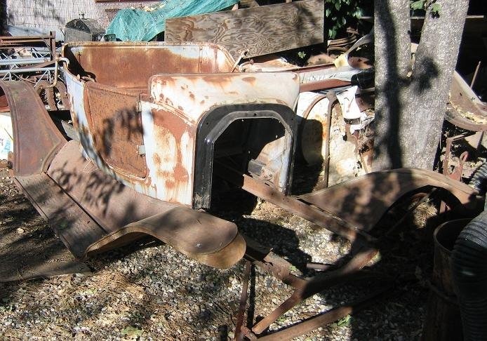

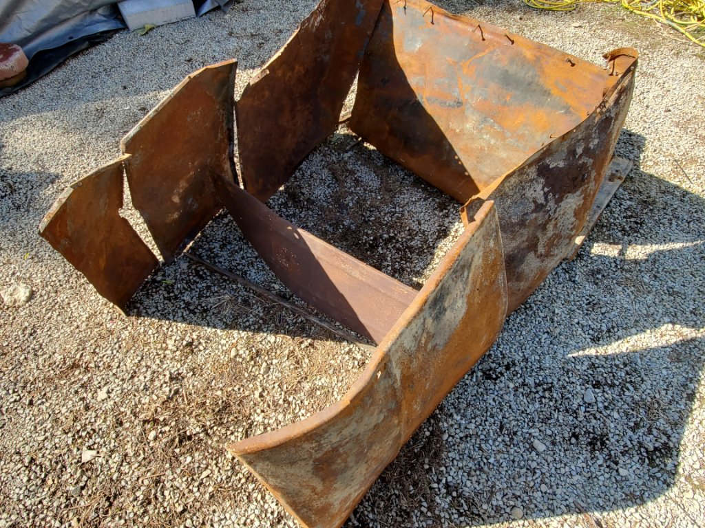

evening all.
I'm looking to invest in a quality hammer and dolly set (either new, or well maintained used). Whats a good set off hammers and dollys that would be great for T body use?
I'm also looking into investing in an English wheel and a nice bead roller too. Nothing way pricey, but what would be suitable for repairing and making new patch panels and such for T bodies.
Benji

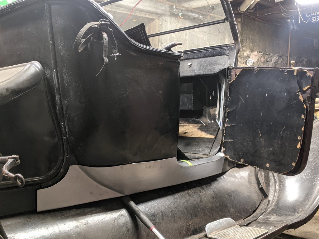

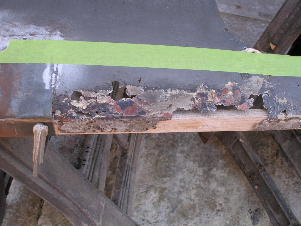

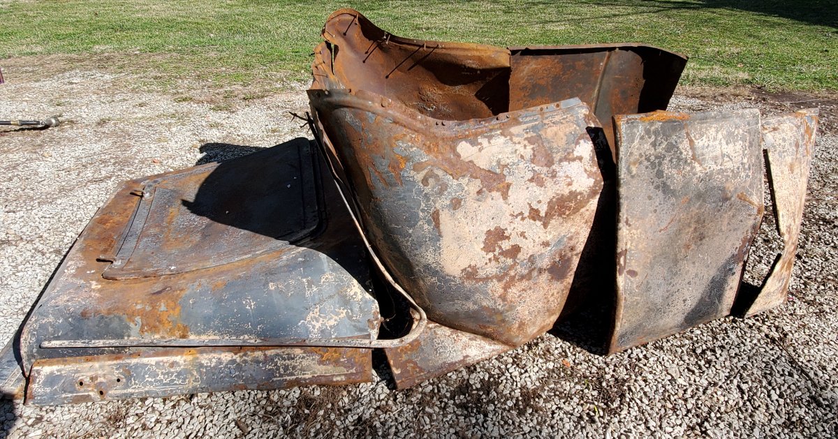

UPDATED: My internet was out for a couple days, so im just now able to reply. Here's some pics of my 1913 roadster sheetmetal to restore.
Benji

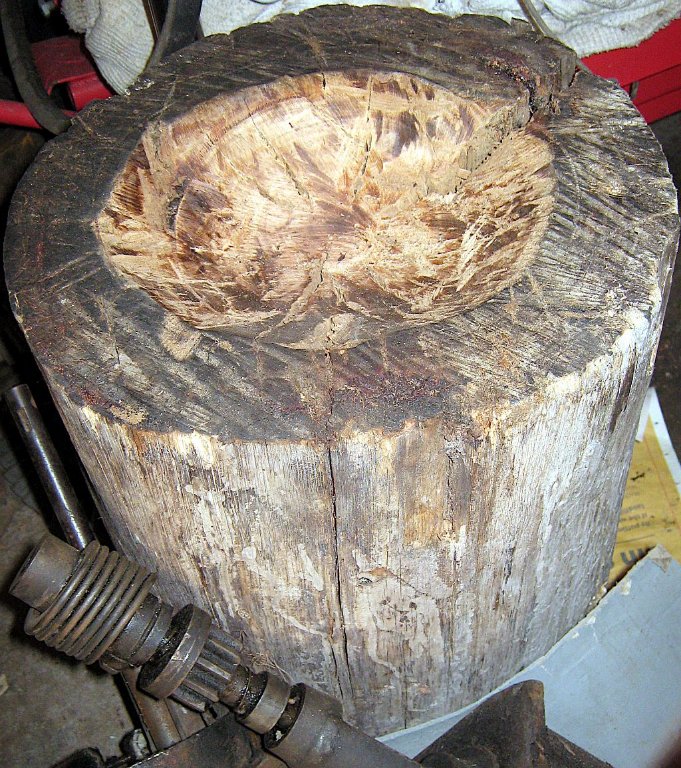

You'll also want to make a shrinking stump to go with the above gear, and perhaps get a planishing hammer along with some post/standard finishing dollys to round out the kit.
Oh, and you can make quite a good shrinking slapper with an old coarse file. Again I'll photograph some of mine, if someone else doesn't do so beforehand...

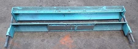

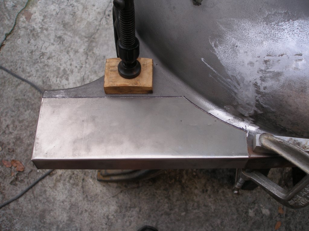

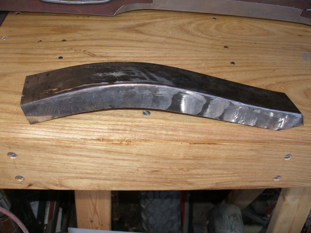

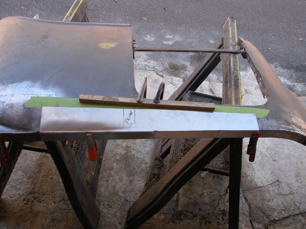

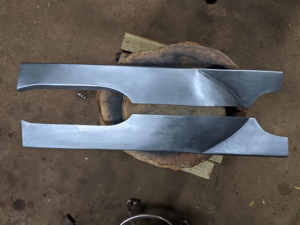

No English Wheel
No Bead Roller

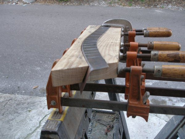

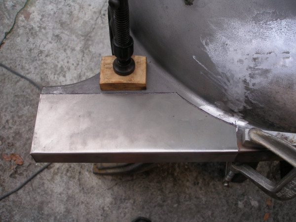

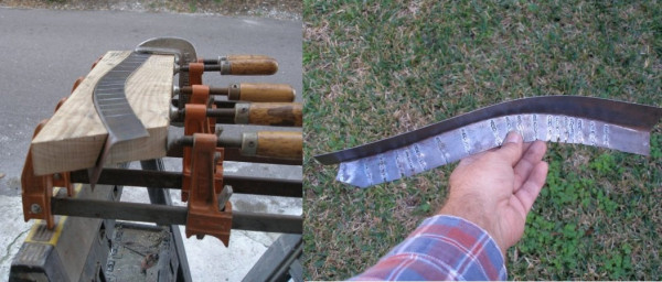

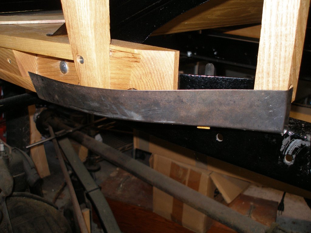

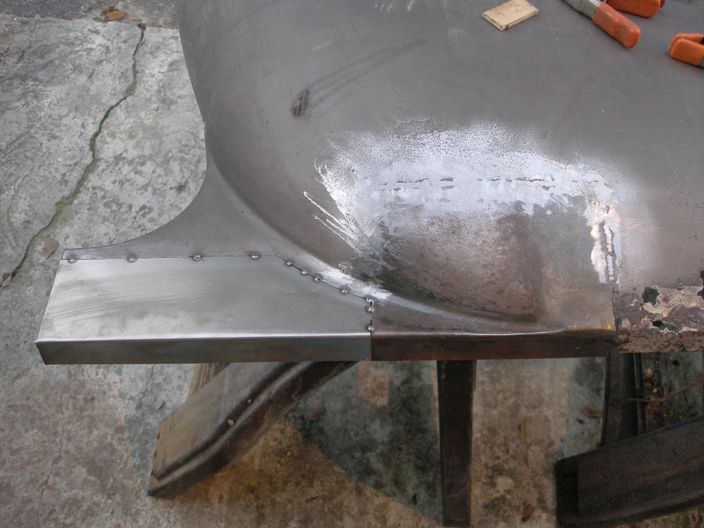

All would be nice, but a hammer and dolly did this after being disgusted with the fit and shipping costs of patch panels...If I was going to have to spend a day making one fit, I figured I'd spend a day and a half and make them myself and save the money
No Bead Roller

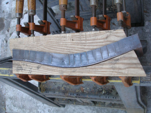

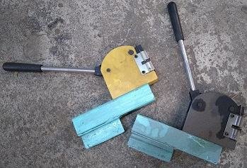

- Posts: 6835

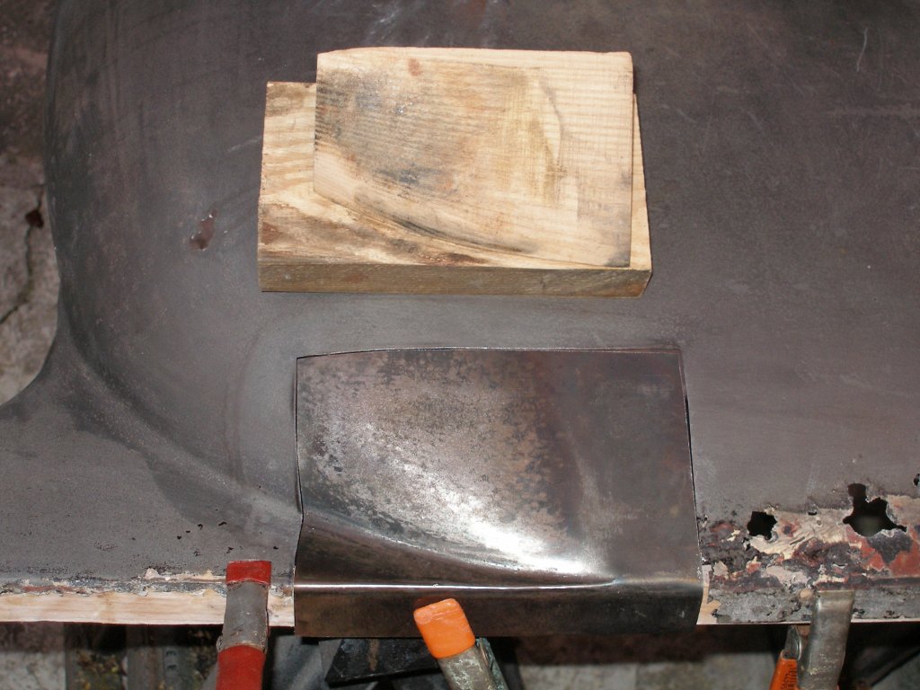

Re: What is the best Hammer / Dolly sets to get, as well as everyone else's favorite body working tools?

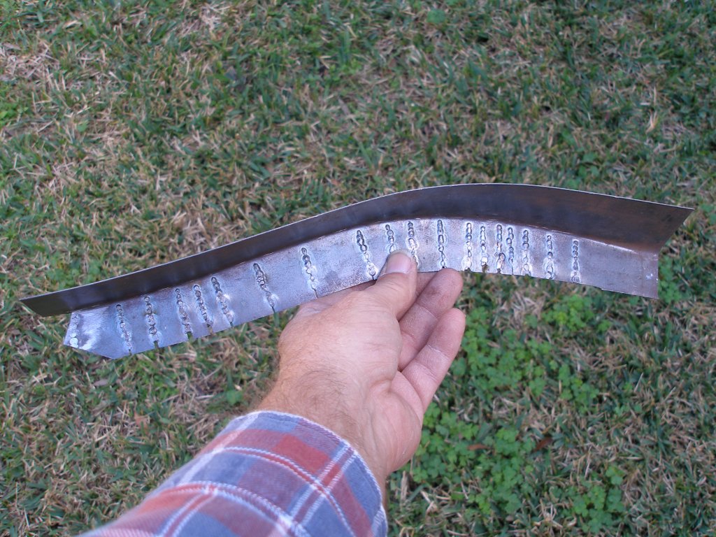

You just have to be smarter than a piece of flat metal
A shrinker would have been nice, but this took 3 hours and a bandsaw and cost me nothing but time...I doubt that I could have made it in 2 hours with all of the "correct" tools, anyway

Learn to use these and you'll find that all of the cool and expensive shop tools can stay on the showroom floor.
I don't use a brake, I bend seams with a couple stout pieces of steel, but this would be great for the money:
https://www.harborfreight.com/30-inch-b ... 67240.html
Myself, I HATE cheap tools and am not wealthy enough to buy them, but I use my machine shop tools a LOT and buy the best I can afford...with body work, I do it once every 4-5 years and the cheap stuff usually works just as well as the expensive stuff for that amount of use. If you buy an expensive hickory-handled Martin set of hammers and dollies, report back to tell us if it made you into a craftsman sooner than the cheap hammers.

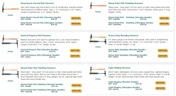

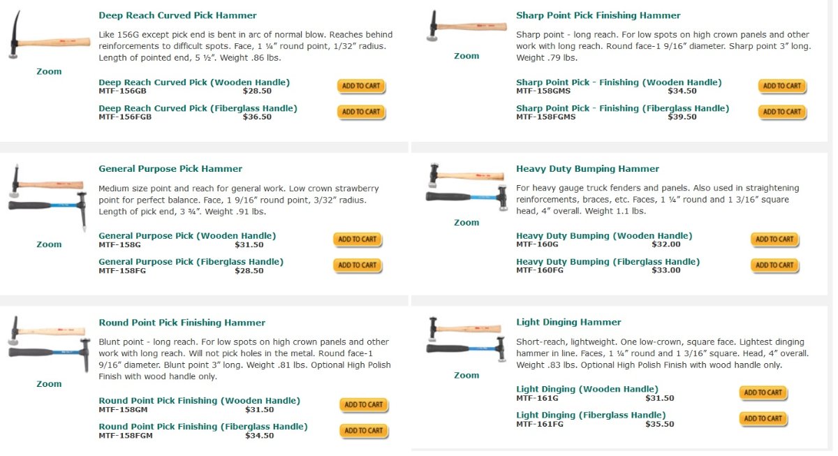

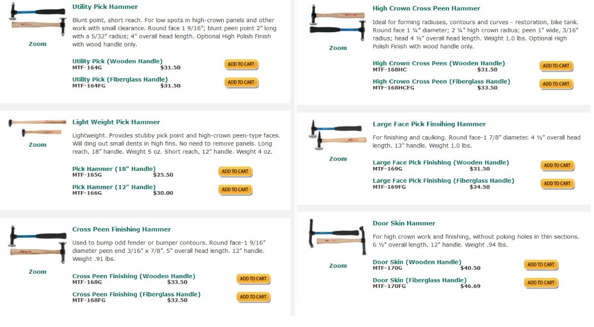

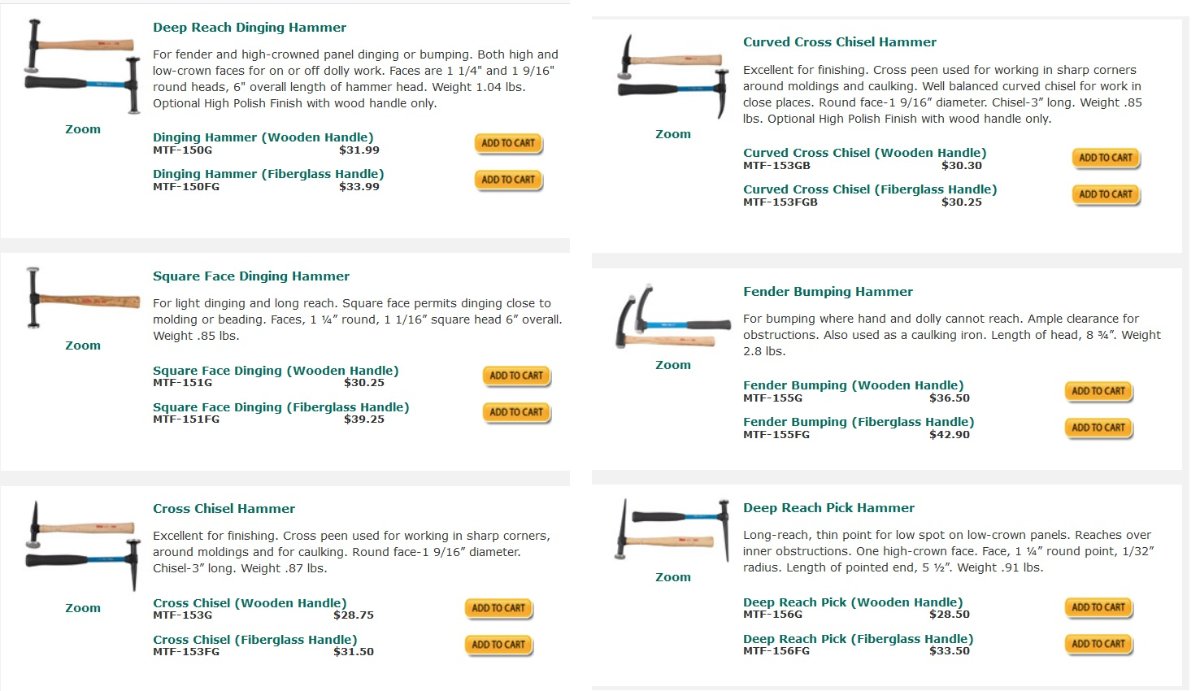

Lists purpose of various hammer styles ...https://www.tinmantech.com/products/han ... y-hammers/
Which styles make sense for Model T work.? Sometimes a "kit" contains stuff you'll never use.
Martin Tools makes very good American auto-body hand tools. These are based on the old patterns from Fairmont, Paramount, Proto, Blackhawk, and others. We have found this company to be responsive to the market, and they are genuine made-in-America.

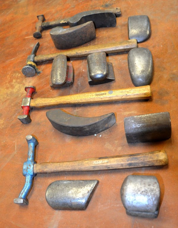

Luke
- Posts: 617
- First Name: Luke
- Last Name: P
- Location: New Zealand

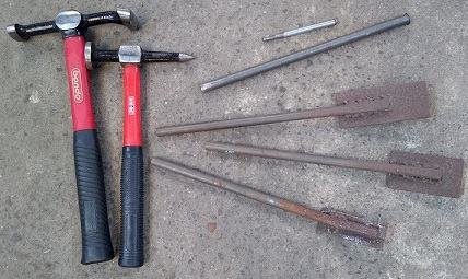

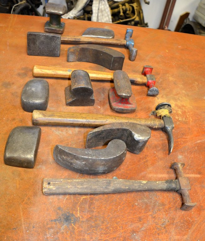

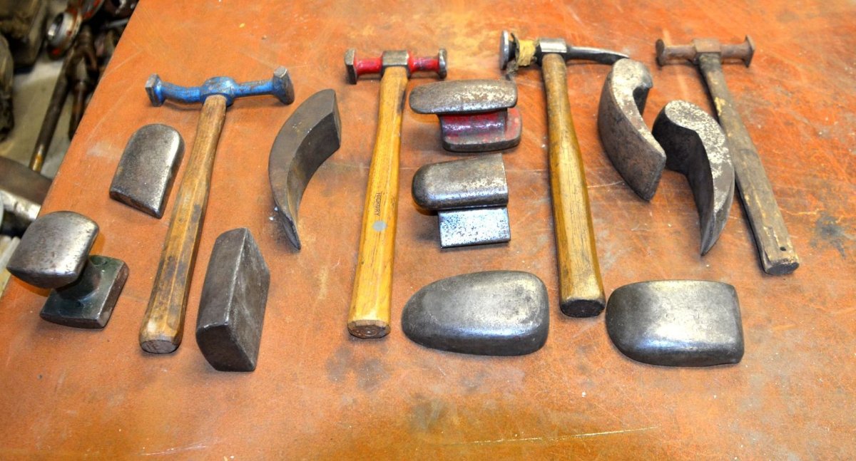

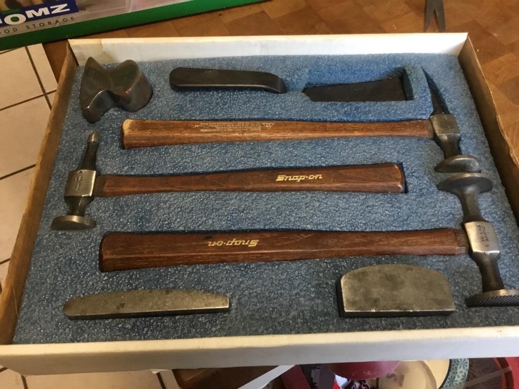

As promised I've photographed a few of my hammers and dollies. Hopefully the different views will give an adequate idea of the shapes.
About half of these dollies are ones I made, the others are Snap-on or SP.
Such tools are very personal to each owner, and different people will find different tools more preferable to them (depending also on the type of work you do). What you see here is a subset of the ones I've found useful for old car work, there are many other levers, spoons, slappers, dollies and hammers I've got, but I reckon this lot is probably the most useful.

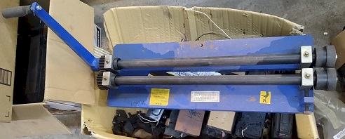

The bead roller is a fun tool in that the wife enjoys supplying the forward and reverse power while I have two hands on the metal. I encourage a deep throat.

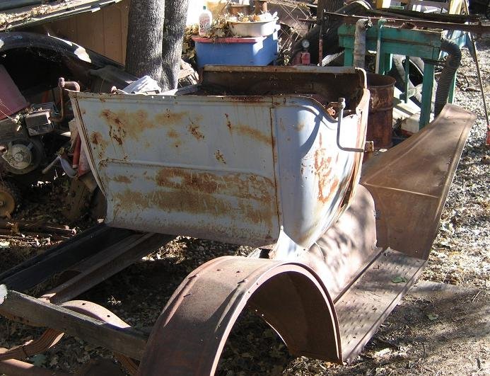

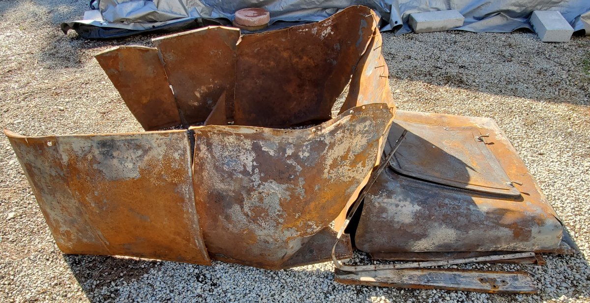

Hey all! Can't thank you enough for the replies. Lots of outstanding work, and you gave me a good idea of what I need. Swap meet season is coming up, so this info gives me a good idea on what to look out for. Especially good brands. I dont mind spending a bit extra for good tools and tooling. I'll definitely take a look into all the advice given here.
I've read through this book so far: Professional Sheet Metal Fabrication - Ed Barr
And also have Metal Bumping next to read. I have a friend that's been doing body work for decades, so can get some extra instruction there, but I moved a while back, so he's not as close to me as before, unfortunately.
I've got a heavy arbor press and 20 ton press now. I do want to get an English wheel for this work, and for future. A deep throat bead roller is planned. Id like to get a good break, but will look for a decent used one as the cheaper harbor freight ones aren't the best the last I looked into it.

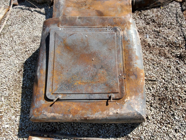

Al, my cars are early, so patch panel availability is minimal. No patch panels for the bottom of 13 doors, etc. So its best I learn all of this. My 13 roadster is more bent metal, no rust outs.
The 13 touring I have has alot of rotten metal on the lower 6 inches or more in the rear tub, and tapers out about the middle of the car. It was screwed to a piece of plywood, and left out in the weather a long time before I got it. Had it not been, most of the wood would of been intact, as well as some upholstery. Very sad, but I'll try and save it. It also came with the fenders, hood, firewall dash shield, one engine pan, all the brackets and toe heel panels, the little lips for the seats, splash aprons too I think.
I've got some old parts and fenders saved up to practice on when I get my tools. And have a new Lincoln mig welder I started learning on last year.

Like a couple others, I make my patch panels myself. Available patch panels I have seen others buy never looked that good to me, and the fit wasn't good. Since I work on a very tight budget, I figure I can spend less, and the time I usually spend making them isn't much more than I would waste on phone calls and fiddling with and getting a bought part anyway. I made the piece for my car like Scott Conger shows above. He did a nicer job than I did on mine, but mine fits, works and looks good!
I don't have enough proper tools for body work. A couple that belonged to my dad many years ago, and a few cheap ones I bought almost forty years ago myself. I make do with other tools I have, and also carve bucks out of wood like Scott C shows with his patch panel. A little thought, some creativity, and a few good tools can accomplish amazing things!

Benji,
You've got a fair job ahead of you, judging by the photographs. It's not going to be easy, and there'll be some difficult times I expect, but if you persevere I'm sure you'll get great satisfaction out of what you produce.
Mike and others have given good advice re videos etc that are online. These are great for getting an idea about what you should do, however you'll need to put that learning into some sheet steel and see what you can make with it. Lots of practice is a Good Thing
A couple more things that may be of use and interest. Firstly, Zintex and the like can be a bit hard to work so you'll want to use soft panel steel, about 1mm thick.
Secondly, there is no one right way to make panels but you may want to 'invest' in a shrinking stump to make some of your quarter panels and the like. Here's one I made recently:
I used this to make the complete quarter panels for the car you see in this thread: viewtopic.php?f=2&t=19034 - the methodology there was to first cut out the rough shape of the panel, then shrink the edges with the stump and wooden round-headed sheetmetal hammer, followed by working with an English wheel, then finishing off with flat panel hammer and dolly.
With the door skins, which generally require much less curvature, I'd just use the English wheel if I was making the whole skin (and possibly bead roller if you wanted some edging), but if I was patching it then there's a lot you can do with simple hammer and dolly work as Scott has said.
As a matter of interest the original metal panels for the car in the above thread were in some cases not too dissimilar to yours in terms of condition, but in others areas they were completely non-existent. The restoration decisions were:
- Guards had repair panels that were made with folder or wheel, and/or flat and crowned hammer+dolly. These panels were then let into the guard via mig or gas welding.
- Quarter panels were made new using the method I describe above. I did try repairing one of the original panels but it was badly holed in a number of places and a new panel gave a better outcome for a lot less time and welding material.
- Rear panels including bootlid and guttering were all manufactured using a roller or folder, with a little hammer/dolly work. You don't actually need a roller for this but because I had one it was used. I also used a post that was holding up Adrian's shed in order to adjust the curvature in one panel and it worked fine!
- The front cowl was made simple by cutting to shape then bending up each side by hand on a piece of carpet layed on the ground. When it was fitted into place I needed to do some shrinking and stretching with straight-pick and flat hammer + dolly.
- Sill panels were made with a swager because the folded edge was necessarily not straight. This was followed with a light wheeling and fettling with flat and curved hammer + dolly to get the final shape and fit right.

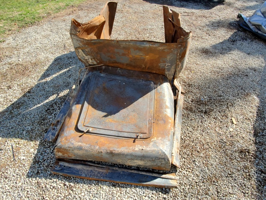

I am trying to decide looking the the photos if it is rust/exposure or has been in a fire? Kinda look like the panels have been thru a fire. If that is the case, could affect the work-ability of the metal.
Herb Iffrig
- Posts: 1775
- First Name: Herb
- Last Name: Iffrig
- Location: St. Peters, MO
Re: Update: Pics of my 13 Roadster Sheetmetal. Hammer/Dolly Set to get; everyone else's favorite body working tools?
My first thought was that it had been in a fire too.

I think I have seen that before. Looks like Warren’s roadster from Knoxville. Hope you can save it. Dan

I've been seeing what others have been using tool wise. I dont think I'll buy a set so to speak. Im going to look for some used tools that I need first since swap meet season is upon us. And will go from there. But yes, your right, I only need the tools for specific sheetmetal work on early Ts.
Dan, Mark, Herb: yes it was in a fire. Dan is correct, its Warren's old 13 roadster parts I dug out of the carnage of his garage.

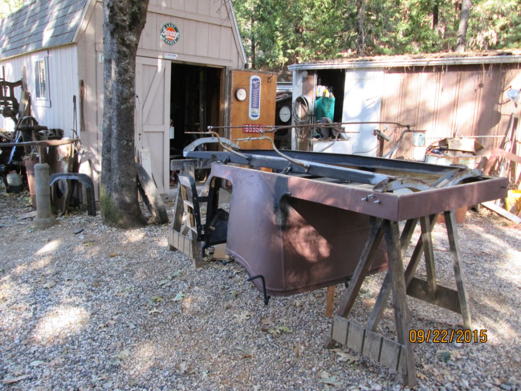

For a little comparison, I think I will post a few before and in process photos of my 1915 runabout. Mine wasn't in a fire, but I have restored panels and fenders from fire damage before. And my body had suffered from an attempt a few decades back by someone wanting to build a bucket T hot rod. Along with some rust-out (not bad, but enough) took a lot of work to fix it up to decent. I don't have many pictures of my fenders or side aprons, but most of them were in much worse condition than the body was.
Most of my project are parts rejected from other people's restorations. A lot of it is done now, and I just need a few things to get it put together.
It can be done! And I think you can do it with yours!

Two more things I forgot to list as other tools:
The fire tool, it damaged your car but it can be used to anneal sharp bends before straightening, and used to stretch panels.
Though it does not apply to these panels since you have access to both sides, a stud gun/welder is better than drilling a hole and inserting a sheet metal screw. With a stud gun I use a lever instead of a slide hammer for better control of the pulling force.
