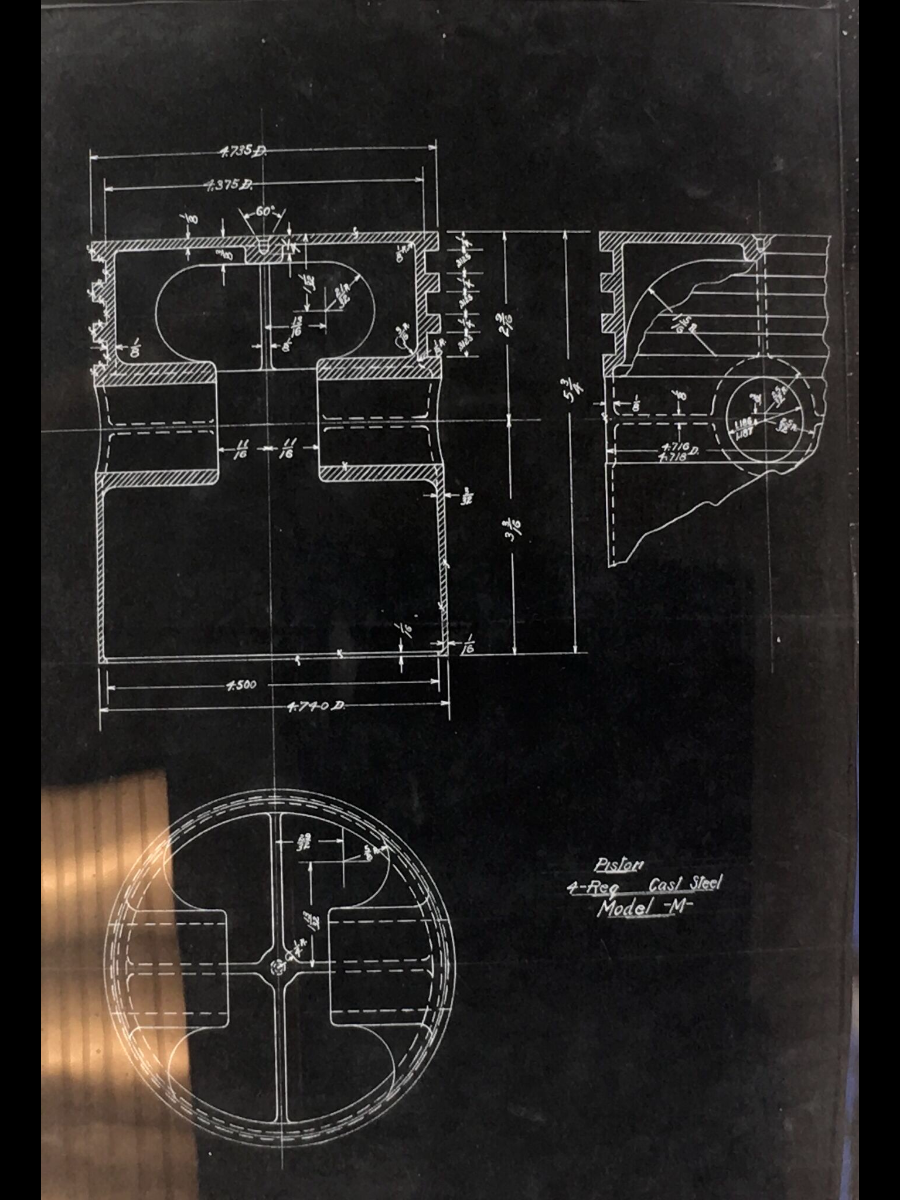

First, this piston drawing has a maximum OD of 4.74", matching the 189 cubic inch racer used in the 1911 Alonquin Hill Climb. It's labeled Model -M-:

Next, Model M piston ring. It shows a "grinding size" of 4.75" OD. What i don't know is if grinding size equates to cylinder bore, or if it would be a bit larger or smaller than bore?

"High compression" is of course a relative term. Many factors come into play. The size and shape of the head's combustion dome is one of them. These cars were built before significant developments were made in the shaping of the combustion chamber in total. How close the piston travel is to reaching the top of the cylinder is another factor ('20s Chevrolet for example had a flat head surface and the piston reached to about an inch below the top of the cylinder). I would imagine that your "M" model has a piston travel that just tops out barely above the top of the cylinder like an early model T (how many here are familiar with the early "curved top" pistons?). It would appear that based upon the normal standards of the day, that would be a rather high compression, albeit without the shaping developed later. It should be noted here that the generally accredited developer of combustion dome shaping was none other than Harry Ricardo, manufacturer of the Ricardo heads for model T Fords! The Haibe and Giant Power heads were licensed knockoffs, but also his design. For many years, other automobile manufacturers had to pay royalties to Harry Ricardo to use his dome designs. Chrysler's famous "red heads" in the mid '20s were among the first American marques to do so, and helped establish the new name and former Maxwell as an industry leader.
(Was that a rather wordy "minor comment"?)
The head gasket does need to be cut and formed larger than the bore to allow the gasket to squish and not be hit by a top reaching piston, or burned even by the burning gasses of a lower reaching piston.
I find those rings very interesting indeed. I do not know whether I could find them easily or not? However, I have a bunch of very old genuine new-old-stock piston rings, most of which I have no idea what they fit. Among them, are a few rings (maybe sets?) of rings tapered in that way. I think I may also have a few used such rings that I took out of an early T engine?
