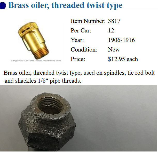

Not sure what "time" you are referring to (production or repro's)- but early spindle bolts where threaded for brass oilers. https://mtfca.com/phpBB3/viewtopic.php?t=4474
by Scott_Conger » Wed Jun 12, 2019 2:56 pm
They are in fact different
'09-'14 screw-in oiler spindle bolts are offered by suppliers for '09-'17. Note: early spindle bolts were a couple thousandths larger than later ones and if you purchase one of the repros that is CORRECTLY made, you will need a slightly larger reamer than the line-reamer the suppliers offer. Mine is .504"
'15-17 man-hole oiler spindle bolts are not available
'18-'27 spindle bolts come with flip top oilers
Zerks/Alemites will fit in those too
In looking for info on the Spindle Bolts also found pictures of different designs http://www.mtfca.com/discus/messages/59 ... 1451597403
By Dan Treace, North FL on Thursday, December 31, 2015 - 01:08 pm:
Comparison of original Ford (left) and modern avail. repro king pins (spindle bolts).
The picture I inserted with the threads was removed from a front axle that was laying in a field a few years ago- (how long was it theer? 50 year old repro?). It has no groove around the oil outlet but one near the top.

How quick we forget. I have purchased several of the ones you show with the brass twist oilers. My mind went back to what I bought back in the '60s. I still have grease cups in them. They may have been from J. C. Whitney. It seemed the bushings wore quickly in them.
By the way, the spindle bolts now turn about an eighth of a turn after adding the penetrating oil. I'm not sure how long it will take to soak to the bottom bushing. It sure steers easily with the bolts turning in the axle and up on stands.
Thanks for the input.

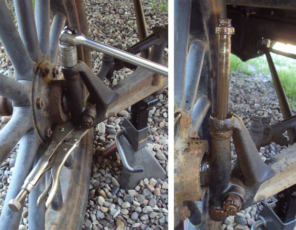

Don't turn the top to loosen it a bit until the bottom nut is partially removed. In case you forgot the end of the bolt is threaded to the bottom part of the axle.
Re: Just when you know everything.
Post by Rich Eagle » Sun Apr 18, 2021 3:45 pm
Yes, you can see from the top picture the nut is completely off.

I have been patient and working on some other frustrating projects while the oil does it's job. However I notice a few minutes ago that the lower bushing is turning with the spindle bolt. The alternative may be to cut the bolts at the bushing flange to save the axle and the spindles. Patience lost for today.

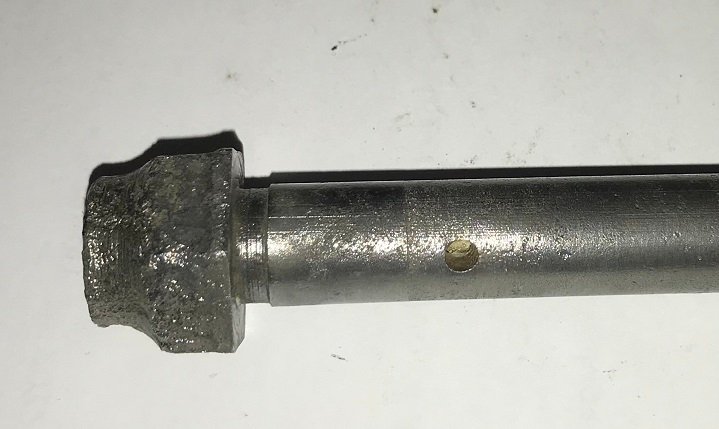

Post by Rich Eagle » Wed Apr 28, 2021 6:23 pm

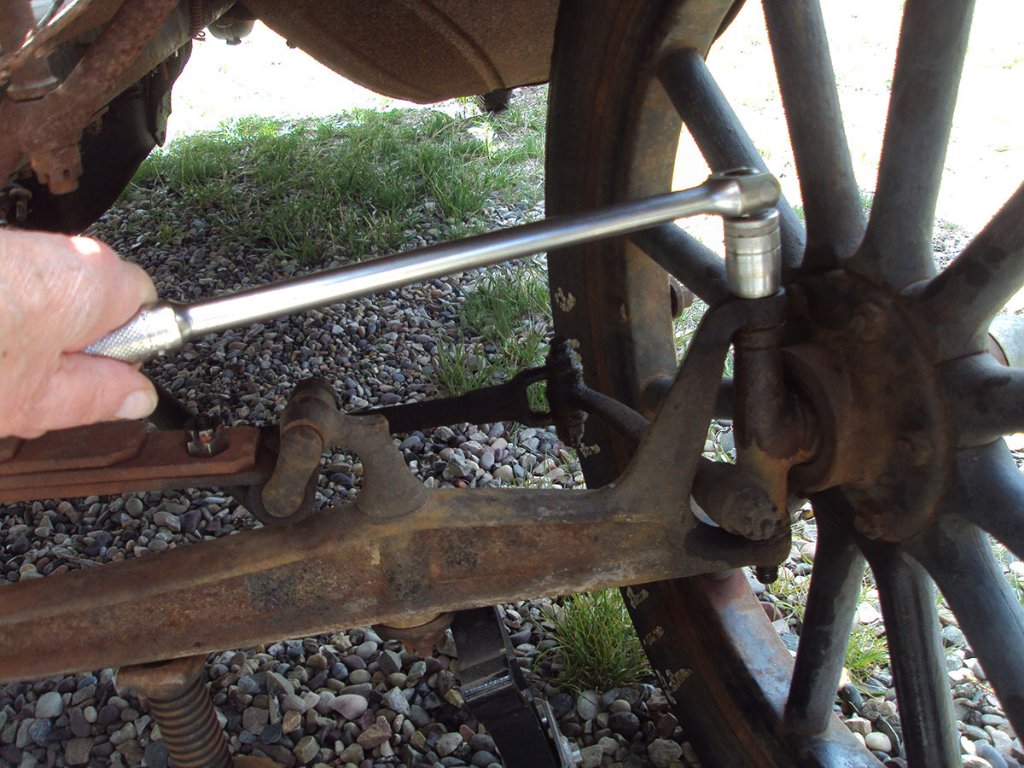

Today with the help of vice grips (one side) locking the lower bushing I was able to turn and remove both spindle bolts. Soaking for 12 days did the trick. Good threads at the bottom let the bolts move up as they were turned.

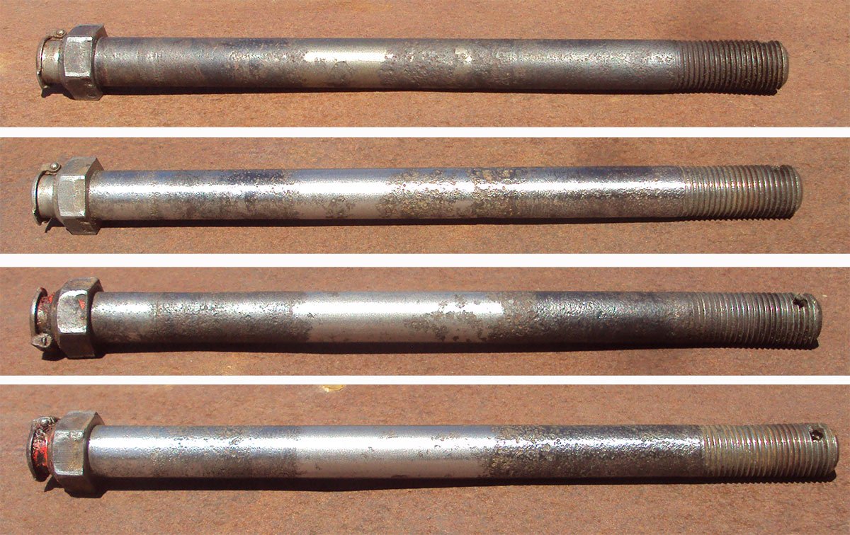

I see that the bolts were old originals when I installed them 8 years ago. One is Ford script. They measure .499 and .498 half way down and .497 to .491 where the bushings ride. Pretty good for used bolts.
They are shown here before and after cleaning. There was a dark brown tar on them. I suspect old oil and rust from water soaking in and condensing inside the spindle body. More frequent oiling should have eliminated this problem. Being kept outdoors also contributed.
The spindle bodies didn't want to come out of the axle. The bushing flanges were tight. I scrubbed them with solvent in place. They didn't seem to wear much during regular in town driving.
They have plenty of oil now and I will try to remember to oil them more frequently.
