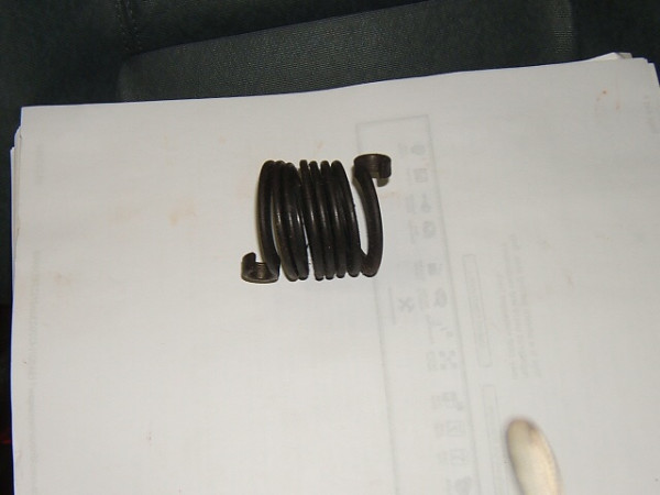

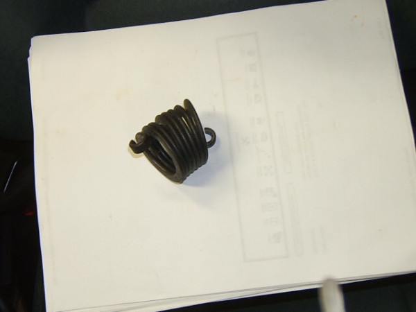

When I bought my T back in 2001, the buyer, who had bought my T in1996 and passed away from cancer in 2000, had installed a 12v system. When I got it home, I immediately converted it back to a 6V system. When I rebuilt the engine in 2010, the bendix spring had been slammed so hard by the 12v system, it was deformed so that the bolts were on opposite sides of the starter shaft and he brass ring gear had to be replaced.
The bendix spring is designed to return the bendix gear back to its’ proper starting point. The first picture is what an undamaged spring looks like with the bolts on the same side. The second 2 pictures are of the damaged spring that I found in my engine that had been deformed by high pressure caused by a 6V starter being connected to a 12v system and subjected to higher torque than it was designed to take. This kind of torque can also damage the teeth of your brass ring gear. Jim Patrick

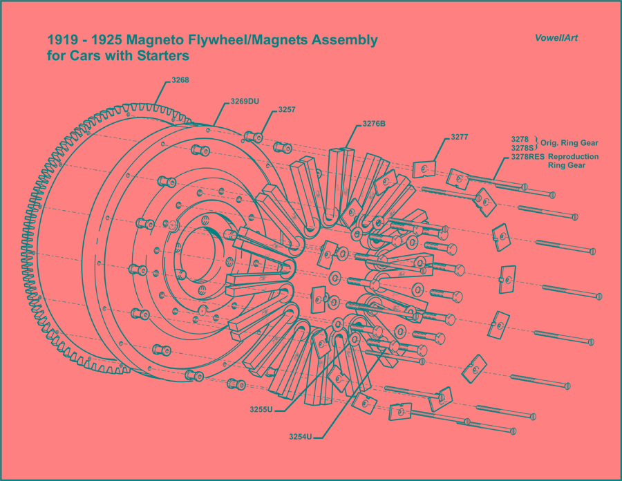

Jim, I agree with your post but just what and where is the “brass ring gear”?
Tony Bowker

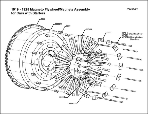

The ring gear, #3268 in the diagram, is mounted on the heavy flywheel on the side opposite the magnets. The bendix gear engages in the teeth of the ring gear and is what turns over the engine to start the car. Jim Patrick

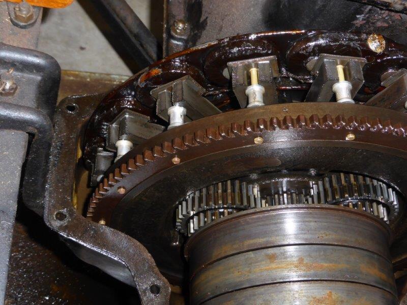

Ring gear is steel, but the bolts are brass. However, even the steel parts are not immune to injury caused by 12V as noted above.

I never knew the flywheel ring gears available today, were steel. I purchased two ring gears in 1971 (one as a spare) and could swear that they were both solid brass, because I recall thinking how nice they looked and wished there was some way to show them off inside the transmission. Am I imagining this? Does anyone else remember when the ring gears were brass? When did they change to steel? Isn’t this a detrimental change? I assumed they were brass because if one or more of the brass gear teeth were sheared off inside the transmission, they will do a lot less damage than broken steel teeth. Jim Patrick
