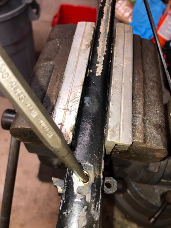

Re: Removing the handbrake lever
Remove the assembly and put it on an anvil or vise or other sturdy surface to hammer the pin out. It is very difficult to get the pin out without a hard surface to keep the hammer impact energy from dissipating where it should not be.

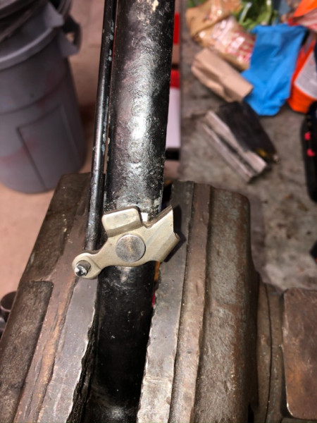

- Posts: 4045
Bench work job to replace worn pawl with new and new bearing rivet.
