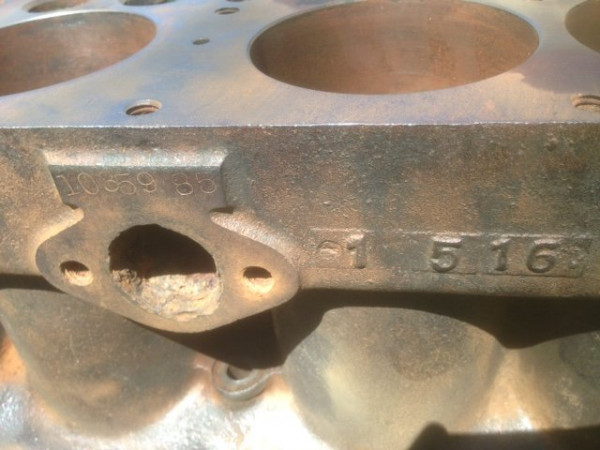

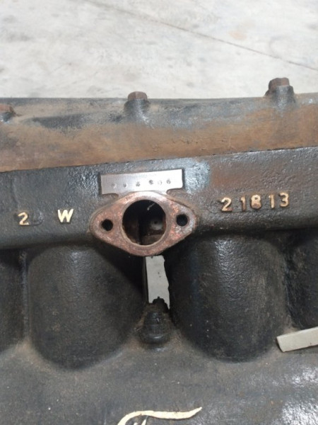

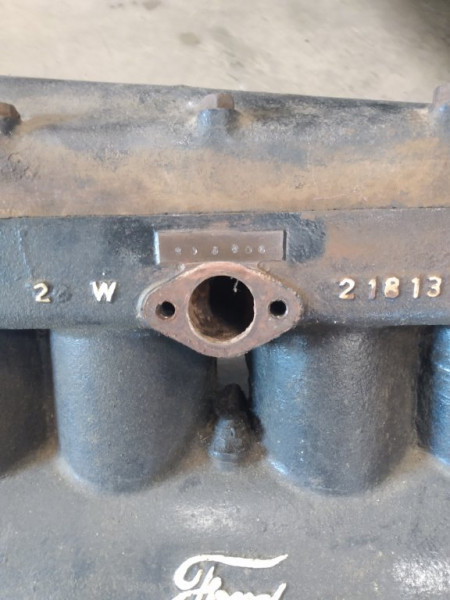

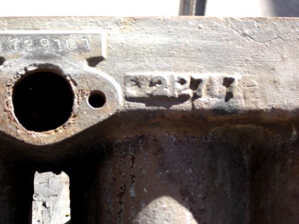

So I listed a 13 engine for sale and put in the ad that it had been restamped-. It was then brought to my attention that the number pad itself was rather large. It infact is. I have a 12-13-14 to reference to and those do have the smaller no.pad. I don't understand how it can have the cast no. On the block and then have the lg.no. pad. Thank you

Did someone remove half of the 3?

Someone here listed a 12 block for sale. When I examined it, the pad had been shortened, it didn't have the threaded freeze out plugs, and other things that made it a non 12 block.

I have another engine the block reads 10-27-13. The. Small no. Pad says Jan. 14. Other than the large no. Pad on the one for sale they look identical. I can't get over the cast no. On the block. Also- my other engine has thread in freeze plugs; the one for sale. Does not

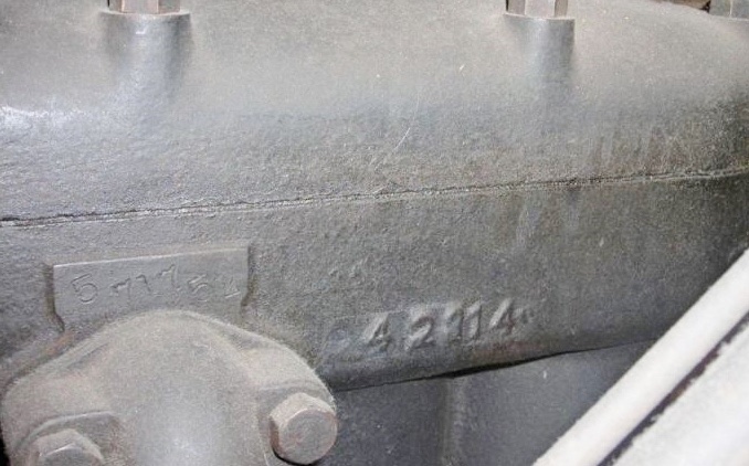

My guess is when the number boss was milled away to remove the serial number, then 'somehow' the 8 in the 1918 block loss half of its loops to become that "3".

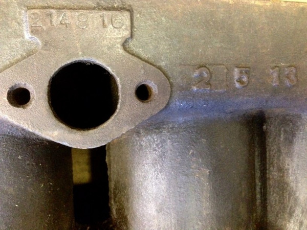

Here is an 1917, and shows the proper length boss for the number stamp, an earlier block like this 1914 has the correct small length boss.

I'm slow; but I just couldn't understand how every one was coming up with 18. I'm just not a deceiving person. Just simply grind the 8 and there's a 3. Throw a low head on it and there you go. I apologize to every one I did not mean to try and sell a deceiving part.thanks everyone

As mentioned above, the engine number boss on the block in question is of a later style, beginning in late 1915 or early 1916. When the serial numbers hit the one million mark the extra digit made for a tight fit for the the guy stamping in the numbers. You can see what an original 1913 number boss looks like and the reason why the boss was lengthened in the 1916 photo.

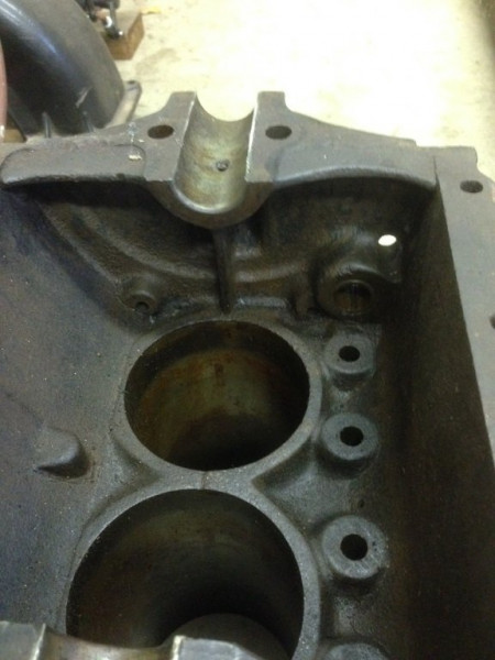

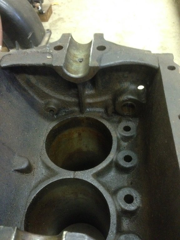

There are other changes during 1913. Early 1913 blocks had a single reinforcing gusset supporting the rear main bearing while later in 1913 this was replaced with a pair of gussets.

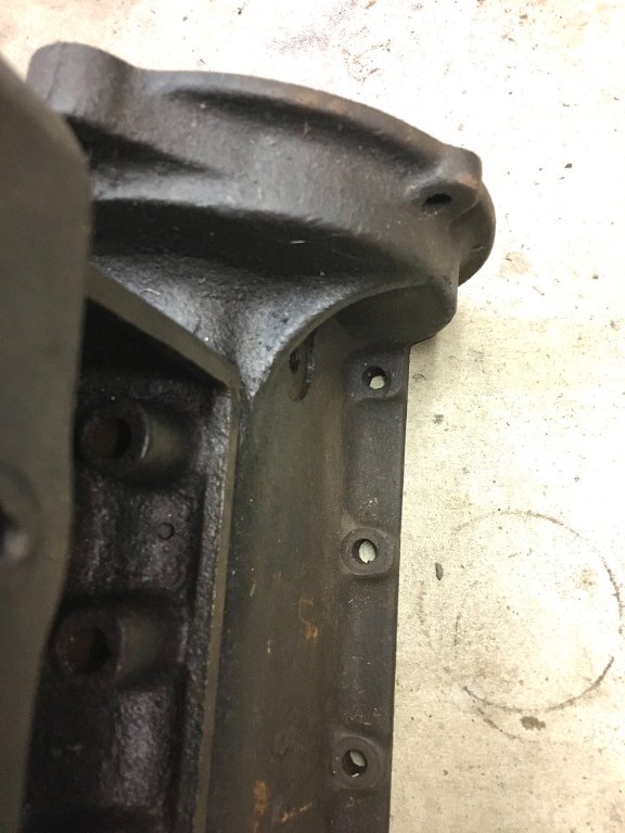

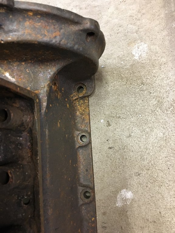

One other change is on the block flange that bolts to the pan - on the right side just back of the front cover. During 1913 the first bolt hole got a reinforcement, which remained there through the end of the non-starter engine production. However in early 1913 blocks this change had not taken place, as pictured below. The non-reinforced bolt hole is from the Feb 1913 block pictured above and the reinforced block is a 1918.

The inside the crankcase photo of the 1913 block shared by Rich C gives a good view of the earlier rounded 'setup' block inside the crankcase. That detail also changed around late 1913 or early 1914. Practically all model T blocks from very early had those two 'setup' corners inside the crankcase, opposite the cam, one in the front half, one in the back half. I don't know exactly when it began (other than fairly early?), but those were carefully placed inside the casting molds as a setup reference for the first machining the block would receive after it had cooled. All the top and bottom smooth areas were first referenced from that cast corner. Early blocks, including that 1913, the setup corners were rounded. Sometime early in 1914, they were squared off, and made slightly smaller. My late 1913 block also has the rounded setup corners. The corners had to be carefully placed in the patterns and the molds to perform their magic. All the 1915 blocks I have looked at close enough, and most of the 1914s I have seen, had the later squared setup corners, as have nearly everything later I have looked at.
An interesting side note. I did once (at a swap meet I think?) see a 1914 block that had one of each (square and rounded) setup corners in it. The blocks were cast in an assembled bunch of multipart molds. Many of the mold pieces were reusable, including most of the external areas of the block, and the inside of the upper crankcase. These would be reused through as many heat cycles as they would remain viable. Eventually the molds would begin to breakdown and have to be replaced. A few mold pieces (most notably the inside of the water jacket!) were single use, usually made of sand.
I just found it interesting that the inside upper crankcase molds would be replaced such that both an earlier and later detail such as that would wind up in one engine block. I wonder how many blocks were used with that anomaly, and how many like that may still be around today?
