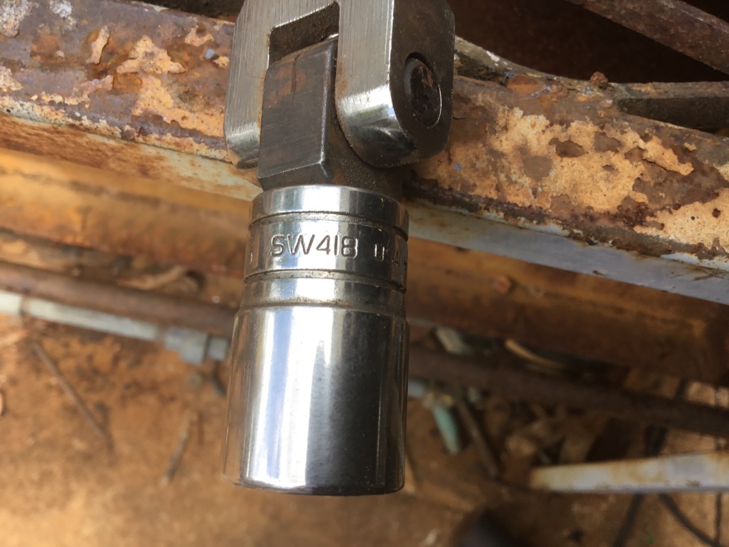

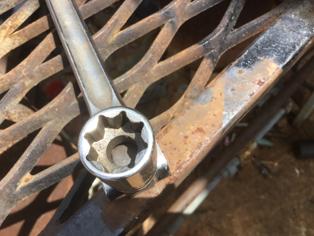

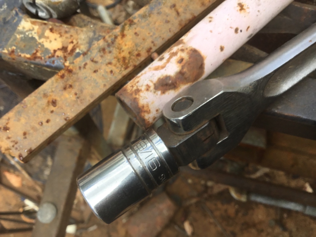

BobShirleyAtlantaTx
- Posts: 361
- Joined: Mon Jan 07, 2019 12:44 am
- First Name: Bob
- Last Name: Shirley
- Location: Atlanta Tx
Re: which socket main bearing cap
. This is a Snap-on, probably easy to find on line or in your area.

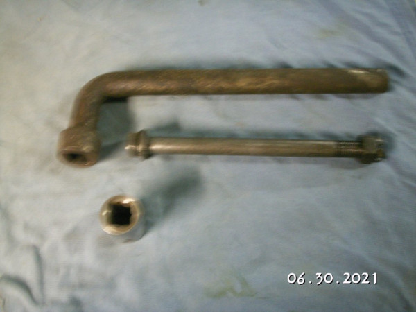

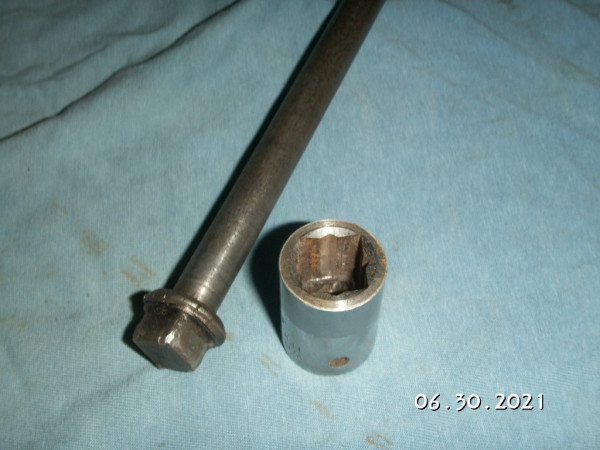

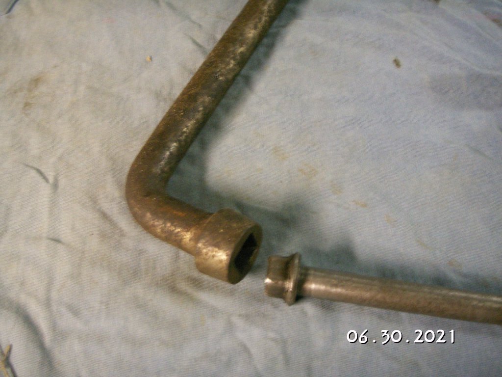

TFan
- Posts: 415
- First Name: Jim
- Last Name: Riedy
- Location: Sandusky,Ohio
Here you go, the socket is a Wright 4fs18 and the wrench is a Mossberg 622 more than likely a copy of a Ford tool. Jim
