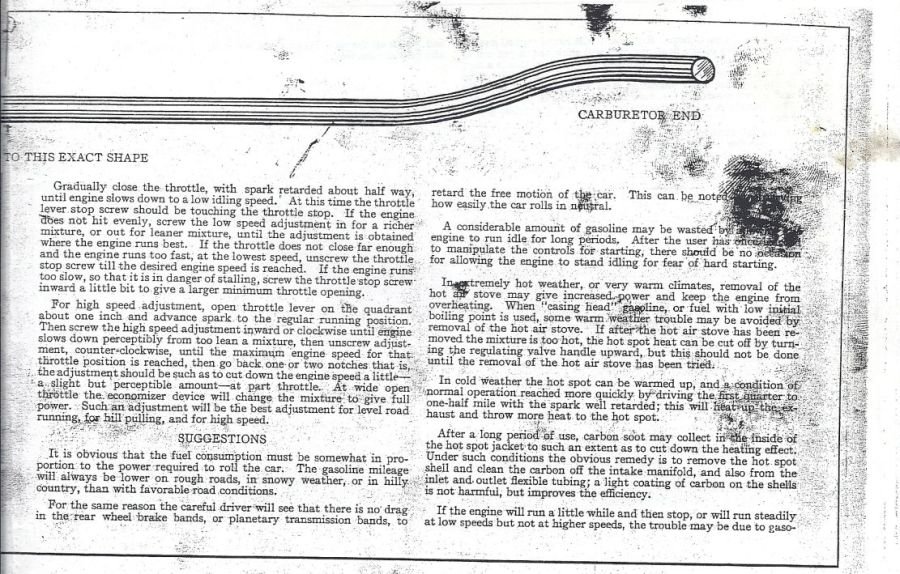

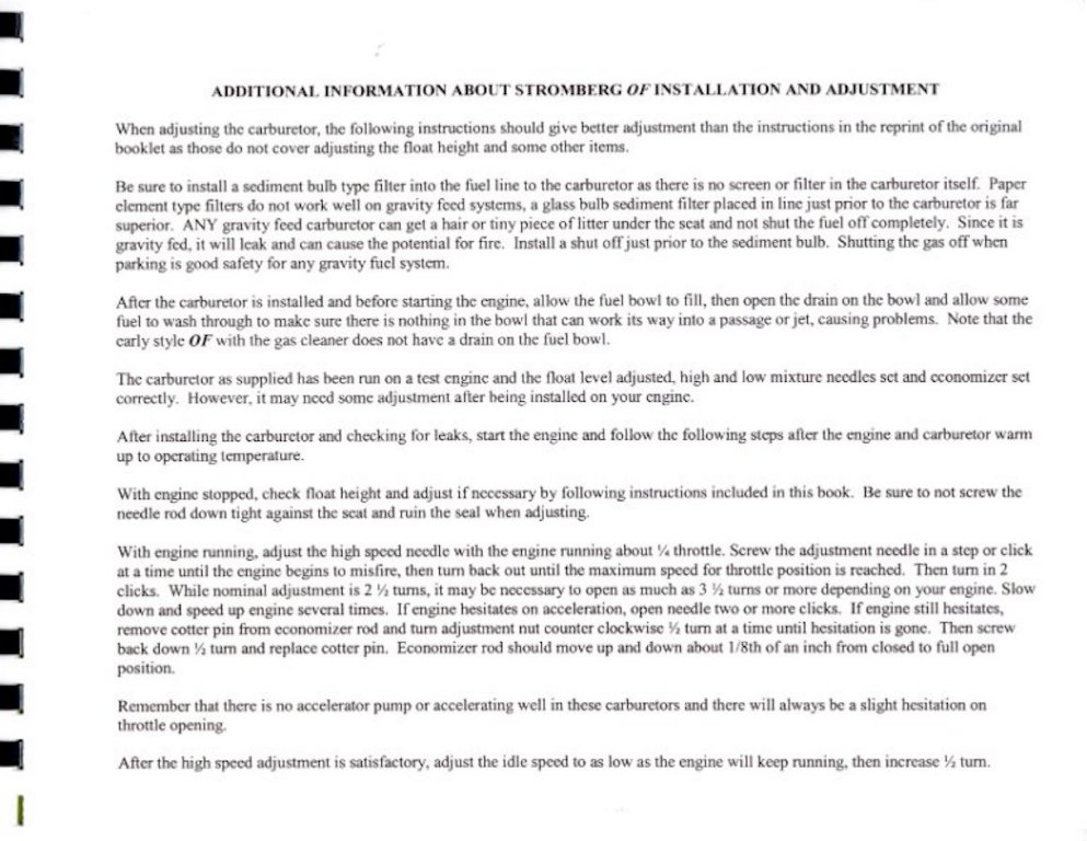

Years ago, Stan sent me a booklet that included a reprint of the original period Stromberg literature. The booklet also contained four pages of original material from Stan based on his extensive experience with this carb. Here is a copy of the original Stromberg literature from Jay Klehfoth, along with scans of the four additional pages added by Stan. Hope these help. :)
stromberg_of.pdf
(408.52 KiB) Downloaded 166 times

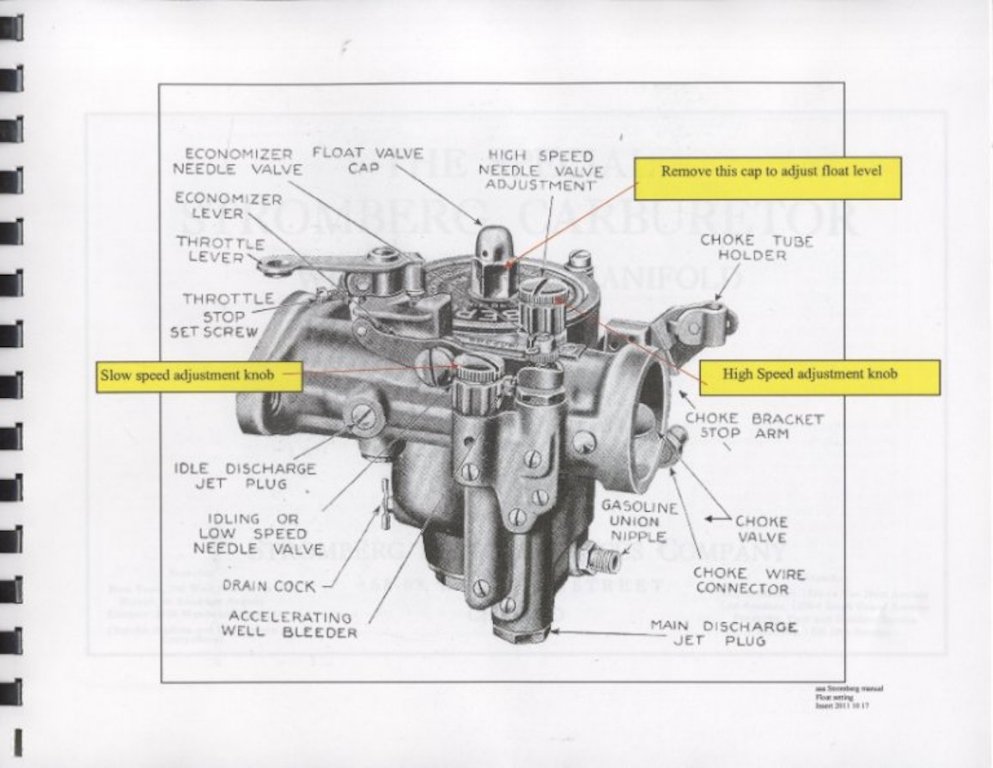

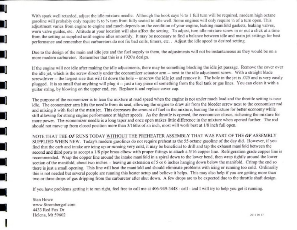

Here are the four pages rotated and enlarged. You sacrifice a little sharpness when you blow them up, but they're still readable.

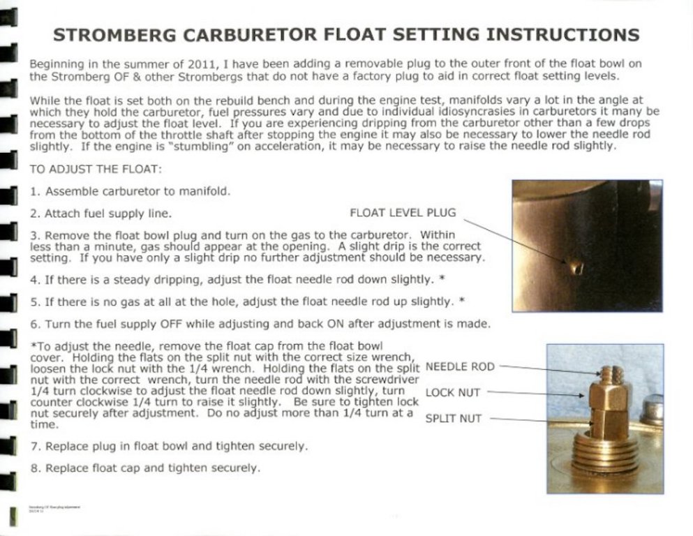

While the OF made a big difference in "Oomph !" ... it was always
part of the engine build design, combined with the C-race cam, SCAT
crank, and Z-head, at high speed it stumbles. Feels like a miss. But
4 months of chasing around the ignition side has left me fairly certain
that the OF is my culprit, and I'd like to have a strong sense of how the
thing works exactly, to then field fiddle with it, to find its sweet spot.

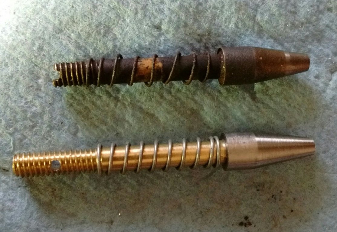

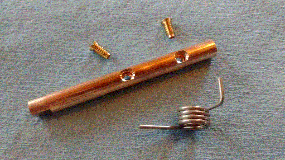

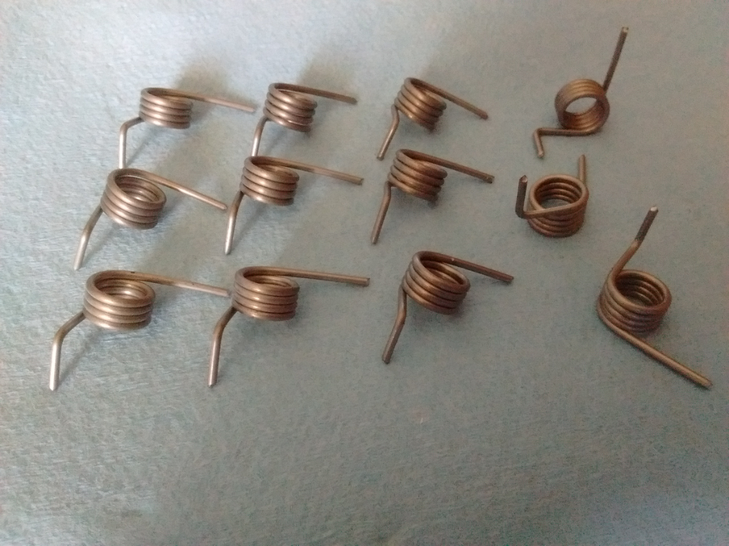

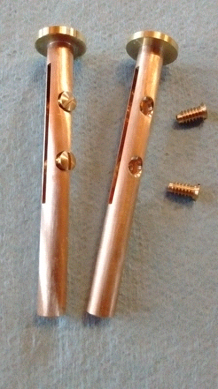

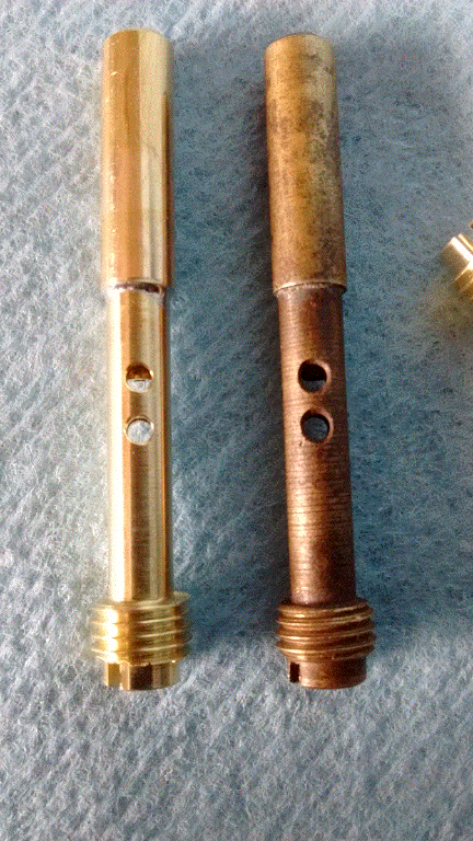

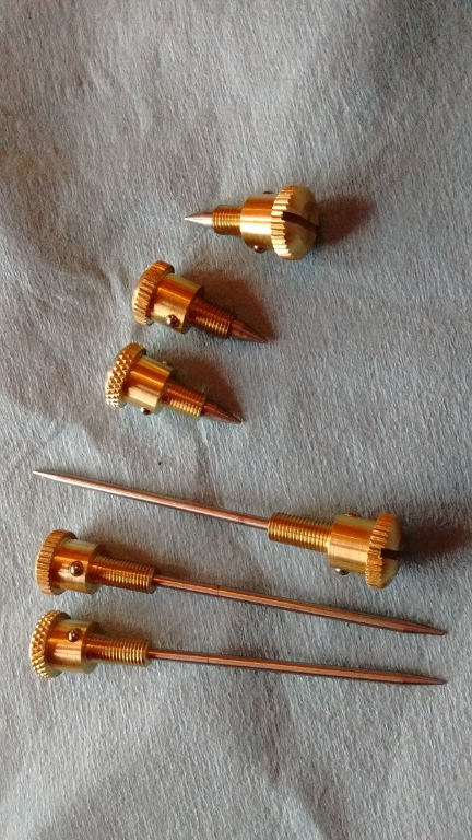

No one making specialized parts for them?
Do you mean specialized parts like these?:
Last edited by Scott_Conger on Fri Aug 06, 2021 10:35 am, edited 2 times in total.
Posts: 6596
Re: I'm No Stan Howe

Harry Lillo
Posts: 327
Joined: Fri Jan 04, 2019 10:18 pm
First Name: Harry
Last Name: Lillo
* REQUIRED* Type and Year of Model Ts owned: Speedsters, racers, depot hack, coupe
Location: Calgary
Post by Harry Lillo » Fri Aug 06, 2021 12:10 pm
Scott,
Are these parts available for purchase from you?
Harry
SurfCityGene
Posts: 681
First Name: Gene
Last Name: Carrothers
Post by SurfCityGene » Fri Aug 06, 2021 1:03 pm
Scott, Thanks for showing some of your fabulous work!! You do amazing stuff with these little parts and I hope you continue to make these available!

The 'stumble' could be caused by the float level being very slightly out of adjustment. I us a Stan Howe rebuilt OF and all the settings given by Stan for slow speed and high speed adjustments when it was first installed only required minor changes to get it running as I wanted. Subsequently on 2 occasions the float level has required very minor adjustments to eliminate a 'stumble'. Try raising the needle 1/8 turn, if no improvement go a further 1/8. It fixed it for me. I had looked at all the other adjustment with no success until I had a light bulb moment and looked at the float level.
I hope this helps.
Nigel Hugo.

Looking good Scott. I didn't know you were fabricating the OF parts as I've been out of touch lately. Do you do the throttle arm/cam and the economizer arm pieces too?
Posts: 6596
Post by Scott_Conger » Fri Aug 06, 2021 9:48 pm
Bruce
I don't make those though I'm constantly designing tooling in my head to fold them up efficiently...not there yet, though!

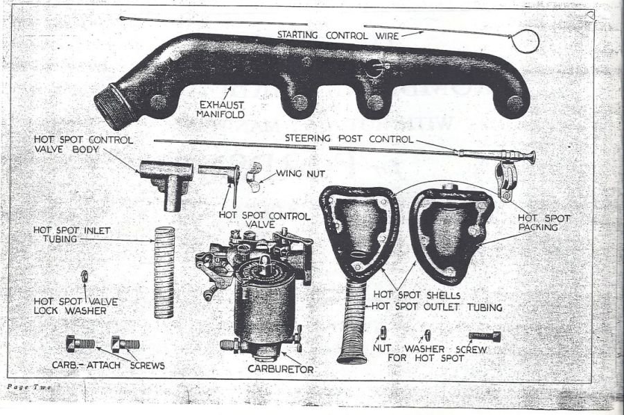

ModelT46
Posts: 1649
First Name: Darel
Last Name: Leipold
Location: Excelsior MN
Post by ModelT46 » Sat Aug 07, 2021 2:57 pm

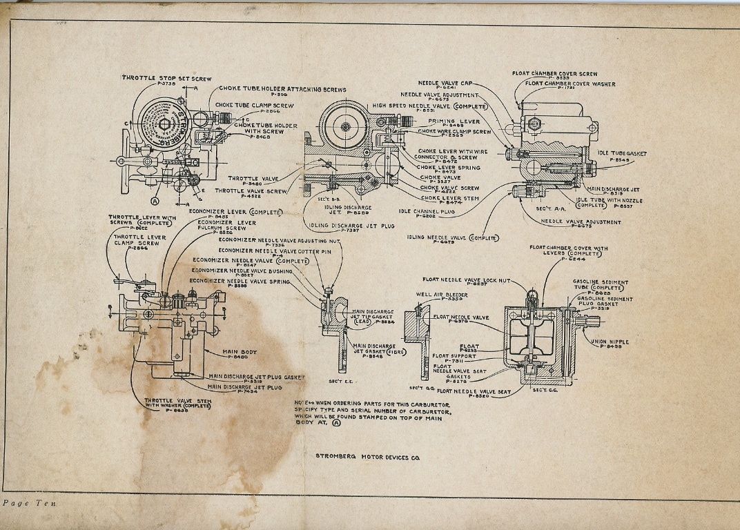

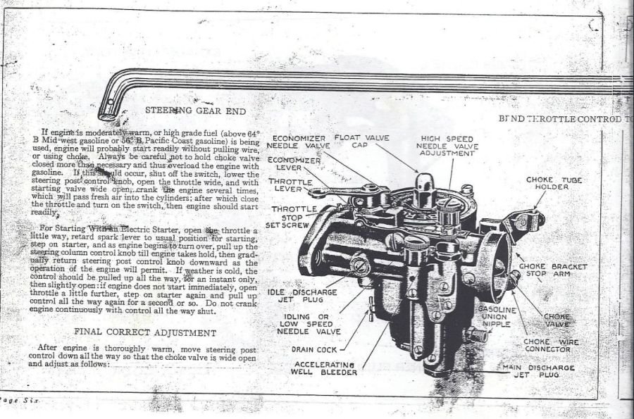

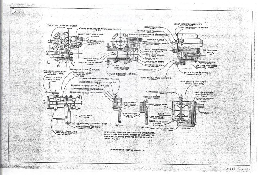

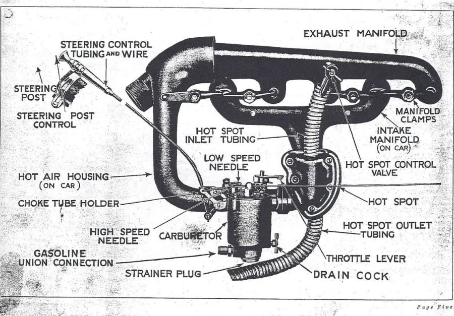

From an original 1923 booklet.
ModelT46
Posts: 1649
First Name: Darel
Last Name: Leipold
Post by ModelT46 » Sat Aug 07, 2021 3:00 pm
another page
ModelT46
Posts: 1649
First Name: Darel
Last Name: Leipold

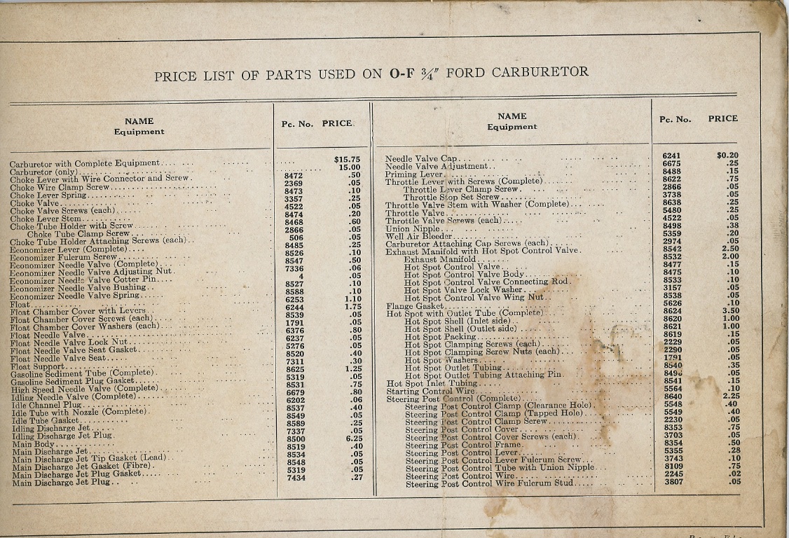

Post by ModelT46 » Sat Aug 07, 2021 3:08 pm

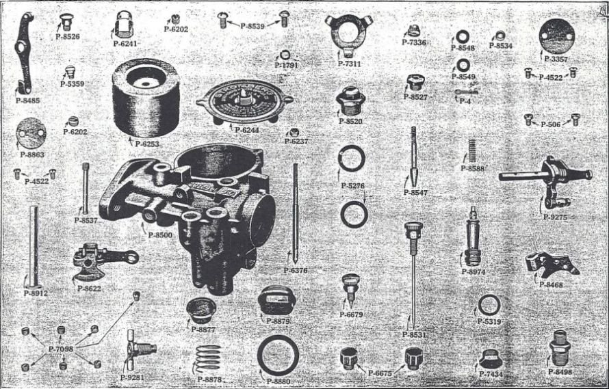

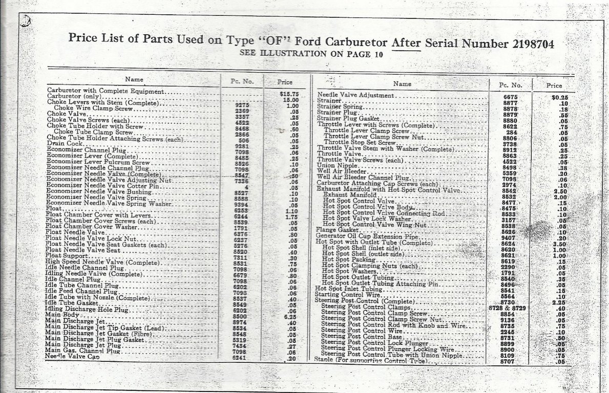

parts page

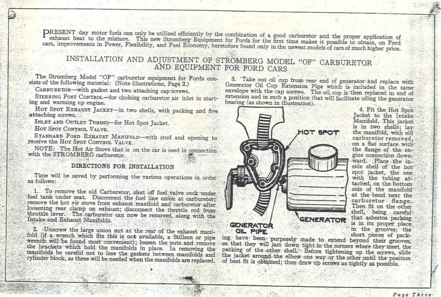

BHarper
Posts: 242
First Name: Bill
Last Name: Harper
* REQUIRED* Type and Year of Model Ts owned: '14 Touring, '20 TT Farm Truck, '24 TT Depot Hack, '24 Coupe, and a 1914 Metz Model 22 Torpedo Runabout
Location: Keene, New Hampshire
Post by BHarper » Sun Aug 08, 2021 8:39 am

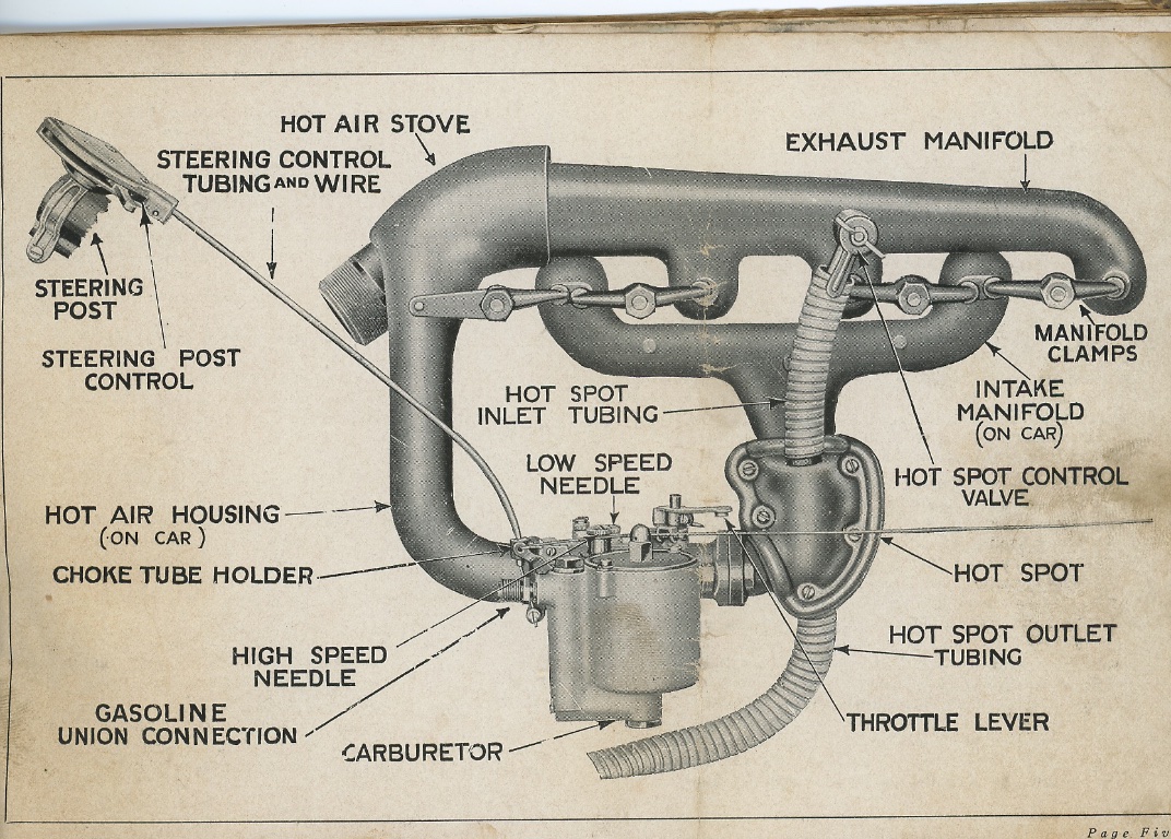

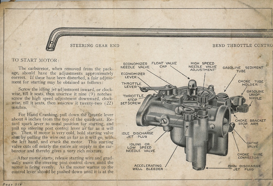

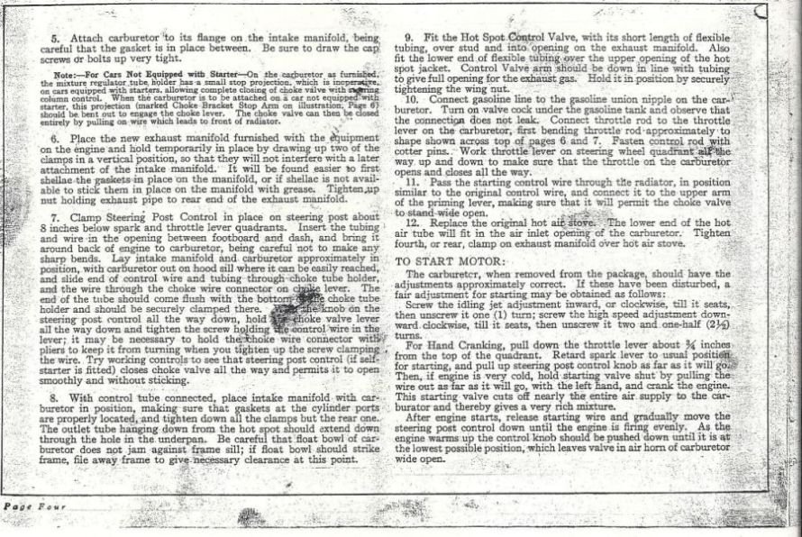

A few pages from an OF pamphlet which, as I understand it, was supplied with a new carburetor.
Golly, it is a real inconvenience to be limited to only five images when, in this instance, there are more pages of the pamphlet to be shared. Bill
More to come.
Bill Harper
BHarper
Posts: 242
First Name: Bill
Last Name: Harper
Post by BHarper » Sun Aug 08, 2021 8:47 am

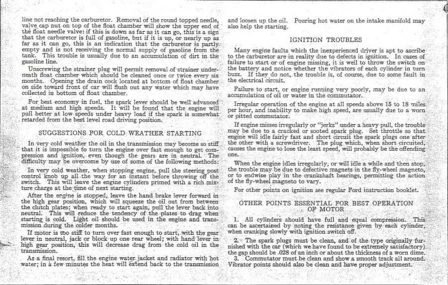

Here are the next pages:
Another batch to be posted. "Watch this space." ;)
Bill Harper
BHarper
Posts: 242
First Name: Bill
Last Name: Harper
Post by BHarper » Sun Aug 08, 2021 9:01 am
And here is the last of it.
Two advertisements from the period:
Bill Harper
