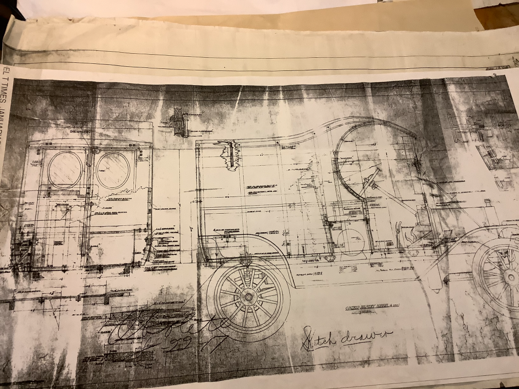

I’m currently building one. I haven’t started construction yet, I’m making up all my body irons and hardware. If you want authenticity contact The Henry Ford Benson research center and purchase the factory drawings. The drawings are $30 each. The main drawing will show dimensions only from the side and only a few from the rear. The construction of the the body is a wood frame with metal skin. Many of the framing will need to be steam bent. The drawings show only the way it looks construction wise but not how it’s framed together( journey such as lap joints etc) I purchased a book on antique car joinery that gives styles of joinery used during that era. The pie wagons were made by Beaudette. If you can get your eyes on some pictures or in person of someone’s 1911-12 Model T body and look at the joinery used that will help you out as well. The drawings will also show the various Factory numbers for all the body irons. There is a lot of body irons on these bodies. The guy in Maine does make some very nice bodies. I looked over one of his delivery cars and although very nice it does not follow the way they were originally constructed. I’ve seen both of John’s Pie Wagons, one of them (regular body) was completely restored from an original using the original as a pattern. The other is a whole complete original body (knockdown version) that was Sold on this Forum. http://www.mtfca.com/discus/messages/17 ... 1303742919

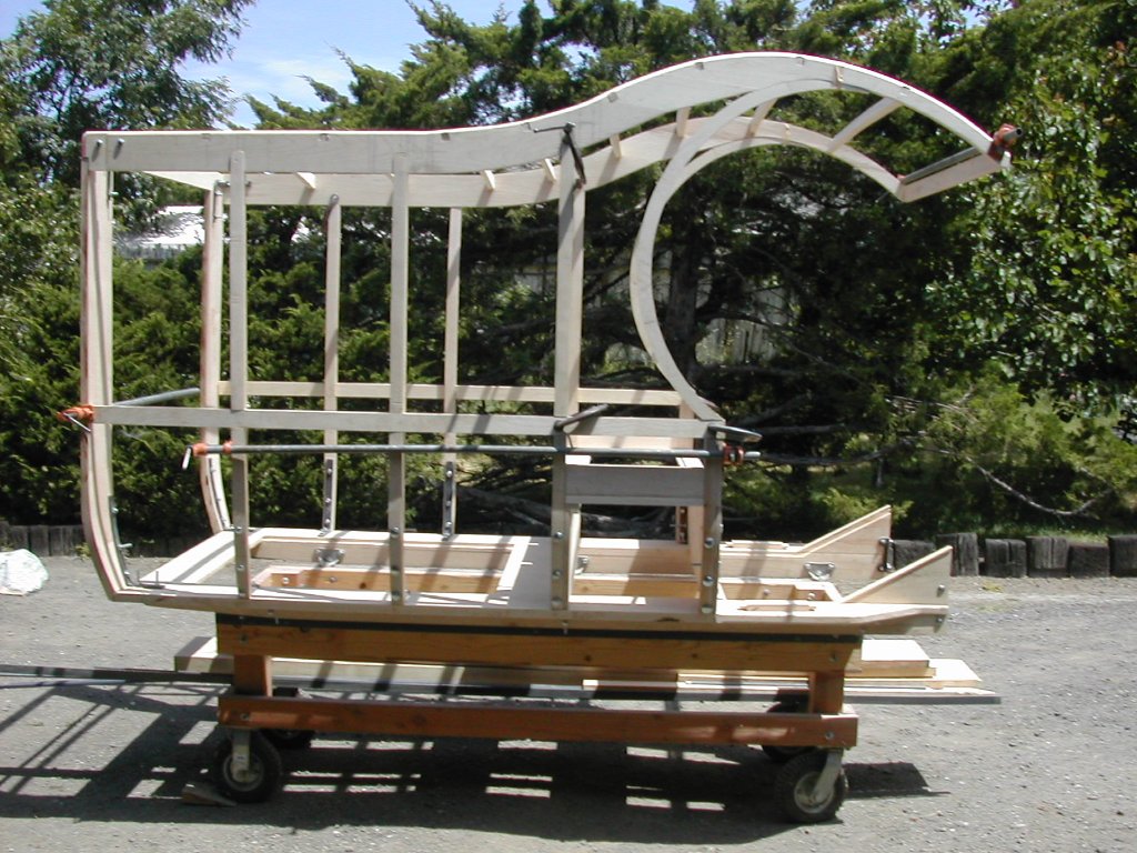

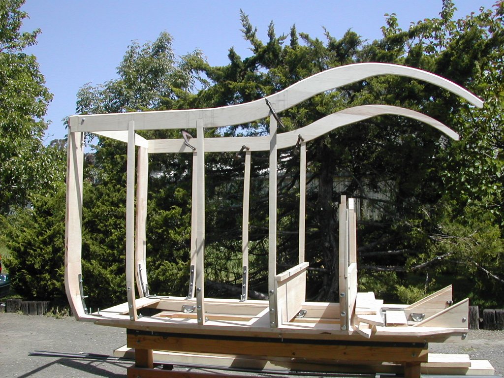

Posts: 3871
Re: help with pie wagon project
Post by Dollisdad » Sat Oct 16, 2021 2:19 pm

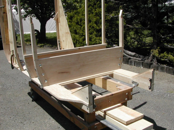

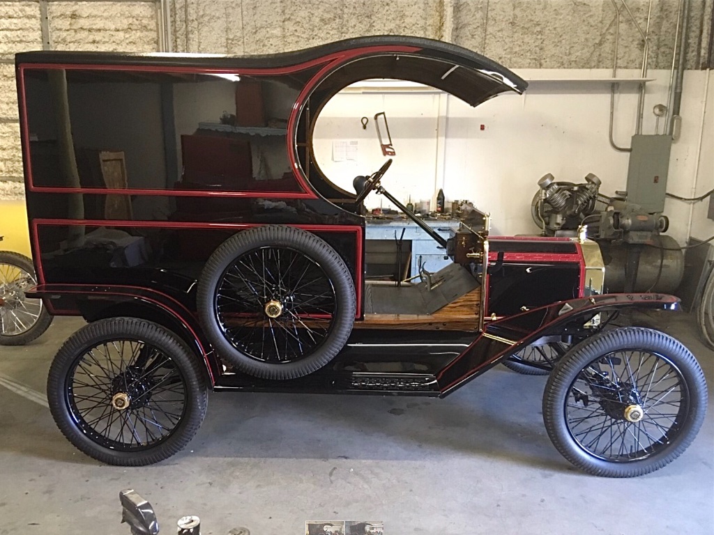

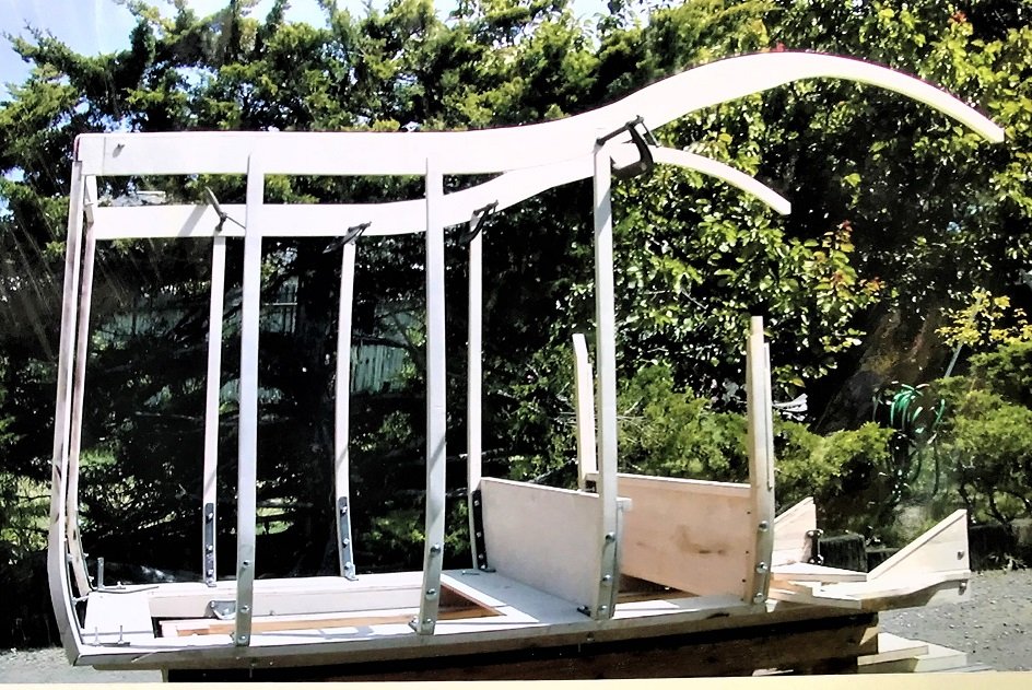

Here’s my 2 cents. This skeleton,
Became this.

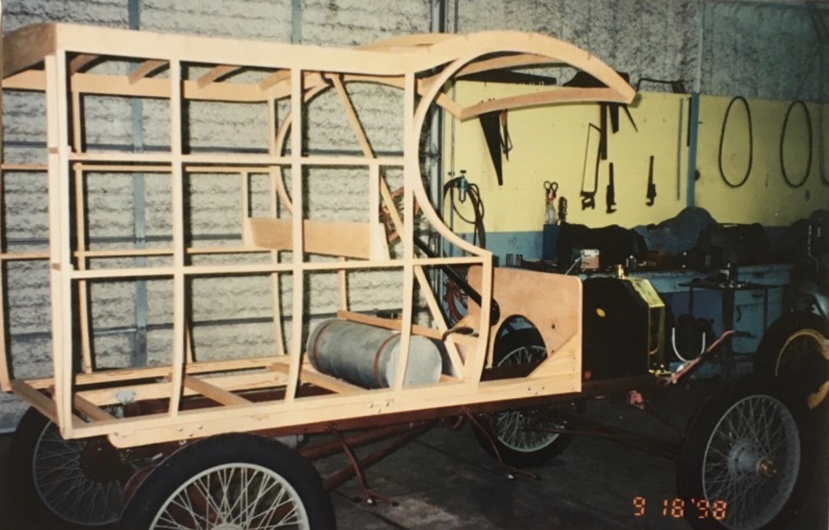

Post by TRDxB2 » Sat Oct 16, 2021 4:01 pm
Have an album full of pictures of the build. Need to take them out of the glossy page protectors and resize/zomm Here are some still in the glossy covers

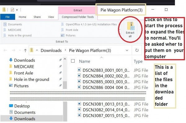

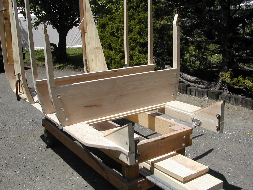

There are about 65 photos that were taken by the builder William Brommer, Castro Valley, CA in 2008. Whats interesting in the build is when things were painted as they were assembled. These photos are in zip files (compressed data file). To download and view on you computer is easy (email me if you need help).
Pie Wagon Platform.zip
(5.89 MiB) Downloaded 129 times
Pie Wagon Frame.zip
(5.25 MiB) Downloaded 114 times
Pie Wagon Exterior.zip
(6.51 MiB) Downloaded 106 times
Pie Wagon Finished.zip
(10.14 MiB) Downloaded 102 times
I added instructions on "How to down load and EXTRACT (expand back to original) the files" down below

Posts: 7310
Post by Allan » Sun Oct 17, 2021 11:28 pm
From Tom's skeleton photo, it would be easy to set the timber backrest to any comfortable set-back and then build the seat base to suit. On my Haigh's chocolate van the steering wheel is right in my lap, and it is way too cosy in there. The second one I built for a customer had the problem solved.

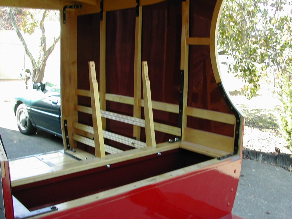

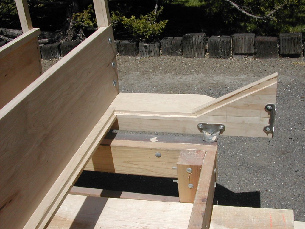

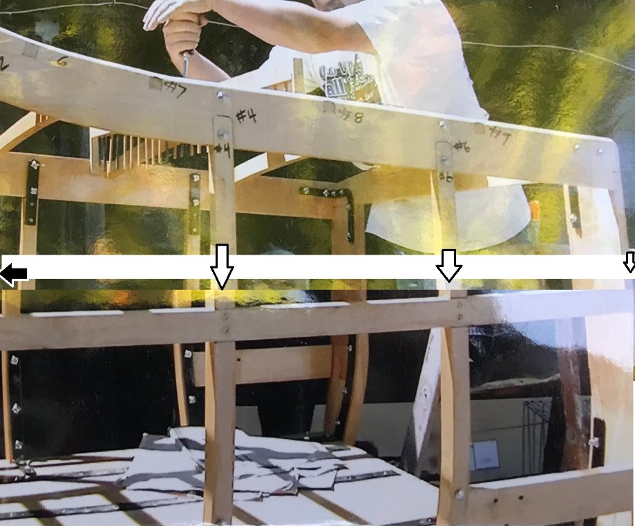

Posts: 6607

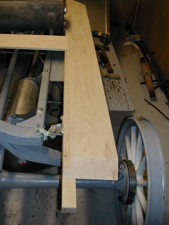

Post by TRDxB2 » Mon Oct 18, 2021 12:00 am
Some of the frame.zip pictures around the seat position

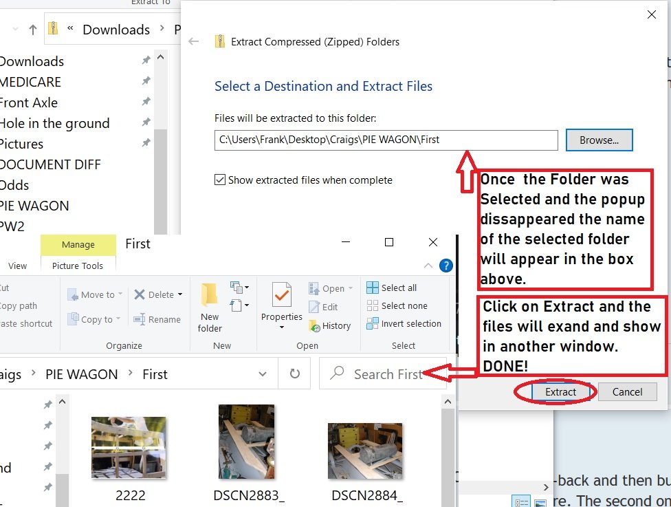

Posts: 6607
Post by TRDxB2 » Mon Oct 18, 2021 1:20 am

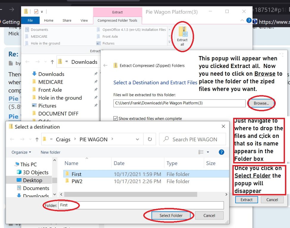

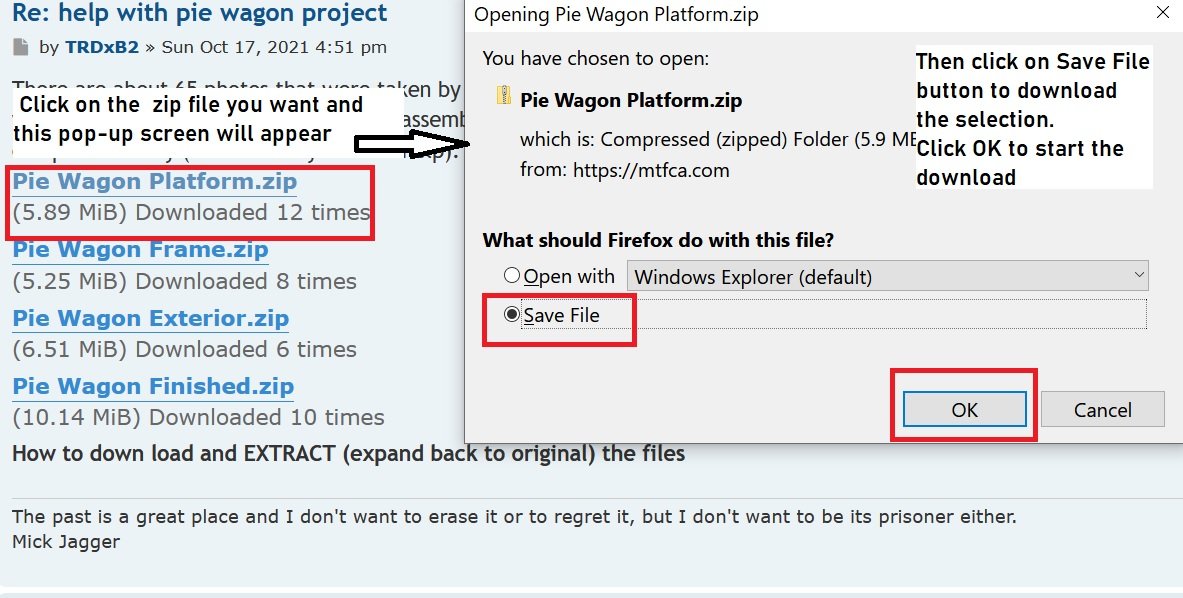

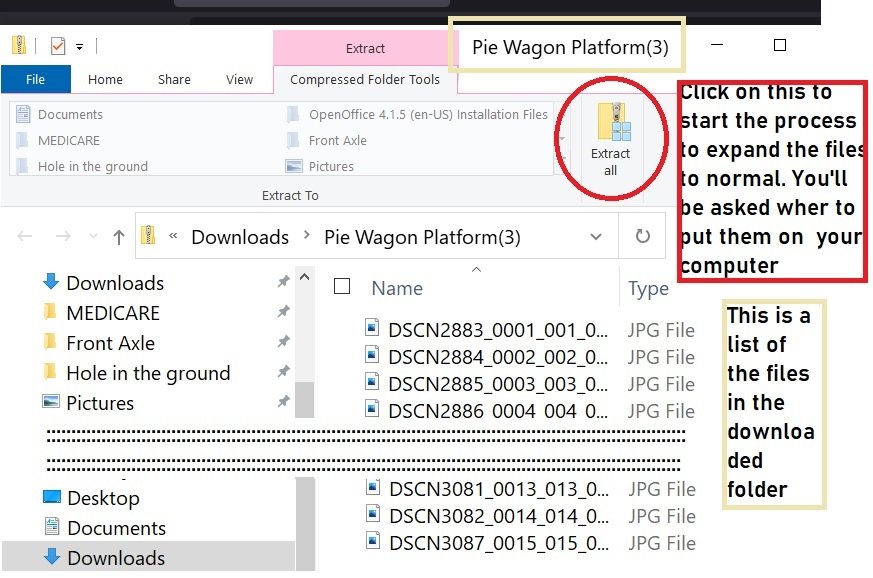

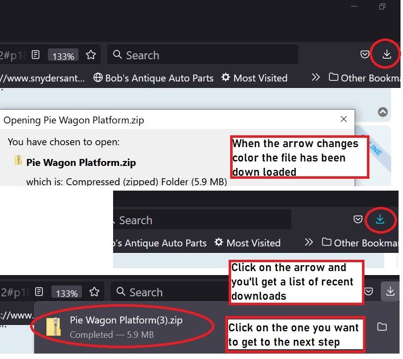

How to Download a Zip File and un-zip it. A Ziped file (or Folder) is the original data compressed into a smaller data package. Since the Forum software has restrictions on data files (pictures etc). It is a way to get around that and make the information available.
The steps just involve a lot of clicking. These instructions can be applicable to un-zippig folders and files that you may encounter elsewhere.

Post by Tbird » Mon Oct 18, 2021 10:17 am

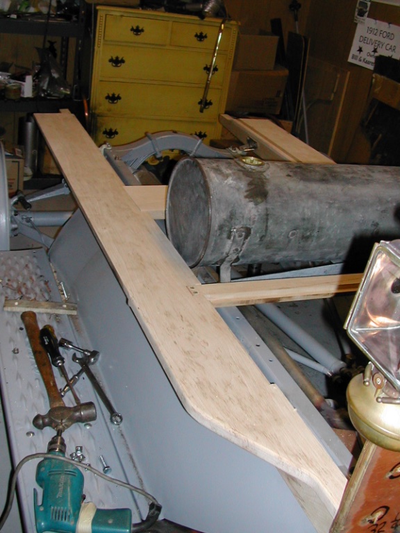

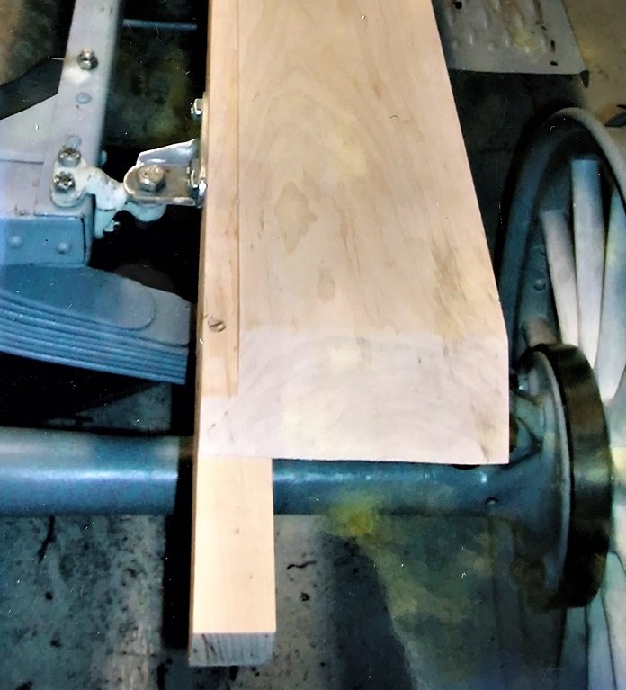

Frank,
I'm a little curious about how the runner (body to frame bracket) is attached to the floor. From the other picture it looks like there is an angle cut
