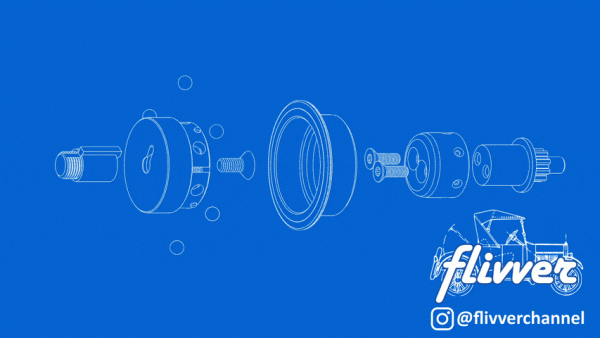

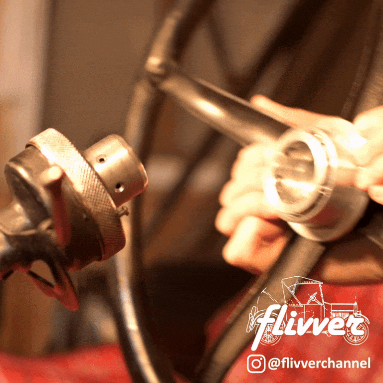

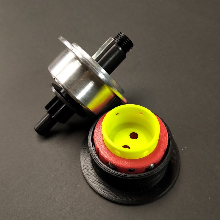

We are working on something kinda neat. Not period correct but very convenient. (click on the GIF image and it should play kinda like a video.)

New product coming to market? Interested, More details.

Designed and machined for our own use. As a stealthy alternative to a fat-man wheel.

Steven,
I really like what you have done here.
Is there a quick connect electrical connection for the Canadian horn button???
Nice......Harry

No horn button connection, but I suppose there could be. My '26 T has the horn button on the stalk, so not necessary in my case.

Hi Steve,
Do not wish this to be negative in anyway, great idea but quick release steering wheels on public road vehicles have been banned for years. For racing use only.
Sorry, had to post due to liability issues,
Hank
Hank

Quite right! I designed this specifically to Not move the wheel closer to the driver; it's very close already. I also wanted something that used the original steering wheel unaltered, and was stealthy and hardly noticeable.Craig Leach wrote: ↑Sat Dec 11, 2021 9:32 pmit dosnt seem to move the wheel adversely closer to the driver like the FatMan adapter does.

Could you add a "safety pin" in the collar to prevent the accidental removal of the wheel. I think that might change its definition ever so slightly from "quick release" to "easily removable" How is the release collar connected to the steering shaft?Flivver wrote: ↑Sat Dec 11, 2021 11:13 pmQuite right! I designed this specifically to Not move the wheel closer to the driver; it's very close already. I also wanted something that used the original steering wheel unaltered, and was stealthy and hardly noticeable.Craig Leach wrote: ↑Sat Dec 11, 2021 9:32 pmit dosnt seem to move the wheel adversely closer to the driver like the FatMan adapter does.

Impressive design and machining work. But a removable steering wheel... what could possibly go wrong?

Interesting idea! I'll give that a think....

But, yes, a removeable safety pin on a small chain to "lock" this unit into place would be a nice safety feature. It's not like everything else on our T's are held in place with cotter pins.

How about sharing the prints, if you are not going to produce them?

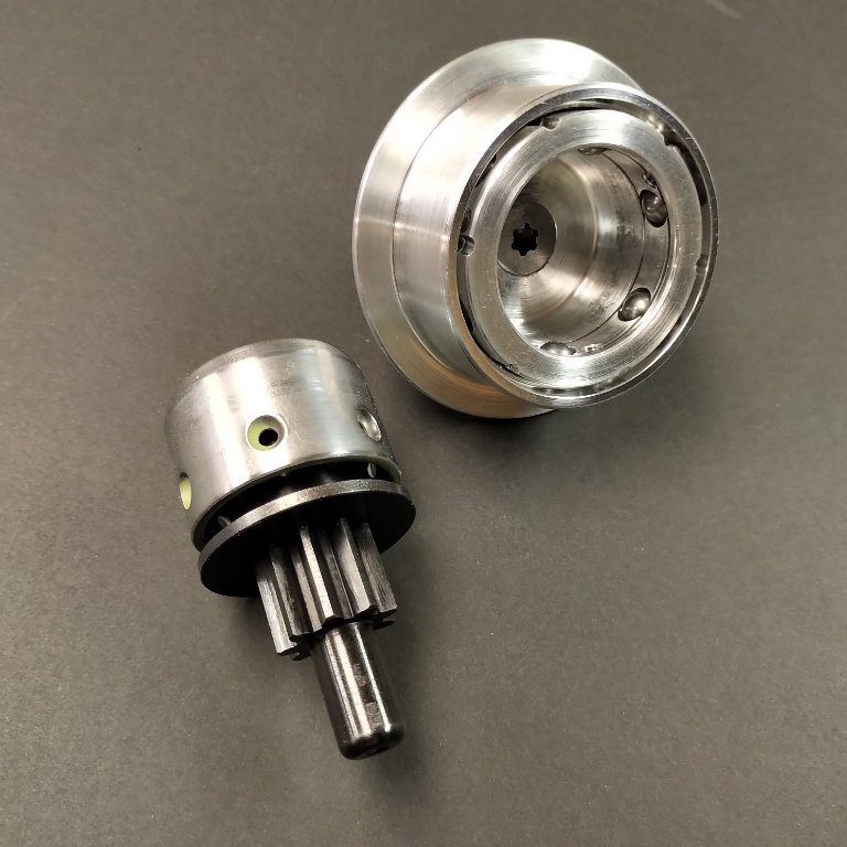

Having raced modern dirt cars with removable steering wheels you should always pull up on the wheel to check that it is locked on steering shaft before driving. Also if you use a open car trailer or park car unattended remember to remove the steering wheel or a thief may do that for you. One comment I have is that the racing removable steering wheels have a spline, or flat sides, to interface between the steering wheel hub and the steering shaft to take the steering load. Even a stock Model T steering wheel can inavertaly become a removable wheel if the set screw is accidentally omitted and the cover comes unscrewed, make sure to check for a set screw.

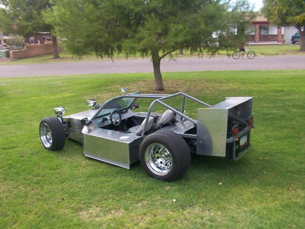

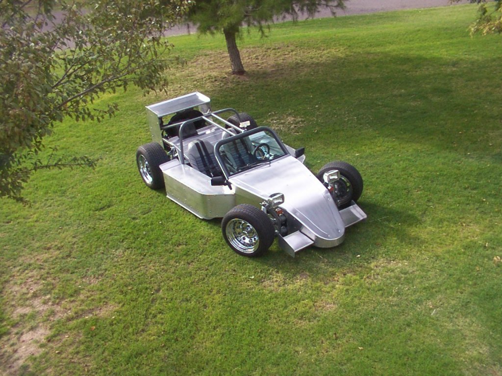

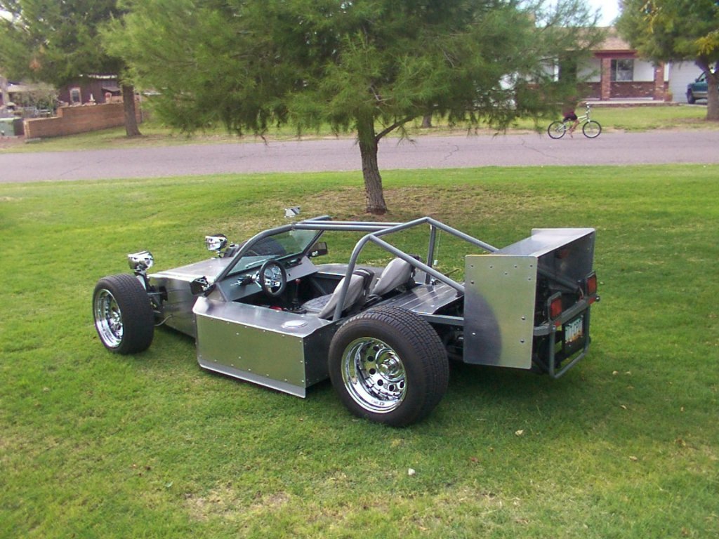

In 1998 I built a sports car with a ramovable steering wheel because you did not get in the car you put it on. The car has changed hands many times and last I talked to a owner the steering wheel was never a problem. You do get a real big reaction from a unhappy passanger when your say if you dont like the way i drive you do it and hand them the steering wheel! I have thought of it many times but I'm not as creative as some. My hat is off to Steve.

Here is a little more info on the Removable Steering wheel design. (click on GIF for animation)

Raw, unanodized parts for trials, with the working prototype 3D-printed predecessor prototype.
