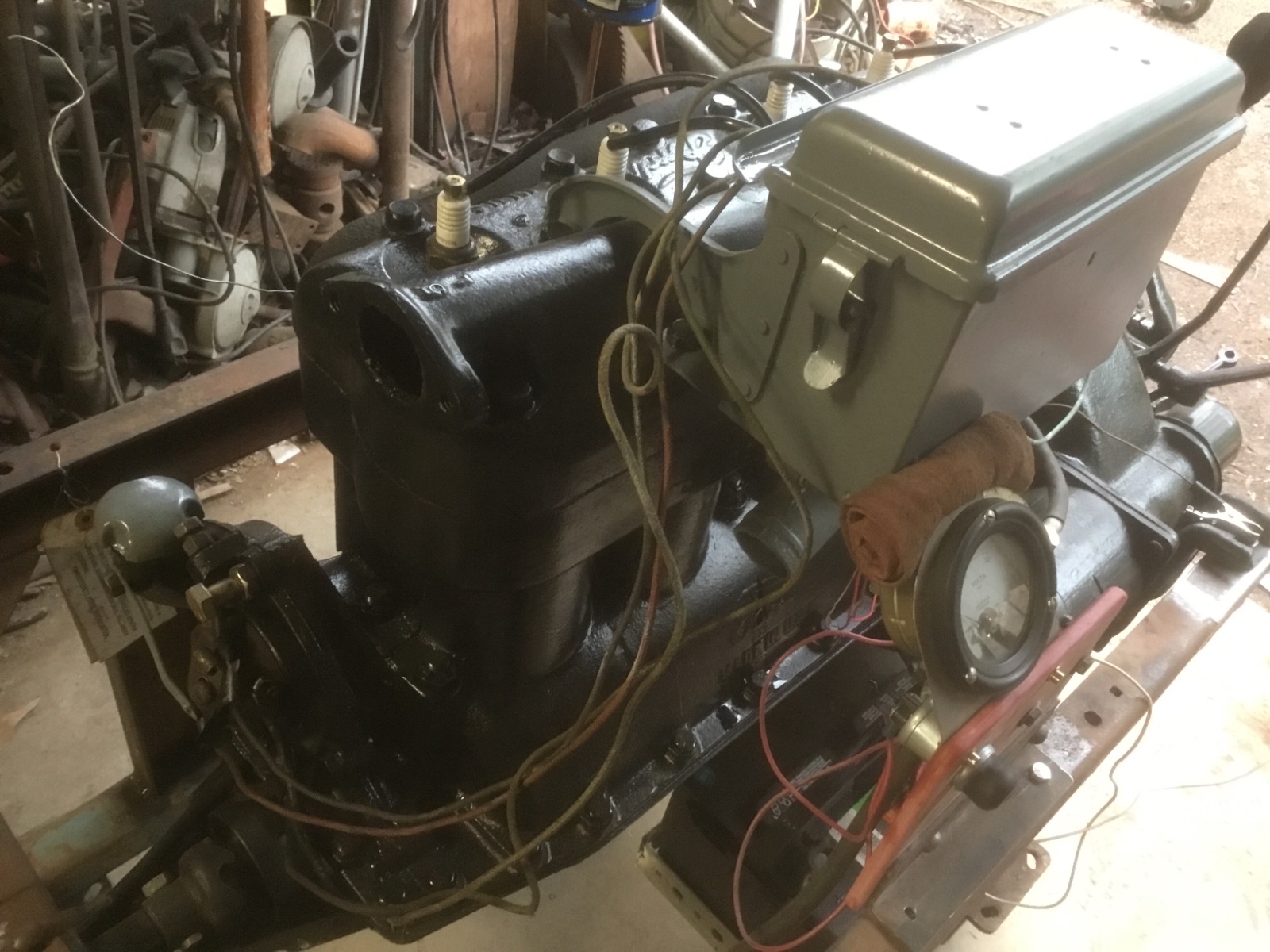

Post by Steve Jelf » Tue Apr 02, 2019 12:02 am

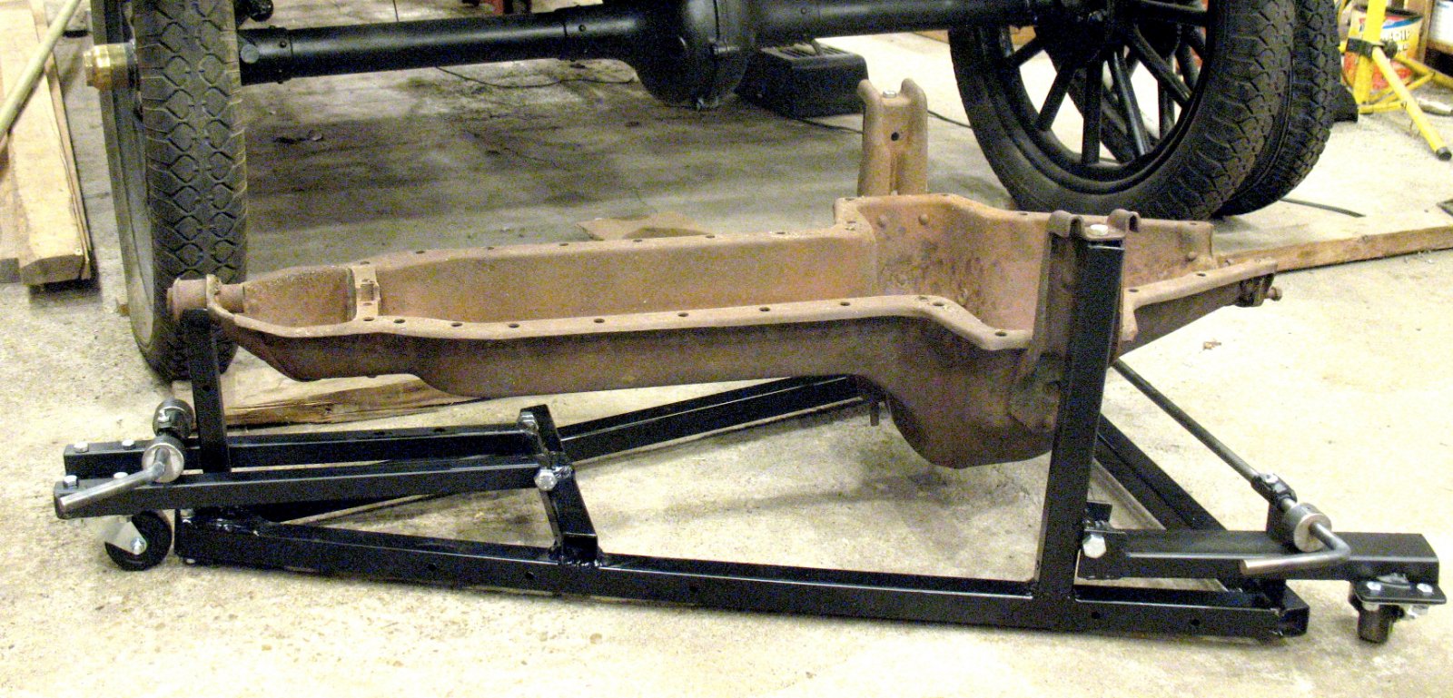

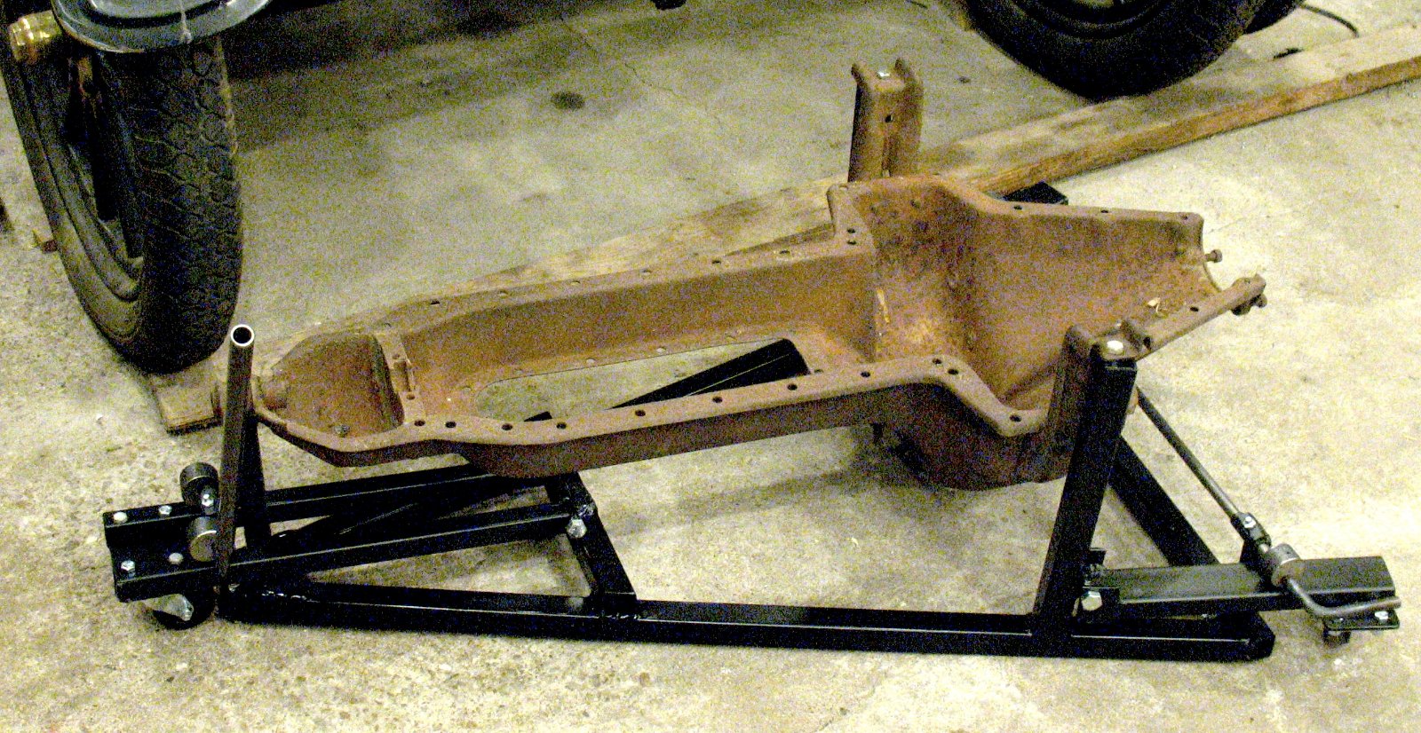

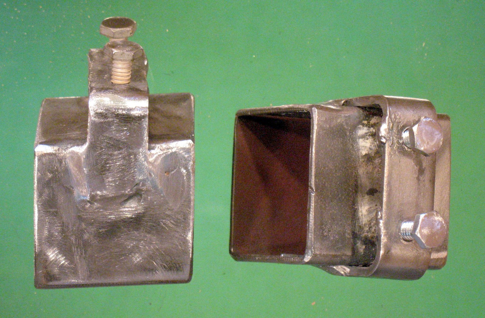

I'll start it off this month. This isn't a specific car, but any Model T engine/transmission I need to haul in my Suburban. With limited overhead room I can't reach in with a hoist, and I've been using a wooden stand I have to slide in and out. Putting it mildly, that is no fun. So I made a stand that sits low enough to fit and will roll in and out.
Turning the handles forward puts the casters down so the stand will roll.
Turning the handles back lowers the stand to rest on the floor.

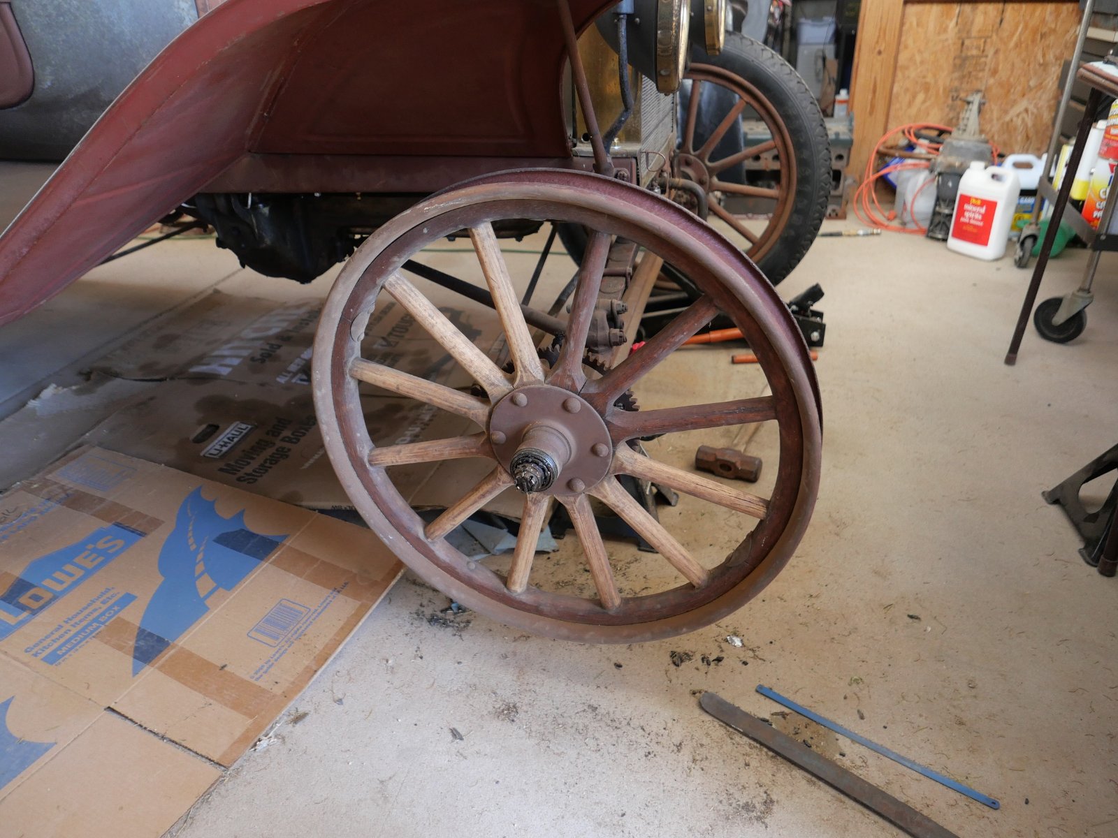

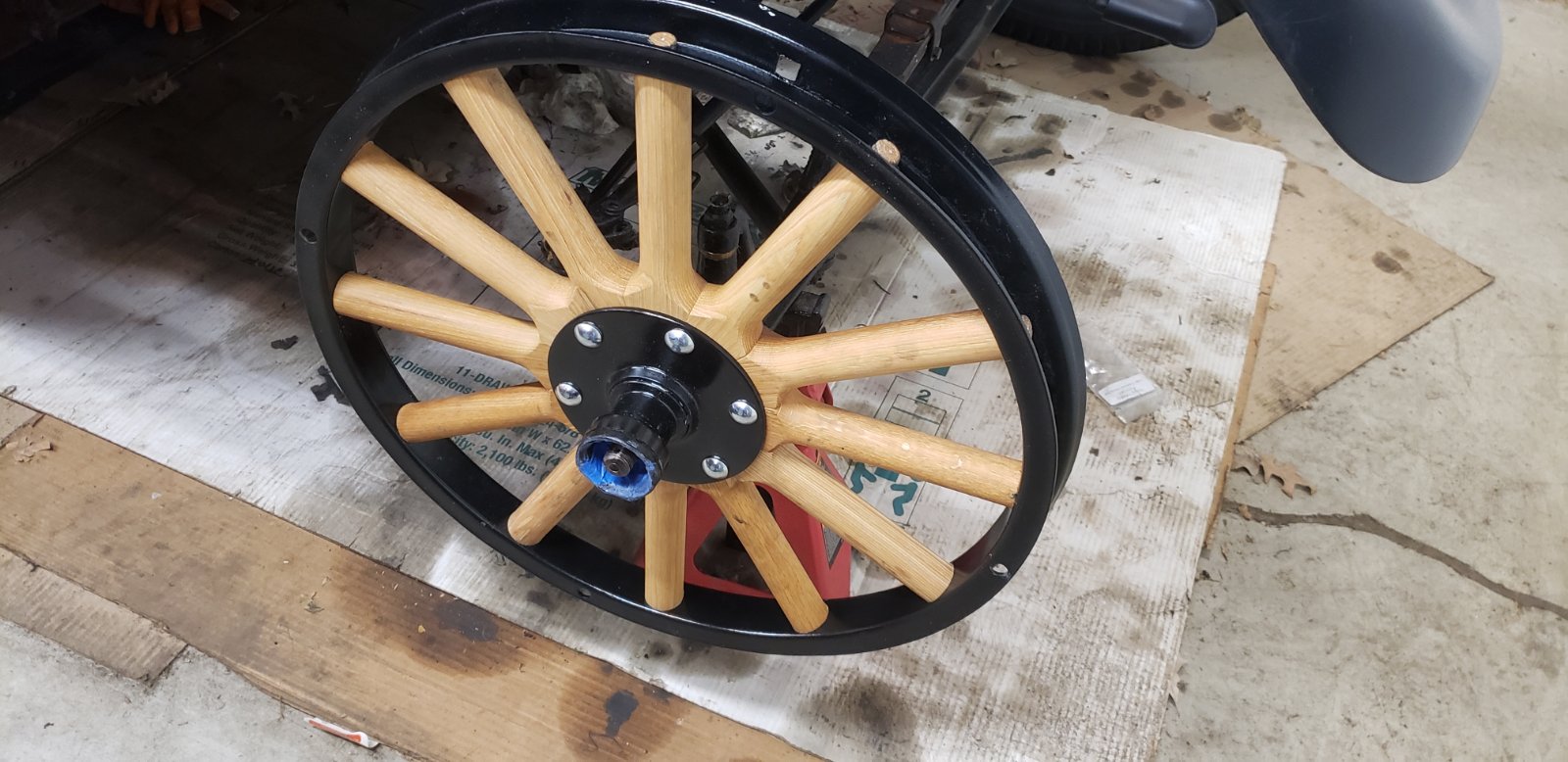

Pulled the wheels off the 09 and replaced one rear wheel that was racked and not safe. Looks like the darn thing would be under warranty but the local Ford dealer is out of them. Glad I had a good spare. Getting it ready for summer!

Post by RajoRacer » Tue Apr 02, 2019 10:03 am
Nice work Steve - did you engineer that ?
Posts: 7413
Re: What have you done with your Model T in April?
Post by Steve Jelf » Tue Apr 02, 2019 10:12 am
...did you engineer that ?
I guess you could call it that. It was one of those things where you start building and make it up as you go. Mostly scrap on hand. I may have as much as $25 in it.

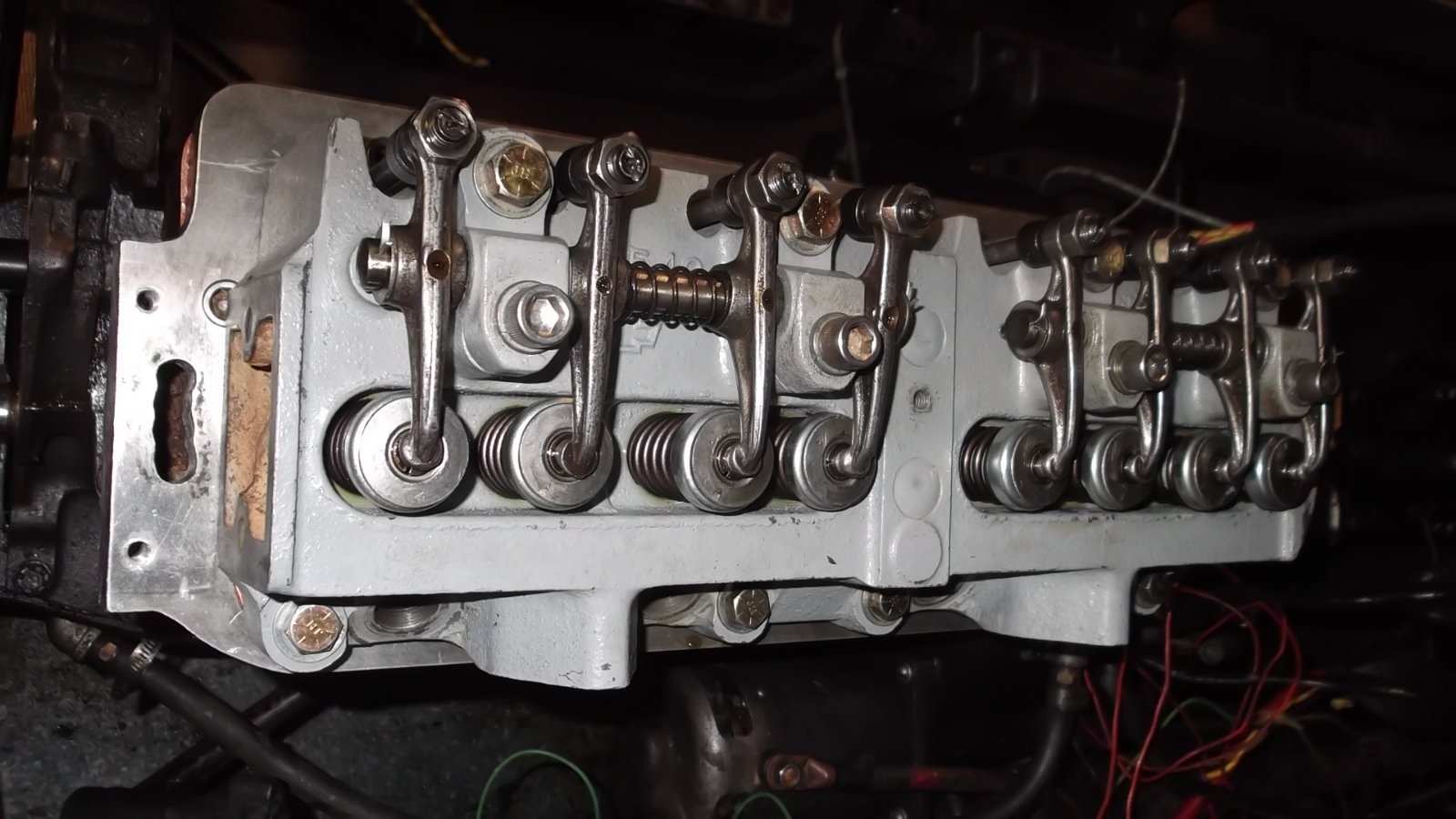

Post by Mark Gregush » Tue Apr 02, 2019 10:38 am

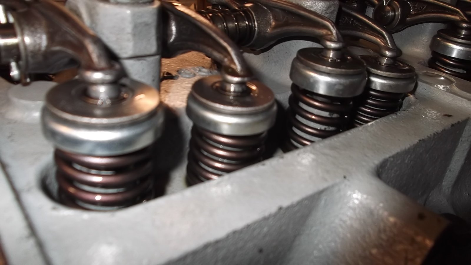

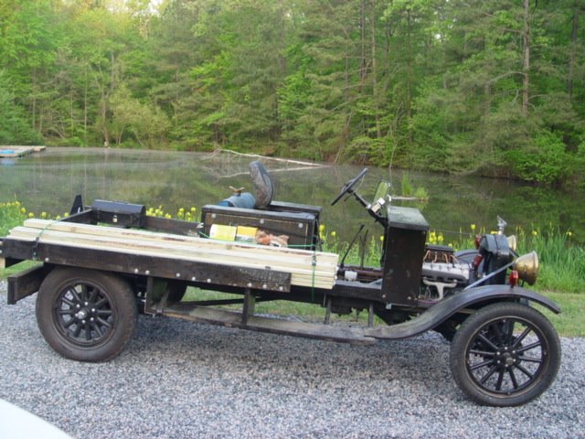

Sorry to say I pulled the Chevrolet over head conversion off my T. Not disappointed with the results, just don't have room or money to keep experimenting with it right now. It ran fine but with the carb setup I was using was slow. I will have the whole shebang at the Portland (Oregon) swap meet (EXPO center) this weekend.

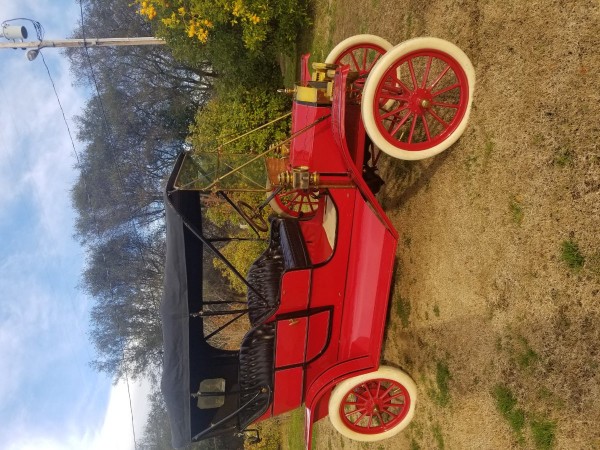

Post by Jem » Tue Apr 02, 2019 5:06 pm
Got it out the shed and dusted off the cobwebs

Post by Art Ebeling » Tue Apr 02, 2019 8:01 pm
IMG_20190330_120344848_HDR.jpgGot it out the shed and dusted off the cobwebs
Jem, How about some more pictures? Art

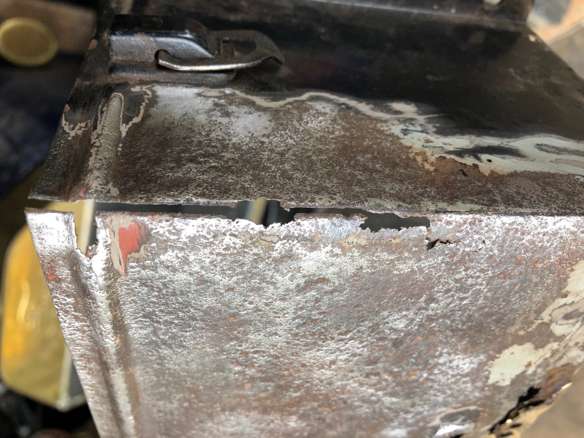

Post by Barth_Tool_Co » Tue Apr 02, 2019 9:26 pm

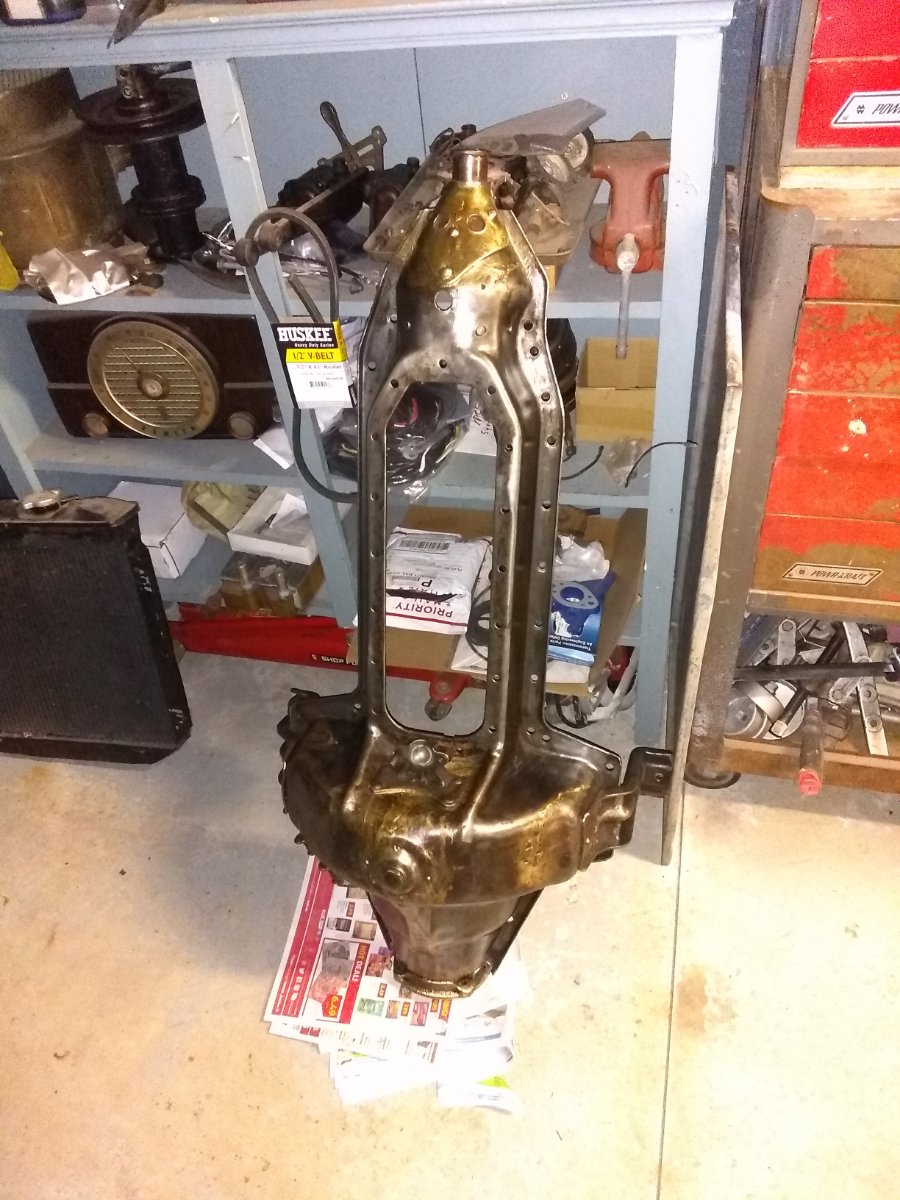

Cleaned up my pan to prep for straightening...

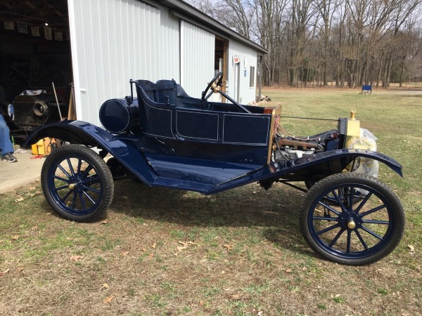

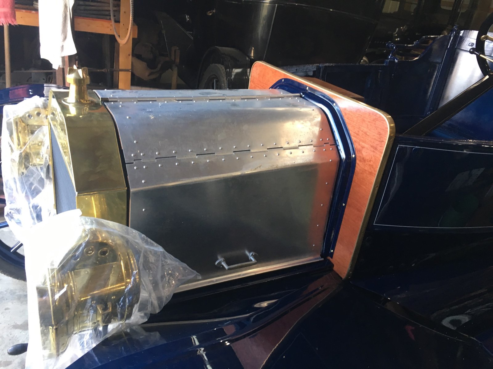

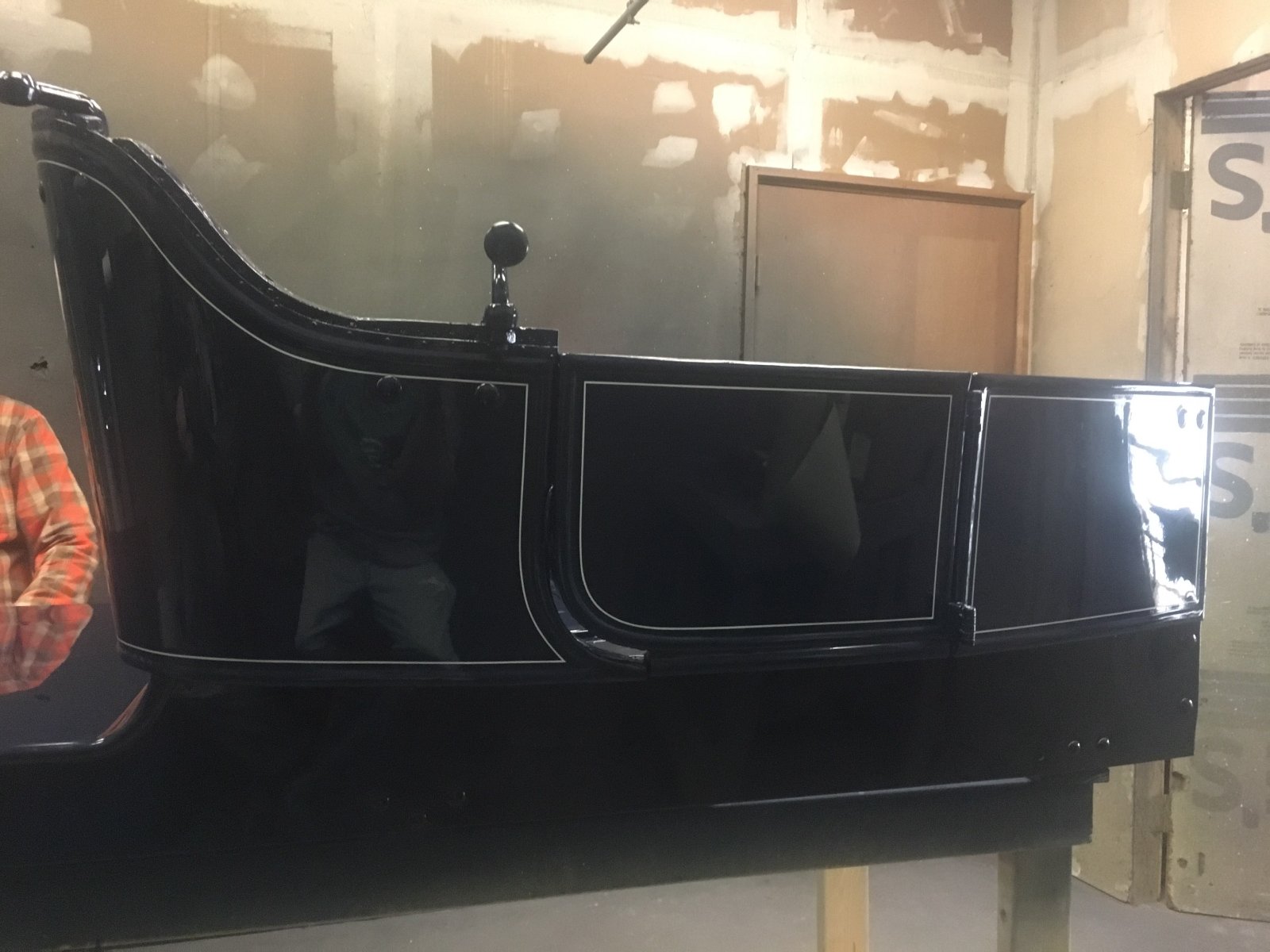

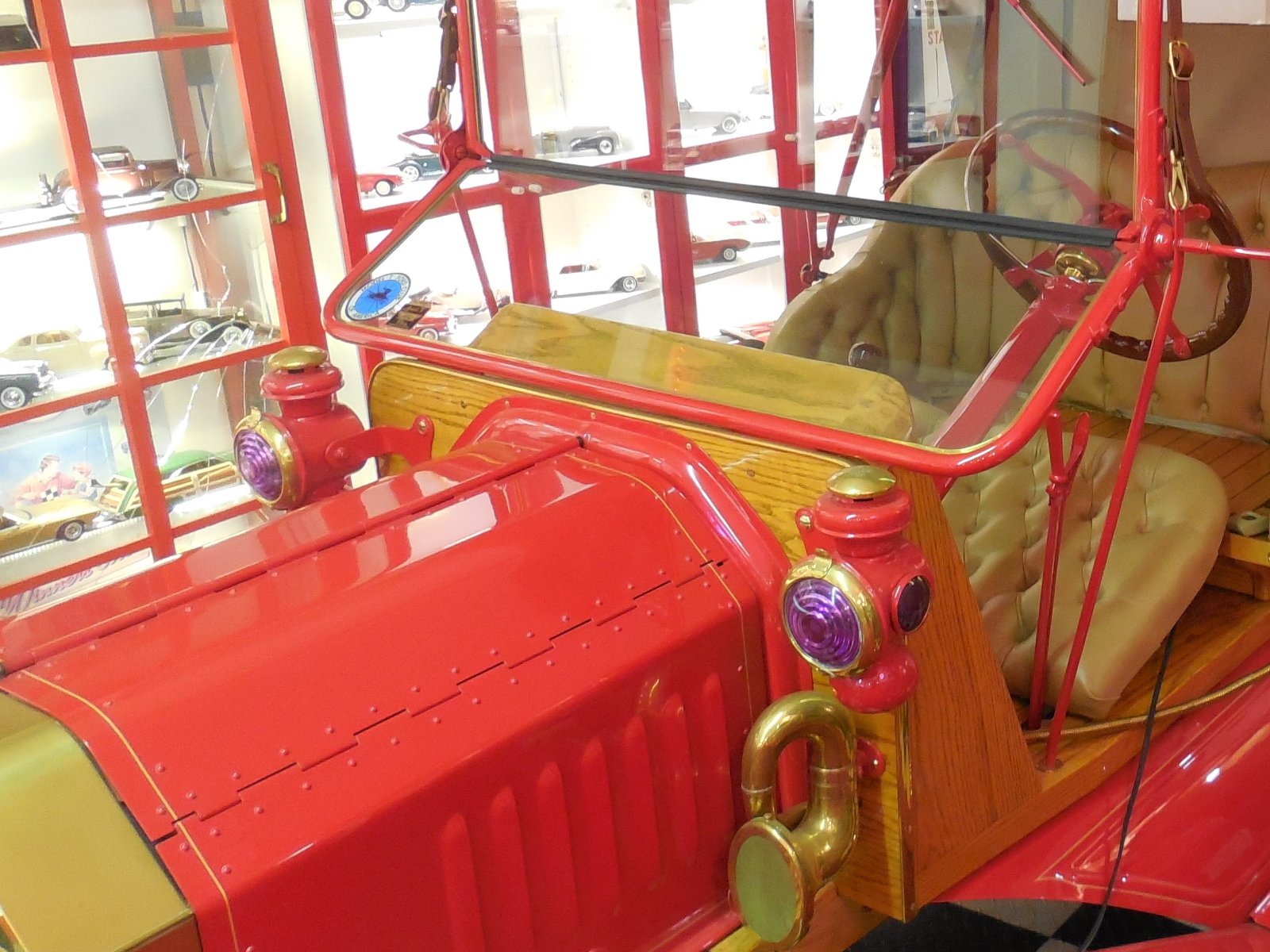

While not my car, Mark and Phil Eyre are making steady progress on their '11 Torpedo project. They have the chassis and engine pretty well licked and the body is now blue. The long process of pin striping began today.
Eyre Torpedo stripe
Eyre Torpedo stripe

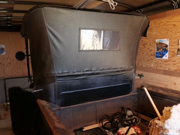

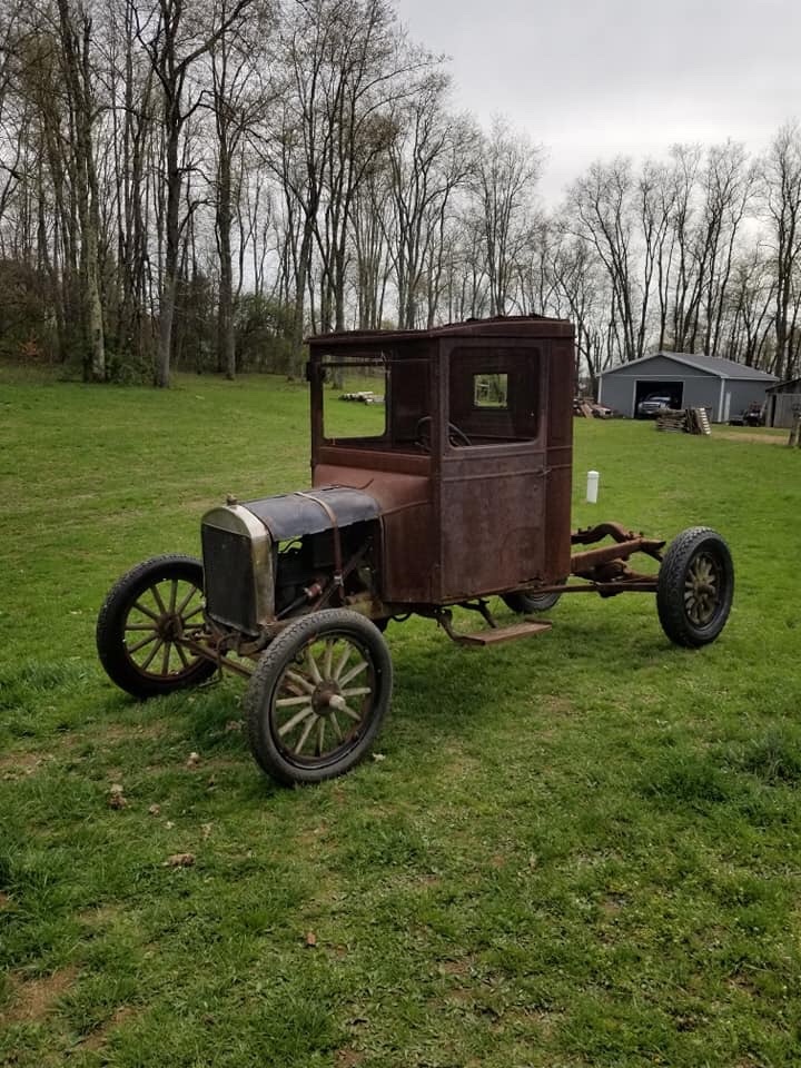

Just bought this one and brought it home. It was sitting in a home garage near me for 30 years. Needs a good cleanup and then we will try to get it to run. Should be fun!

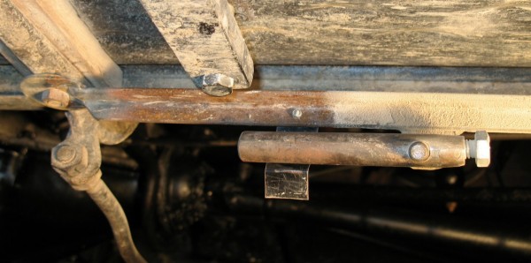

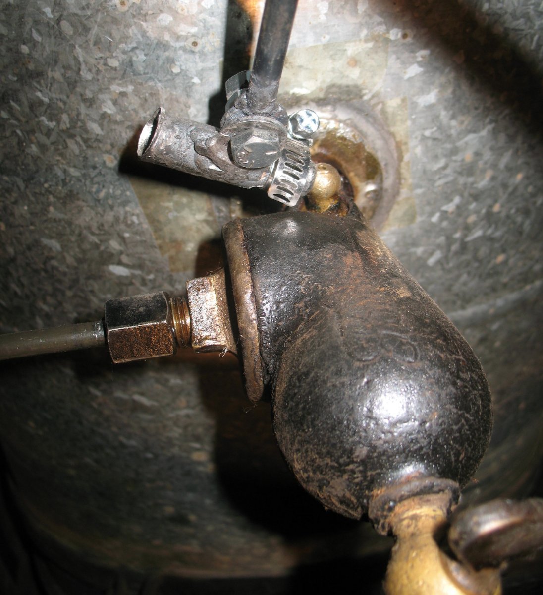

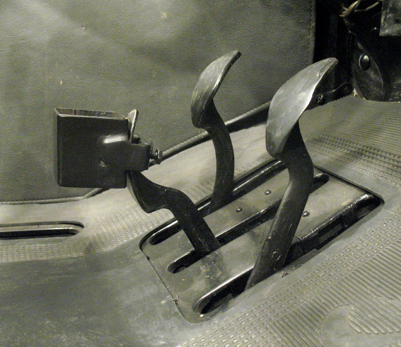

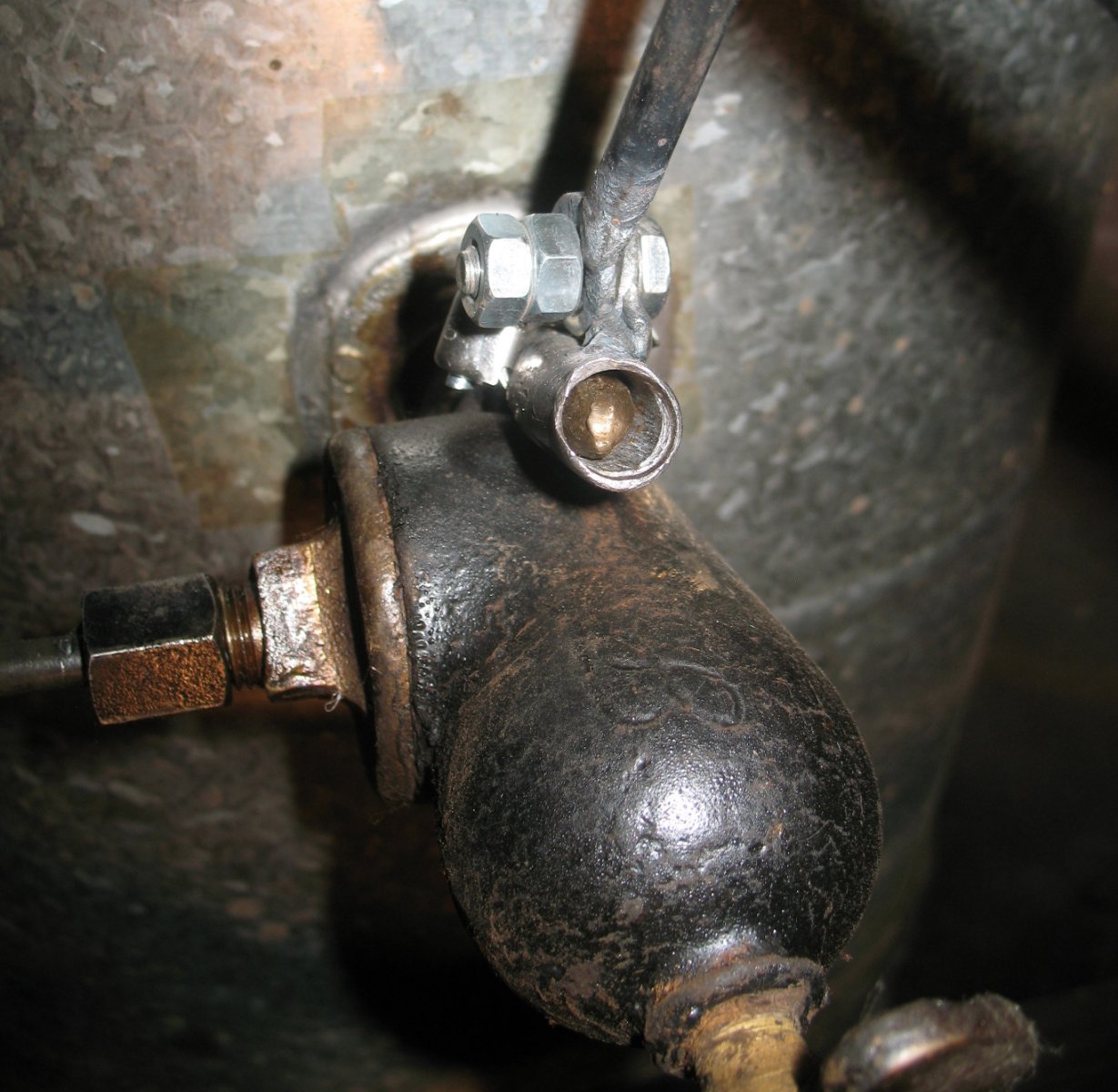

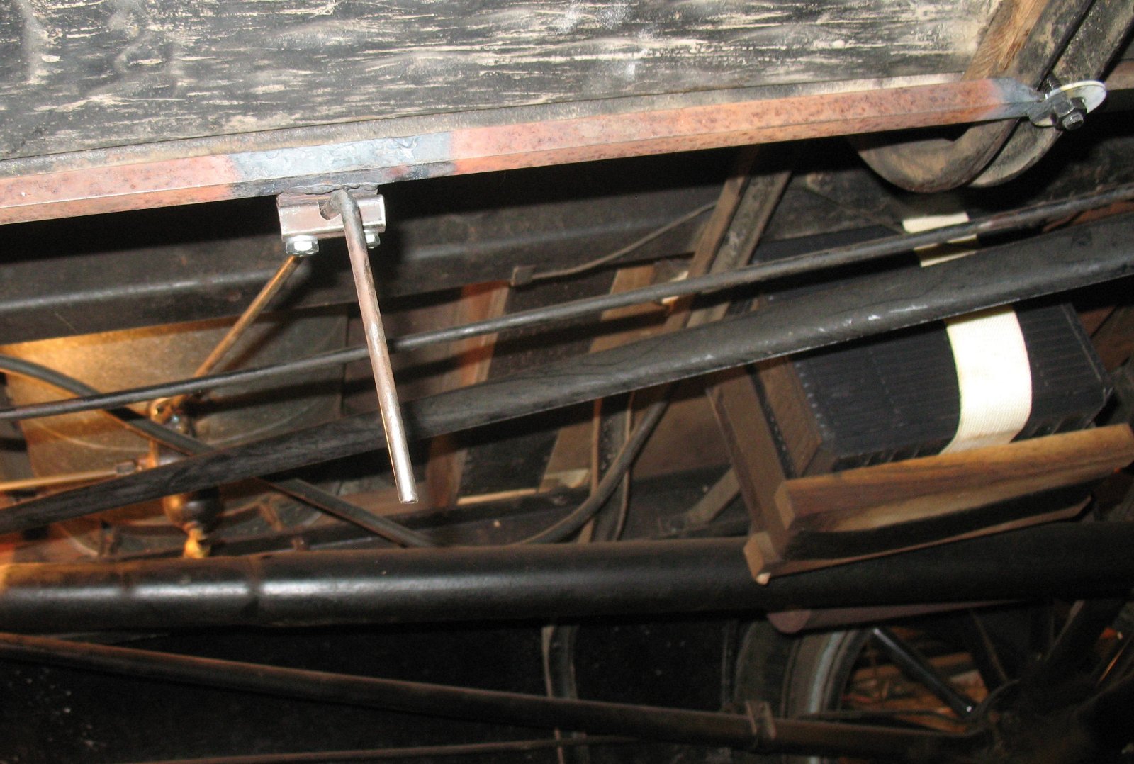

Shouldn't I have a valve on my carburetor to shut off the gas? No. It looks modern, and/or it's so stiff you practically have to use a wrench to turn it. After seeing a setup like this on a TT a few years ago, I made one for my 1915 runabout, and I just made another for my 1923 touring and installed it this morning. You can turn the sediment bulb valve from beside the car. No need to crawl underneath.
Two running board bolts hold a length of angle iron, which holds a rod attached to the sediment bulb valve. When the handle is down...
...the valve is closed. A short piece of tubing swivels on the end of the rod, fits over the valve handle, and is held on by a small hose clamp.
When the handle is turned up...
...the valve is open.

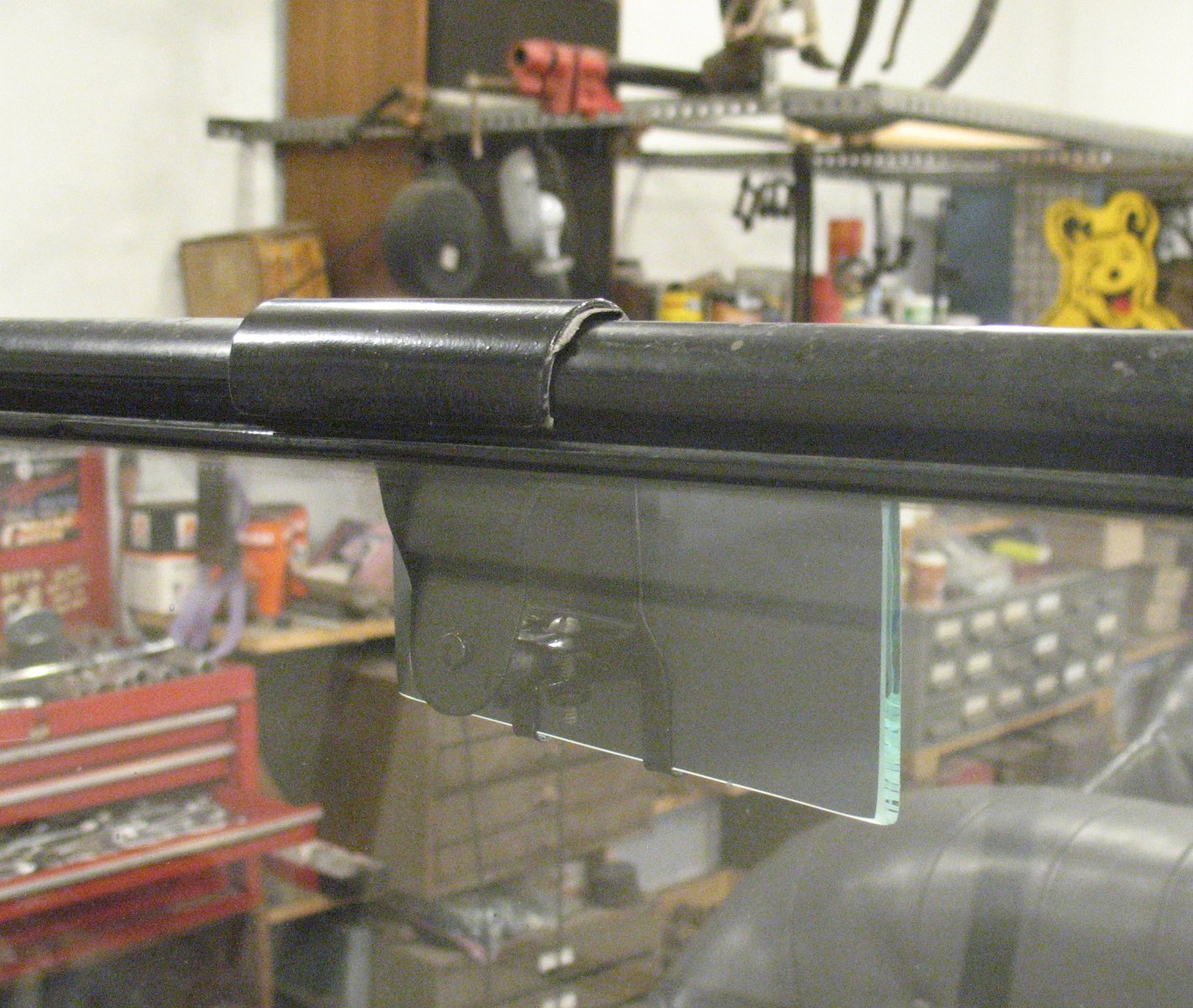

I like it Steve, but with bumps and travel might the handle work its way down and shut the gas off? Needs some sort of say zip tie loop to go around the end of the handle and keep it from sagging down and thus closing the gas?
Posts: 7413
Post by Steve Jelf » Wed Apr 03, 2019 12:54 am
This one seems stiff enough to stay put. But if it doesn't I'll add a spring catch like I did on the runabout.

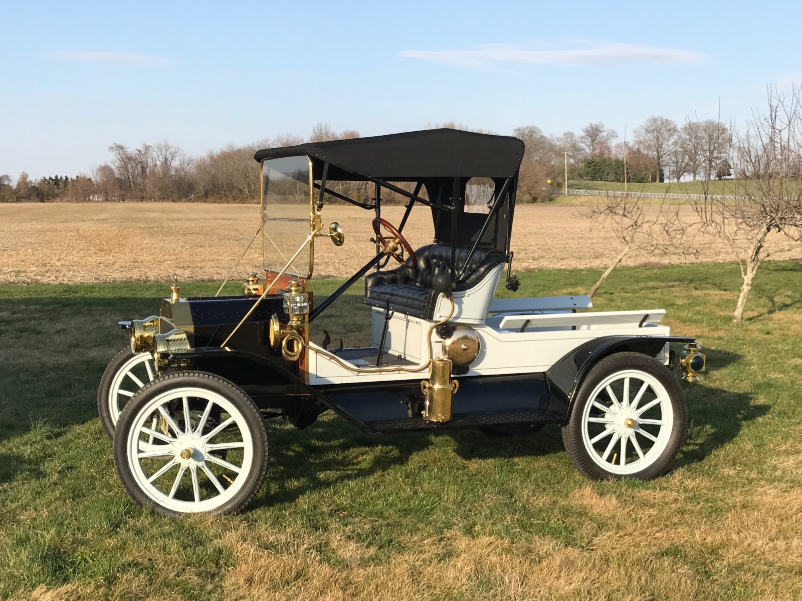

Post by EricMac » Wed Apr 03, 2019 1:21 pm

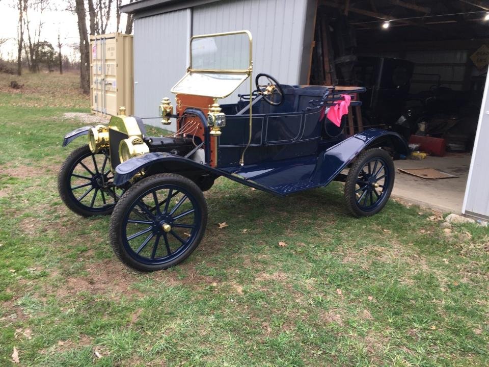

The Eyre T Torpedo looks like a car today.

Post by Rich Eagle » Wed Apr 03, 2019 1:29 pm
My gosh Eric, that looks fantastic!

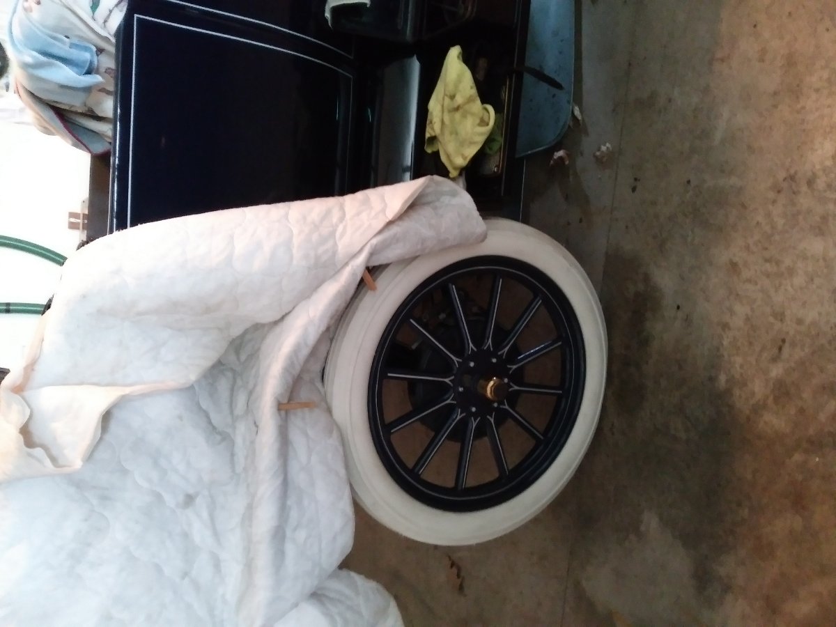

Does covering the car so it doesn't get overspray while painting something else count as doing something on my T ?
Dick

Post by EricMac » Wed Apr 03, 2019 10:44 pm
I have been following along with the progress on this car for 20 years. You would not believe how good it is in person.

Post by Model T Mark » Thu Apr 04, 2019 10:22 am
Eric is correct on the 11 torpedo in the above post it has been apart since 1987. We took it apart to store it when I was 17. Next year I’ll be 50 and it was time to get it done. Life certainly gets in the way of the hobby sometimes. I’m not too computer savvy so Eric has been posting pictures as I get things done. Our hope is to have it completed for next year. It’s a closed valve twelve river rear end car. It was a pretty complete car and we did purchase repo fender and hood on it. I wish now I would have fixed the originals.

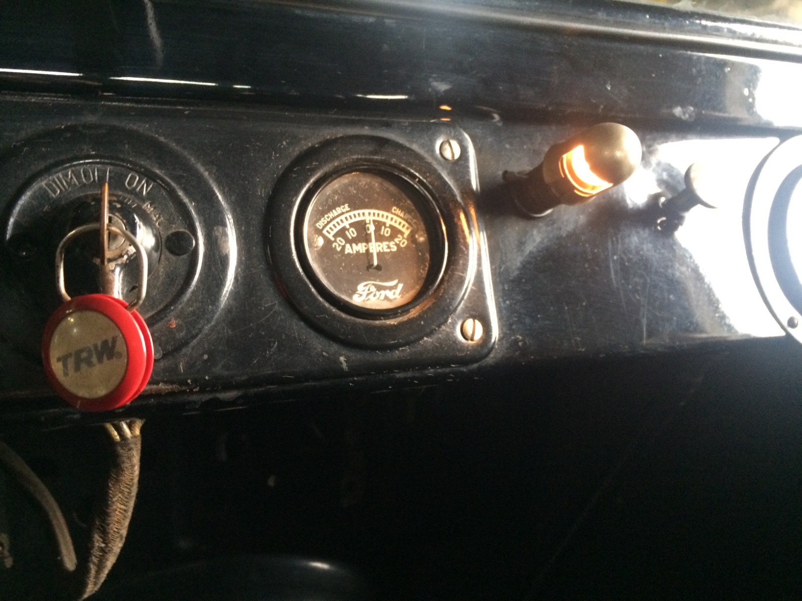

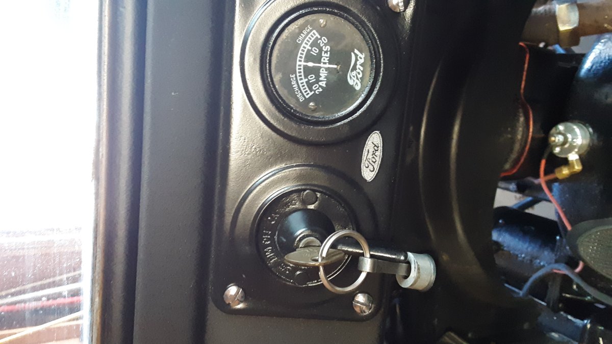

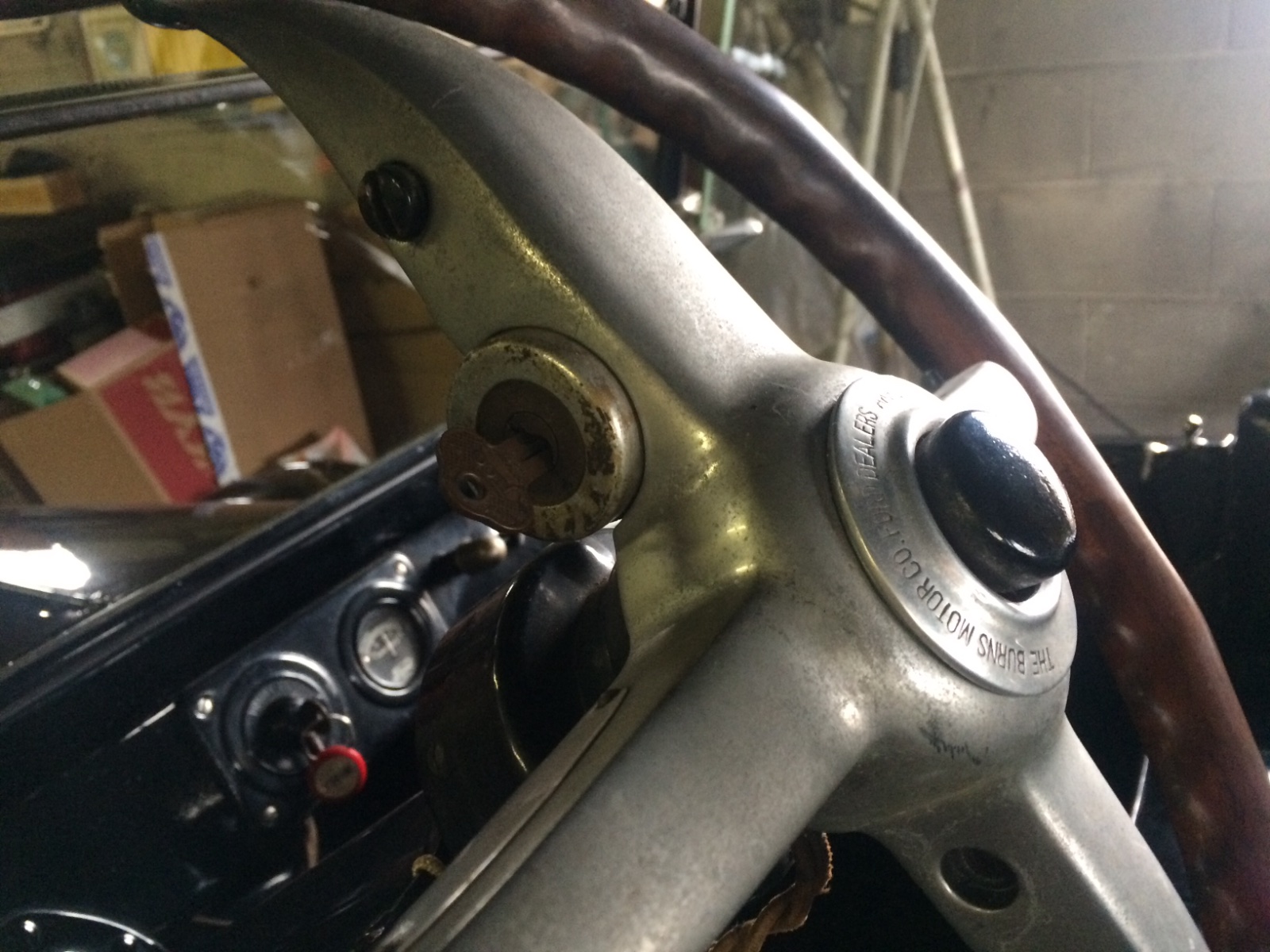

Got my locking steering wheel off and lubed the gears. I think by tightening the spider screws, the pesky rattle should be gone !! :D
I also fixed the wire end for my dash light, and it works ! 8-)

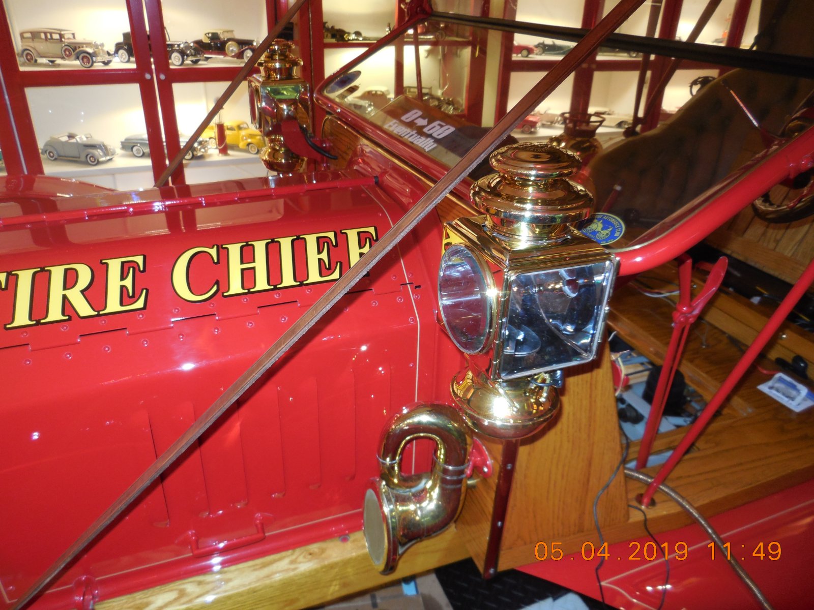

These are what came on the car.

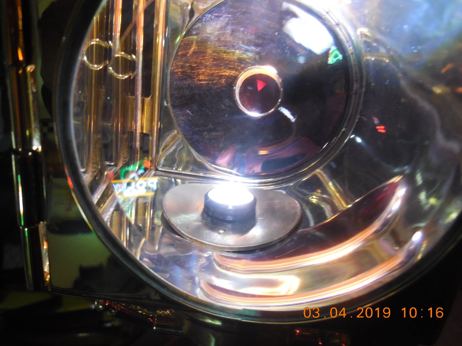

Changed the E&J 1915 sidelights to correct 1913 sidelights and then converted the 13's to LED lights.
These are the new lED lights I got on Amazon<br />https://www.amazon.com/gp/product/B07DD772MJ/ref=ppx_yo_dt_b_asin_title_o05_s00?ie=UTF8&amp;psc=1  <br />Very bright
https://www.amazon.com/gp/product/B07DD772MJ/ref=ppx_yo_dt_b_asin_title_o05_s00?ie=UTF8&psc=1
Very bright
New lights all wired up.
Installed into the new light. It only took a few washers to make them fit.
:D

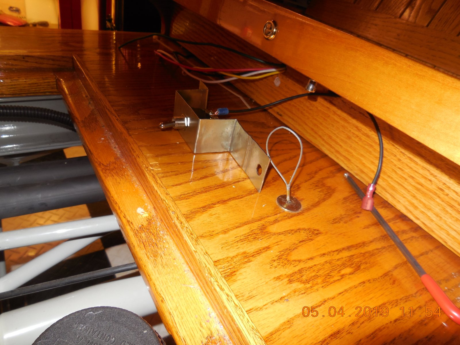

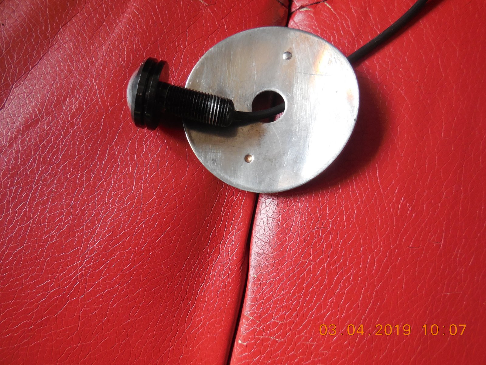

The 13 Modern Speedster had turn signals installed when I got it, however the switch was below the dash in front of the passenger - very unhandy and also dangerous. I have now moved it to the seat riser under the seat and to the right of the driver a skosh, now it's easily activated with my right hand and I don't have to get all contorted as before.
Bracket I fabricated to mount the TS toggle. it gets attached to the seat riser.

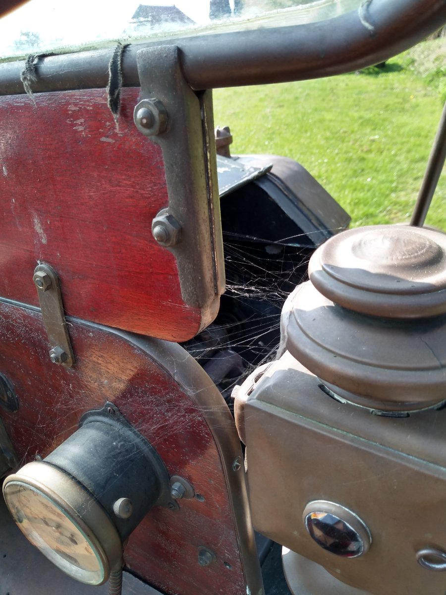

Post by DLodge » Fri Apr 05, 2019 5:14 pm
Jem now has the cleanest cobwebs in all of Lincolnshire.... :D

Post by jagiven » Fri Apr 05, 2019 11:02 pm

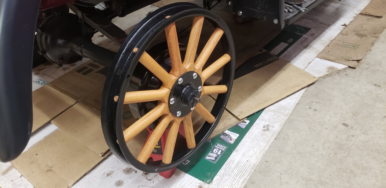

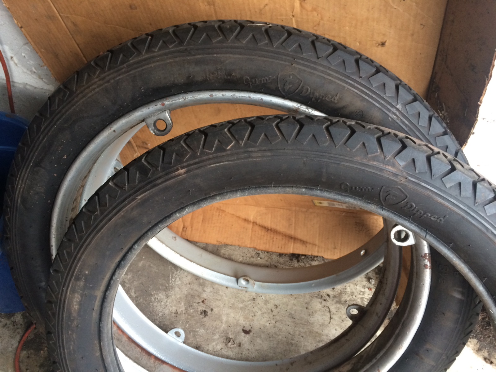

Rebuilt two wheels. Spokes are finished with boiled linseed oil and turpentine. Just have to finish painting the iron components.

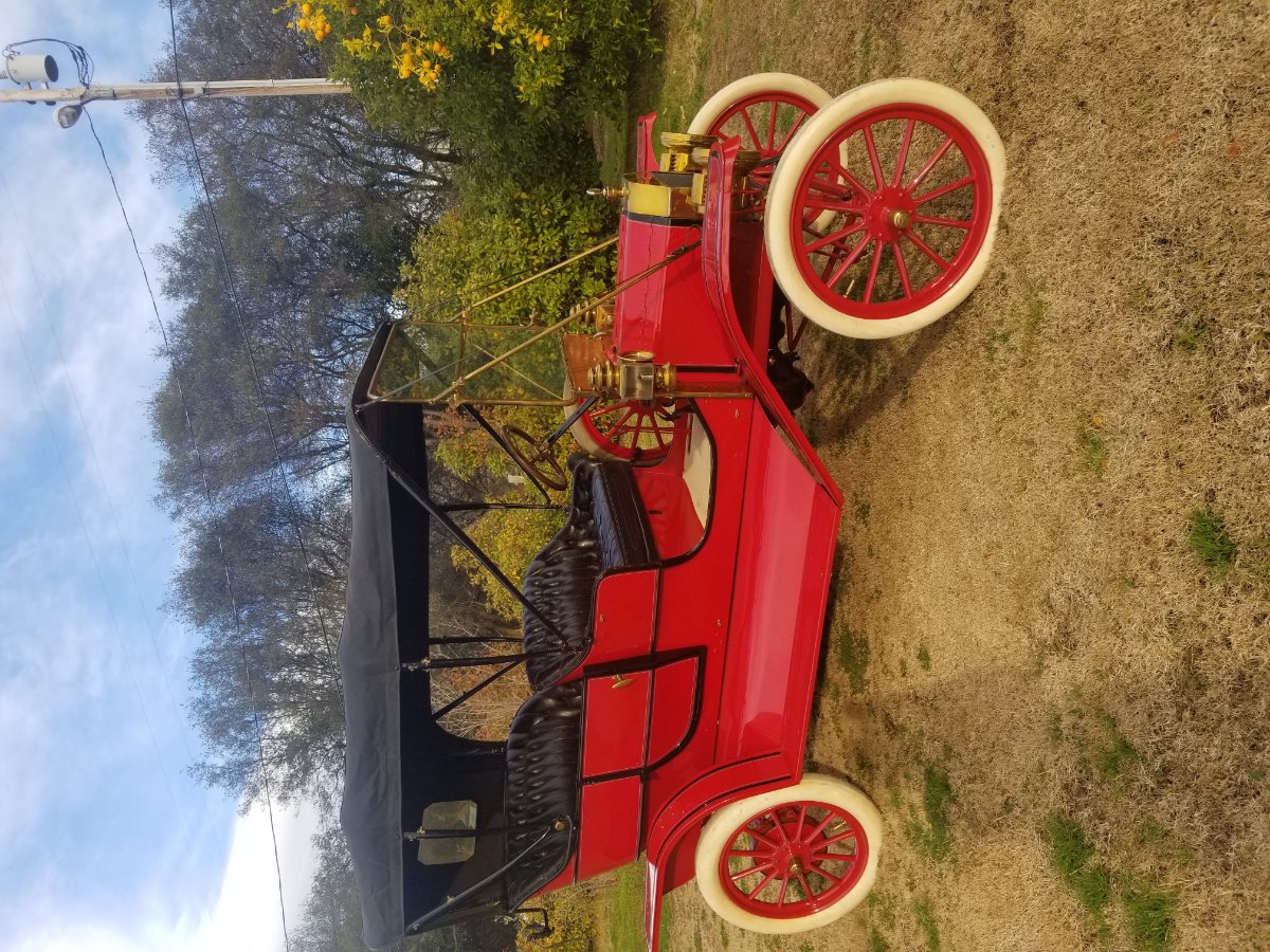

Post by Tbz4u » Fri Apr 05, 2019 11:44 pm
Ok i did take the1909 out for a ride! Unbelieveable in between Storms yea right been raining for days here . Anyway. Had problems with the coils and i new that rv Anderson had done these in 2002 well anyways i called him after numerous times tries because storms back east were bad. i got ahold id him told him he had done these he said send these to me, there under warranty. What. I insist i ll send to you and ill pay you, he said ok if its do to wear he will charge! WHO the hell warrantys something you never paid for right . Well he did i paid the shipping There and rebursed him for ride back on shipping all within 9 days id like to give him an applaud . R V. ANDERSON YOU GOT MY BUSSINESS I SEE YOUR IN THUS CAUSE YOU LOVE IT THANKS AND COILS WORK Great just ran the 1909

Post by Tbz4u » Fri Apr 05, 2019 11:46 pm
Sorry heres picture

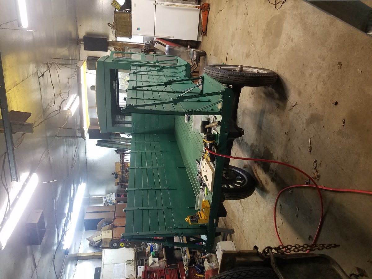

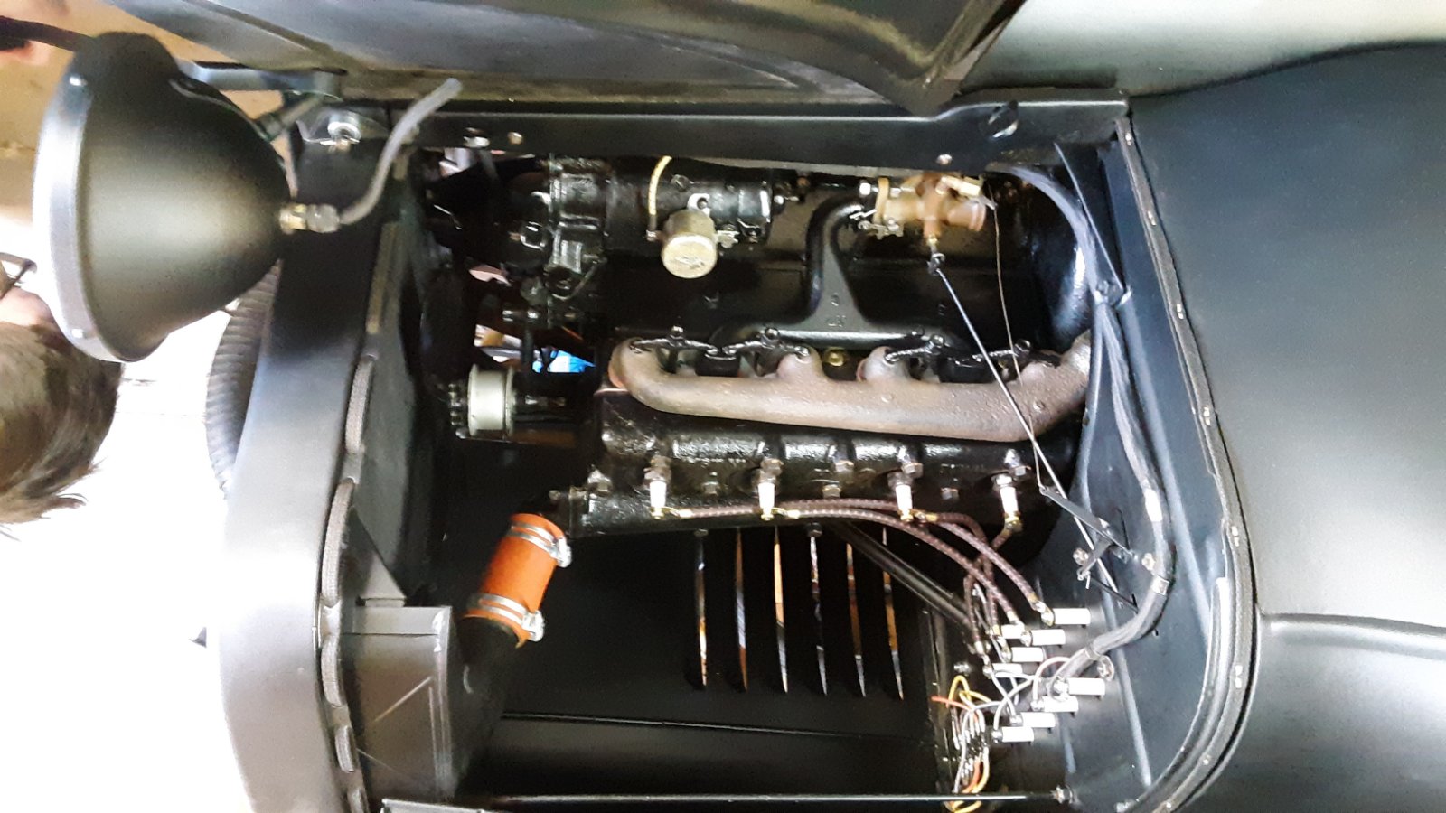

Installed outside oil line on the TT and the wire harness from Dave. Working on a front wheel to get it ready for paint. New tires arrived this week.

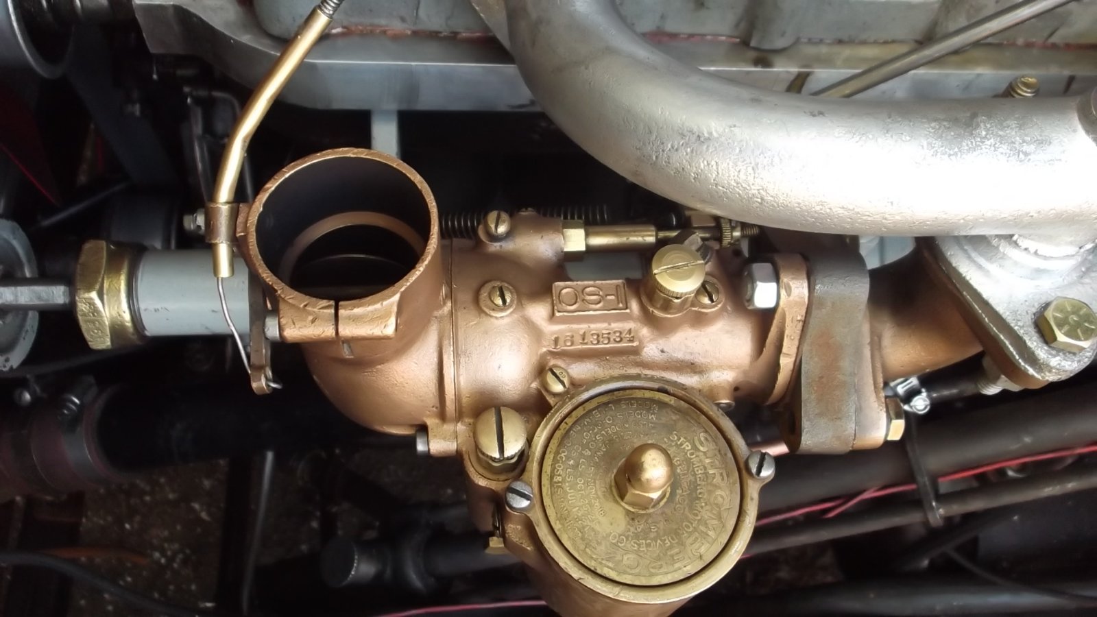

I started early this morning doing my annual maintenance. Cleaned the timer, oil change, greased all the cups, etc. I finished up early afternoon and was able to finally get out for a little drive around town. I've been chomping at the bit to get out this year, but the weather hasn't been cooperative until this weekend.

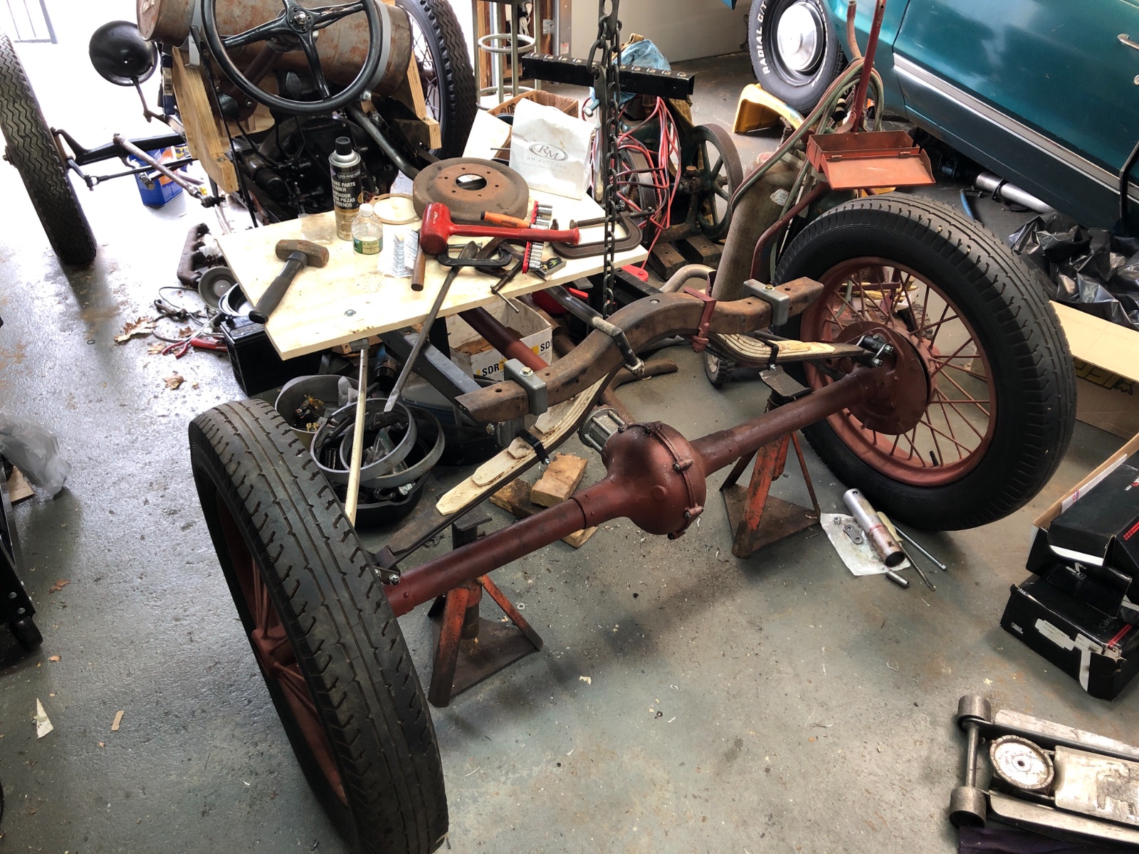

Post by Bob McDaniel » Sat Apr 06, 2019 11:08 pm
One step forward, two steps back. Been working on the 09 the last couple days to get ready to drive it all weekend. Got the toe in set and packed the front wheel bearings, removed the worthless oil sight gage from the side of the pan which stopped an oil leak from the vent hole in the top of it. You can not see the oil in the window under a dark car with dark oil and a black oil pan anyway. Fixed a few small items and reset the coils on the HCCT my wife found for me and then set up the spare coils that came with the car. Most were marked .8 amps 2013 but only 1 was still at .8 and the rest were all over the place and a couple were 1.3 and 1.4. I set them all at .8 and now the car idles all the way down and is smoother. After all this I noticed fewer free starts and thought maybe I need to play with the coils more but after a long day of driving we stopped for drinks and when I shut it off the switch felt loose and then would not work. After pulling it apart in the parking lot I found all the screws were loose inside and the switch had come apart inside. I fixed that and we decided to head for home but stopped by the house of someone my wife works with to give him a ride. The car was now starting much better and free starts were back so we felt it was ready to drive till I made a sudden stop for a light and found out the brakes worked better than most T's I have driven. Then the problems came. At the next light I hit the brakes and nothing happened! Lucky for me I had fixed the rear brakes the other day when I replaced the bad wheel and found a spring had come off after someone put lined brake shoes on the car so I pulled the leaver and stopped just over the white line with my front wheels. I was able to take him home with just the rear brakes but when I got home and pulled the cover to see what happened I noticed the Kevlar bands I was told the car had were cotton! Looks like I will be putting new Kevlar bands in before we can drive it again. Glad I found this before the tour in June. We put around 50 miles on the car and it would have been a long walk. Shake down runs are so much fun!

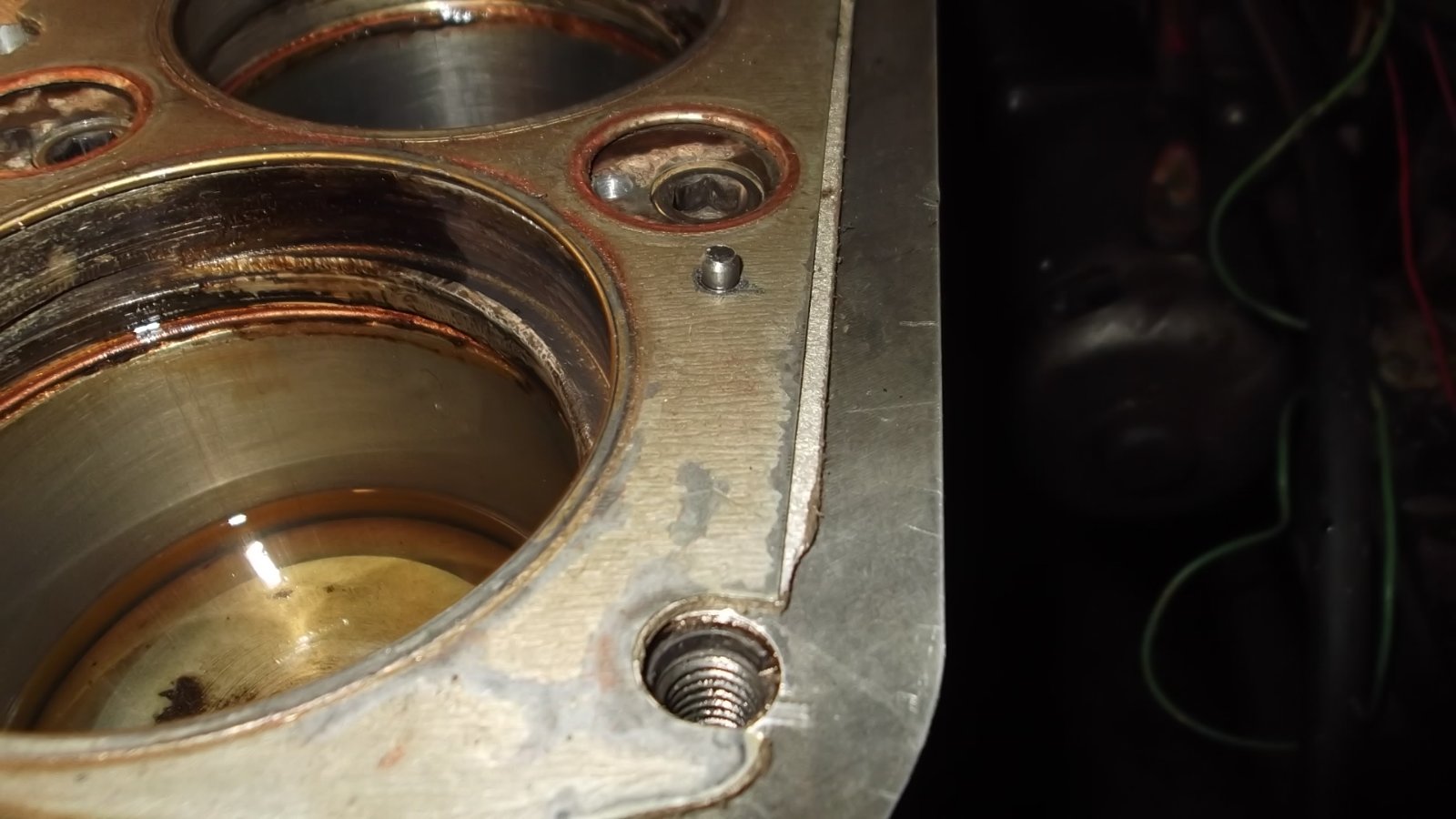

Post by John E. Guitar » Sun Apr 07, 2019 3:55 am
I crossed the Blue Mountains in my 26 Tourer with the usual suspects.
260km round trip for me. It seemed to run ok although compression is currently 28, 32, 39, 32 psi.

Post by jagiven » Sun Apr 07, 2019 5:34 pm
Went to paint the hubs their final coat of paint.
Front hub, both halves, must have had some type of contamination on them. Blistered almost immediately. Now I get to strip it, and start over. Funny thing, the rear hub, was done at the same time, sat right next to it during, and no issues with it. Both used the same paint, primer, handled exactly the same. Oh well, a little more work.

I replaced the petcock to the sediment bowl today using Easy Turn. So far so good. No leaks.

Oops. Should have said EZ Turn.

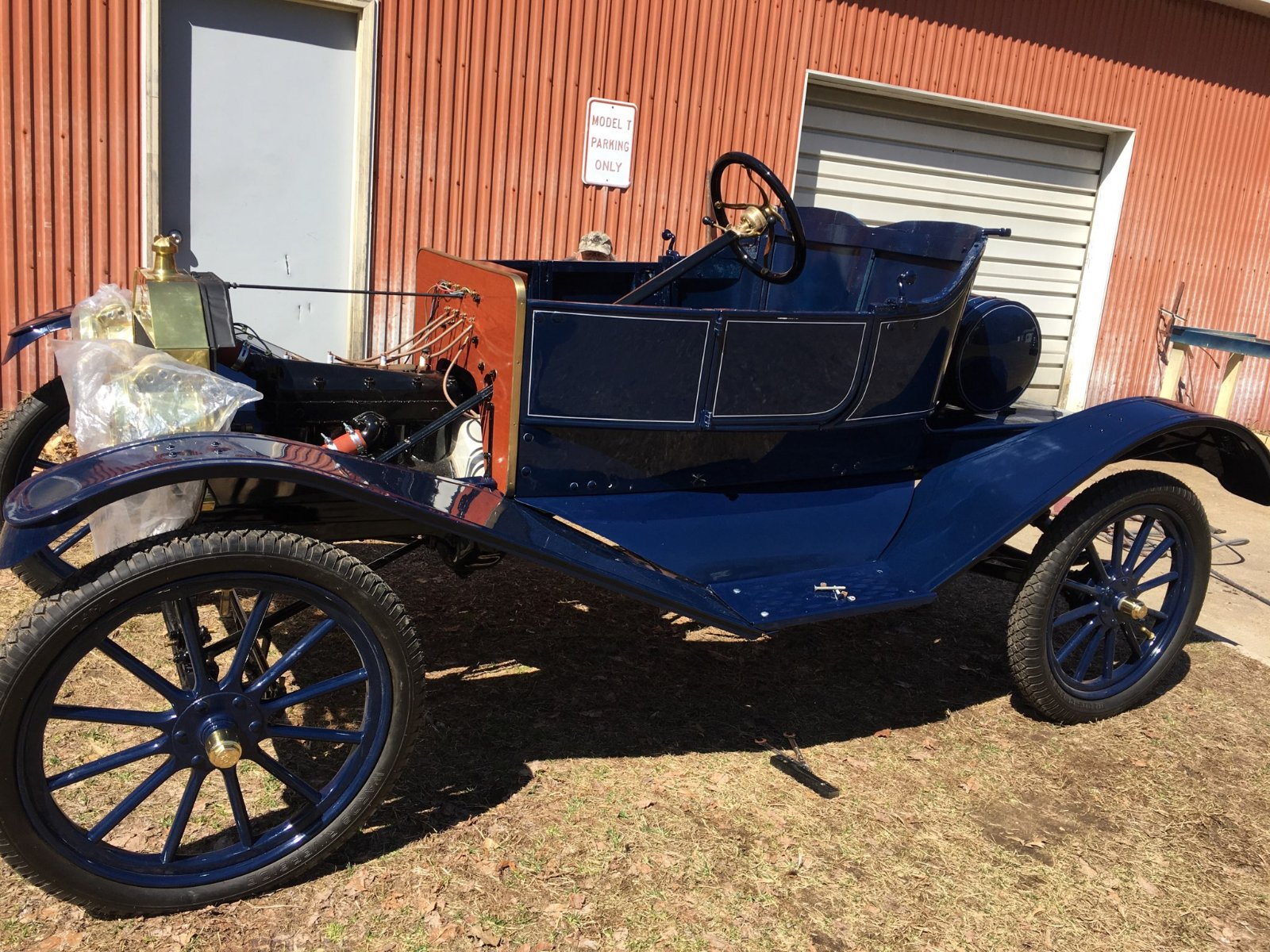

Post by Daniel828 » Mon Apr 08, 2019 4:49 pm

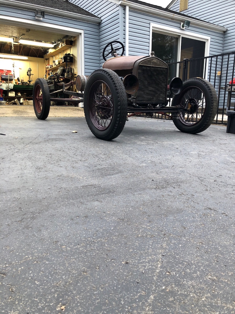

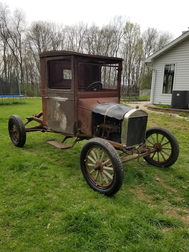

Ive gotten my speedster on the ground this just today.
Still lots of work to do but getting closer

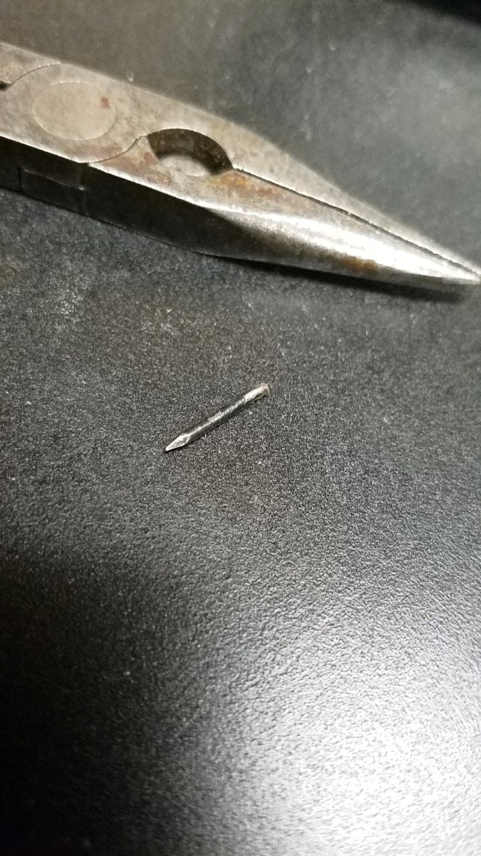

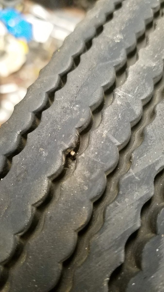

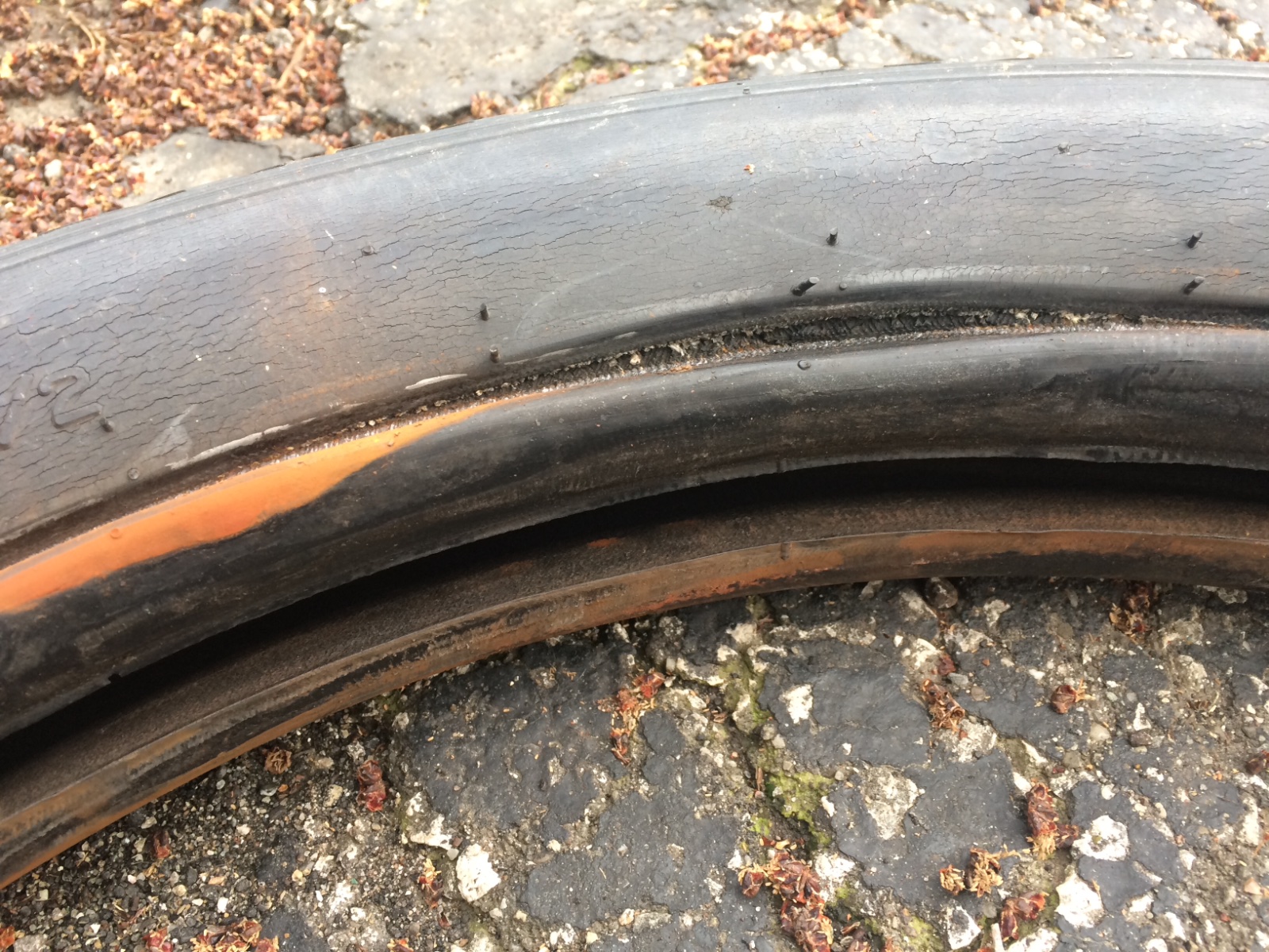

Who would think something so small could cause so much trouble? In any case I am coming back the other way on this job.
Nail in 26 tire
Nail in 26 tire

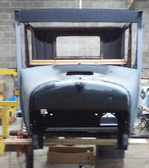

Post by EricMac » Fri Apr 12, 2019 6:21 am
The hood slipped right on the Eyre Torpedo. It's only two inches longer than standard but it looks lick much more than that. And oh what a wonderful optical illusion it is!
Eyre hood
Eyre hood

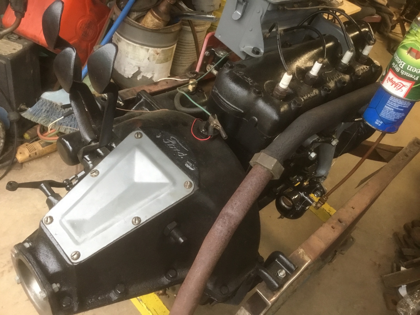

I put the motor back in "Lulabel". My outdoor shop is going to leak tommorow so won't get it running until next week. Looking forward to driving the for-door. The new Z head ought to help her climb the hills better.

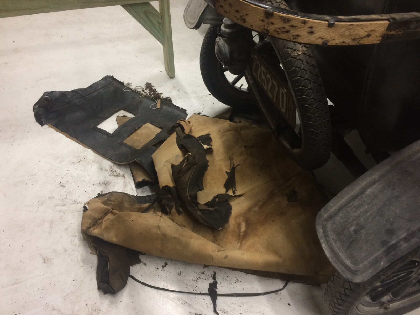

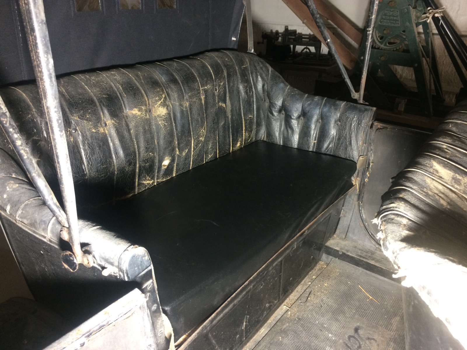

Post by D.Yoder » Sat Apr 13, 2019 12:52 am

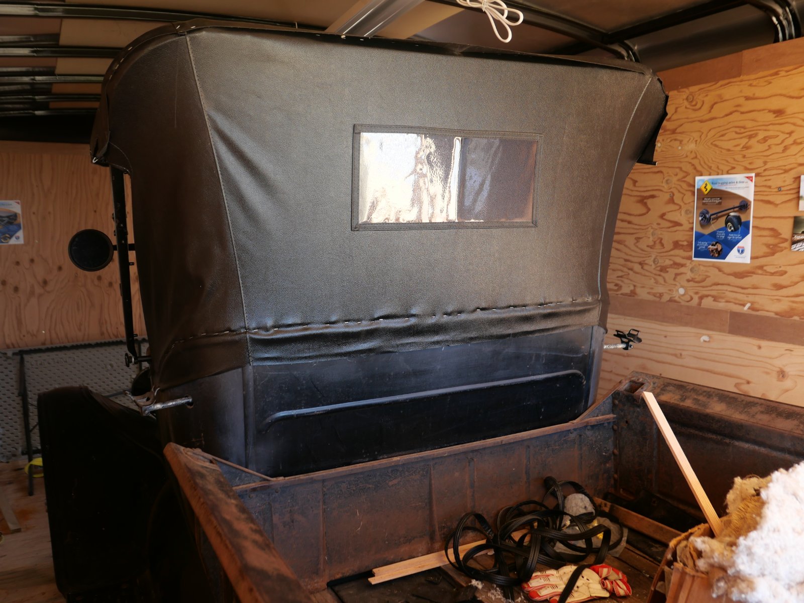

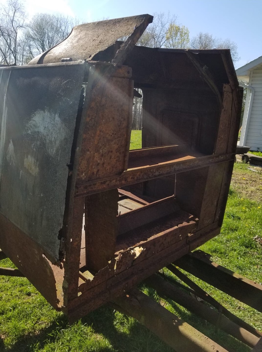

Removed my 100 year old top

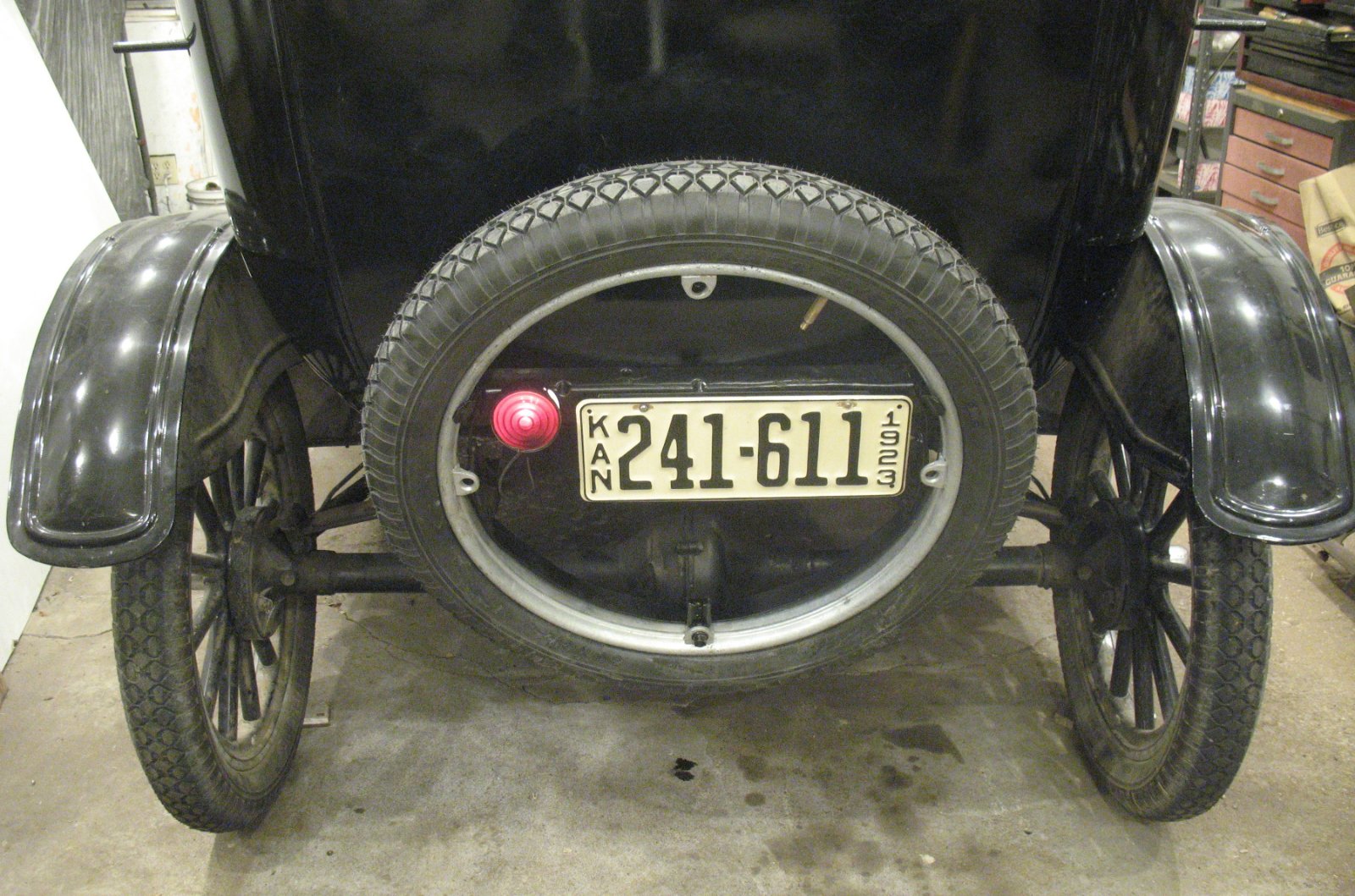

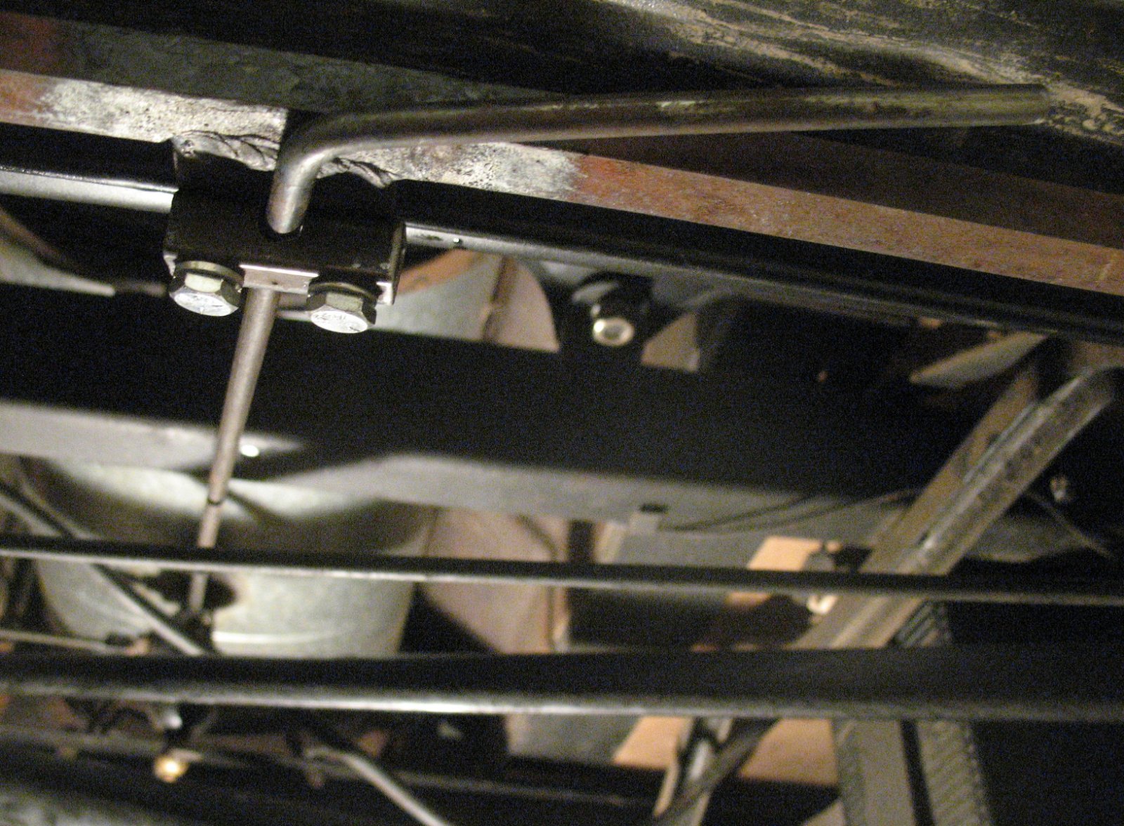

I finished something today! A couple of somethings, in fact. Accessories to enhance the driving experience.
The first project was a pair of extensions that will allow me to back up without getting my big feet tangled in the pedals. Nobody will ever accuse me of being a skilled welder, but I don't think these will come apart.
This one is for the touring and the other will go in the runabout. I could have bought prettier ones for $60+, but these are from scraps and materials on hand for no cash expenditure.

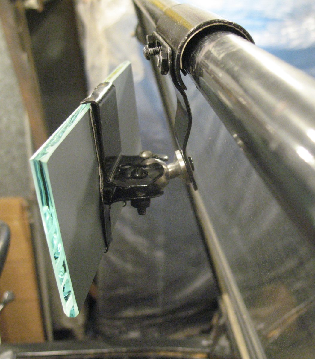

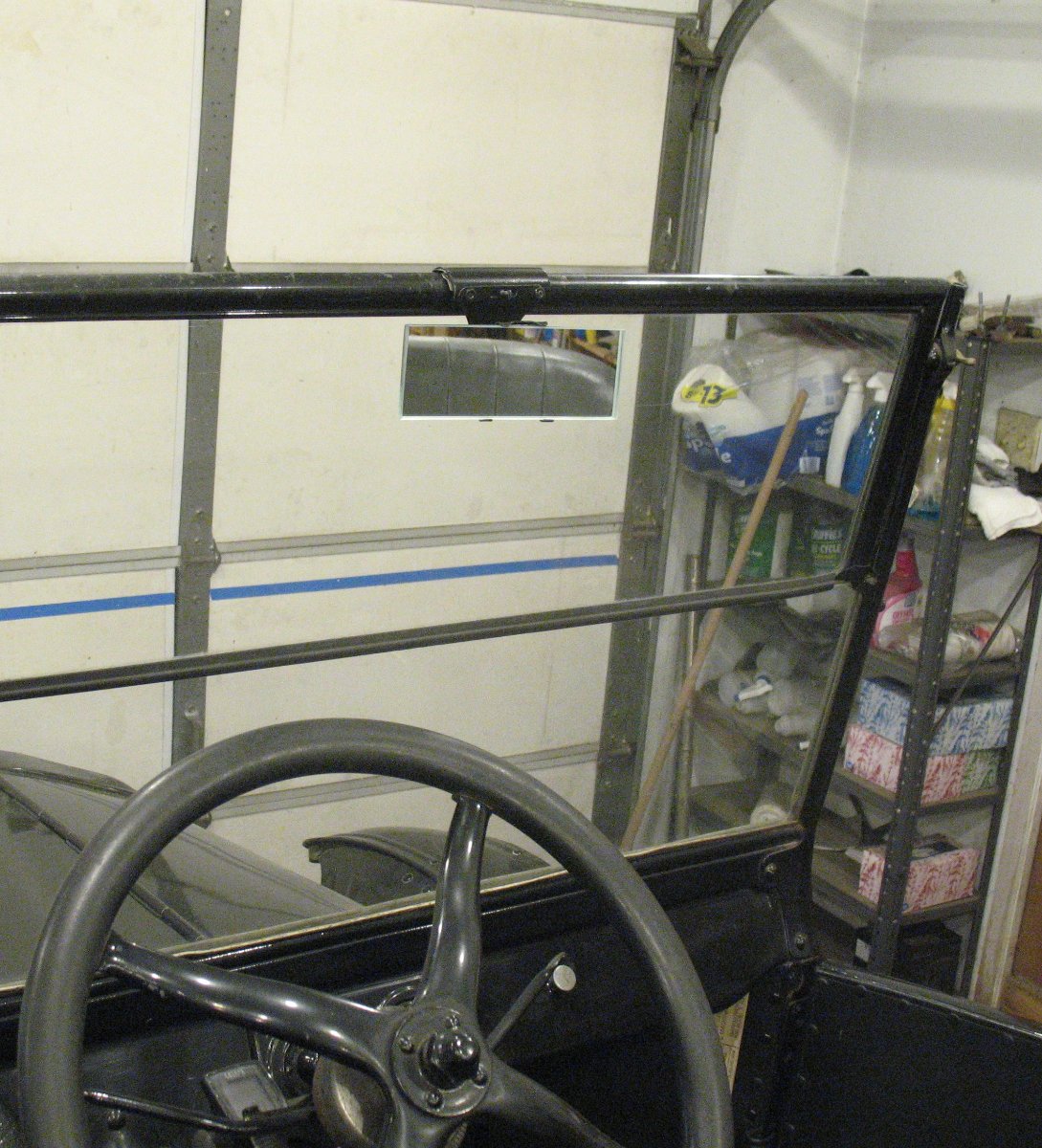

The other improvement is this mirror for the touring. The cash spent on this was $2 for a new mirror, as the old one was pretty bad.
I found the original mounting hardware in my parts room, but there was no clamp to hold it on the window frame. So I made one from a piece of 1" conduit.
This should keep me informed if anybody is sneaking up on me from behind.

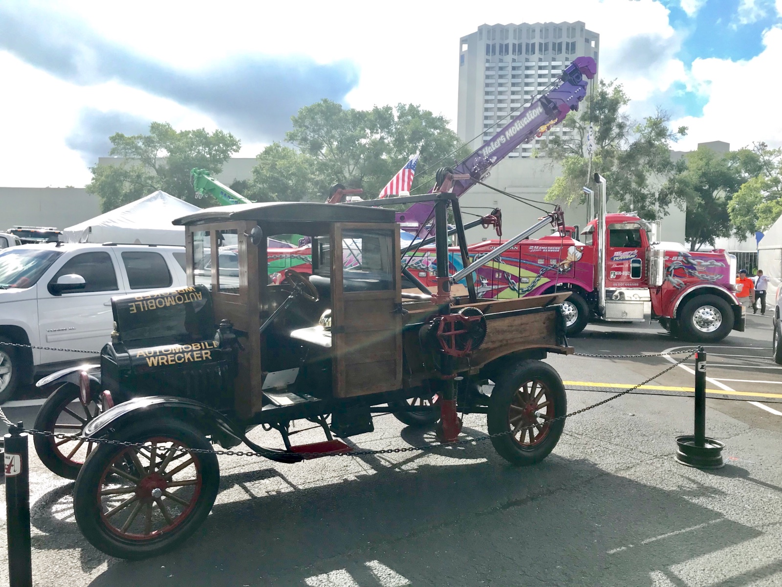

Took the ole boy to the 2019 Florida Tow Show in Orlando.
Was parked next to a 2018 Peterbilt/ Jerr-Dan 85 ton Rotator. (2 drive axles, 1 bogie, and 2 steer axles).
We’ve come a long way in 100 years !

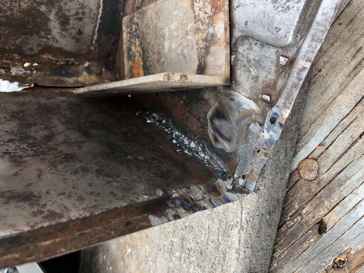

Welded (dropped metal balls) six small pieces to the right A-pillar which is the final body piece that rests on the sub-frame. It's only been several years to get to this point, working off photos without dimensions. Finally, was able to test fit the front and back body halves of the coupe together to see what needs to be fixed. Can't replace the skin yet as it would get in the way of welding things in place. I learned that there was no way for Ford to assemble (rivet) the body frame to the sub-frame at the factory with the skin in place on the improved models. I dunno, maybe he did anyway.

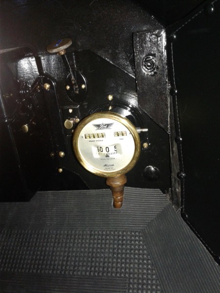

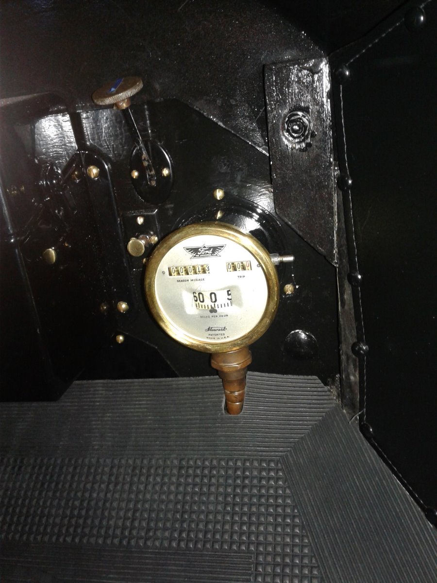

Post by WayneJ » Sun Apr 14, 2019 11:28 am
I installed my speedometer in my 1915 Runabout:

Post by JEC » Sun Apr 14, 2019 11:41 am

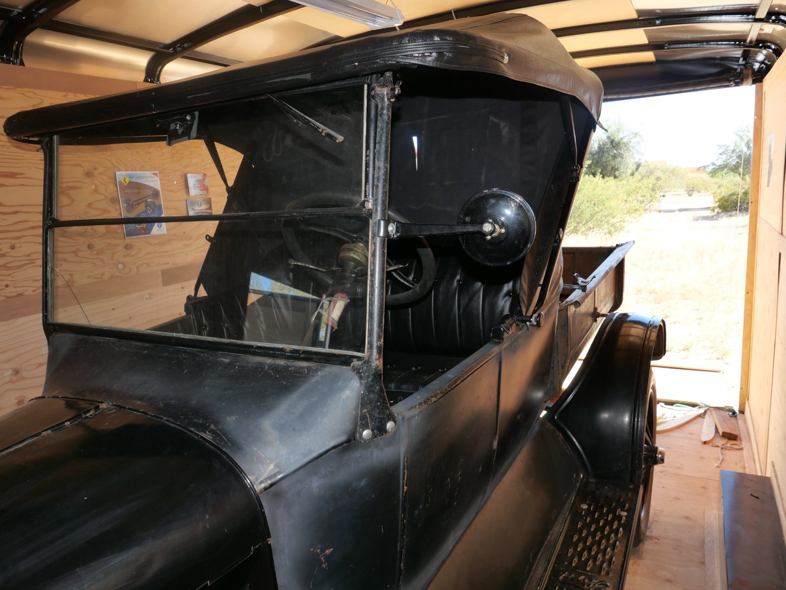

My wife goes to a quilting romp with her Missouri girl friends every year in April.
This year I hauled my 25 pickup back and my friend Wayne Ringgenberg helped me put the seat back upholstery and top on.
He knowing what he was doing as opposed to me did most of the work.
We only had three days to complete the job and we are both over 80 years of age so I came home with some minor unskilled jobs left
Posts: 6817
Post by Scott_Conger » Sun Apr 14, 2019 12:19 pm
Looking good, John!

Post by Daniel828 » Sun Apr 14, 2019 11:20 pm

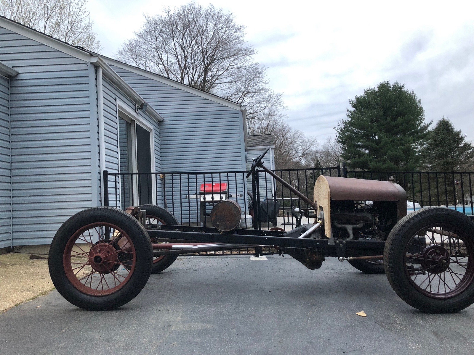

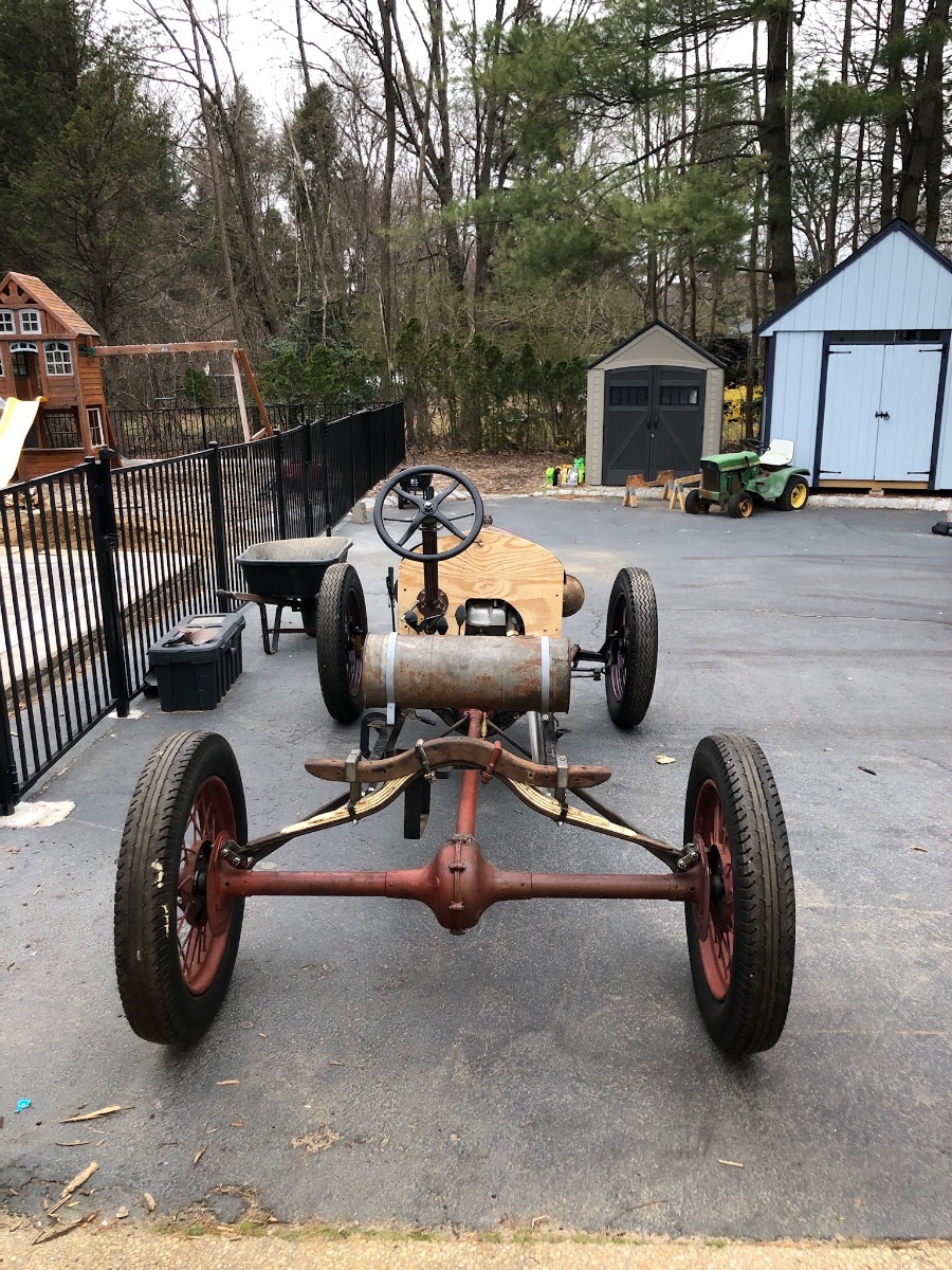

I rolled my project out of the garage the other day for the first time ever. This car was made from parts acquired from friends and visits to Hershey
It was going to be a speedster but I’m changing direction and I’m going to build a depot hack body for it

Ran the 15 motor a few more times.

I am replacing my rotten tires and while I have them off am refinishing the wheels.

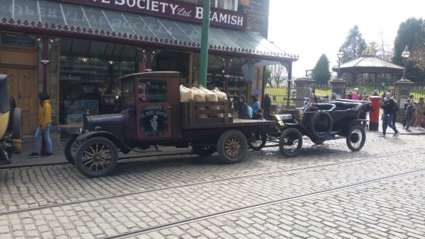

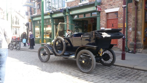

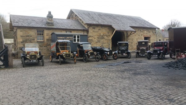

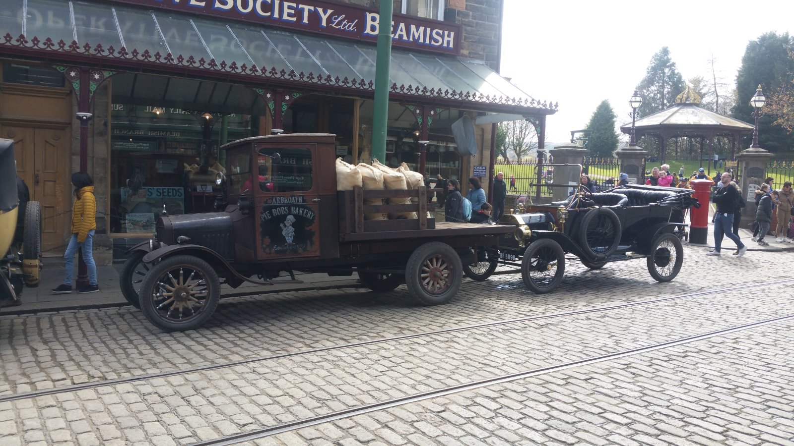

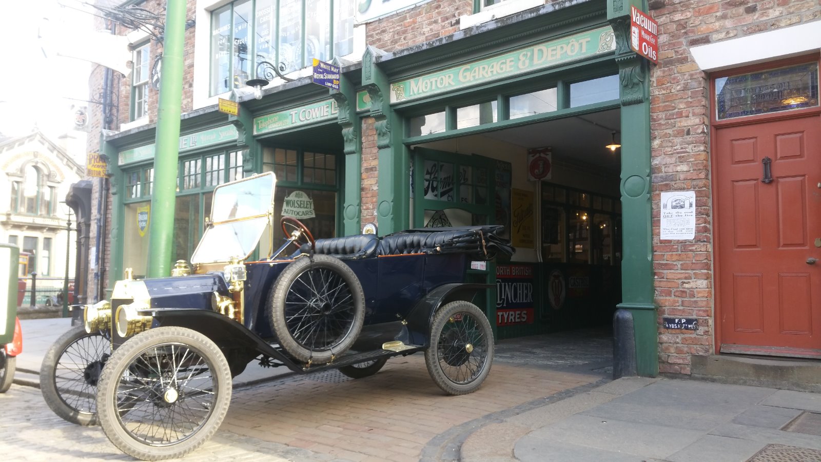

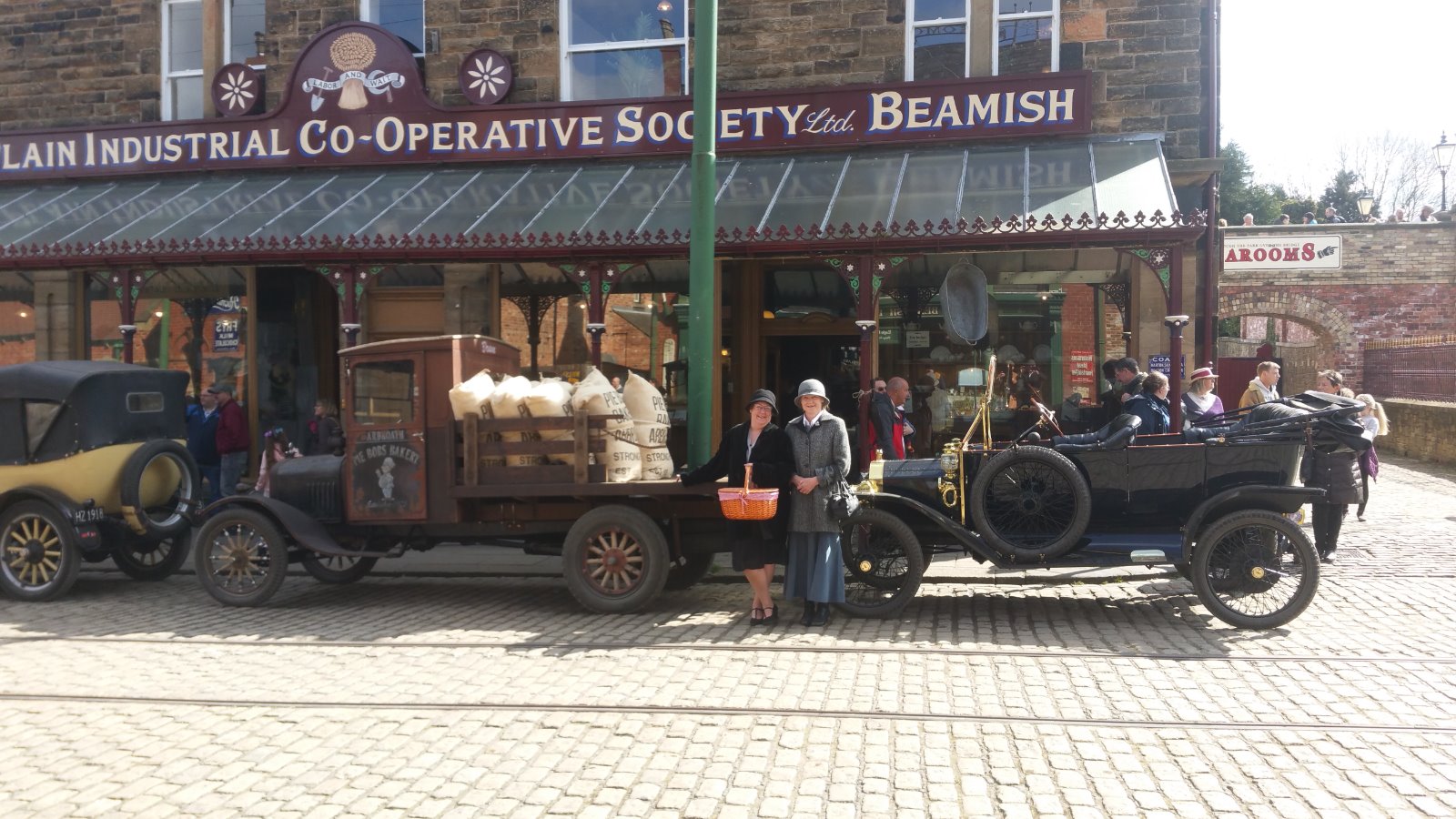

Last week we travelled down to North East England and had 4 excellent days at Beamish ( The living museum ) Great North Steam Fair. All vehicles pre 1930 and a great selection of T's, including my friends ton truck and my 13
Link to youtube video https://www.youtube.com/watch?v=2sc92N_lmY0

The Eyre Torpedo continues to make steady progress. The side lamps and top bows are now in place. Meanwhile Gord Koll finished my replacement dadh for my '13 Touring. It's a work of art.

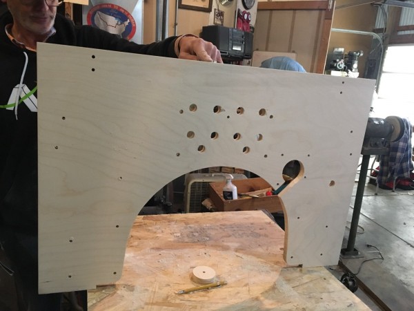

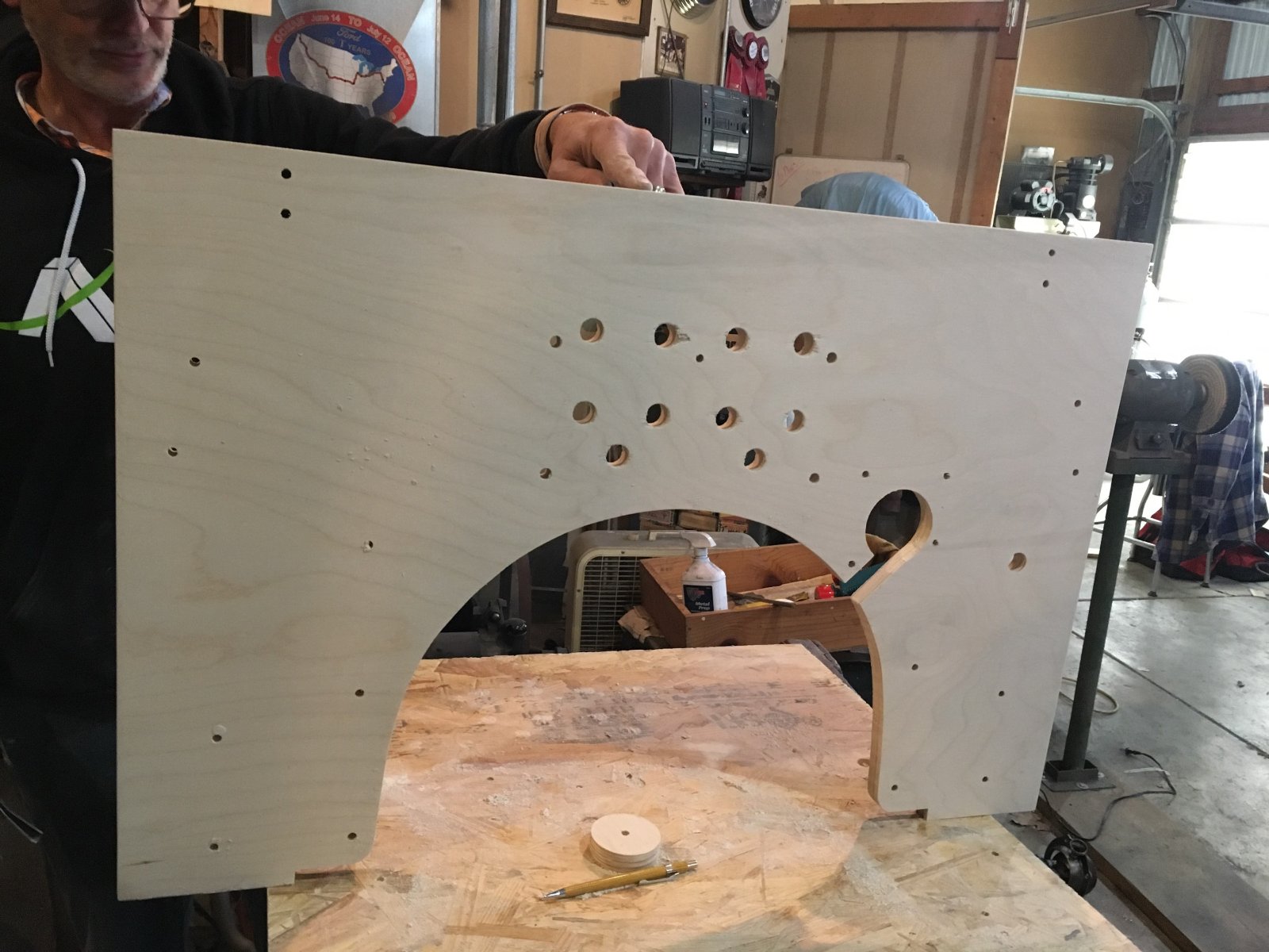

My 13 Dash. Thanks Gord! I have been trying to decide if I will make it look "weathered " to match the rest of the car or factory new. Right now I am leaning towards new.

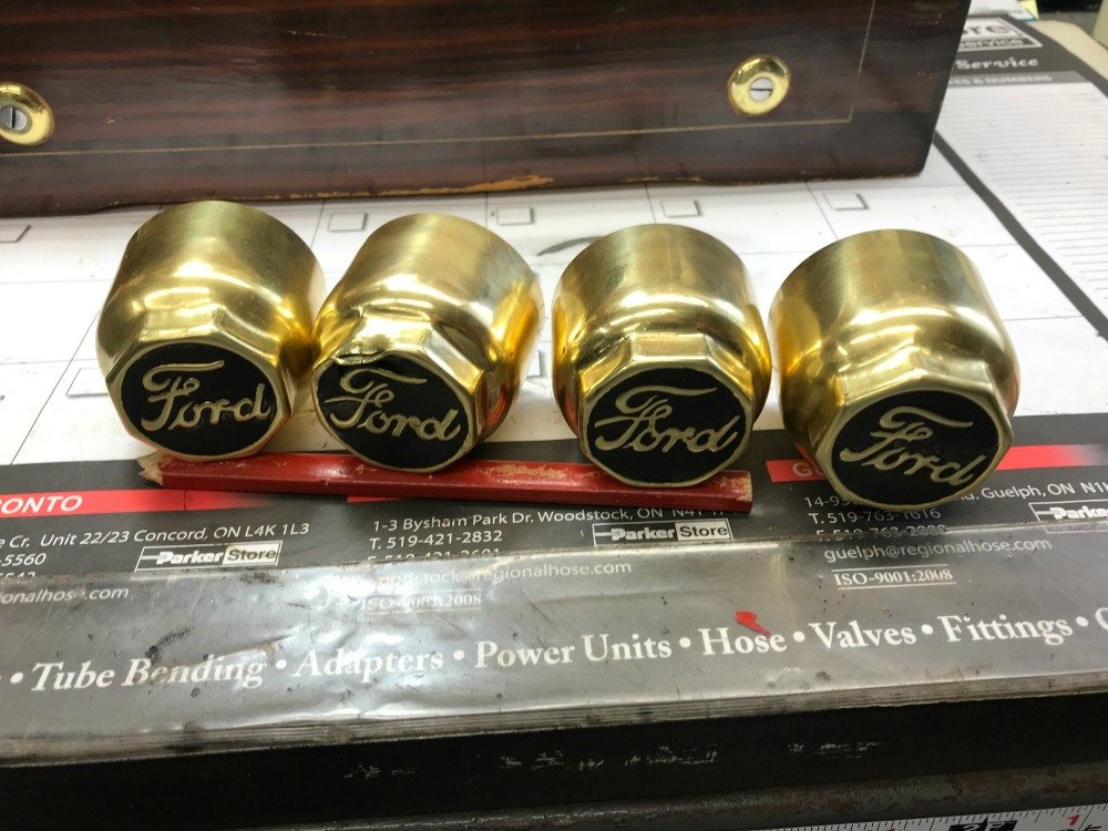

Painted my hubcaps for my '13

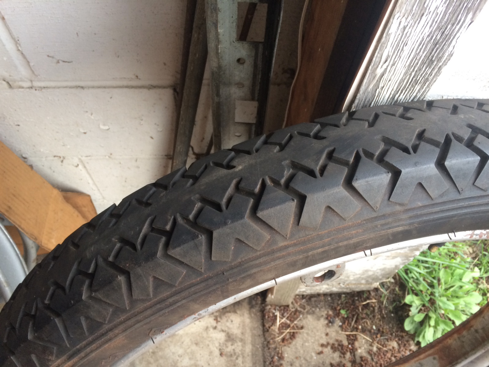

Ain't nothing special really--just started putting the white ribbed tires on the '13. Rear done now...maybe Monday or Tuesday the front and then I can take her for a spring spin!

Post by fbergski » Sun Apr 21, 2019 5:52 pm
Drove Isabel to Cars & Coffee yesterday, spent most of my time explaining how oil lamps work!!

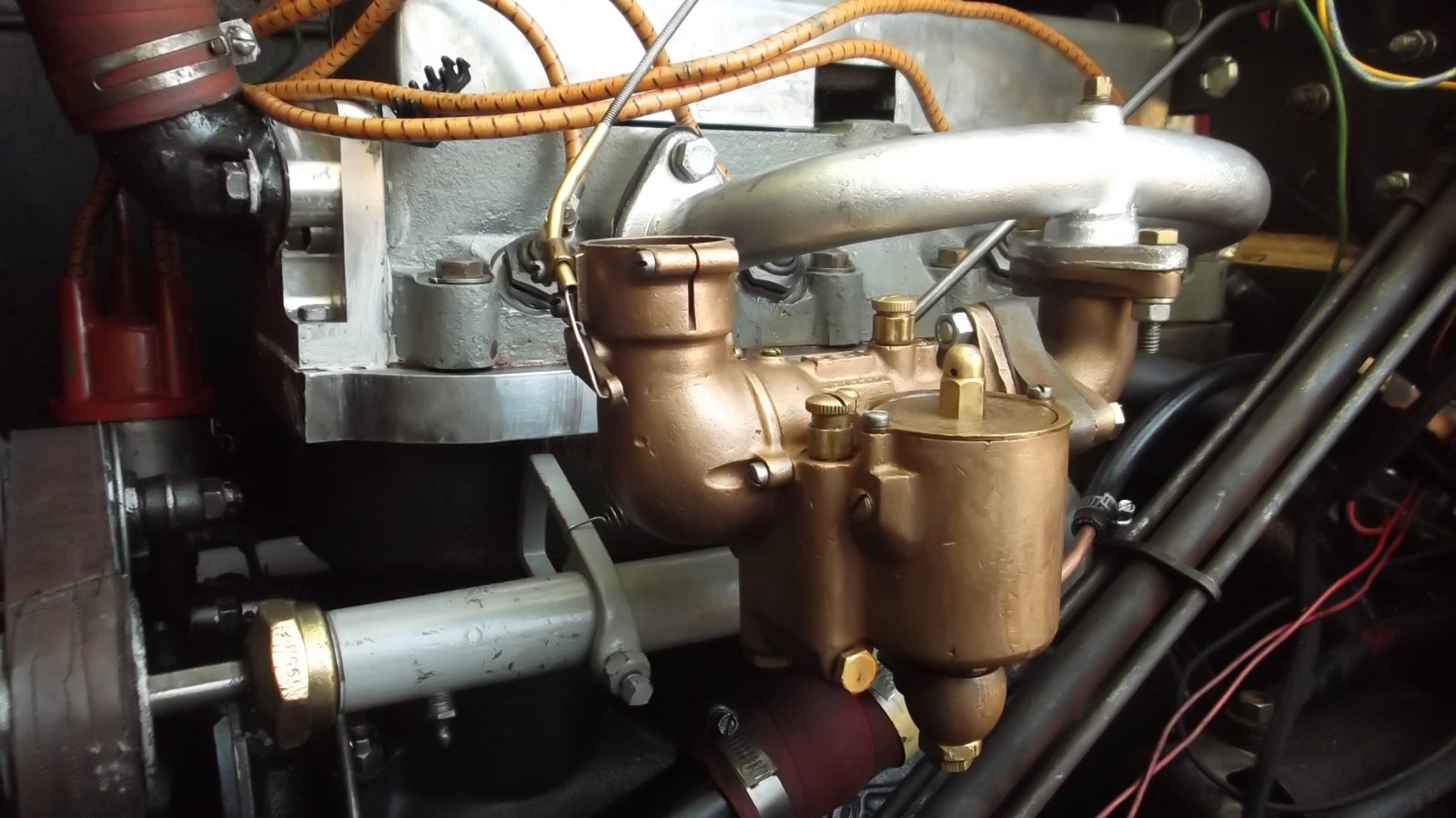

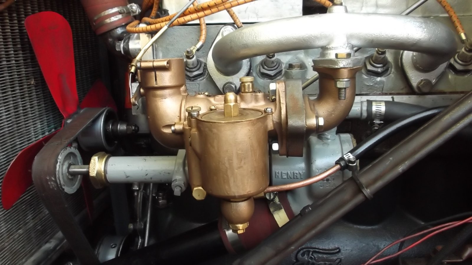

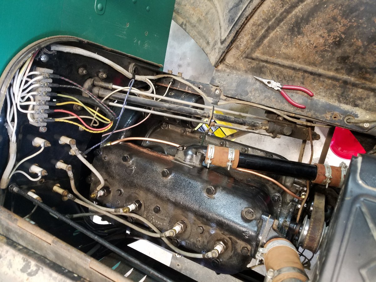

I decided that after all the work putting the Chevrolet overhead on my 21 that I was going to keep it. I put new rings in and took up the rods a bit. Because you are using 7/16 bolts in 1/2"+ holes it gives a lot of latitude to where the head sits so this time I installed locating pins where I wanted it to sit. The holes were a bit bigger then the pins I used but they are only there to located to install not keep it from moving later
I also decided to replace the valve springs. Took a bit of searching thru the SBi catalog but found some that were withing the ballpark. To get the compression at working height I added shims at the top, no room at the bottom. Didn't want something too strong because A the cam is not that strong and B didn't want to break the rocker arms.
I also plugged the unused rear water passage, took a little more off where the plate meets the block at the fire ring. And yes I am after coating very well with copper coat am reusing the two head gaskets.

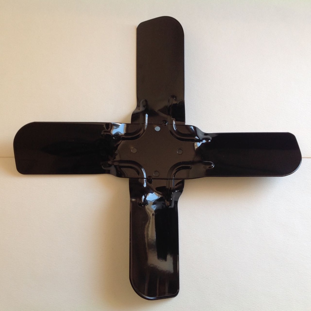

After searching for a 1926/’27 fan at Bakersfield. (The one I did find was cracked.) I ordered a new reproduction fan from Snyders. Very pleased with the quality of the reproduction fan. It is well made and looks exactly like the original. The holes lined up perfectly. It even comes black powder coated for durability. Anyone who needs an “improved” fan will not be disappointed.

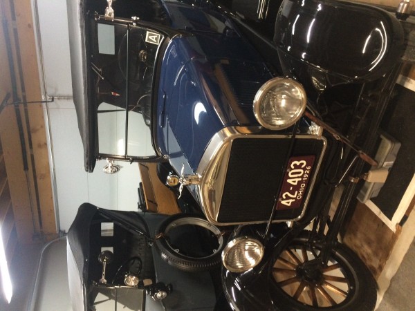

Stuck indoors on a rainy day, I installed the spare carrier on my 1923 touring and mounted a spare tire. Little by little I'm getting the car ready to make some trips.

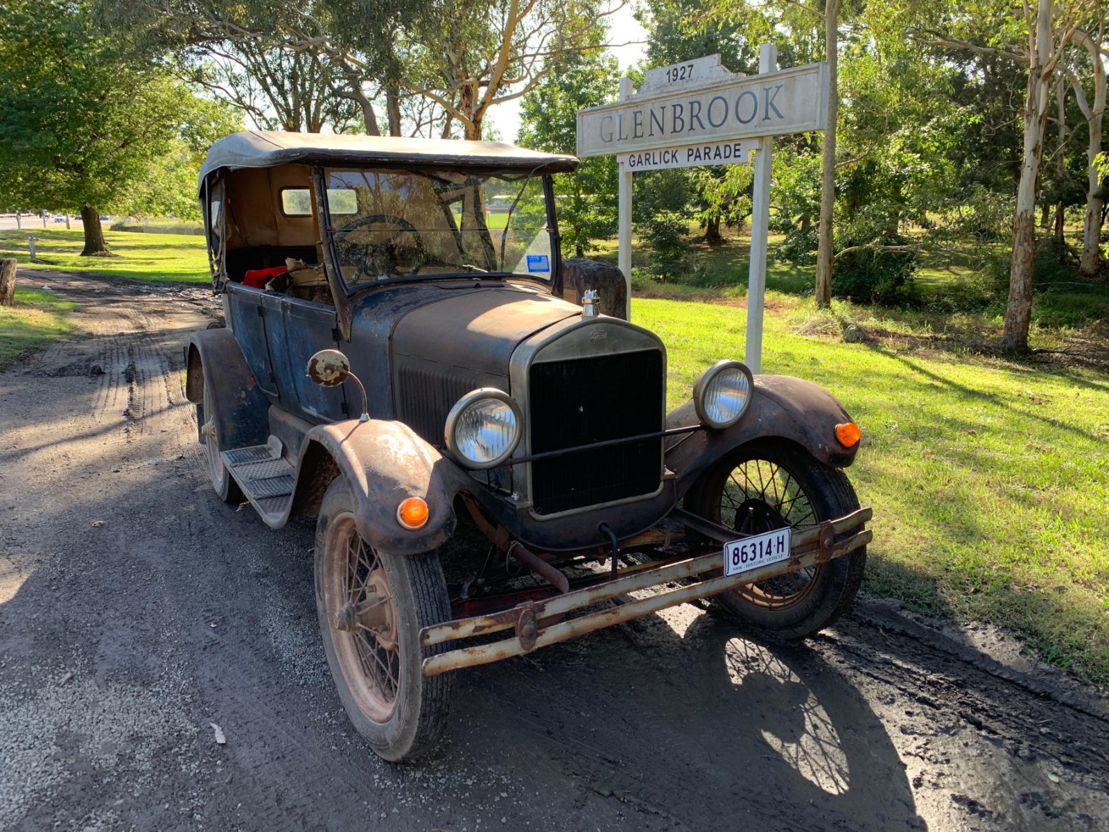

I finished my Speedster build.
Well, finished it enough to be able to drive it, register it and put licence plates on it for the first time.

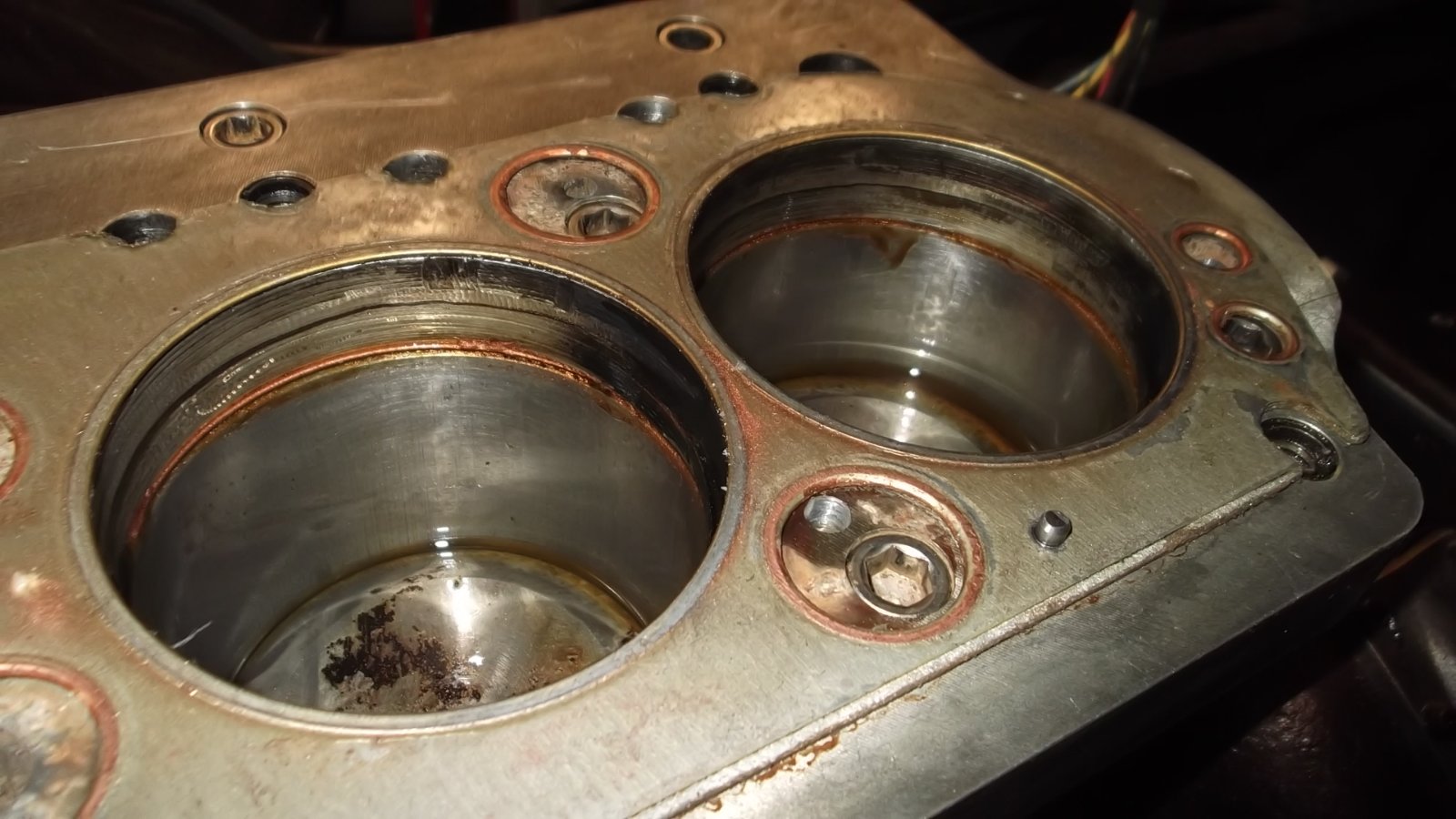

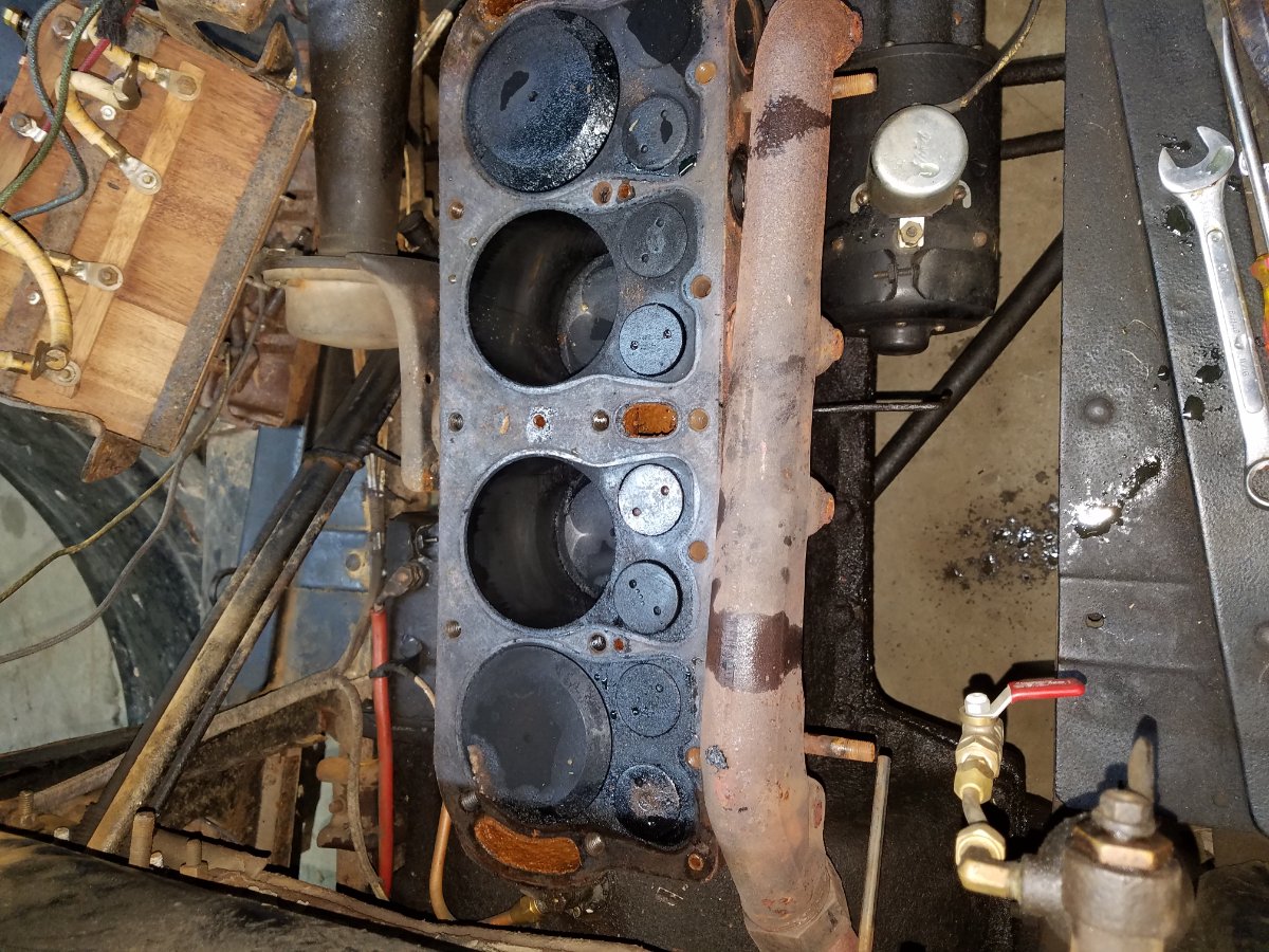

Then I done a compression test on the RPU and found #3 at zero. Pulled the head and decided new valves and tappets are in order

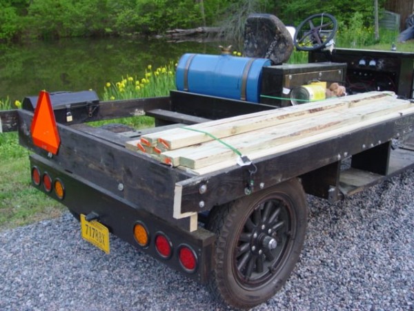

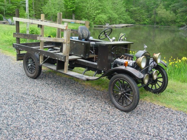

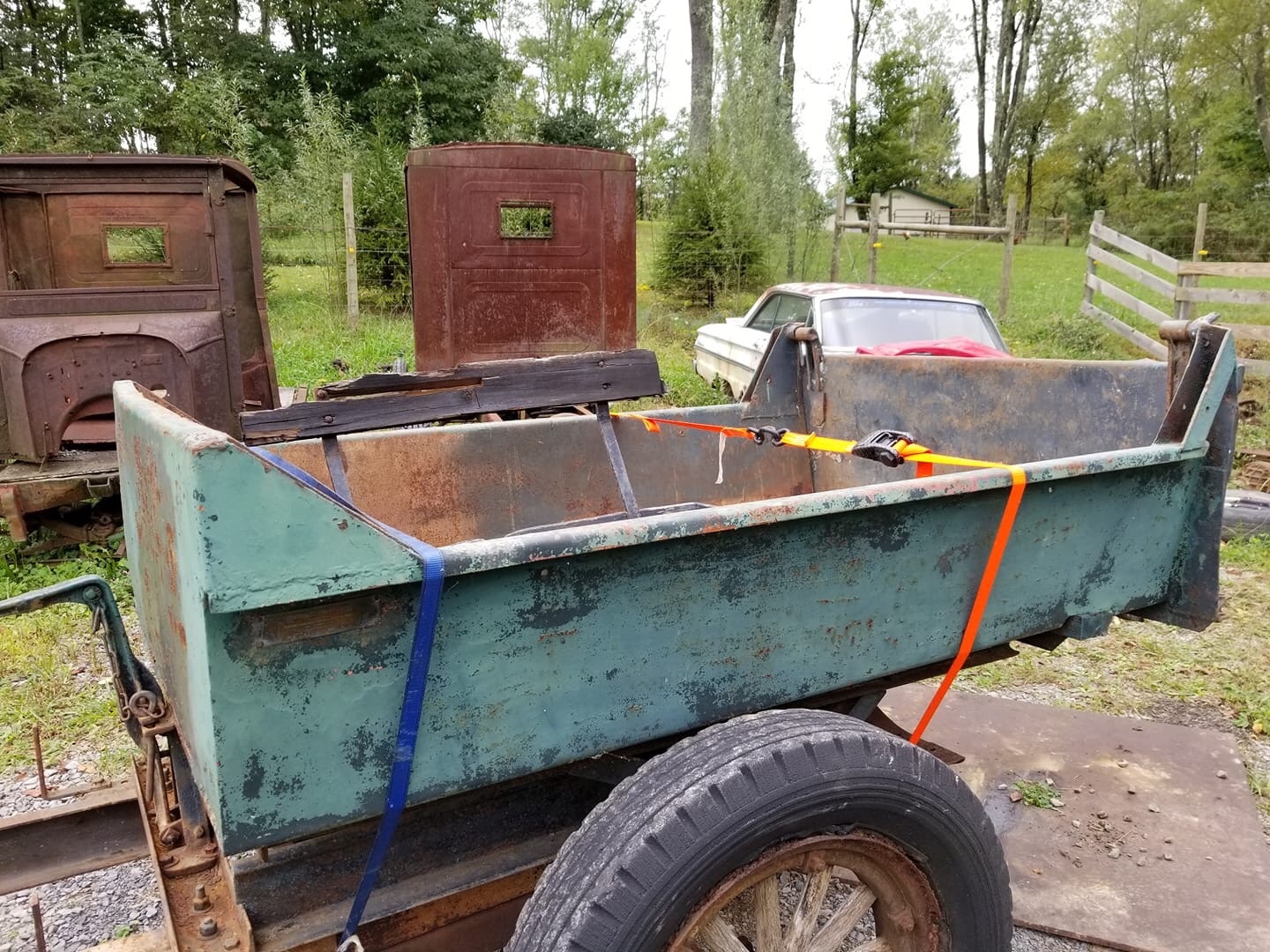

Well thought I had my 20 yr project sold to a fella in NJ and then the tax man hit him. So, I decided I better go ahead and get it running again. Swapped out the incorrect low radiator for a high radiator and dinged up nickel shell. Mounted the rebuilt carb I bought from Tom Strickland last year at the Marietta swap meet. Ordered a fuel shutoff valve, fuel line, packing and pack nuts from Snyder’s. Got them and got the cab laid back to put the fuel tank in. Started to mount the Ruxtell shifter but didn’t have the right hardware, so got that sorted but not mounted yet. Hope to fire it up this week for the first time in about 10yrs. Cab’s gonna need some love before I mount the bed. It’s either getting my Anthony Autorocker or the original flatbed. Here’s a few pics.

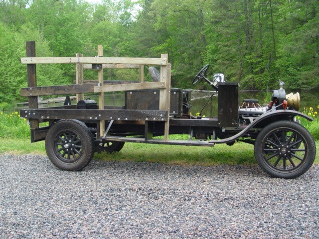

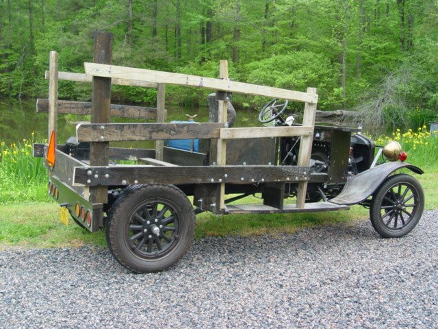

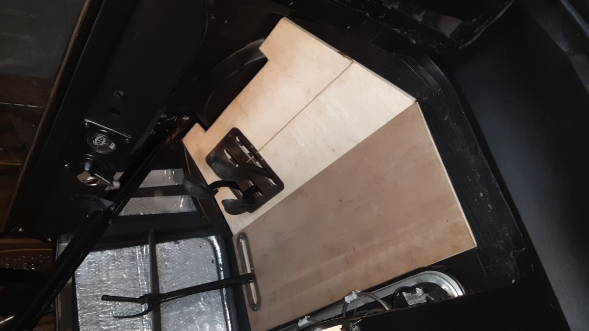

I have started making Ellie Mae's bed. Hope she likes it! All of her wood is salt treated, then I put a penetrating stain on it, she is an outdoors type of girl. The outside frame is done, the actual bed won't take long. The sides are going to take a while, they have to be strong so passengers can push/pull them, but none of the stakes or rails can be straight, level, or plumb. That is where Jed's real carpentry skills will show and I think it will give the truck the Beverly Hills look I am after.

I was busy last night! Next I have to make a removable gate for the back. Passenger access to the rear is across where the passenger seat should be.
I hope I am making Jed proud!

I haven't done a dang thing to it, but I did take it for a ride last Sunday. I discovered a guy with an ultimate man-cave, and another who is a contractor who I may hire to do some work on our house. The T does attract attention. The two guys that I met are into British sports car racing, and were fascinated by the T's wooden spoked wheels.

I replaced my Anderson timer with a TW. Wow what a difference!!!

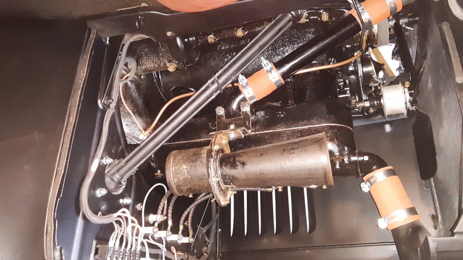

Taking Nelly-Bell the Raloo Rocket on it's first drive after getting new rings and different carb. Put a Stromberg OS-1 on. Photos later. When I get to the shop will re-adjust the valves, they need to be set at running temp. Also need to dial in the carb, right now it is loading up at a low idle. Too fast an idle, hard to get the Warford shifted at stand still even with using the transmission brake to slow the gears down. (might need to adjust the brake band too!)
Posts: 5562
Last Name: Gregush
Location: Portland Or
Post by Mark Gregush » Fri Apr 26, 2019 8:13 pm
Did some bending on foot feed and added a different return spring. Adjusted the valves. Here is my Stromberg OS-1. Still needs a little dialing in but runs better still some popping if I open too fast.

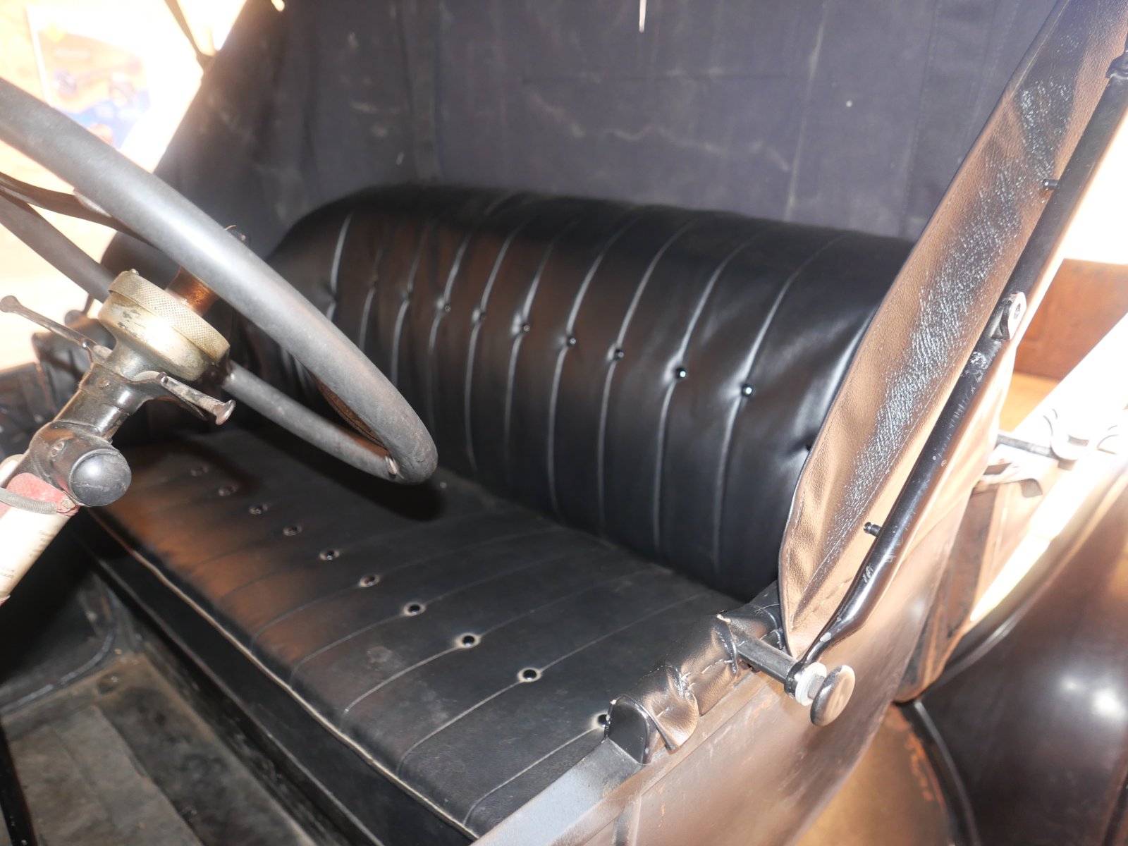

Made seat covers for the 100 year old seats.
Covered the 100 year old holy material
