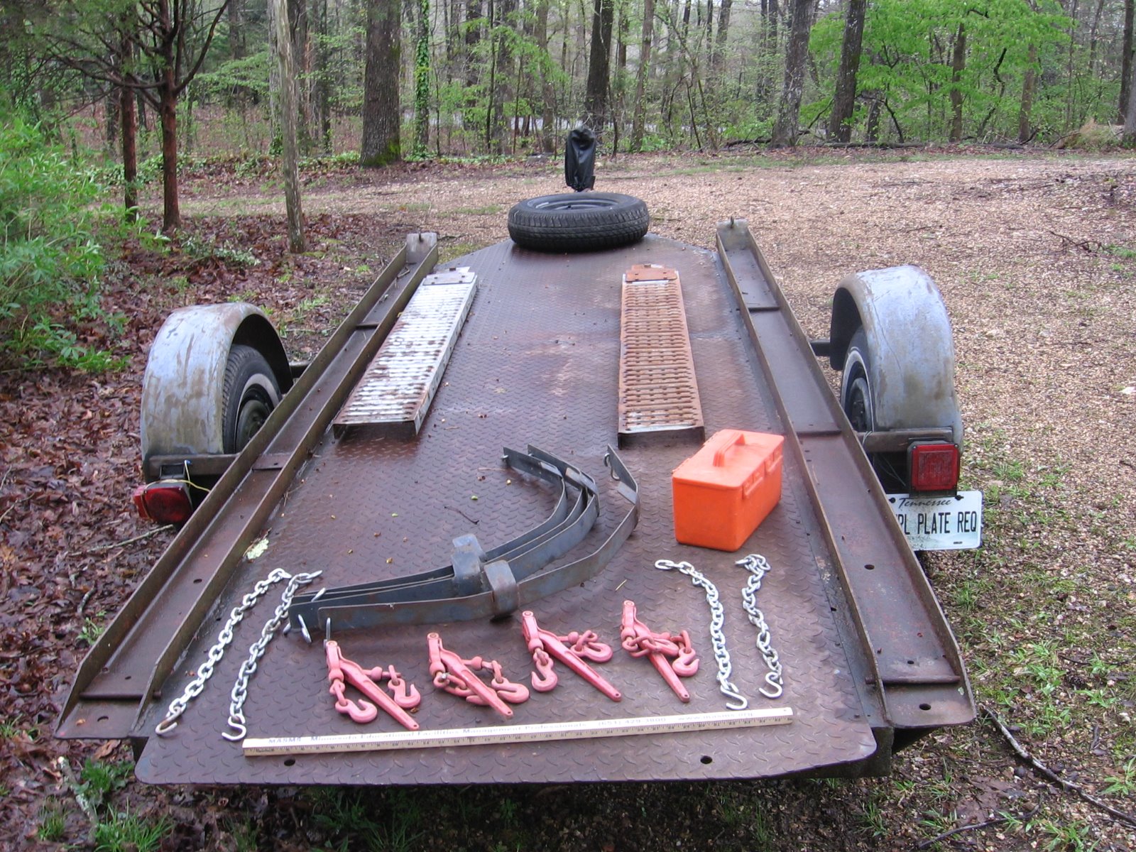

Re: Trailering Questions

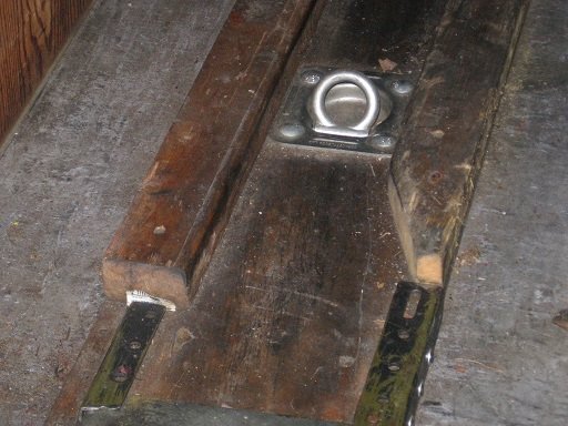

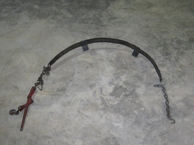

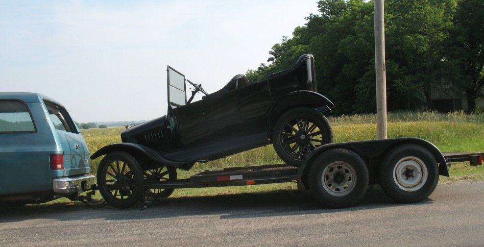

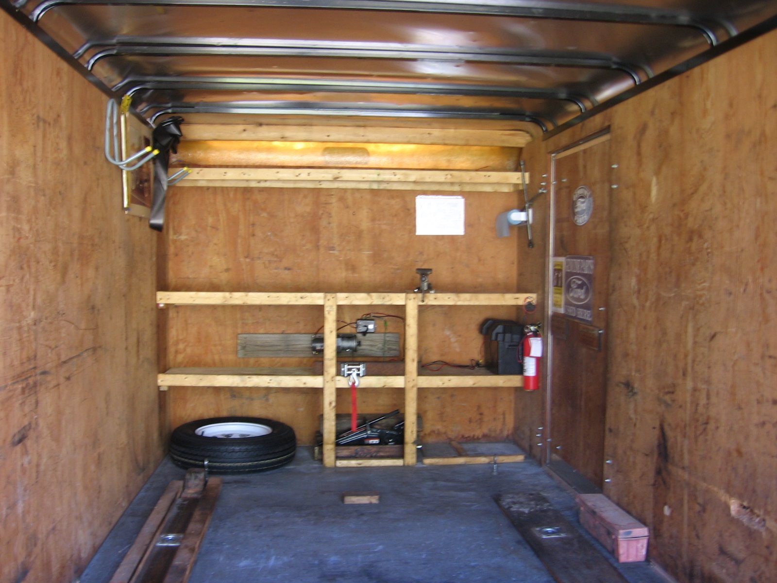

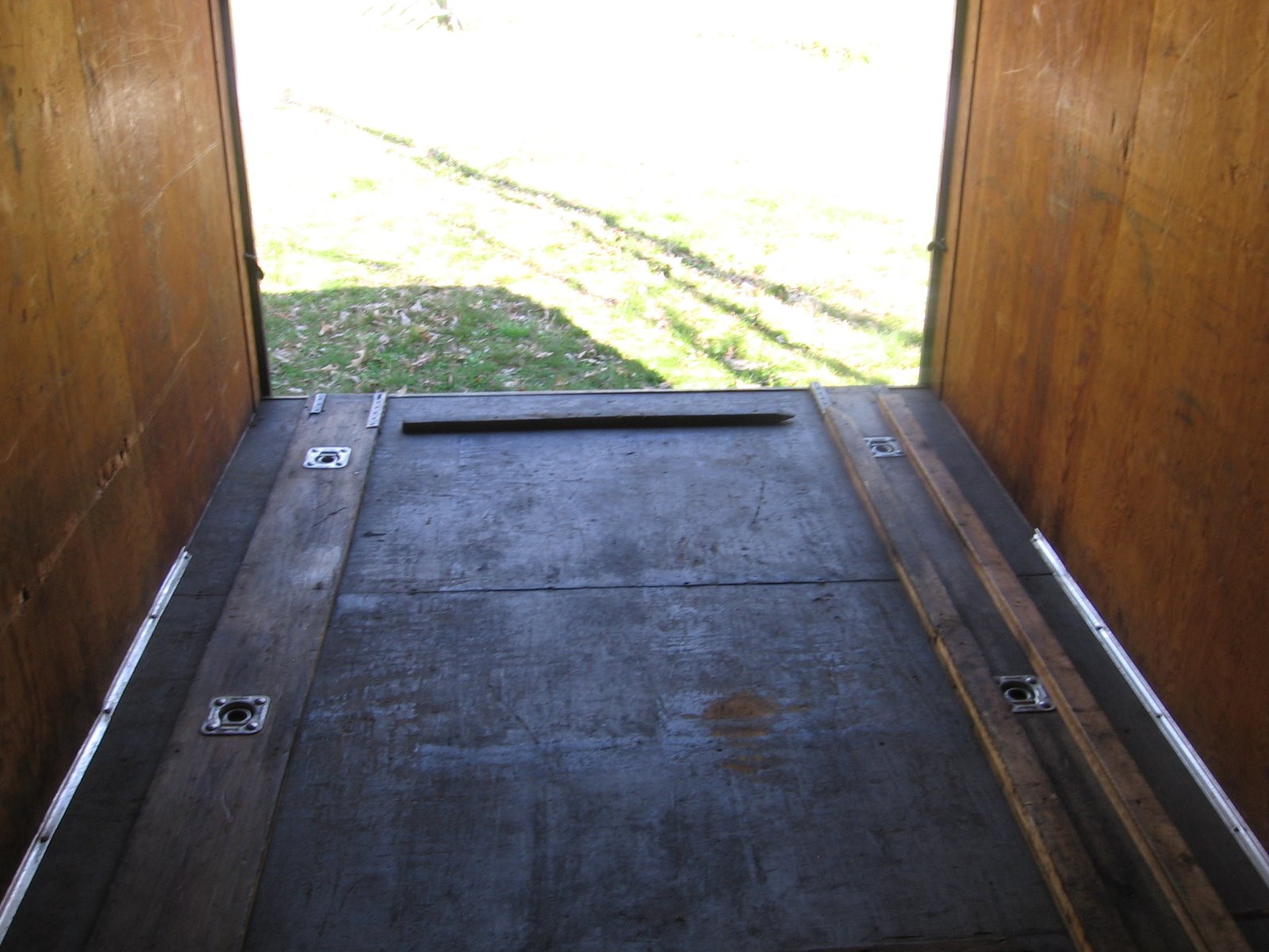

Tim,
Attached are several photos of my open and closed trailers that both use 2" wide, 3 ft. long metal straps with two angled wings (3rd photo) that go over each tire to hold my T down during transport. I do use the hand brake in addition to the tie downs. The enclosed trailer channel on the right in the 2nd photo and on the left in the last photo is 6" wide 2X3s so the T is always centered and will not move. The angle cut on the inside 2X3 is to aid the rear wheel to enter the channel. Let know if you have any questions that I may be able to help you with excluding next week's winning lottery numbers.
Have a great day,
Dom
Have a great day,
Dom

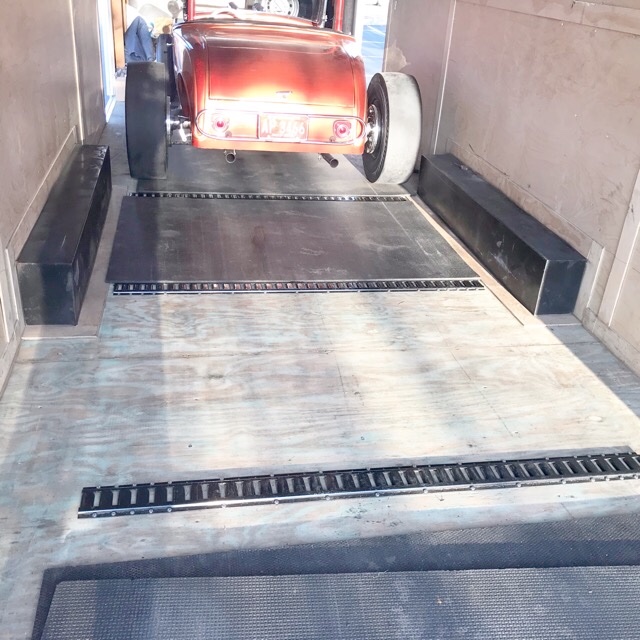

Regarding covering a wood trailer floor ....
Horse stall rubber mats - 4 ft. x 6 ft.
Available at Tractor Supply or other farm & garden
retailers @ $40 a mat.
Easy to replace if torn or damaged by gas or solvent spills.
This wood trailer floor is (10) months old and sees
daily use - yet maintains it’s “ good looks.
By spacing my etrac to accommodate the floor mats - shifting is minimal.
Vehicles to not wander on the rubber mats
if secured properly to the
FJ
