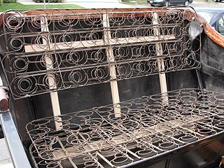

Daniel,... I don’t even know how to use the alleged search feature on the Forum but I always go to google to find my Model T info. In your case I googled “mtfca touring seat wood” and this is one of many pictures that appeared..🇺🇦
Posts: 4689
Last Name: Kuehn
Location: Texas
Re: Front Seat Back to Riser Assembly 1917-22
Post by John kuehn » Mon May 02, 2022 8:12 pm
Your right about that George. That’s how I find T information and it’s faster. The picture you posted is one of many and on the post I made reference to in my reply. And there are many more besides the one on the older post.

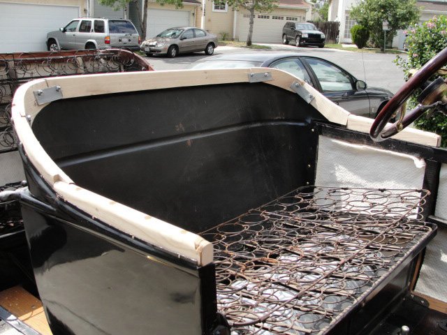

On a 17-22 the front should look like this (that picture looks more like a 15 or 16) the front seat didn't have one of those risers, but the back seat does. The seat back tack rail supports the seat back tin and anchors it to the body wood frame, through the armrests....the springs are tied to the top two seat back tack rail cleats. Now what my car did have on the inside of the seat back tin was a piece of roofing felt to keep the tinniness down...I replaced it with Jute felt.
My touring is an early 1922, with a 2 man top.
Front seat
Rear seat.
Fun never quits!

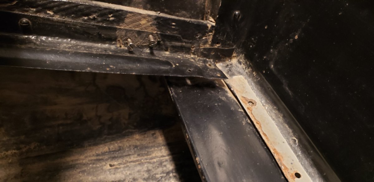

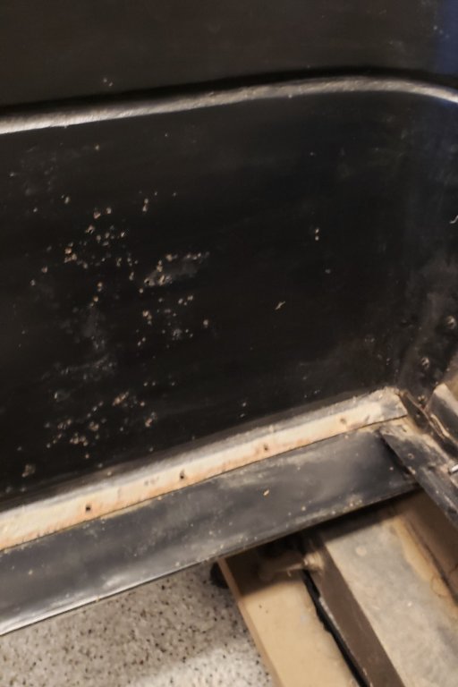

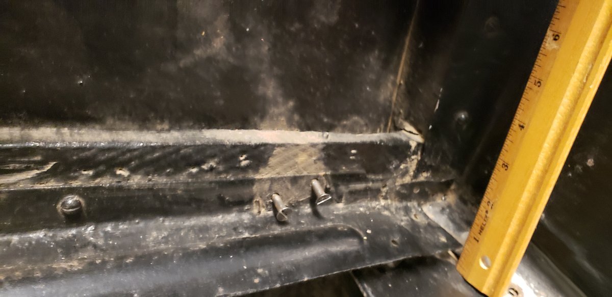

Marty, that is a nice looking Touring you have there and I also like the name of your beautiful state, "Commiefornia". I used to live there back in the 70's when it was still fairly sane, I could not imagine what it is like now. Anyway, what I am needing to know is how that front seat back attaches at the bottom to the front seat riser and kick panel. Here are some photos of my 21. I also seem to have quite a gap between the side seat rail and the rear kick panel. Isn't it supposed to be flush here?
Driver Side
Driver Side
Passenger Side
Passenger Side
Passenger Side
Passenger Side
