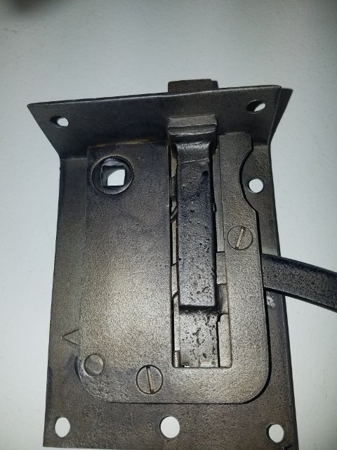

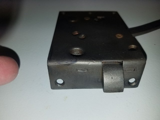

I don't know for which T this latch was made . I'm thinking early 20's coupe or maybe center door. Or something other model. Anyone know for sure?

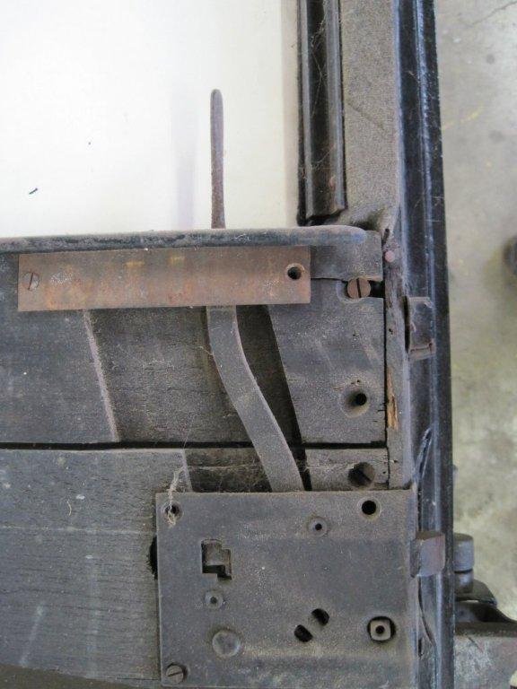

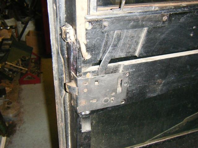

Jack,

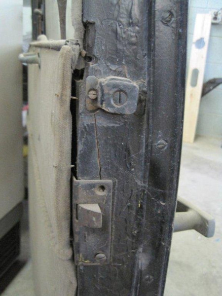

These are the pictures I have in my file of a '22 Coupe door latch before rebuilding. I can go to the shop and take pictures of one that is installed BUT I have the interior installed and would prefer not to remove the door panel unless you absolutly need me to.

Thank you Perry. No need to remove upholstery, your pictures are an exact match. I wonder if it was used in vehicles other than the coupe.

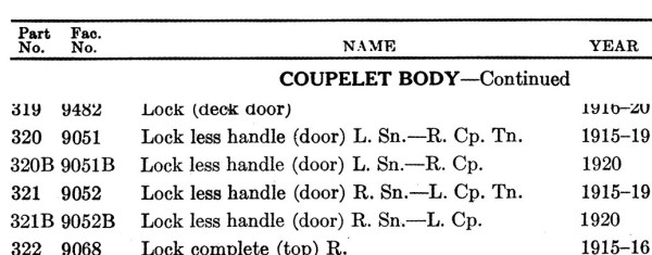

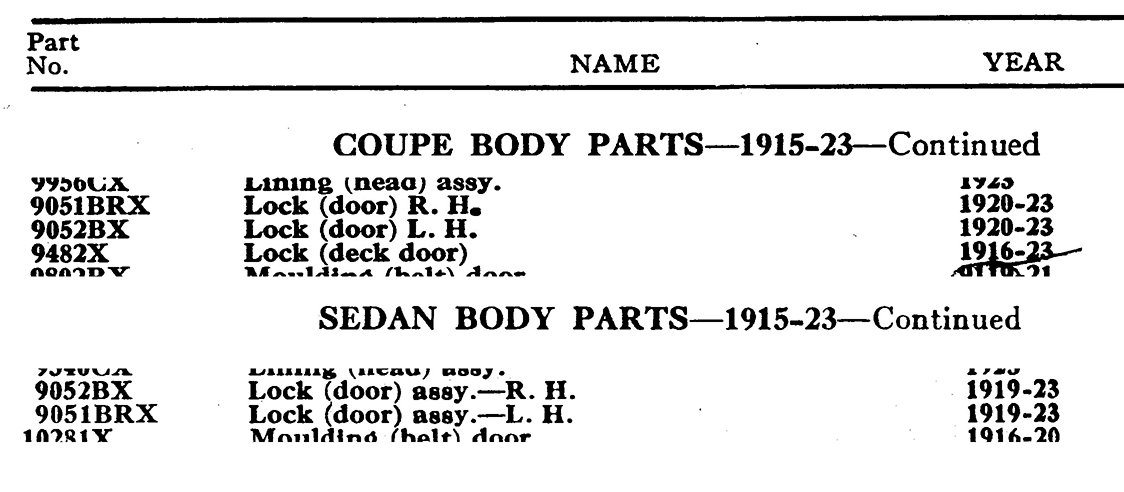

The way I read the part book numbers, the same lock (as they call it) is used on the Centerdoor as the Coupe. Since the Coupe opens backwards Left is Right and Right is Left.
Another book lists earlier "locks for the Coupelet. The numbers are the same with different letter suffixes.

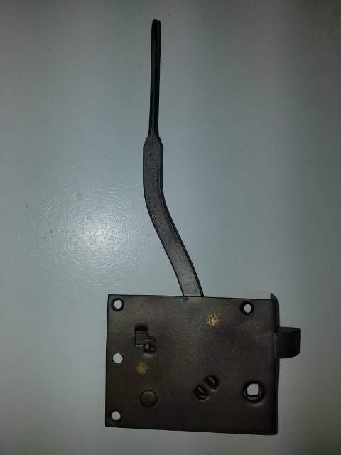

Post by Rich Eagle » Tue Jun 14, 2022 1:35 pm

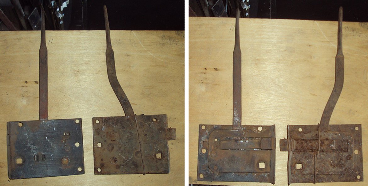

I did find this latch (left) with a straight laver. I guess it would be earlier but don't know what year. It is much the same otherwise.
