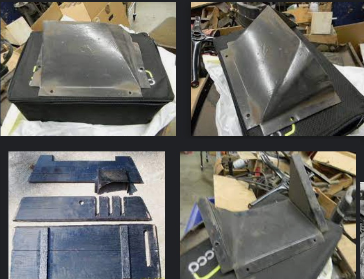

Other options
a DIY solution for under the floor boards --
or
Others have used it as well --
Other options
or

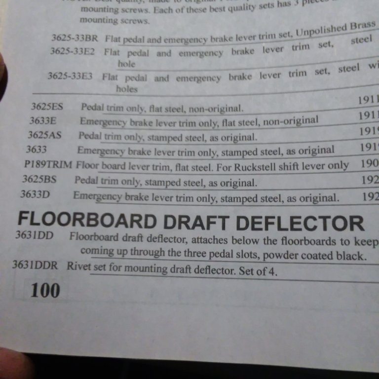

So..... the below pictured "deflector" is found on the bottom of pg. 100 in the 2021 LANG'S catalog. THAT is precisely what I was referencing on my INITIAL post....
I was merely inquiring to see what others had come up with, hopefully on a bigger and more effective scale to increase comfort on a warm 90+ degree New England day..... plans, drawings etc...

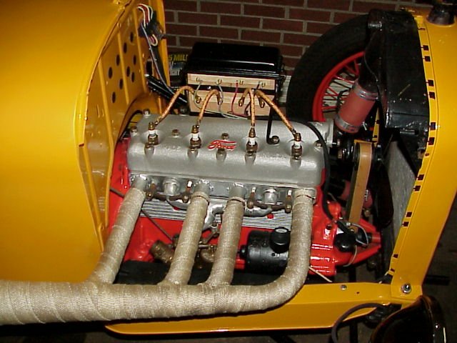

I have used the wrap on my '23 with great success. My '26 project is still in the "R+D" stage, hence the posted topic...

The catalog part to which I was referencing in the initial post...... Had no idea of scale not had I ever seen one installed on a car.
And that's probably because THEY'RE NOT PRODUCED anymore!
UNAVAILABLE last time I asked.....

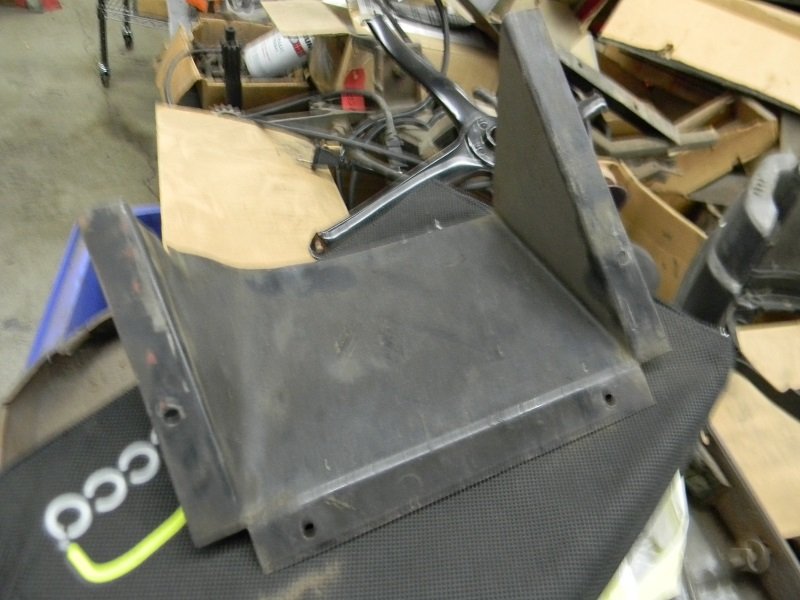

This link has some better pictures of the draft deflector. http://www.mtfca.com/discus/messages/50 ... 1443449023
The round side would rest on the hogs head

My 24 Coupe has the draft deflector as pictured. First time I thought about it since it was mentioned here. And it does work. That’s another accessory that does work. I inherited the 24 in 1958. It must have been on the car at least since then and probably longer. So the idea of a deflector has been around a long time I guess.

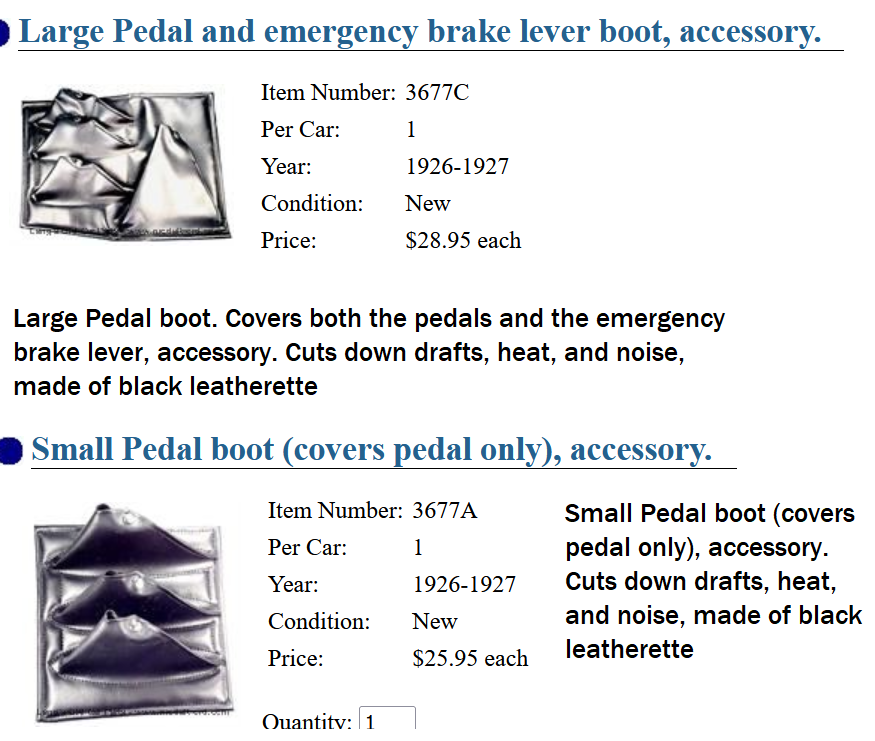

My '27 roadster has engine pans and a deflector. No pedal or brake lever boots, and no Ford floormat. I don't get much heat from the engine in the car.

Well maybe we're onto something then! Perhaps those "splash shields" are really "passenger compartment heat deflectors"
So we have a good test case to see what works for the Professor
