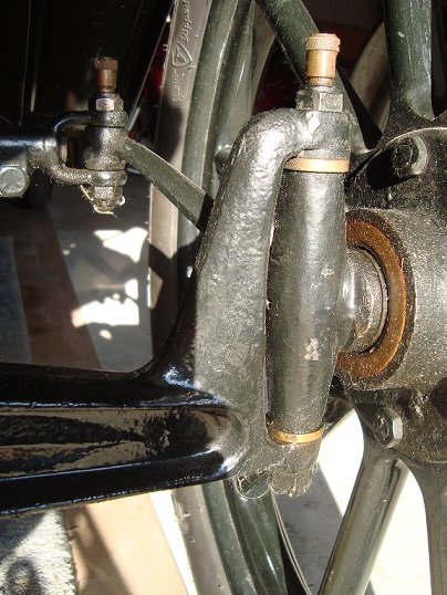

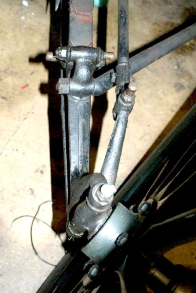

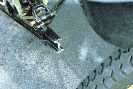

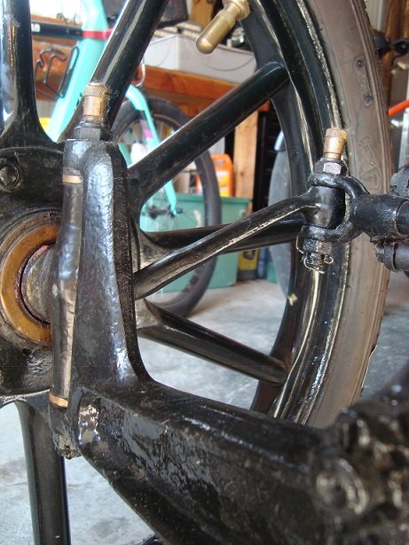

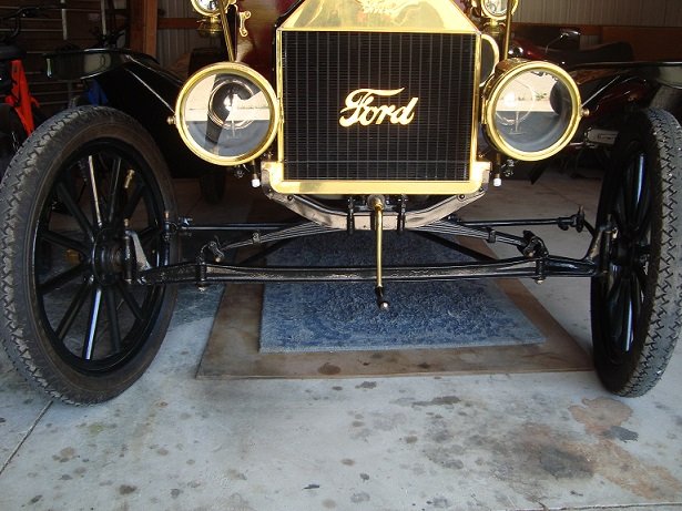

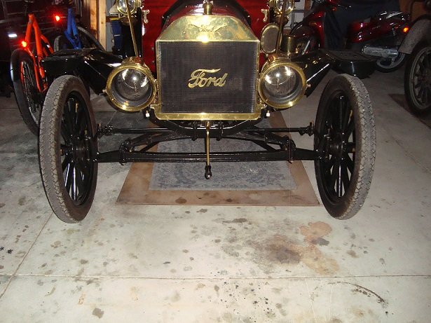

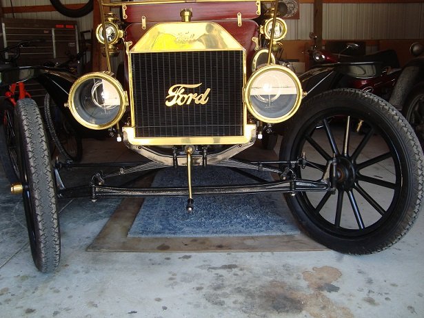

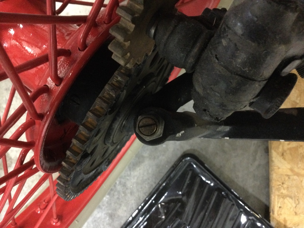

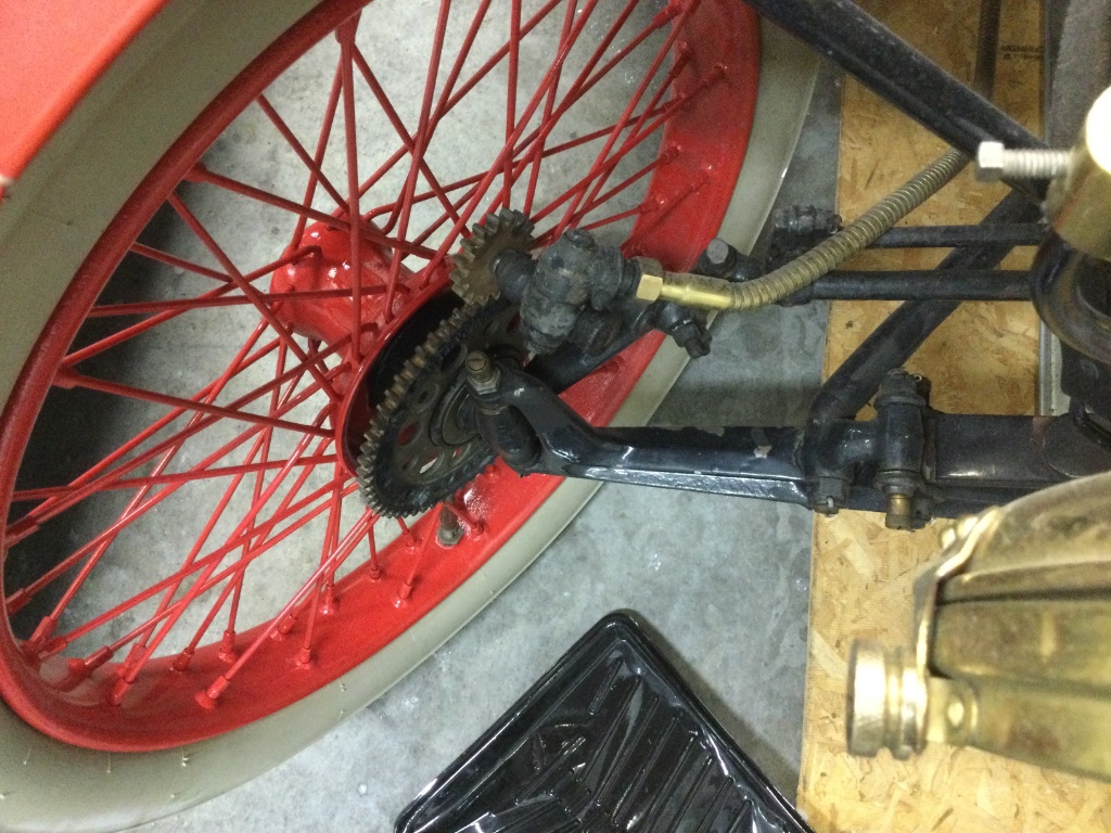

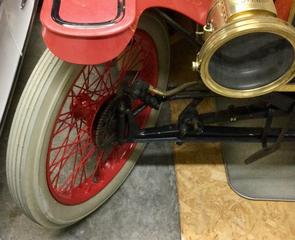

Here are some pictures I took with my old digital camera; the first is an overhead shot of the troublesome spindle hitting the axle and the other two are self-explanatory. Hopefully,
this helps.

I’m starting to think my toe in is off: what should it be?
ThreePedalTapDancer
Posts: 1736
First Name: Ed
Last Name: Martin
Location: Idaho
Re: 1910 Steering issue question
Post by ThreePedalTapDancer » Tue Jun 28, 2022 3:56 pm
My wheel turned all the way, arm does not make contact with axel. Your arm may be bent, or you might have 1921 one piece spindles on there not 1910 spindles
Posts: 6607
Post by TRDxB2 » Tue Jun 28, 2022 4:12 pm

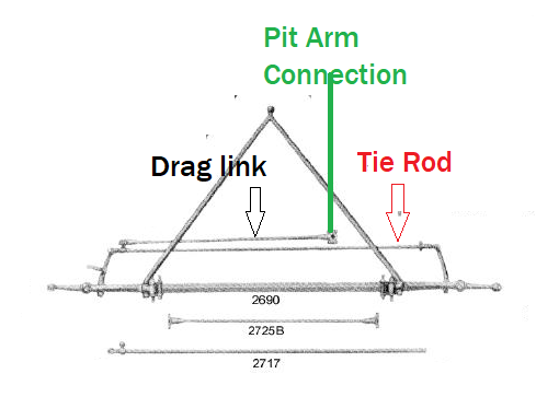

I can see where the drag link could cause a difference in movement of the spindles. Also if the adjustment of the tie rod was not made with the pit arm in the proper position or a combination of all these. Pictures help

I think I see your problem. You have the correct fine threaded drag link. I don’t know the correct lenght but your link may need adjustment. Adjust at both ends to leave about same amount of threads showing. This should place your steering pitman arm in the correct position if you have the correct pitman arm.
The 1921 one piece spindles were used with the later 1919-27 under axel wishbone. The 1921 steering arms would have the offset up to clear 1919-27 wishbone.
To get close first set for correct toe in with the drag link disconnected. Next place steering wheel so that the pitman arm is strength down. Adjust drag link to the measured distance between pitman arm and tie rod ball, having about equal adjustment treads showing at both ends of drag link. You should now have a centered steering and about the same turning radius both left and right, and have no binding or over center of steering.

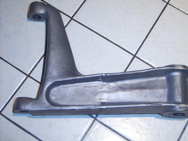

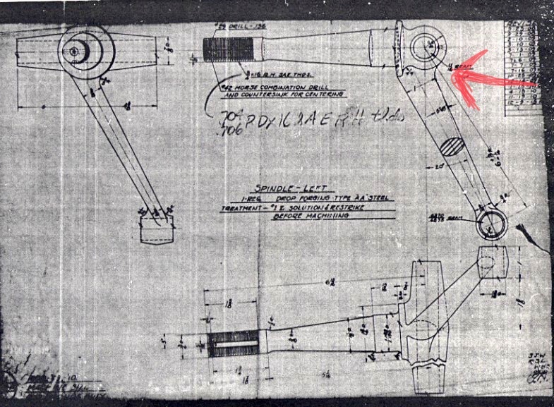

1921 one piece spindles were often modified to fit the 09-10 axles. Check for the measurements, welding evidence and shape of arm and body of spindle. Is your arm curved up or straight? Does it have this offset to allow the wheel to turn wide without hitting axle?
https://www.mtfca.com/discus/messages/2 ... 23188.html?
Posted above link 1910 spindle

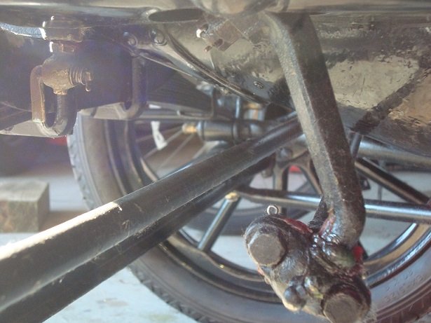

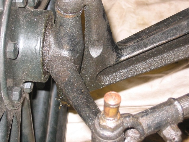

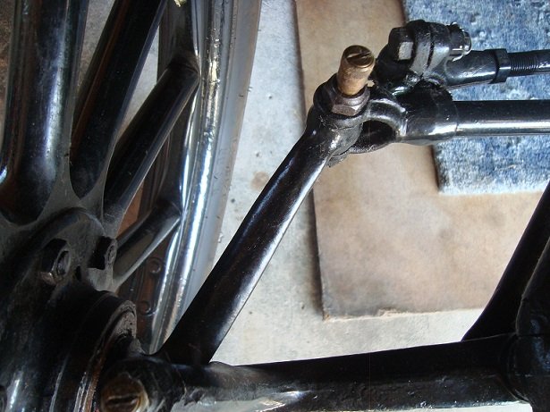

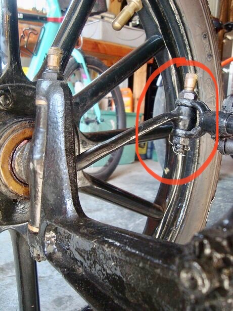

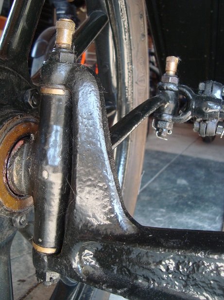

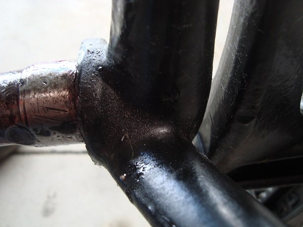

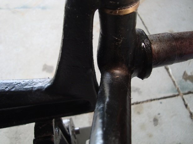

Here are a few more pictures of the spindles - they seem to be correct but I'm not certain. What does a "fat" spindle look like?
sorry, I don't know why it keeps repeating the first pic!

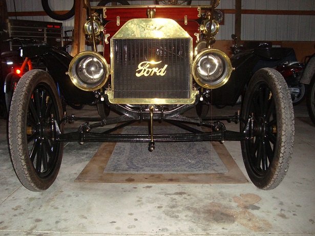

Looking at these photos, I really don't think I have enough toe-in. I've also included a picture of the pitman arm, which I believe is correct. Again, any advice is always appreciated! I'll measure for toe-in
tomorrow and let you know.

Post by Bryant » Tue Jun 28, 2022 7:57 pm

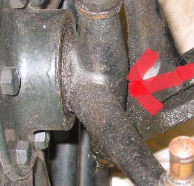

Iam not sure but is the spindle arm bent?
Belliott3
Posts: 366
Joined: Sat Jan 19, 2019 7:44 pm
First Name: Bill
Last Name: Elliott
* REQUIRED* Type and Year of Model Ts owned: 1916 Model T Touring
Location: Michigan
Board Member Since: 2006
Post by Belliott3 » Tue Jun 28, 2022 8:09 pm
Wow, I never noticed that! Sure looks bent; I’ll do some investigating tomorrow when it’s light: good catch!

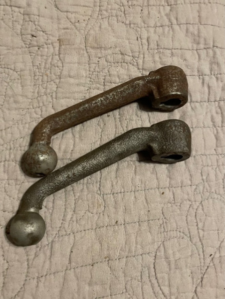

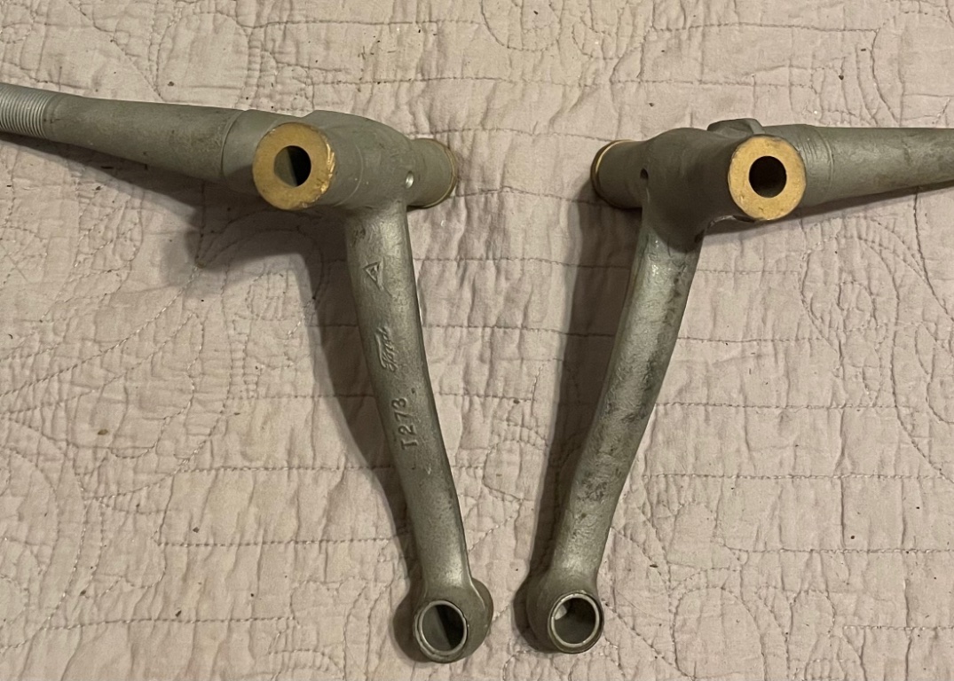

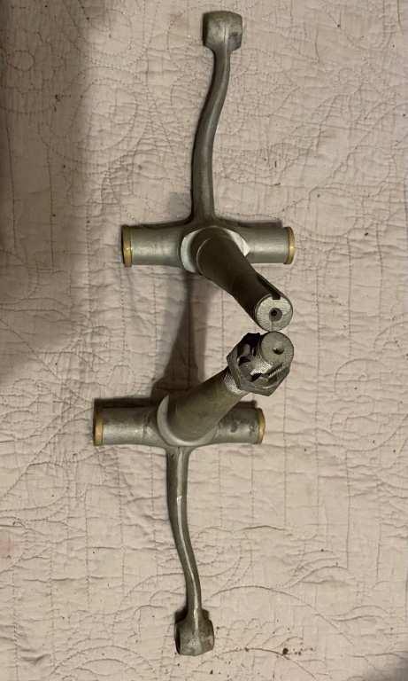

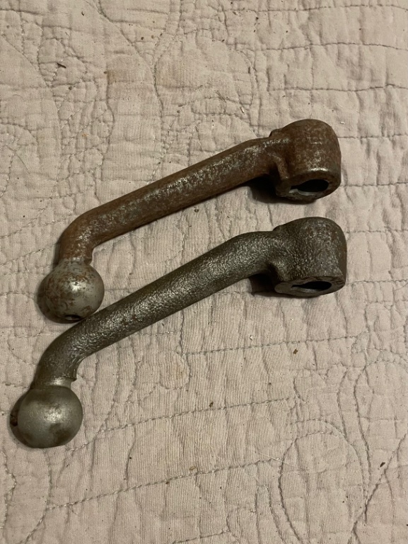

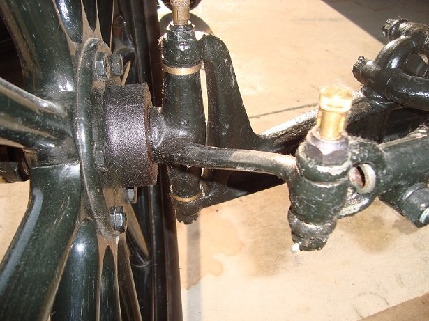

Bill attached are the 1921 one piece spindles.

Your left spindle looks correct. The right one looks like a made over '21 spindle. To my eyes anyway... :shock:

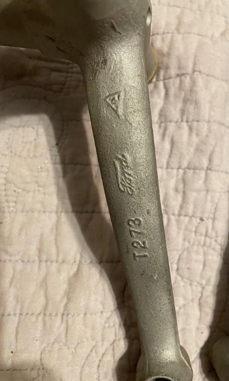

And thanks for the pictures John! I checked both spindle arms and can’t find any Ford or other markings.
Posts: 1967
Last Name: Tannehill
Location: Hot Coffee, MS
Board Member Since: 2002
Post by JTT3 » Tue Jun 28, 2022 9:07 pm
Generally speaking one on the left will have numbers on the bottom, one on the right on top. For some reason the right one will have the numbers that are not as proud, they may be there just covered in paint. Your pitman arm looks long. I’ll try and take pictures of the difference.

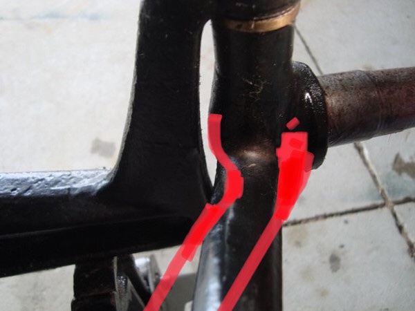

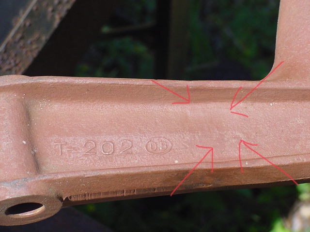

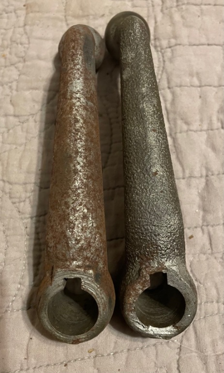

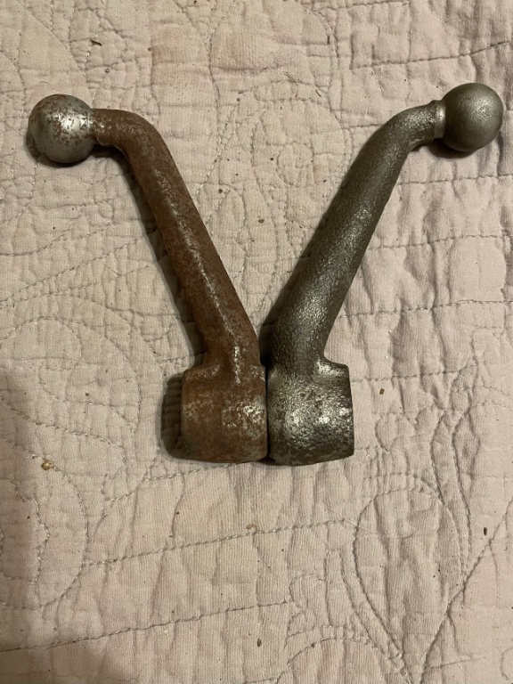

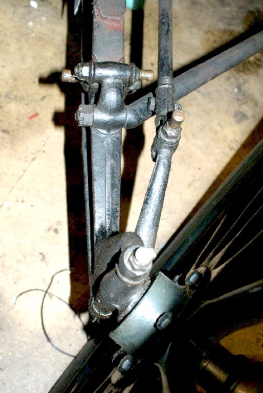

I’m willing to say the passenger is bent or the wrong spindle. An original spindle and arm allows total movement and will not hit the axle when attached correctly. Look at how the arm comes off the spindle, it has a set back that allows total movement. The 21 do not.
ThreePedalTapDancer
Posts: 1736

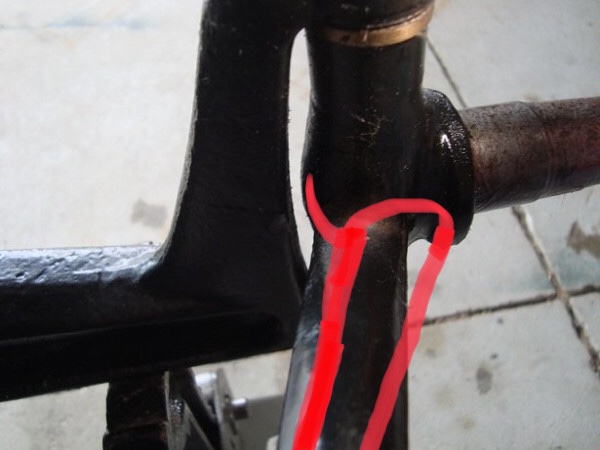

Post by ThreePedalTapDancer » Tue Jun 28, 2022 9:31 pm
Top has setback where arm comes out of spindle. The 21 shown on bottom has little to no set back, and the arm will hit axle before full turn is achieved.

Post by ThreePedalTapDancer » Wed Jun 29, 2022 11:48 am
You can bend the arm to a workable angle similar to the original spindle. Then you grind out the appropriate amount of indentation to allow a full turning of the wheel. You add some weld buildup to the backside of where you grind out the material for the indentation for added strength. I’ve seen some that had the whole arm removed and relocated to make a more appropriate angle that works. You just need a creative welder that can put some deep structural welds on the modifications to be sure they hold and are safe. Welds can be cleaned up and dressed with flap wheel on a handheld disc grinder. Then you can put your feelers out for a correct spindle and still enjoy the car.
Option 1 Relocate and reweld arm
Option 2 Bend to appropriate angle, grind indentation out, add weld on backside for support

I think the first/best option would be to source a proper spindle... if possible. Place an ad, who knows???
Pat Branigan Wisc

Bill did you have the front axle down to bare steel? People have modified later axles with new ends and have been proven unsafe. Pat
ThreePedalTapDancer
Posts: 1736
First Name: Ed
Last Name: Martin
Location: Idaho
Post by ThreePedalTapDancer » Wed Jun 29, 2022 2:10 pm
The issue Pat raises is the practice of welding a reproduction 1909-1910 axel end onto a later axel. It can be done properly by a certified welder, but it would have to be tested to see the quality of penetration and depth. Backyard welding often was the culprit for failures in the past. There is a difference in structural welds verses backyard butt welds. Dissimilar metals are an issue too.
Common location for welded axle area hidden under primer.
Belliott3
Posts: 366
First Name: Bill
Last Name: Elliott
Location: Michigan
Post by Belliott3 » Wed Jun 29, 2022 2:41 pm
Yes, it was sandblasted and painted so it’s the real deal.
Post by ModelT46 » Wed Jun 29, 2022 3:23 pm
The 4th picture down of Bill's posting is a fat one. The other of the replacement ones have a taper from the center out. I have an spare 1910 pr I am keeping. I will post a photo. My 1910 T has the correct early ones also.

I believe I’ve found an original one-piece RH spindle from a forum member, so I’ll post a finished project when it’s wrapped up. Thanks again for all the help fellas; much appreciated and much learned! BTW, are ‘21 one-piece spindles worth anything? Mine is in great shape with good threads and bearing surface!
Posts: 4414
Post by Wayne Sheldon » Wed Jun 29, 2022 10:00 pm
The odd 1921 front end with one-piece spindles is mostly a curiosity. People with a 1921 car equipped with them like to brag about them (I don't blame them, I would if I had one!). They are fairly rare, even in 1921, very few Fords left the factory that way.
The only reason that they are somewhat valuable is that a lot of people on a budget wanting to piece together an early T (people like me?) drive the price of them up. For an early T, they can be made to work with only a little effort. A bit more effort, and they can work fairly well and most people won't know the difference. As you found out, making them work really well is a bit more of a problem.
The "real" early ones are a bit expensive, and for good reasons. Check the one you are getting for cracks! I won't ask what you are paying, or where you got it (unless you or the seller really wants to). But I have seen the 1921 one-piece spindles sell for as much as a couple hundred for a single (don't recall which side?). And, no, I am not buying! I have too many projects already, and do not need to start another pile. If I can get four other projects finished first, the late 1912 project pile I already have will be the earliest one I will consider doing.
Posts: 1967
Post by JTT3 » Wed Jun 29, 2022 10:10 pm
Congrats Bill on finding the correct spindle. The last 1921 pair I know of sold for north of $350.
