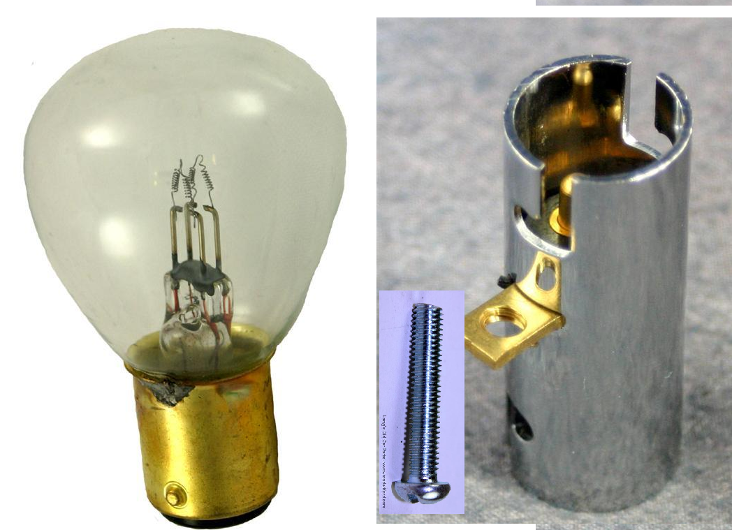

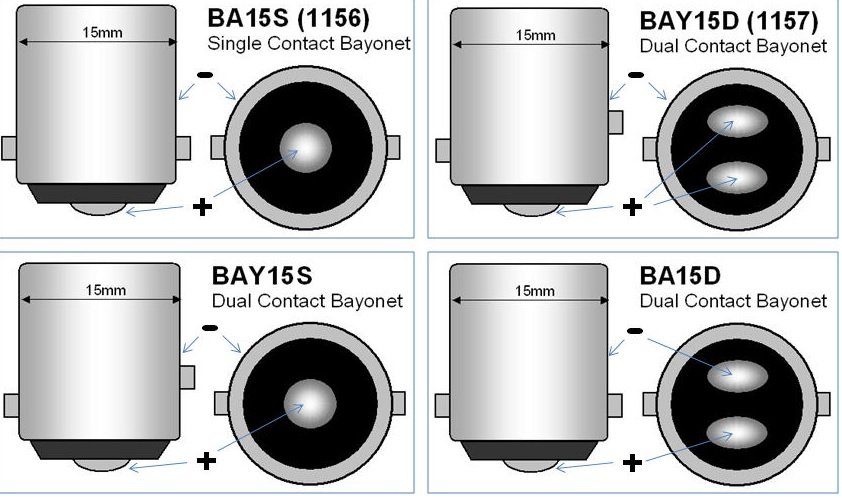

You do not need to use 1157 bulbs they use a different socket base BAY15D (offset pins) while the Model T double contact base is BA15D (aligned pins)
Noe the picture for the BA15D is showing optional wiring positions for ground. For our purposes the bottom two contacts for for the headlight filaments and the outer shell for ground. However the + - represents connecting bulbs in series like for for Magneto Bulbs --
The vendors sell a High low beam bulb basically is two circuits. When t he switch is on DIM it provides voltage to the 32cp filament, when switch to ON the connection to the Low filament is disconnected and the 50CP is used. An 1188 6v bulb will also work but the filaments aren't positioned perfectly The vendor bulbs appear to have their filaments in the proper focal point position for headlight reflection. If you look into the reflector you may see a shiny center

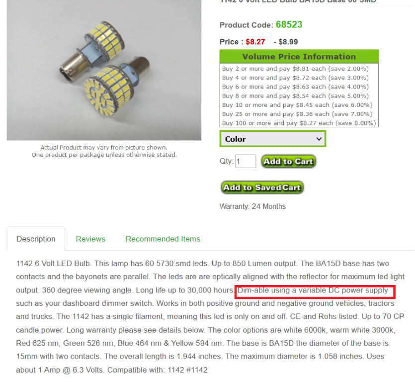

You might want to consider LED drop in replacement bulbs. considerable brighter and just barely moves the amp meter. headlight socket pin orientation does not effect operation. I have a T with one headlight socket with OEM pins and the other after market with reversed pins. to make it correct with a OEM filament bulb would have had to replace socket or turn socket and drill additional hole in headlight housing. with led bulb doesn't matter. they make 6 and 12 volt versions. LEDLIGHT.COM 6V LED Headlight BA15D 60 SMD Dual Filament
Product Code: 87455 they have high and low beam output. bright & On
$8.27 - $8.99
$8.27 - $8.99
- Posts: 7304
Re: High beam vs low beam headlights?
Those LED globes have forward oriented units and two rings to sebd light towards the reflector. Unless some of the leds are not lit up on low beam, the only way to have a low beam is to drive the leds with less power. This will refuce the light output, but will not result in any change of focus for the light. Result is the same beam with less light intensity, rather than dipped lights of different orientation of the beam.

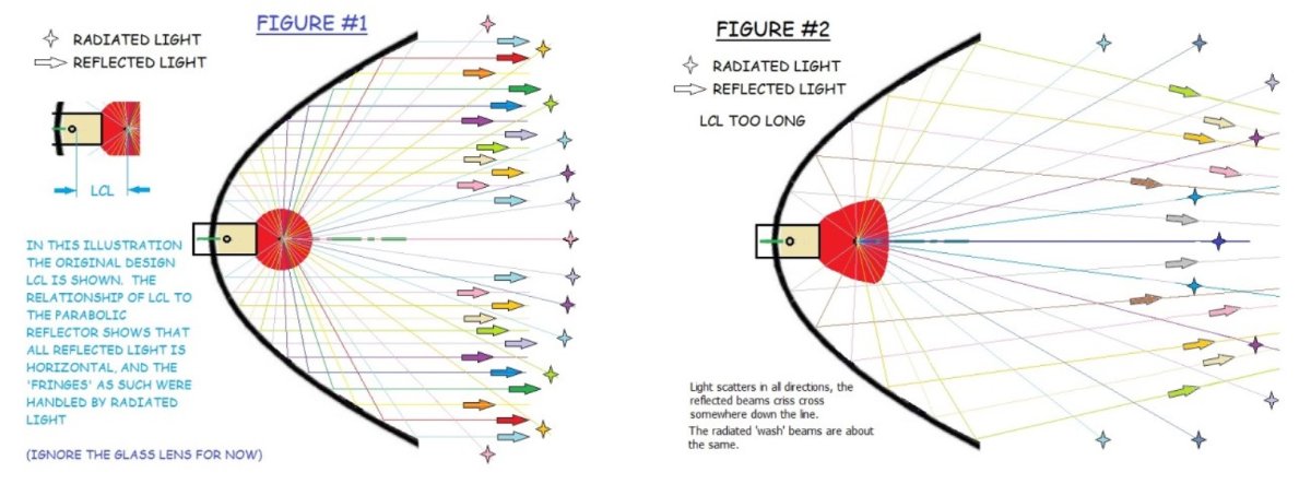

So here is a bulb and the screw is used to get the tips of the two filaments into the focal point location. Anything outside that will project unfocused light. --
The clear area at the base of the reflector is where the focal point is

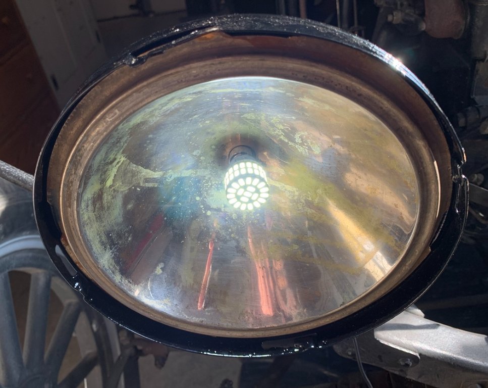

I replaced my 6 volt bulbs with LED's in my TT. They are a lot brighter. These have high and low beam, basically the bulb has an internal 50 ohm resistor on one pin to dim the LED's. Unfortunately the 6 Volt LED bulbs that I used don't have much difference between high and low. The resistor needs to be bigger, at the expense of a dimmer 'dim' setting.

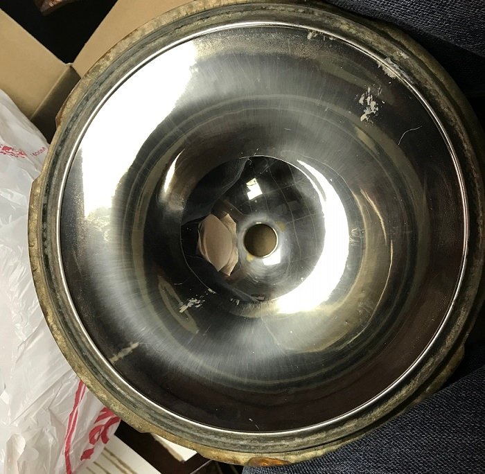

I was able to focus them. Looking at the reflector without the glass lens, There's a position where most of the reflector is lit up. That turned out to be quite a bit forward (toward the front of vehicle) than the dual filament 6 Volt bulb.
The current went from 3 amps to 0.150 amps (150 mA) and they stay cool.
They run off the battery (not the mag) so the voltage is pretty well regulated.

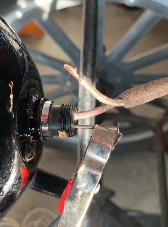

I did have trouble with the bulb ground. The socket ground relies on a clean contact through the adjustment screw. Rusty sockets were intermittent. Not original, but I soldered a small flexible wire from the socket to ground. Solved my problem.
There are a lot of styles for 6 Volt LED bulbs. Wish I had the time and money to try them all.
Attached are the second pair I tried.

The amount of light output is measured in lumens, but that doesn't mean that one bulb will provide more down the road brightness. The issue with LED bulbs is that the orientation of the chips that emit light when they are scattered around the bulb. Forward facing chips are not reflected, but illuminate the lens making the headlight look brighter and are still aimed by the lens (good). The chips that are the most productive need to be near the reflectors focal point. It is the lens that distributes and projects the light down onto the road ahead. These assume properly reflected rays.
So with the lens off you would want to adjust the area inside and close to the red ring to be the brightest - anything outside the pink ring isn't going to do much other than to make the lens glass look brighter.

For those wanting to run magneto lights and looking for bulbs, you want the BA15D base shown in the illustration Frank posted. Actual magneto bulbs are marked 9v. Those are rather scarce compared to 6-8v bulbs, which are much more plentiful. Some 6-8v bulbs will do if they are identical in pairs. As mag lights are wired in series, if two bulbs are not identical one will be bright and the other dim. In some cases one will be VERY bright and the other so "dim" that it doesn't light at all. I test them with 12 volts in series and put them in matched pairs in little plastic bags, and several bagged pairs in a cigar box in the car. The box also contains a candle to lubricate the bulb bases and headlamp rims.

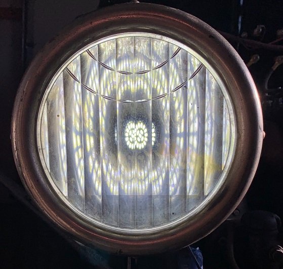

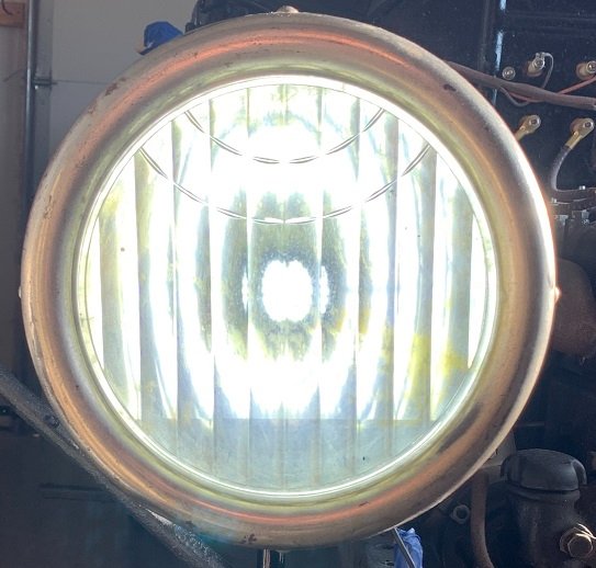

The LED's that Jim notes below were well worth the $29 including freight! On my ’21 Touring, I discovered that in order to get the LEDLIGHT.COM bulbs (Product Code 68523) to function, it was necessary to run a ground wire to one of the two input connections on the lamp terminal (see photo). I chose the ON input wire (switch position) for the positive supply, and connected the ground to the DIM connection point. The arrangement of the LED’s on the side help the reflectors project a lot of light!

Tom, presumably your photos show bright and dim for your lights, and the dim is achieved by driving the leds at a lower power. There can be no high/low beam with such bulbs, as there is no change to the orientation of the light source in relation to the reflector.

The pictures appear to show all LED chips lit on high beam being reflected but only the forward array lit for low beam. The reflector isn't capturing much of anything from the LED in low beam and the picture is just shows the forward LEDs in the fluted lens. As far as brightness goes - Standard Model T filament bulbs are rated 50/32 CP & that is mostly reflected light but lower Kelvin. The LEDs are likely closer to that than the rated spec since not all is being reflected. As I stated earlier the higher K value changes the color of objects making them appear brighter but not having more light shine on them. So if these are even in a brightness tie with standard filament bulbs its a 1/2 watt (.083amps) vs 21w/6w (3.5/1 amps). That's a plus if its needed!Allan wrote: ↑Thu Nov 03, 2022 10:56 pmTom, presumably your photos show bright and dim for your lights, and the dim is achieved by driving the leds at a lower power. There can be no high/low beam with such bulbs, as there is no change to the orientation of the light source in relation to the reflector.
I checked the spec for the bulb and it does have a the option ffor high & low beam
V LED Headlight. Works 6V AC or 6V DC. 60 quantity 5730 smd leds. Optically filament aligned so you get maximum light output through your headlight fixture and lens. The headlight is dimmable using a variable voltage supply. Being dimmable helps out with the older vintage and classic vehicles voltage system and wiring is not 100%. There is a total of 16 forward firing and 44 side firing leds. Each 5730 uses up to 1/2 Watt of power. This bulb up to 950 Lumen or 70 MSCP for high beam. Low beam up to 500 Lumens or 40 CP for low beam. Compatible with C-6 filament designed light bulbs. Comparable to a 30 Watt to 55-56W Watt incandescent light bulb. This bulb works in both 6 volt negative ground and 6 volt positive ground vehicles, tractors and motorcycles. This lamp can operate 6 Volts and has both a low beam and a high beam filament. Long life up to 30,000 hours. Long warranty please see warranty details below. This 6v bulb shape will fit your headlight without any issues with installation. The shape is this bulbs is smaller than a normal BA15D headlight bulb.

Frank, you and I are seeing different things. The forward array that is showing for low beam is not as right as it is in the other photo, indicating that this array is being driven a lower power. i agree the reflector isn't capturing much of the light. How can it when the leds are aimed to the front.
The specs state that the headlight is dimmable, using a variable voltage supply. They do not state that there is a high/low beam function.
High and low beam are not the same as bright and dim.
The Ford parabolic reflector design is simply not able to focus and direct light from multiple light sources like an array of 44 leds, so high and low beam are not achievable.

You are correct. I selected a different LED. The website has several LED bulbs configured the same way. I would not have selected the one referenced in the photos (Product Code 68523). LED 87455 would be a better choice of the two. I do agree that the arrangement of LEDs aren't reflected properlyAllan wrote: ↑Fri Nov 04, 2022 8:25 amFrank, you and I are seeing different things. The forward array that is showing for low beam is not as right as it is in the other photo, indicating that this array is being driven a lower power. i agree the reflector isn't capturing much of the light. How can it when the leds are aimed to the front.
The one in the photos is 68523 --
The one I referenced above https://www.ledlight.com/6v-led-headlight.aspx 6 LED Headlight. Works 6V AC or 6V DC. 60 quantity 5730 smd leds. Optically filament aligned so you get maximum light output through your headlight fixture and lens. The headlight is dimmable using a variable voltage supply. Being dimmable helps out with the older vintage and classic vehicles voltage system and wiring is not 100%. There is a total of 16 forward firing and 44 side firing leds. Each 5730 uses up to 1/2 Watt of power. This bulb up to 950 Lumen or 70 MSCP for high beam. Low beam up to 500 Lumens or 40 CP for low beam. Compatible with C-6 filament designed light bulbs. Comparable to a 30 Watt to 55-56W Watt incandescent light bulb. This bulb works in both 6 volt negative ground and 6 volt positive ground vehicles, tractors and motorcycles. This lamp can operate 6 Volts and has both a low beam and a high beam filament. Long life up to 30,000 hours. Long warranty please see warranty details below. This 6v bulb shape will fit your headlight without any issues with installation. The shape is this bulbs is smaller than a normal BA15D headlight bulb.

Hey Guys,
Sorry about the confusion on the two photos of the lights! There's only one power supply and one brightness level. Was trying to emphasize how much surface area of the reflectors are used with this style of LED bulb. I used a low aperture and high aperture shot. Despite a lot of plating loss, just amazed at how much light is projected!
