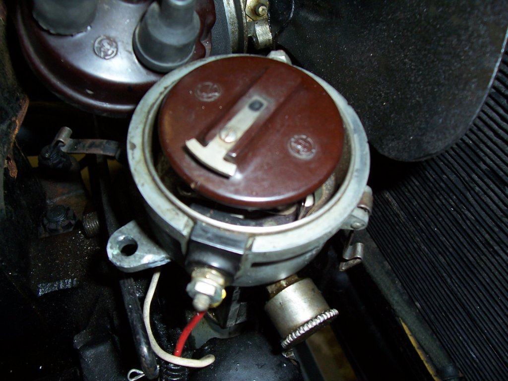

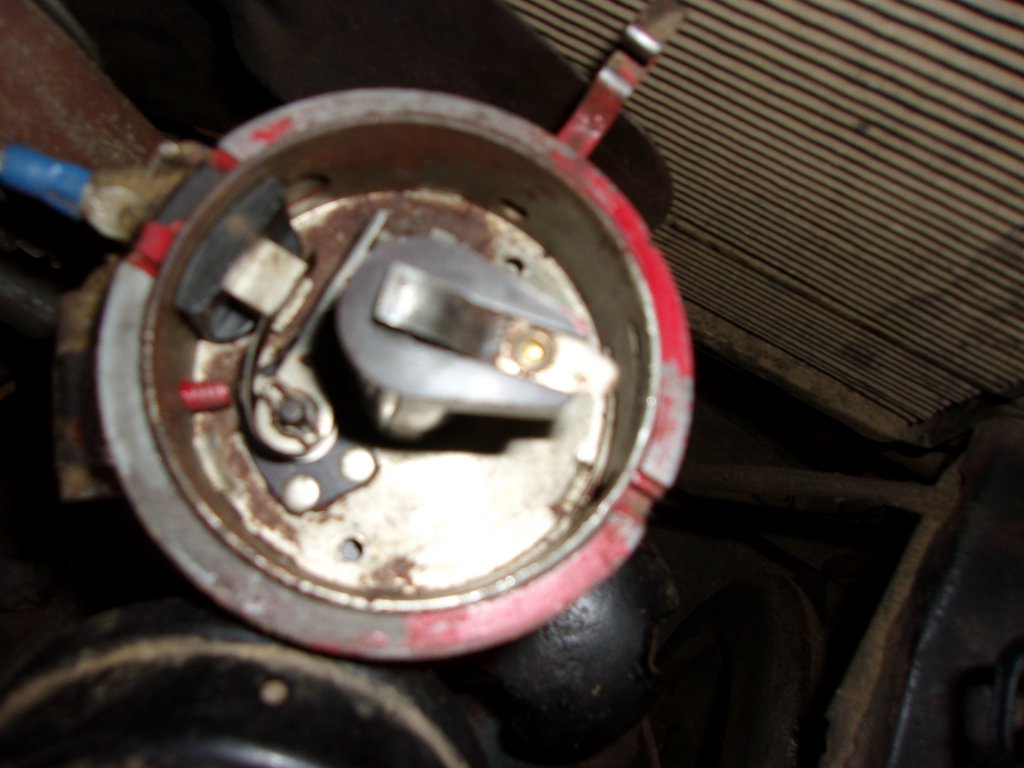

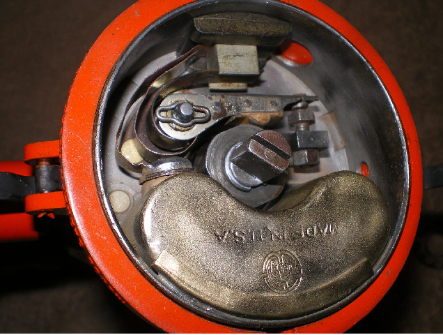

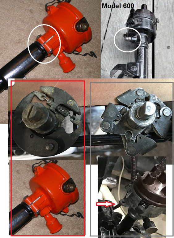

Here are some differences of the two models I know of
The orange red one is the later style and is the correct color for the head, I do not know the model number for it.
The difference between them is the earlier model has a lockable pin on the head that rides into a small slot on the shaft base. This keeps the head on the shaft and allows for manual spark advance as well. The later style has a the bolt that clamps the head securely to the shaft base. You'll find many of this style broken at this juncture from over-tightening.

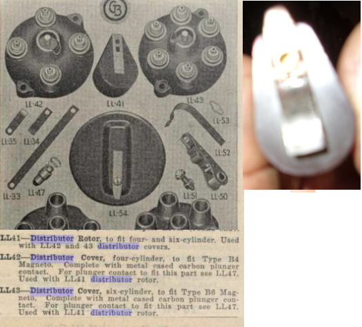

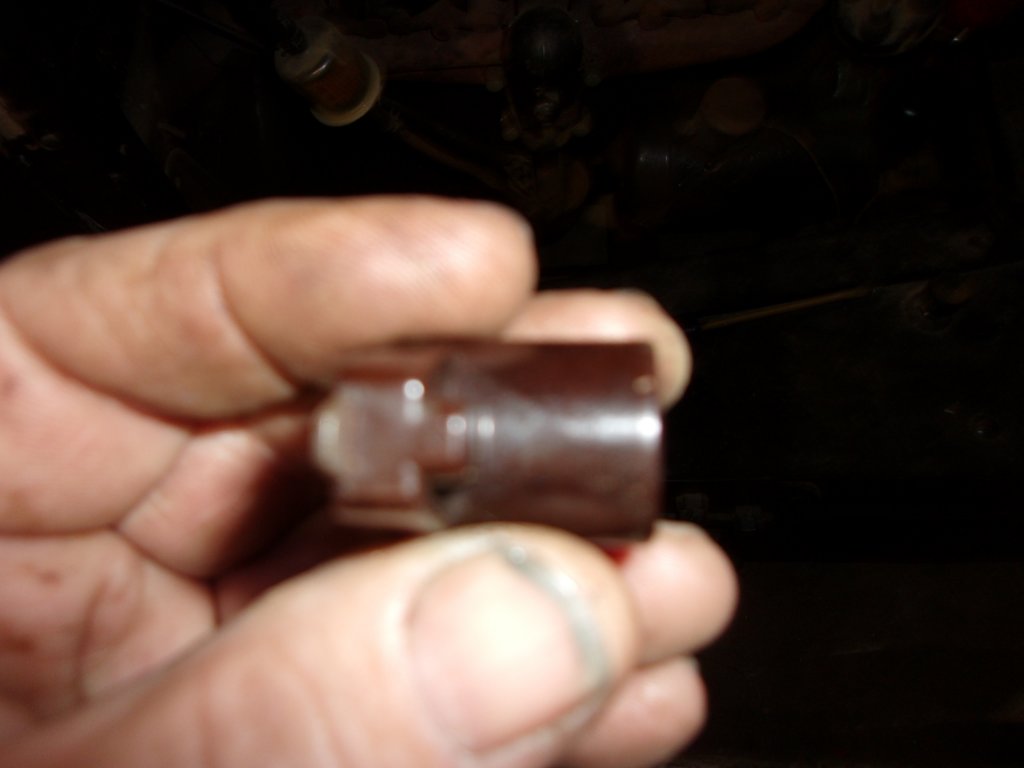

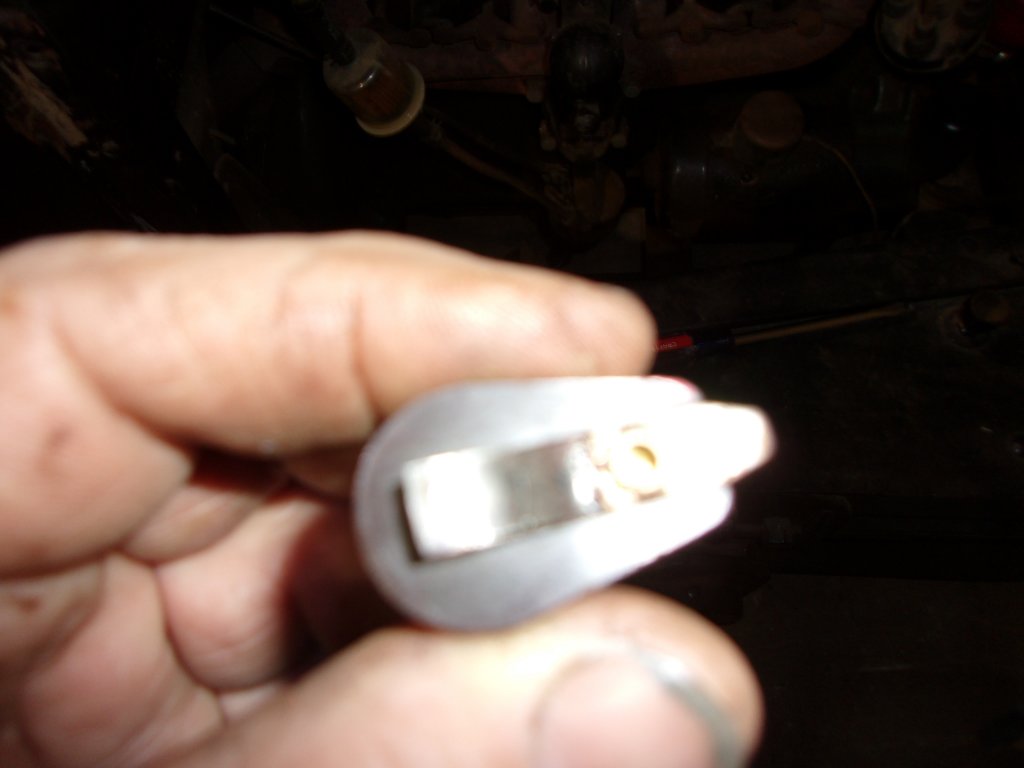

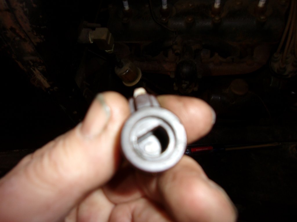

I have the LL-41 rotor according to the parts breakdown of the American Bosch distributor. This is what I like about our group, the great help everyone gives to keep the hobby going. Thanks

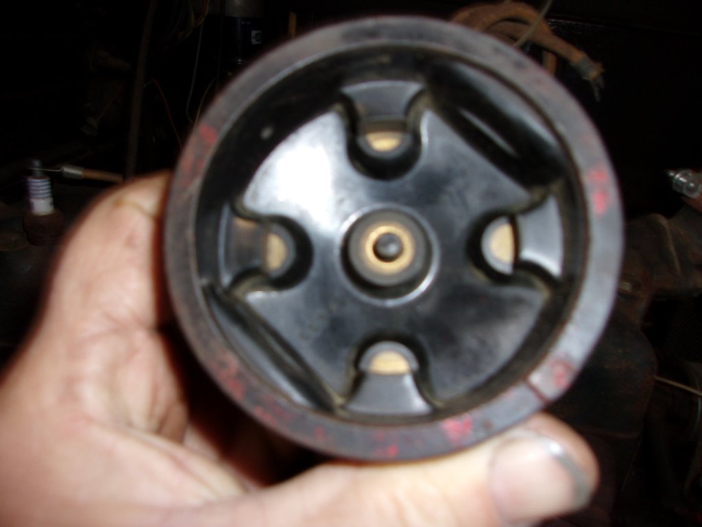

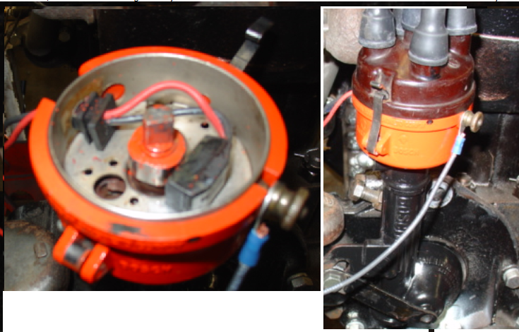

It appears to me that the distributor was retrofitted to use available parts. The rotor you have looks like the LL-41 but its not, the flex contact on the top isn't on the Bosch. There should be a number on the rotor you have. If the cap is the correct one and that rotor works then its nice to know as a potential replacement. I attached a picture of the American Bosch plate with points and condenser (kidney shaped).

I have been watching this post and need to step in. Paul, the rotor you have is not the Bosch LL 41, but rather an Autolite IB 1048. That particular rotor was used on the 1926 to 1928 Essex ONLY. The LL41 rotor does not have the center spring contact like your rotor. While it may have the same mounting configuration, it will sit higher on the distributor shaft and potentially hit the contacts in the distributor cap. The correct rotor is Bosch #68400 as shown in the photo. I have a fair supply of the Bosch 68400 rotors and condenser units and a good supply of the point sets. However the distributor caps are getting very scarce and at this point they are slipping into the "unobtainium" category. I have two NOS ones left in my inventory. Some time ago, I proposed a project to reproduce these caps but only a few people responded. I need at least 20 commitments to start the project but only 5 said they were interested.

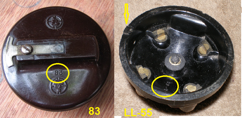

Is this the one?

That is the correct rotor, (my reference to LL-54 was incorrect see below) for use with the correct distributor cap, LL-55. See parts list above. But haven't seen enough of Paul's Friend's distributor cap to verify what it is. His distributor plate was modified and does not have the correct American Bosch points for the Model 600 . So as Tom noted the rotor was a Autolite IB 1048, so everything else may be a different

TRDxB2, the rotor in the picture is the correct rotor with the T on the spark contact end. It is not however the LL54. The LL54 has a much larger mounting hole than the one with the T on the end, it will not work and will be very sloppy. In your post of Jan 13th you do show the correct point set and condenser. I wish I could get the pictures to load.

Opps, I wasn't looking at the point just the round disk. Is this then the correct pair. If not you can email the pictures an I'll load them for you (I purchased points from you before)
