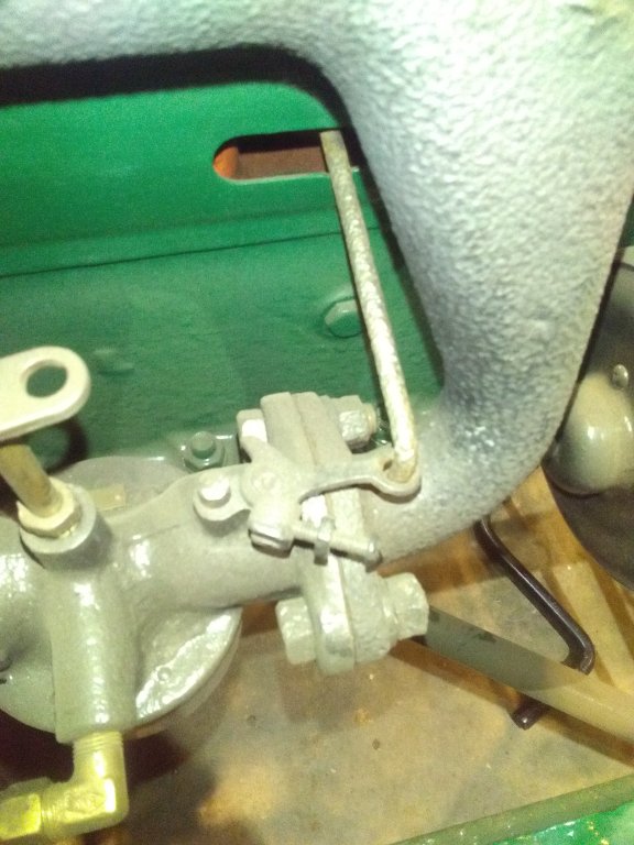

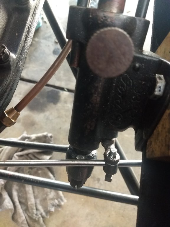

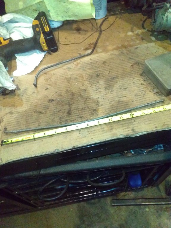

Ok,I went and took pics.
When I posted the question I was in the shop on that computer that I can't get to find photos on the cellphone.
I had the column looking nice but now will have to touch up the paint.
so here is what I have,From what i read in your post ,the carburetor may have the wrong throttle shaft?
The rod measures 15 inches on the table,

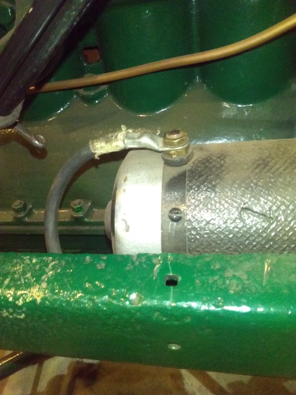

The switch to starter cable appears way too long - it is supposed to come from the rear of the car - the way it is routed now is an accident waiting to happen !

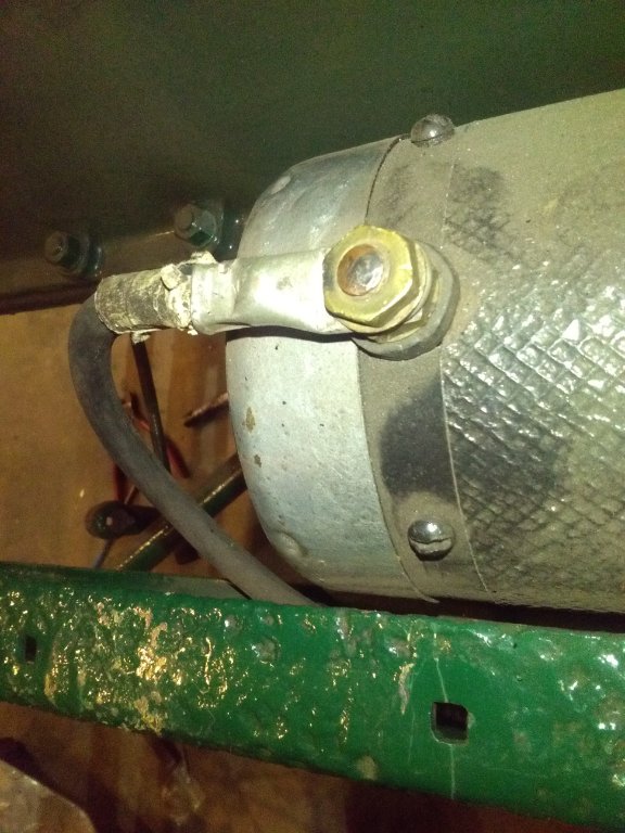

Help me out,what might happen? I don't quite understand. the cable is not close to anything,matter of fact it is very stiff and way heavier than needed, the blue pliers handle may be causing it to look funny?
Edit,I went to the shop and photoed it.

Mack if it touches the case of the starter you’ll have problems quick plus the way you have it mounted now it’s actually pulling on the post.

FWIW. The brass starter cable nut goes on top the insulator.
The steel nut goes on top of the cable.

I woke up at 4:30 this morning and it came to about the cable. If there is vibration or something bumps it ,the terminal would come down and arc. I don't why it took me a while to understand but hey,I am a bit slow.

Re: Carburetor control rod
The carb throttle arm is the correct short length.
If a new one is too short, make your own.

If you dropped the angle of the steering column as is customary on most speedsters, you will have to make your own custom throttle pull rod because the arm is in a slightly different location than original. The throttle rod is an odd diameter and is hardened, so the regular hot rolled or cold rolled steel rod at your hardware store won’t be a good choice. Most larger hardware stores have a selection of shorter lengths of brass and aluminum tubes, sheets, and PIANO WIRE. There should be a piece of piano wire in that selection that is the correct diameter and long enough to make the rod you need.
