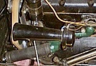

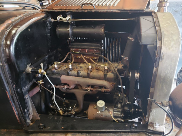

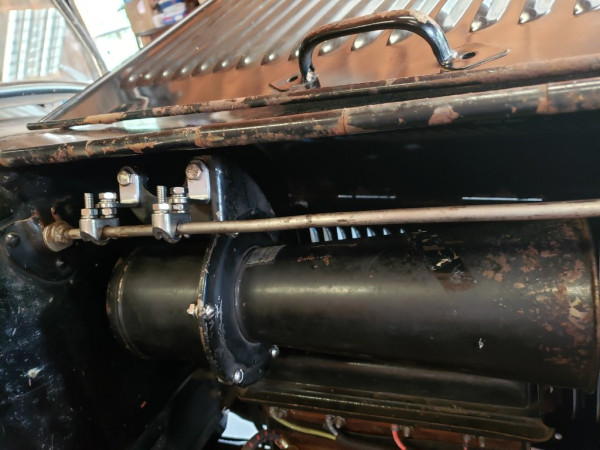

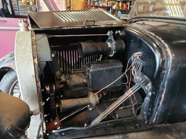

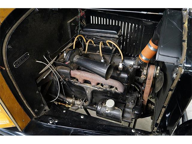

On my 1926 Coupe that has a water pump the battery horn is mounted to the radiator support rod. It works ok for now.

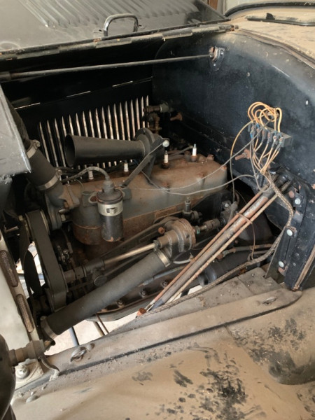

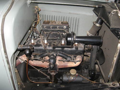

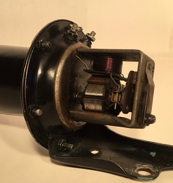

Hard to suggest without knowing what things look like (what horn, water pump, etc). Just mount on passenger side

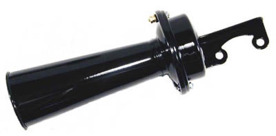

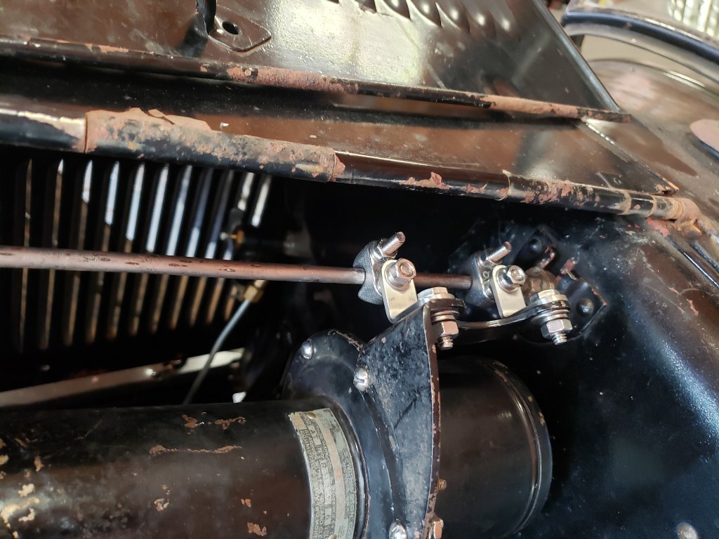

It is pretty easy to make a horn bracket out of 1/8” x 1” steel flat bar to position the horn atop the engine attached to two head bolts on the passenger side of the engine next to the coil box. There is only one 90 degree bend needed using a butane torch to heat the steel where the bend is to be made and the sharp bend made with the help of a heavy vice and heavy mawl. Jim Patrick

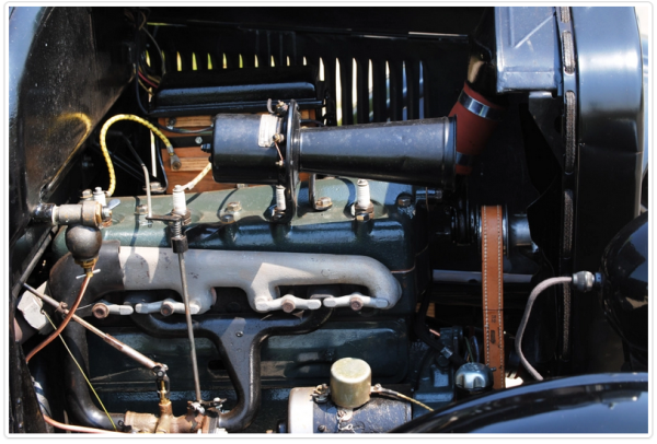

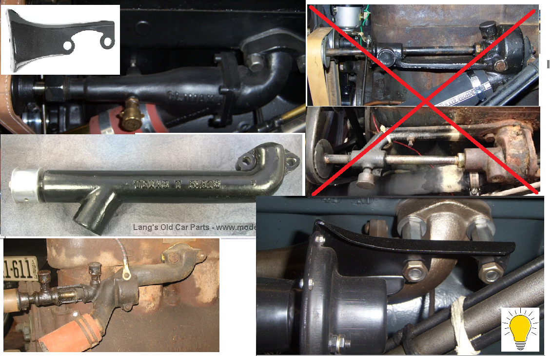

Prior to 26, all T horns mounted with a bracket to the left of the cylinder head, away from the water inlet. In 26, when the coil box was located in that space, the horn had to be relocated and a new bracket was made to locate the horn using the two bolts holding the water inlet to the left side of the motor. Since NO T ever came from the factory with a water pump, the bracket was made to fit around the water inlet casting and NOT the casting of a water pump. When this happened, all side mount water pumps made before 26 would not allow a horn to be mounted to them. Aftermarket manufacturers of water pumps redesigned their castings and pumps with a set of threaded holes to allow the stock 26-27 Ford horn bracket were available. You didn't say if you were trying to use an original Model T vibrator horn or a Model A motor driven horn , or a 6 volt horn off some other make vehicle. Purists would never put a motor driven horn on a T, but owners who don't give a 'squat' about correctness will use anything as at least one of the pictures, above, prove.

""Since NO T ever came from the factory with a water pump, the bracket was made to fit around the water inlet casting and NOT the casting of a water pump.""

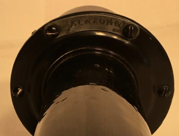

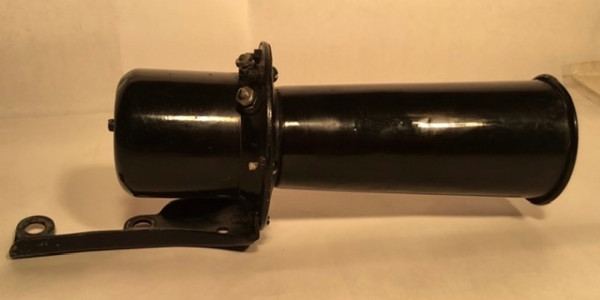

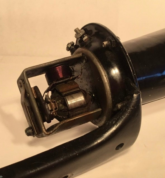

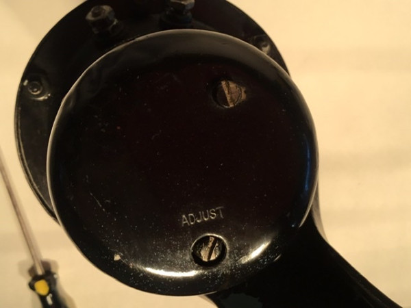

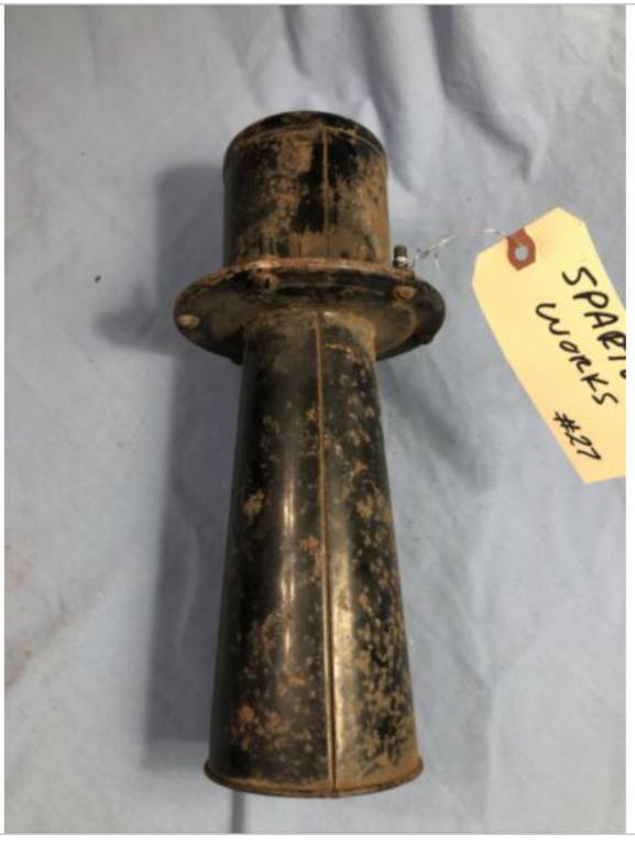

1926/27 horn

Scott thanks for the kind words. I was surprised that the post would get such a reaction. I just want to get the car on the road and drive it. I can tell a fib or two about what parts are what and get away with it. Here is a photo of the horn that will not work. I found it searching for horn photos. This is exactly what I have and it said it was for a chevy, buick, dodge brothers fit. If it can be verified as to what it came off of I guess I can sell it and get rid of it. It really works well and sounds good.
Posts: 5579
Re: Horn will not fit inside 1926 Coupe hood after installing a water pump
Post by RajoRacer » Thu Feb 23, 2023 12:58 pm
That's an original Sparton Ahooga horn - they're a great horn & easy to clean & adjust. A stock Model T horn sounds like a sick goose ! You can make your own mounting bracket easy enough - down along the frame towards the front is a good spot - I stay away from mounting brackets that utilize any head bolts.

Period aftermarket water pumps with the holes drilled to fit a "stock" late horn, typically fit a stock horn.
With the realization that your horn is indeed other, the problem is apparent.
You still may be able to mount your horn in the correct position by using the correct late horn mounting bracket
& changing the horn mounting holes in your horn. Parts vendors sell a stock replacement bracket.

I attached mine to the underside of the hood rod, at the rear, facing forward.

It would have either been an aftermarket accessory or simply "borrowed" from another make & model of car. You mentioned mounting it to the frame. I wouldn't do that for fear of it getting wet or pummeled with road dirt. Best bet is to make a bracket for it that uses a couple of the head bolts on the "carburetor side" of the engine. If you do that, be sure to use longer head bolts in those 2 spots. Sorry for the water pump commotion. :roll:
(I don't have a water pump, but it seemed a better location than on head studs.)
Yes, that would work well too, but might be tough to clamp it there firmly enough so it won't swing around on the rod.

A few of the water pumps* have correct build for fitting stock 26-27 horn and bracket. Texas T Parts (Birdhaven) 'Leakless' version pump is one, the std. Ford horn fits right on the water inlet pump housing. Photo below is the 'Leakless' pump
horn and water pump.jpeg (65.2 KiB) Viewed 9016 times
Use of a water pump on a T isn't an endorsement by this poster. ;)

Harry, I think Larry Smith was referring to the water pumps made by many aftermarket manufacturers for the T's made after the first ones that had water pumps from the factory (1908-09), up to the improved Ford motors made with the coil box mounted to the head bolts. Those pumps had only the two holes using mounting bolts just like the original water inlet. The pumps sold by aftermarket manufacturers for use on improved Fords, had those two non-threaded holes plus two more threaded holes for bolts to attach the stock horn. No pump that I know of was made to accept or mount any horn other than a stock 26-27 horn and bracket.

Making it work

Here is another way to mount with a water pump. This Ford electric horn has the '25 and earlier bracket, that is two holes, vertical from one head bolt to one water outlet bolt.
The owner turned the bracket to fit to the cylinder head, with one bracket hole, and used a long strap from the other bracket hole, to another cylinder head bolt.
Very nice way to do it. Once used a single bolt mount bracket, and the weight of the horn caused the bracket to fatigue in the bend, and the horn fell loose.
Whatever way you mount the horn, be sure to accommodate the shake, rattle, and roll of the Ford. :lol:

The vintage 1920’s 6V Klaxon in my picture is an 8C. It is a very good quality motorized ahoogah horn. Jim Patrick

Post by Mikey1968 » Mon Feb 27, 2023 12:56 pm

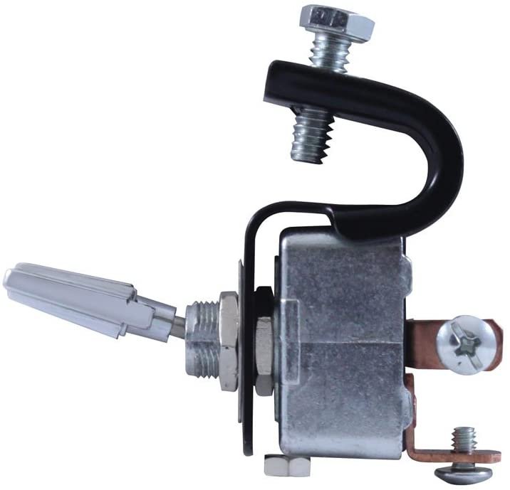

Here's my solution where I have an ahooga horn and the stock horn switched with a dual throw switch. Cable clamps with shelf brackets.
Cheers,
Mike

Post by Mikey1968 » Mon Feb 27, 2023 12:59 pm
This is the switch that mounts under the dash such that no holes are drilled.
