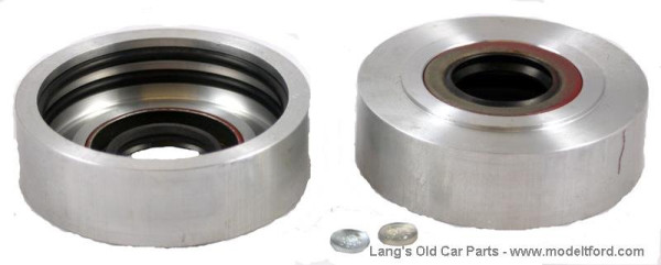

Replaced housing caps with the Snyders outer grease seals. The key doesn’t fit all the way into the keyway length wise. Solutions please.

John, your seal may not be on far enough. Is it a modern neoprene seal or the original style?

The Snyders is neoprene. It won’t go on any further. Probably wasn’t clear but it is the length not width. Can I file the non-tapered end down so the key fits the keyway?

You could shorten the key, however, be sure the hub goes on all the way. I would try sliding the hub without the key and torque down Then see if you can turn the wheel. If not, your seal might be protruding too far. The original cap held in a felt seal and went on all the way. You might either need a different seal or longer axles. If it fits, shorten the key and use it as is.
- Posts: 6719
Re: Rear axle keyway

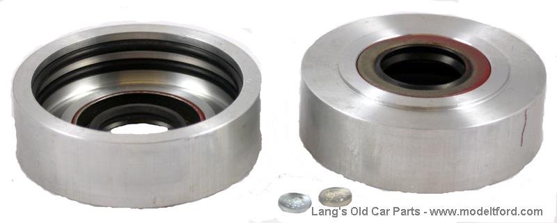

the aluminum "outer seal" sold by suppliers can be problematic for many installations.
No one can give a definitive answer until you provide pictures of the following:
- from the rear with no seal or key in place: how far over the backing plate does the brake drum sit when everything is snugged down?
- from the side and above: with the wheel off, alumum housing/seal in stalled, does the "straight" portion of the axle show through/past the seal?

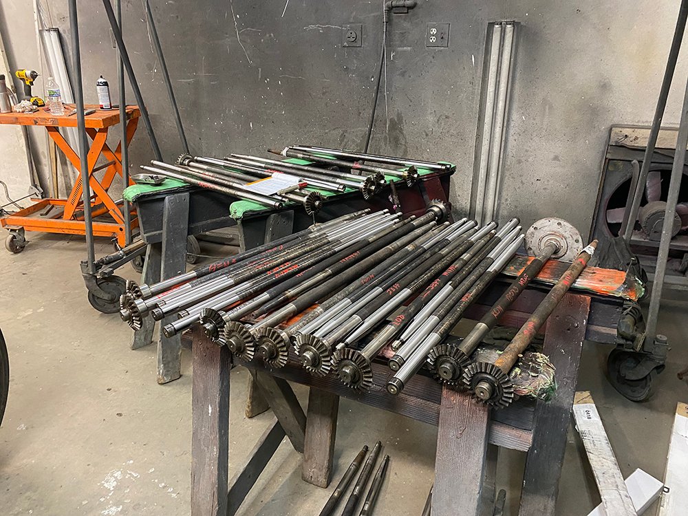

The key must be snug and the axle nut must be tight! 75-90 ft-lbs minimum. Re-check after 50-75 miles and at least annually. Failure to do so can ruin your axles. Most of the cars I've helped work on this year had damaged axles from the hub being loose on the taper.
The attached photo taken at a restoration specialist friend's shop shows damaged axles (and some new ones) awaiting replacement this past spring. He's done quite a few more since.

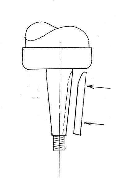

The T is a 1925 coupe. I have the tapered key facing not facing out towards outside of shaft. I have taken pictures with my iPhone and attached the pictures. Format issue. Appreciate all the replies and if someone has recommendations on who to attach photos will be greatly appreciated.

I think you've got some typos above...CrandallJ wrote: ↑Mon Mar 20, 2023 12:25 pmThe T is a 1925 coupe. I have the tapered key facing not facing out towards outside of shaft. I have taken pictures with my iPhone and attached the pictures. Format issue. Appreciate all the replies and if someone has recommendations on who to attach photos will be greatly appreciated.
Is this how you're orienting and inserting your key?

If the inner end of the keyway slot in the axle is covered by the end of the seal, then the seal isn't installed far enough and the slot will eventually chew up the seal material even if you shorten the key.
If I recall, the aluminum seal has an O-ring (or two) that is a tight fit on the axle tube. It can be difficult to get that O-ring to slide all the way over the axle tube, especially if it isn't lubed beforehand.
If you have installed the neoprene inner grease seals and they are stopping the bearing sleeves from going in far enough to be flush with the ends of the axle tubes, then you need to remove the sleeves and grind the inner ends (the ends that fit against the inner seals) until the outer ends of the sleeves are flush with the ends of the axle tubes.
If the axle keyway slot clears the seal, then the correct key should fit without modification, but if it didn't I wouldn't hesitate to shorten the outer, square end of the key if it sticks out too far.

On. One axle the keyway extended too far outward, where the seal lip contacted. I filled in this area of the keyway.
The seal has been working for atheist 4000 miles.
