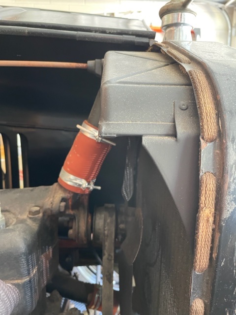

I’ve got what may be the last new Berg’s radiator, that I bought from him last winter just as he was shutting down the business. The box arrived, I peeked inside and put it away til needed. Well, opened it up today to install on my ‘26 RPU and saw that the upper hose neck is very different than all of my other radiators. Not only does it take a much longer hose, but the alignment to the outlet on the head is pretty far out of line. I’m definitely stuck with it at this point and am just hoping that I can get that 2” hose to clamp tight enough to not leak. It’s a high, flat tube rad on a ‘26 high head engine with a ‘26 style fan hub. Has anyone else experienced this and had success with the hose being stressed and not leaking?

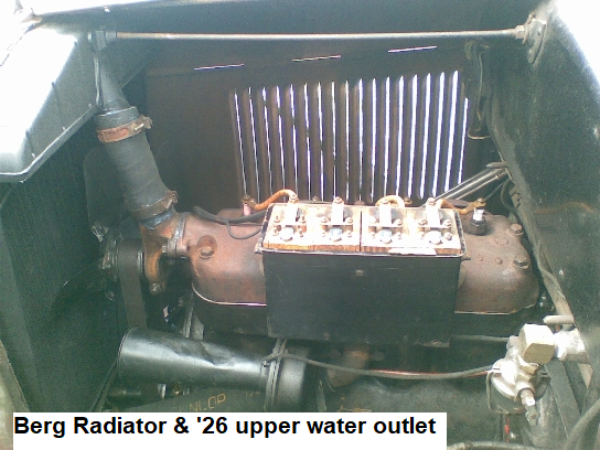

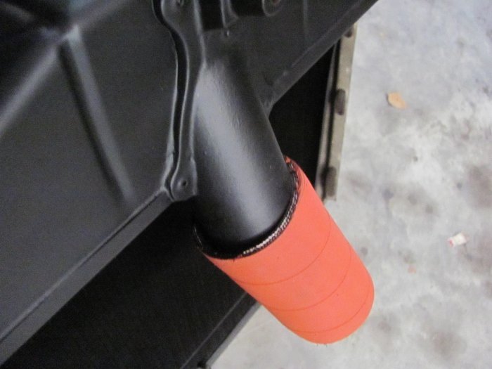

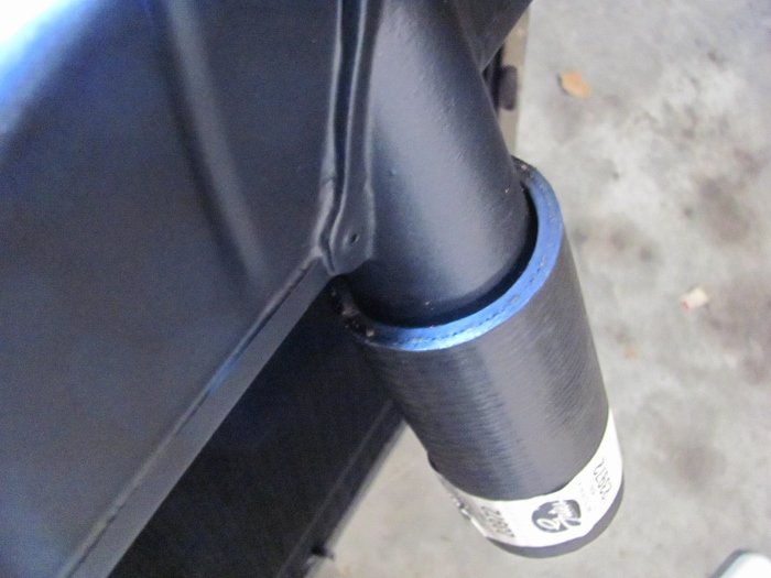

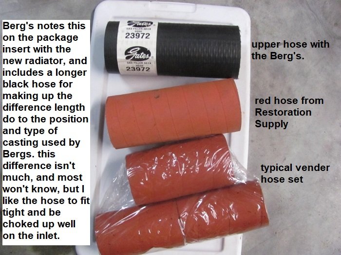

Pictures help to understand (found some). I also have a Berg. I just tried to fit an older red hose to it and it fit nicely. I then tried a recent repro that was a darker red and it felt a bit loose on the radiator but not the water neck. Need to find the black hose that came with the radiator.Dave Young wrote: ↑Sun Mar 26, 2023 9:42 pmI’ve got what may be the last new Berg’s radiator, that I bought from him last winter just as he was shutting down the business. The box arrived, I peeked inside and put it away til needed. Well, opened it up today to install on my ‘26 RPU and saw that the upper hose neck is very different than all of my other radiators. Not only does it take a much longer hose, but the alignment to the outlet on the head is pretty far out of line. I’m definitely stuck with it at this point and am just hoping that I can get that 2” hose to clamp tight enough to not leak. It’s a high, flat tube rad on a ‘26 high head engine with a ‘26 style fan hub. Has anyone else experienced this and had success with the hose being stressed and not leaking?
This problem was discussed in a few older discussions, but only length & fitment were at issue
https://www.mtfca.com/discus/messages/1 ... 1283611652
.In the photo where the upper clamp is, that's about 1/2" past the end of the outlet -------
https://www.mtfca.com/discus/messages/7 ... 1509768274 ---
Restoration supply https://restorationstuff.com/

Berg's is a very well built radiator, for me only real thing is it isn't Ford design tanks, and he uses an available , but good, long neck casting for the upper inlet. That part is different, and have experienced hose connections to be more difficult because that neck is smaller dia. than the Ford design.
Gary told me the avail casting is all he could get, the neck is narrow, so by using the longer hose, you slide it up to gain more contact of the neck, as the end portion of the casting has a bead, that bead is small diameter. My choice was to use modern worm tooth radiator clamp, placed up high.

Hey, Bob. Not sure which row unit I’ve got, but the fan spacing looks good. The radiator looks beautifully made in all regards but my only concern is the mis-alignment at the top hose. Hose length was no issue as I keep 3’ lengths of 2” on hand for my trucks. It’s pretty crooked. I put regular SS clamps on it and I just have to see if it leaks. If so, silicone hose is my next route to try.

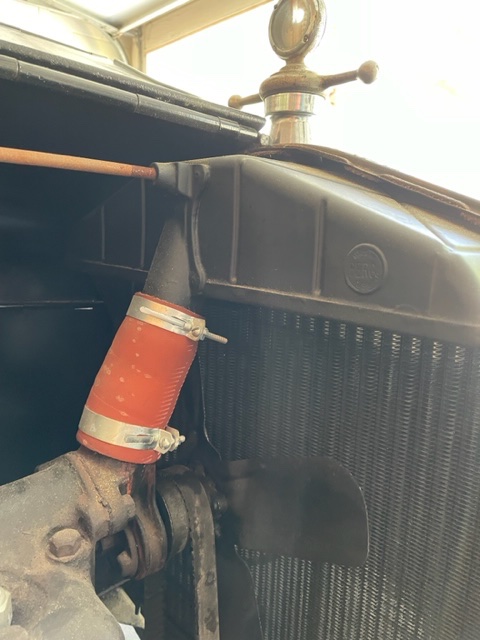

Last one I got from Gery went on a 26-27. I was able to use normal red hose but do recall a fight, where the solution was to slide the red hose up high on the neck, guide the lower on the head outlet as radiator was installed and then wiggle down and clamp all up…no leaks, no rtv. Pictures follow

No leaks, all good!
