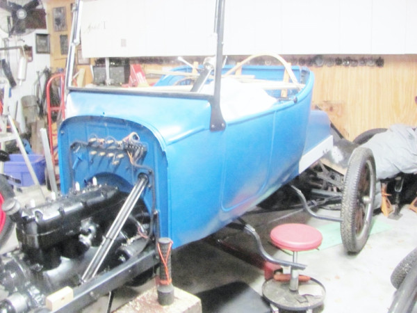

Re: Installing Shield and running board
Thanks to everyone for the helpful replies. The link to the older post with the pictures was great. Another question I have is, the top edge of the shield has 2 ears with fairly large holes, they are spaced the same distance as the body to frame brackets, so I assume they go between the frame bracket and body bracket with bolt going through the shield holes. This is the way I have it now, but it seems like the shield should go ahead about an inch and a half to line up the holes with the running board and the front fender holes. Also I have a large gap where the front fender and shield meet on the frame.
Here is a picture of that. Any help or suggestions will be appreciated
Bill
find your hood strips...lay one over the fender/apron. You will see exactly what goes where.

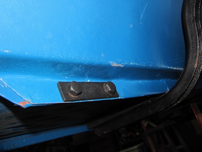

I am still working on this and having a problem getting the bolt holes lined up. I have a question, is the rolled edge of the running board supposed to go into the rolled groove on the bottom edge of the shield.
Briefly, the answer is yes. On some of out Canadian sourced cars there were two bolts at the front of the inner rolled edge of the running board and two slotted holes in the splash panel. At this point the two are bolted together. Earlier cars did not come this way. Those two holes had the effect of making the running boards into left and right hand side items, rather than interchangeable.
It would help if you told us which holes you are having difficulty lining up. I start by bolting the front of the splash panel to the two holes in the top of the frame. Then comes the running board. If the holes for the running board don't line up, it may indicate that you need to adjust the running board brackets to suit.

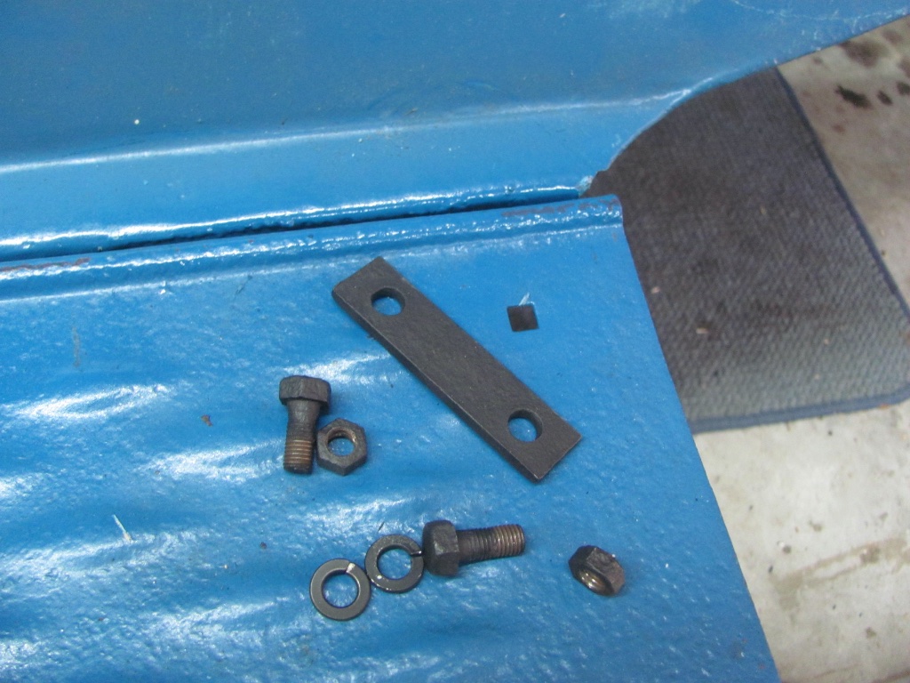

Thanks for the reply. I might be doing this wrong, but I jacked up the body top get a 1/4" between the body and frame bracket and slid the shield in place with the shield "ears" between the body bracket and frame bracket then put the body mounting bolt through the body bracket the shield hole and then the frame bracket. I can easily line up the running board holes and fasten the running board down with the wood blocks in place. The front fender flange is not close to lining with the running board holes. it extends about 2" past the holes. The same holds true for the running board holes and the rear fender holes and also the holes where the rear fender attaches to the shield.

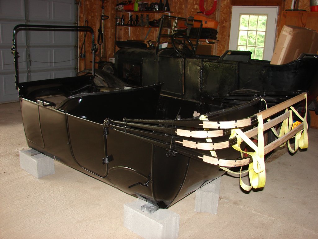

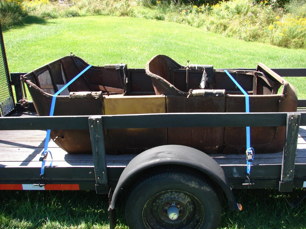

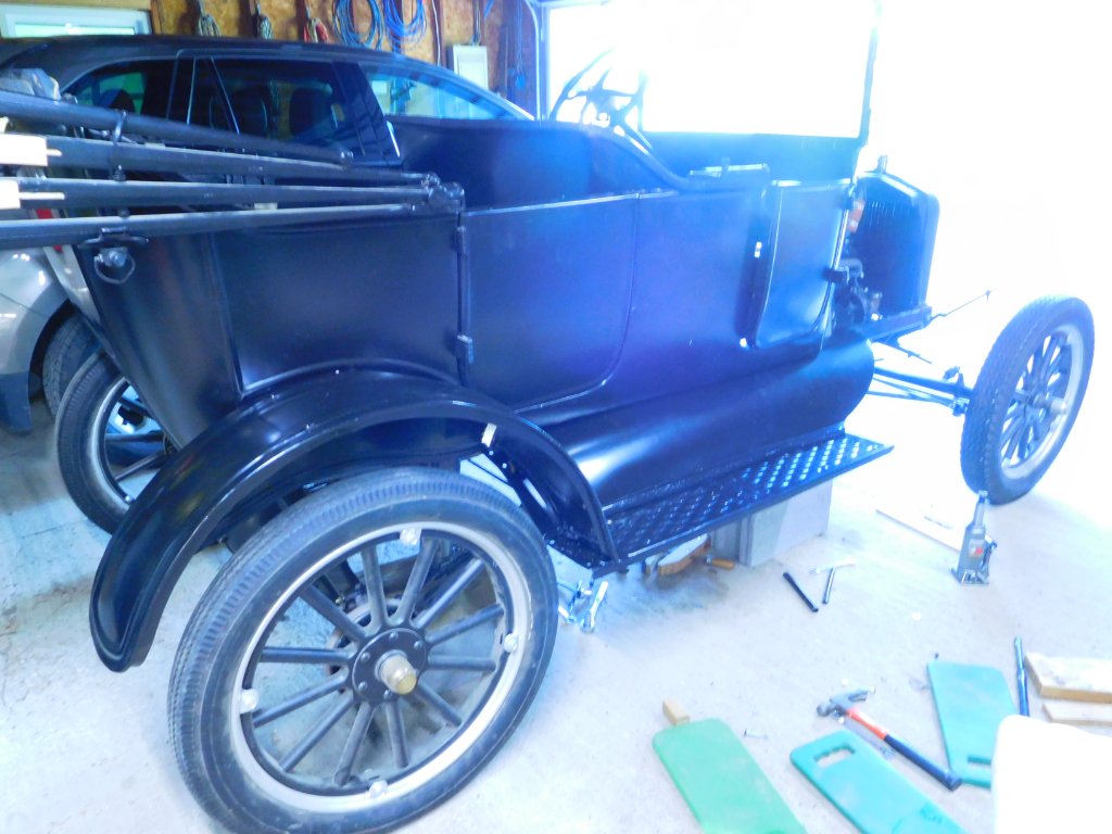

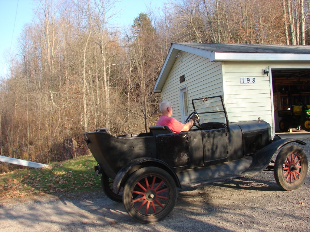

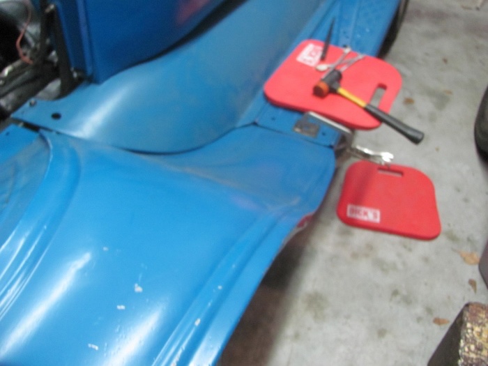

I inherited the car from my father-in-law. He had put it together in about 1985. Engine is a 1919 non-starter, he put a 1926-27 body on it because that's what he had. The frame is the early type. He had found a 1919 body, but due to sickness he never got in installed. In 2013 I decided to put the 1919 body on it, although I knew nothing about Model Ts. I discovered the Forum, bought a service manual and did a lot of reading, now I know next to nothing but know a little bit. I have been told by local T guys the shield, fenders, running boards were earlier and would work well with the 1919 body. The first picture is of me driving the car home, the shield, fenders and running boards are the ones I am now installing. It still has the 26-27 body on it. The frame is also the early type. The next picture is the 1919 body unrestored.
The next picture is the restored body.
The next picture is where I am now.
I am using the same parts and the same frame, but with a different body.
Bill,
Changing the body should not matter all that much come fender fit? Sure, there may be some little issue with how the rear fenders fit into the body dimple...but just look at the Rootlieb site and it will should how the inner fender skirt goes for what style body.
Others may disagree and have different sequence, but I learned the hard way some 40 years ago and have just done the same since.
40 years ago, I did a preservation redo of the frame with body in place. (I unbolted the body and jacked it up a bit and removed fenders, radiator and shell, dust shields, radiator clash strips, front and rear fenders). Then spent the entire winter doing the cosmetics
All cosmetically done, went to the reverse order and NOTHING fit right, everything fought me!
I mounted the rear fenders on the iron, but slightly loose... mounted the shields and running boards as a set and left those bolts loose, then mounted the front fenders loose to the running board. It came apart with only the running board brace blocks...went back the same way. As far as fit from there? Did a bit as Allan suggested since my front irons were apparently wall-eyed! Massaged the iron until the 'eye' was directly above the iron at the elevation the first side was at. Then took that whole long assembly, mounted it to the front iron and went back and only then tightened everything up on that side.
Did the same with the other side...except...made a story stick from floor to 1st side iron height, used it on the other side and cold bent that iron until I had alignment under the fender mount, and heigh was the same as other side. On both had to do some push and shove to get all to seat but once seated just tightened all bolts up and stayed that way until some 20 years ago when it was taken back to a chassis. (After that, the radiator and clash strips went on easy and hood worked out too...just two separate operations.
Good luck, if your rear fenders are for a touring, all should go good, and it is just a bunch of frustrating fiddling from there...the big trick is tighten NOTHING until everything works out! I don't think you'll bulge the splash shield if it is on the frame correctly.
The shields are fitted as you described. The holes for mounting are elongated larger so you can shift the shield as needed. Sometimes a push to 'bend' the shield lightly is necessary, especially if new repros, to conform the curve at the shield edge for fit to the running board flange. Also the frame and running board brackets have to be true for all the metal and body parts to fit up.bill goodheart wrote: ↑Sat Jul 22, 2023 8:20 amI have the shields on so that the 2 "ears" fit between the body bracket and the frame bracket, with the bolt going through the brackets and shield Is this the right way to install them?
Leave the body mount bolts slack until all is fitted, some vice grips at spots help to hold at different places. Use a soft blow hammer if needed to nudge things.
Assembly of a '24 runabout, but similar. On these a bracket is used at the front of the running board to pull the shield in place and prevent rattles.
