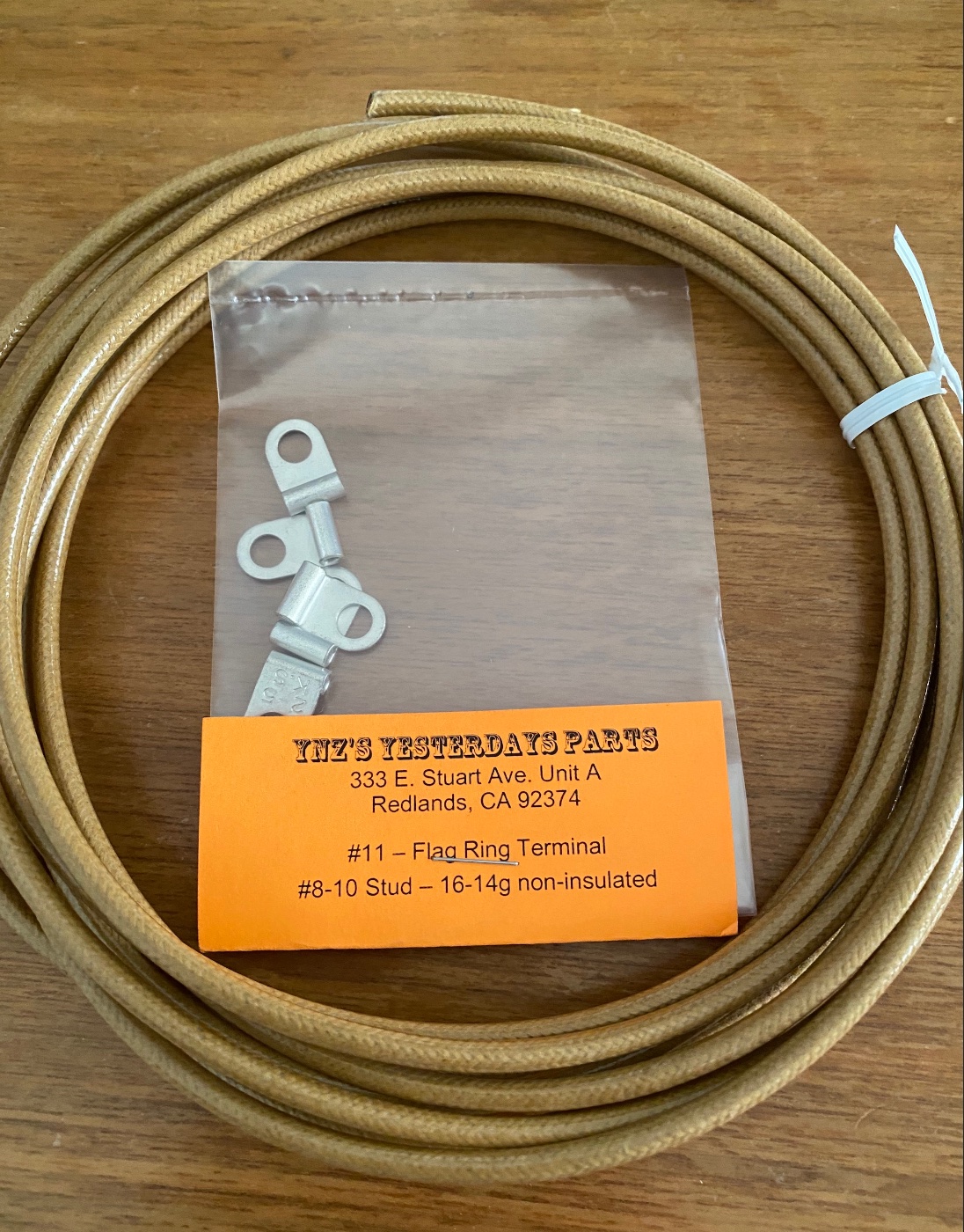

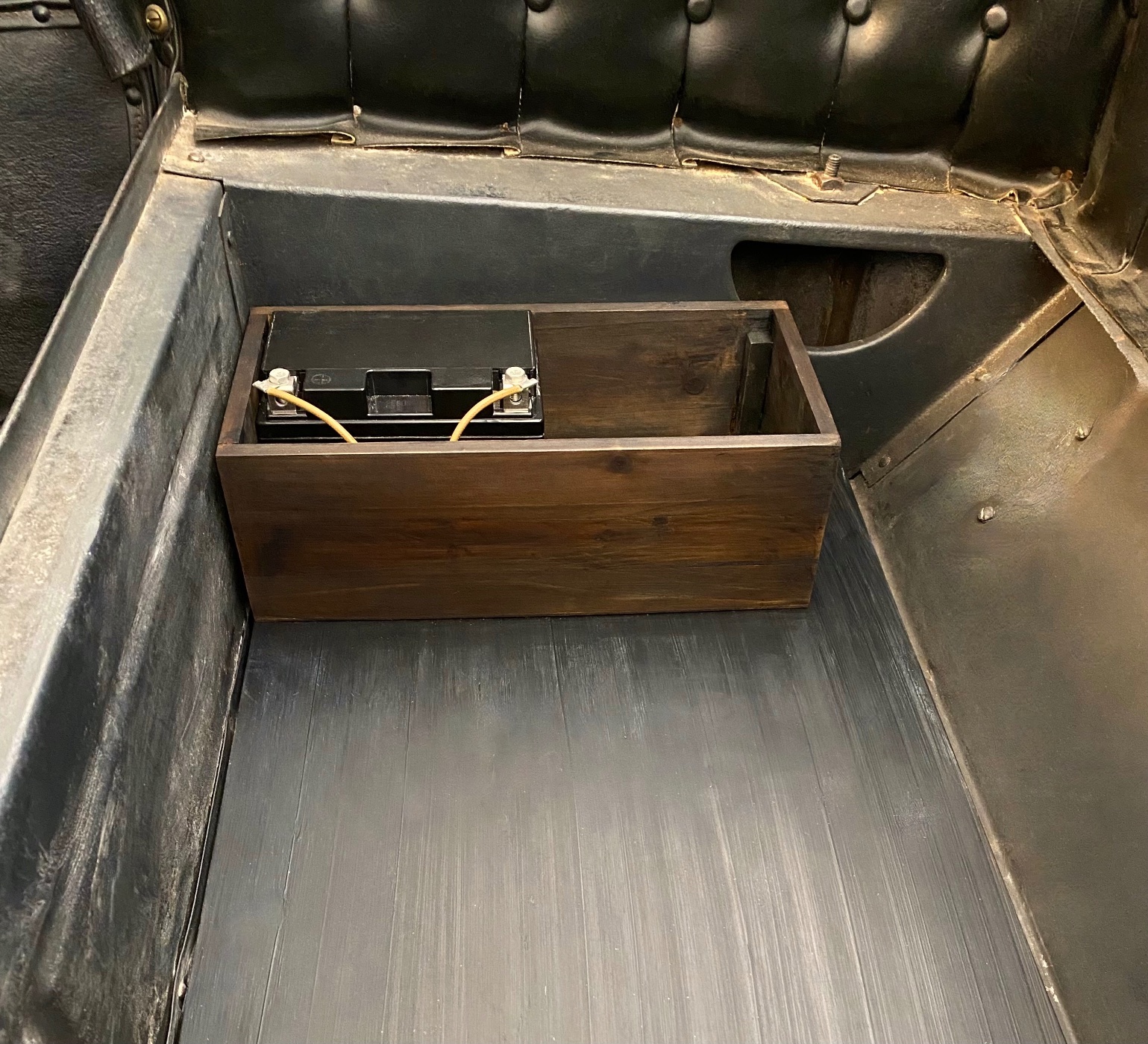

I recently installed a period style battery box in the 1915. Not much info available, so it's mostly guesstimates.
A wood box from a craft store is attached to a wood insert on the rear seat floor. Battery wires pass through drilled holes in the box, wood insert and the reproduction seat pan that came with the car. Cloth wires and flag terminals are from Ynez.

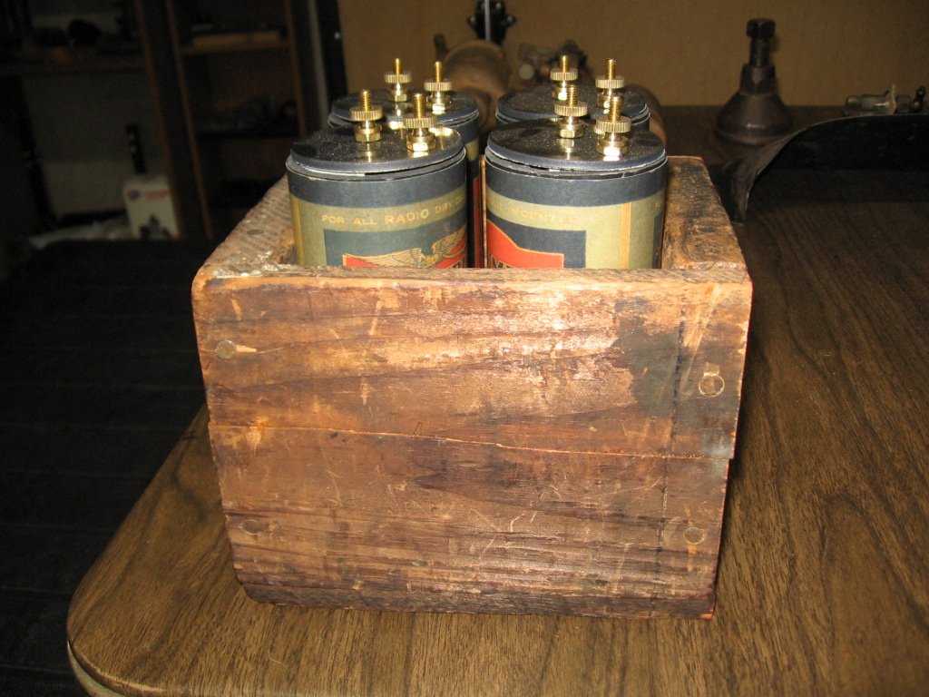

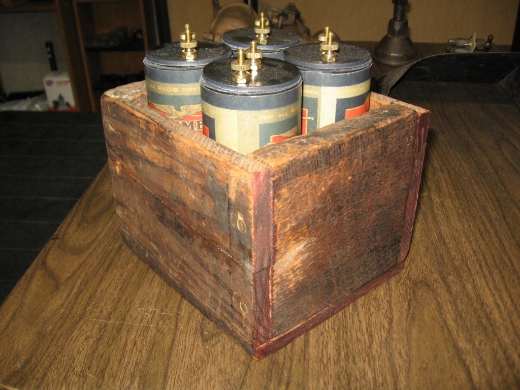

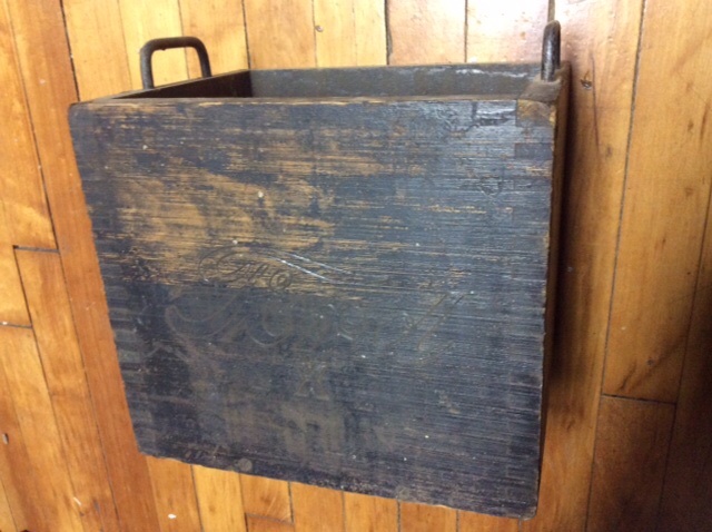

A bit OT, but I had some very old and distressed wood and a battery box picture from the Illustrated Parts Manual of my 1912 Flanders 20. From those, I was able to build a battery box with patina that matches the rest of the car.

That looks spot on!

No hijack at all, it's about period style battery installations, and yours is fantastic. Those little Flanders are amazing jobs, especially comparing the engine design with a contemporary Ford.

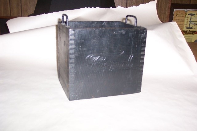

Do you think they might have had a box with finger joints? Seems like, back then they always went the extra mile even if it was more difficult and time consuming. Jim Patrick

It's possible. I can't tell from the pic in the illustrated parts manual, it only shows a top view of the Flanders battery box.

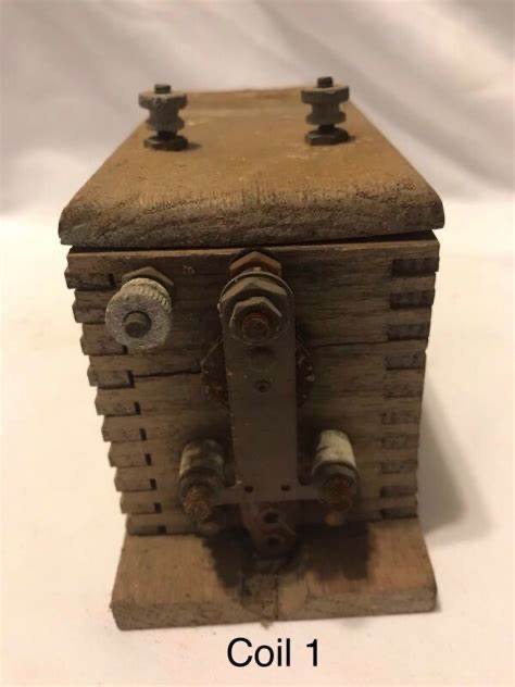

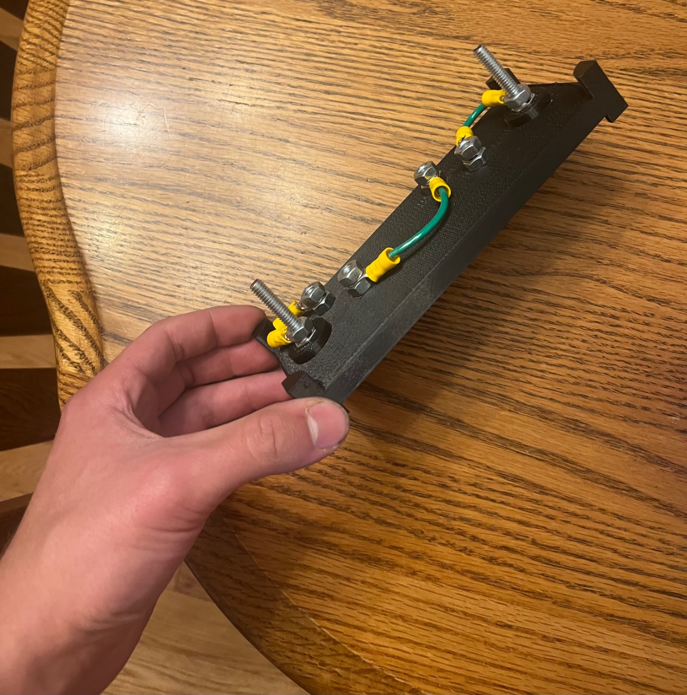

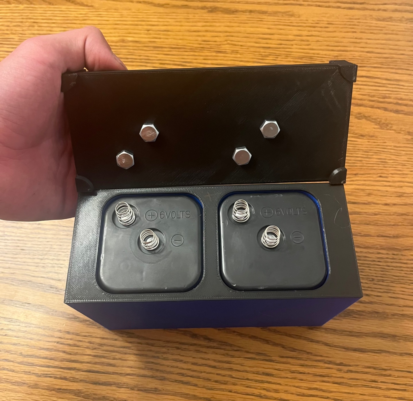

On that 6v dry cell topic I recently got a 1911 brush which needs 12v so I 3D printed what will be eventually the insert to a wooden box but it has contacts so that they can be in series. Im going to try and make the wood match the finish/ appearance of a coil box but my woodworking skills are iffy.

Nice setup. It looks like it fits in the box, hides the modern cells and makes all the connections. Your box will look great when it's done. Print is a neat approach.
I think the wood box handles are to lift it from a steel battery box. Seems to be normal for battery Fords, not sure of other cars.

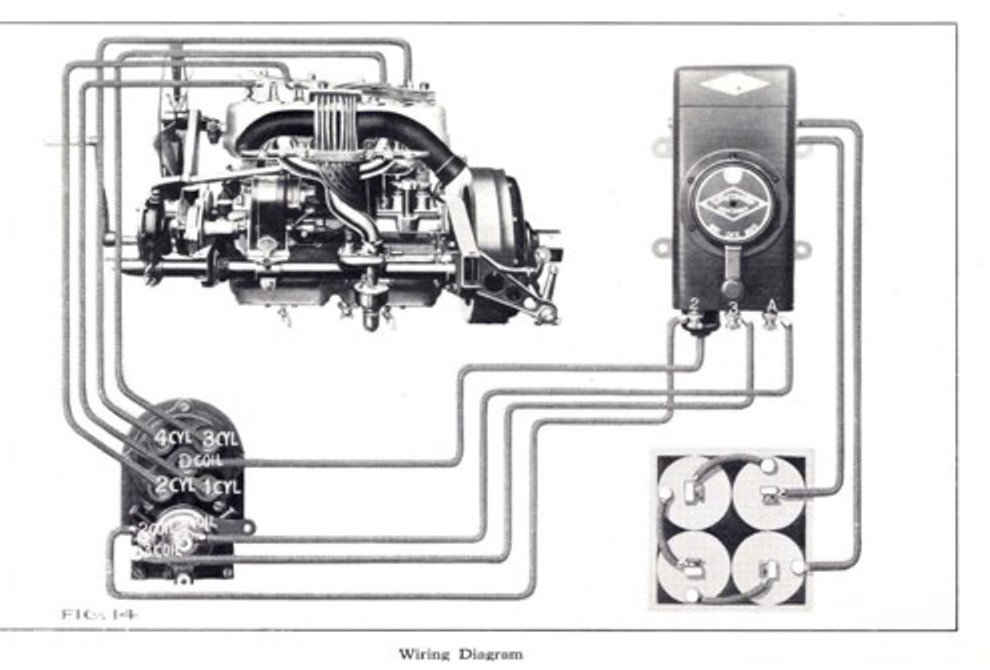

Mark, not much by way of battery placement and diagram in the EMF literature at all, not the diagram you have or the overhead chassis diagrams either.
