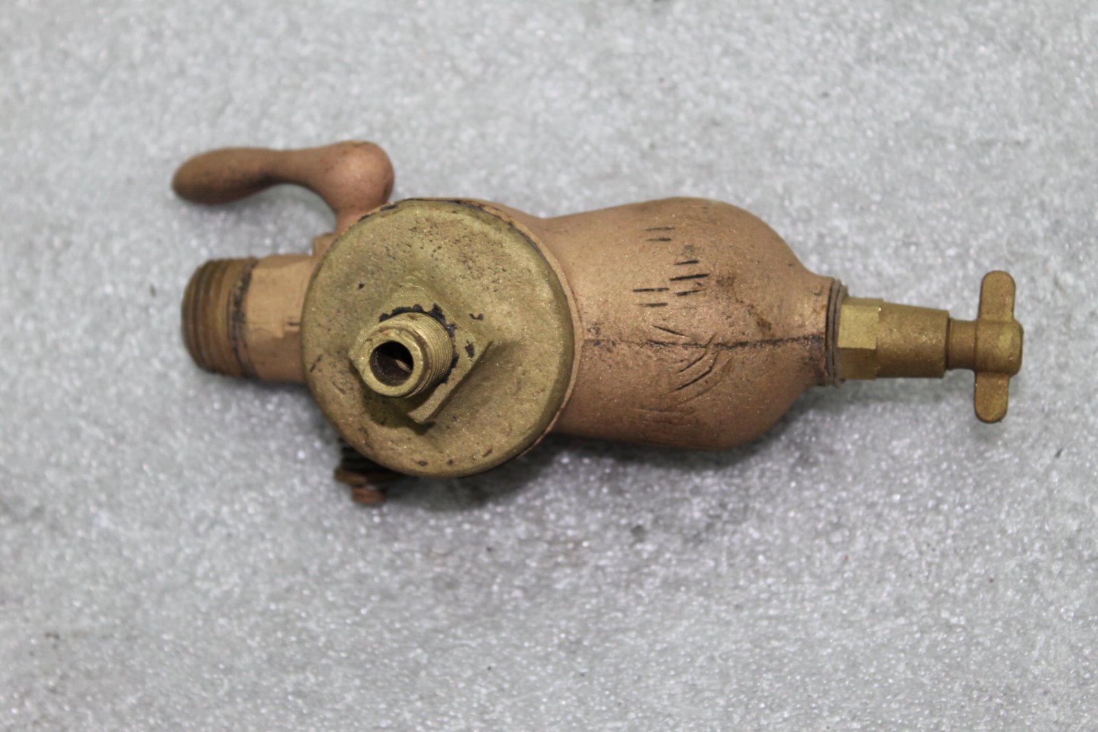

Does this look like the one?

Snyder's new repros are quite nice - we're lucky we can even get a new one !
Posts: 7131
Re: WTB working brass sediment bulb
Post by Allan » Fri Mar 01, 2024 2:18 am
That's the one Eric, but yours has a spurious drain cock. With the hex screwing up in close contact with the bulb like that, the thread may have been re-tapped to a parallel thread for that petcock.
