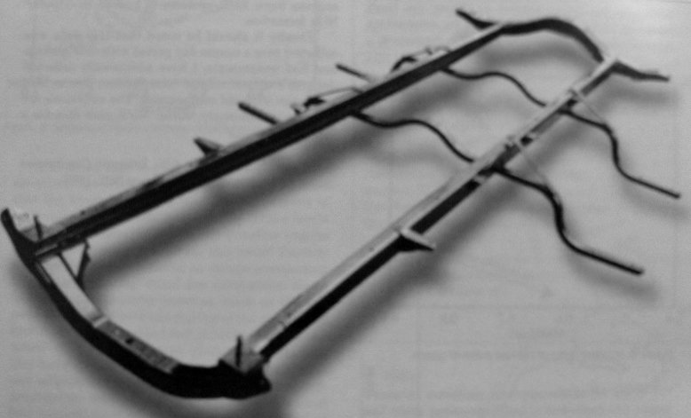

Here is a complete '26 frame with brackets - http://www.mtfca.com/discus/messages/50 ... 1445887806

Thank you for the explanation and photo. The referenced thread was interesting. The Warford I removed was the aluminum type with no cross bar supporting the weight and nothing like the aftermarket truss rod support shown in the thread. I suspect a lot of folks run with a Warford that way.
