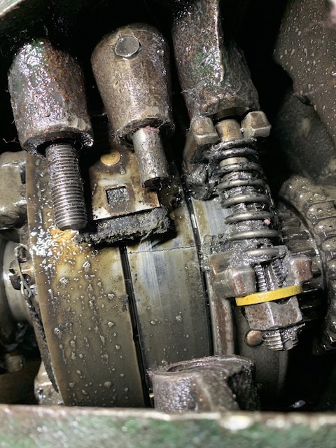

Post by Dan Hatch » Sat Jun 22, 2024 2:24 pm
Has to come out.

Could it be that obvious? Low-speed drum is cracked right across and possibility of water in the oil

That's better. But that drum sure isn't.

I don't know about JBWeld or tar, but I have a low speed drum taken from a working transmission that has had such a crack brazed up. I guess you do what you have to at the time.

A long time ago, I bought a big box full of model T transmission parts. Most of the parts were pretty good, some really nice pieces. However, also in the box were two drums that had been cracked across that way, and very nicely brazed and finished up. Over the years, I have used most of the pieces from that box. But I think I still have both of those two drums. I have threatened to use them a few times. I still might for some sort of short use spare engine or something? I just have never been able to bring myself to put them into a running engine. Not even a short use spare engine.
Part of me wants to try them. Part of me wants nothing to do with them in an engine, risking a major failure in the wrong time and place.

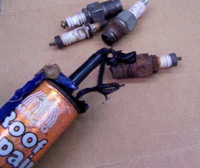

JTT3 wrote:
Sun Jun 23, 2024 8:09 am
As most know Hugh Jass was a visionary with his use & promotion of modified bituminous roofing tar. Perhaps the foremost advocate of its use in unexpected areas of model T restoration & maintenance.
Agree wholeheartedly about Mr. Jass. His knowledge on that material led me to find it the very best sealant to keep those stubborn bubbles from escaping around the spark plugs. Excellent method for this purpose.

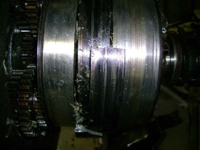

I recommend that you take the transmission out and either rebuild it or put in a different one which is in good condition. I will attach a picture of what happened to one of mine when I had a cracked drum. It locked up and I couldn't even push it in the middle of an intersection. Had to put a floor jack under one rear wheel to winch it up onto a trailer.
