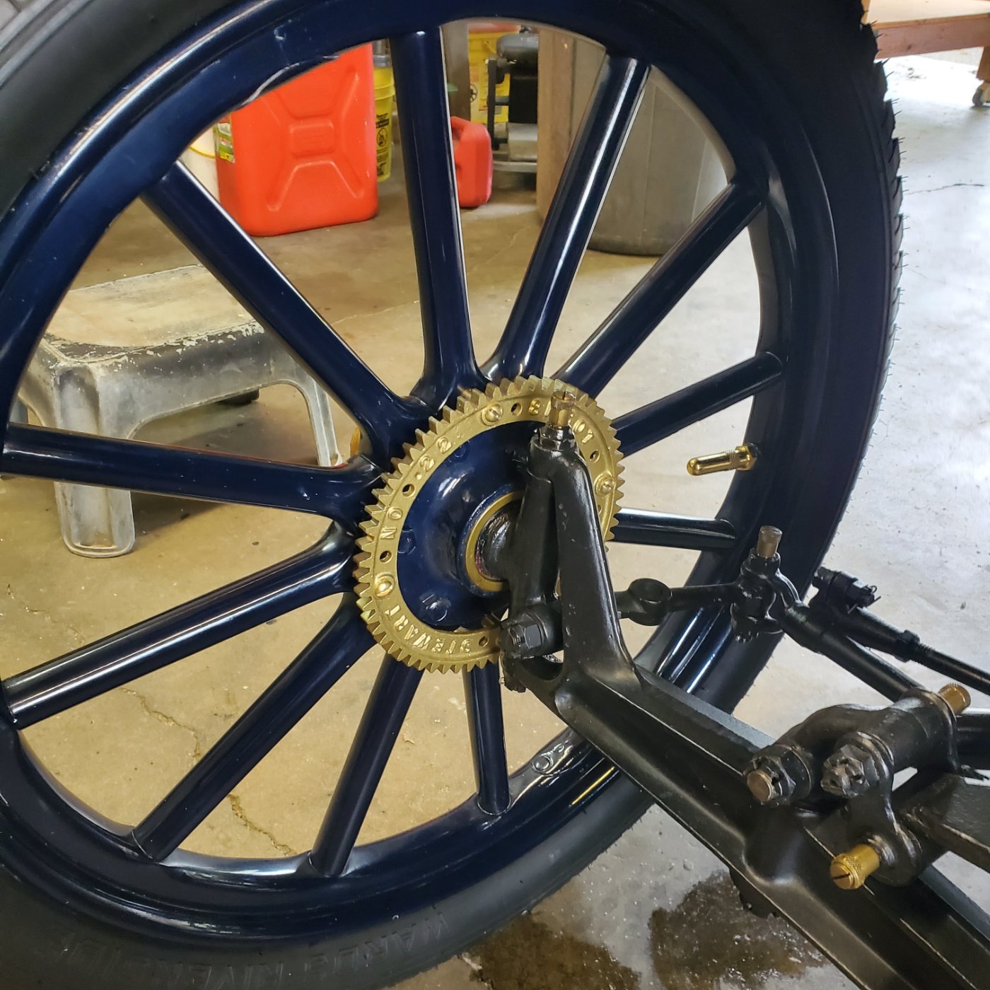

I have a 1920 wood wheel T (30 X 3 1/2") and want to mount a speedo drive gear true. Is there a template one can get (copy) or a jig? Any tried and true solitions??

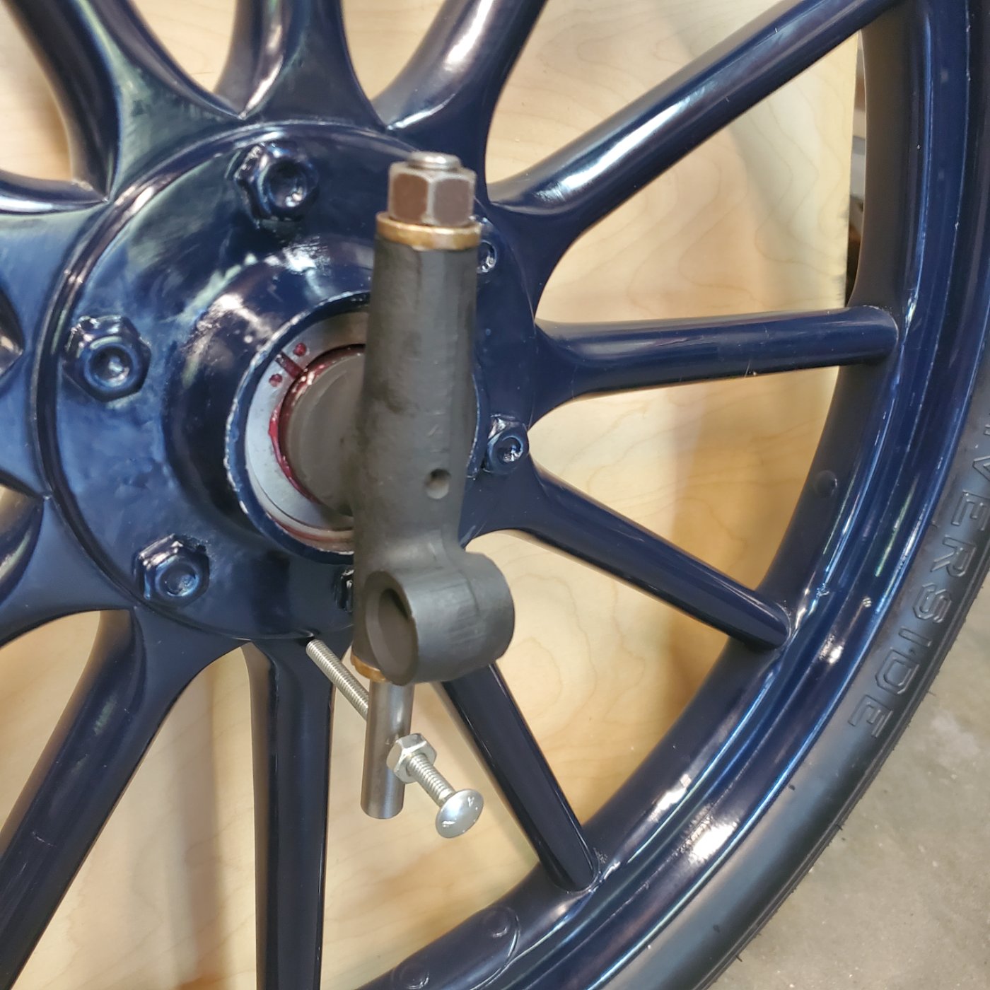

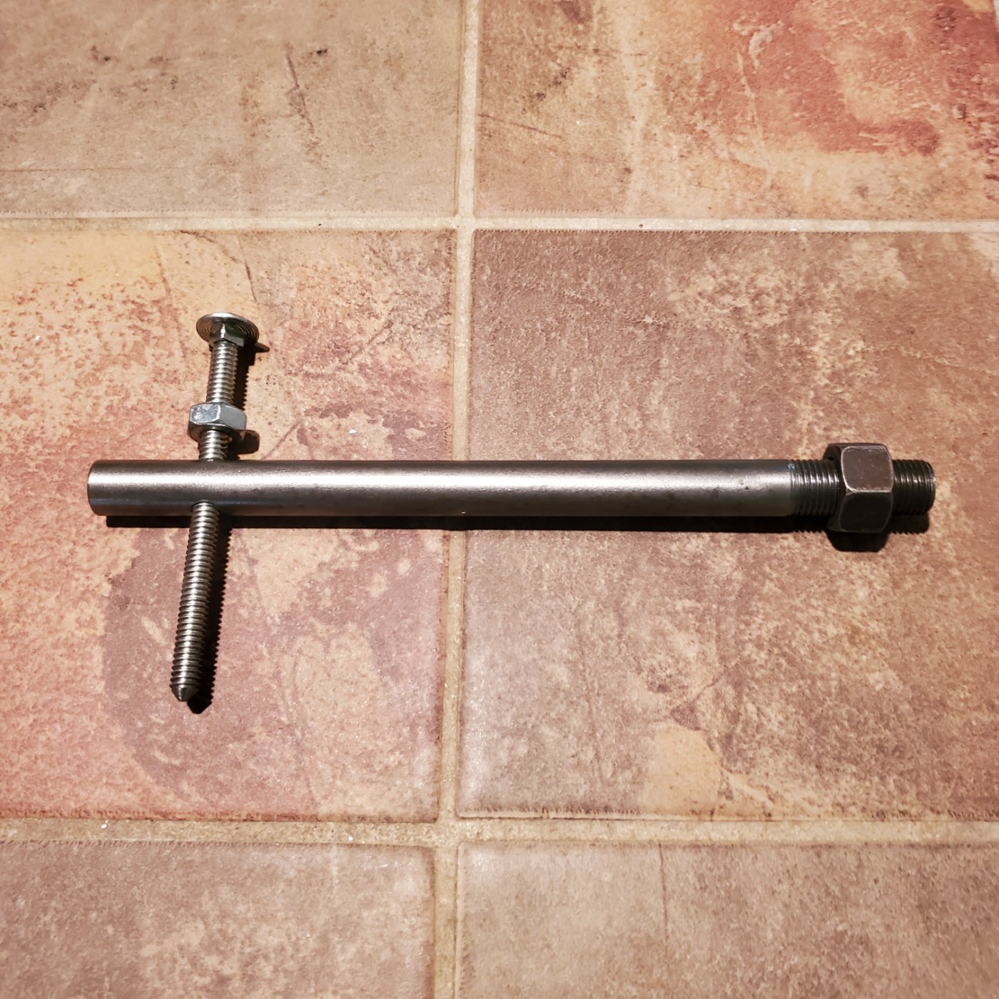

Post by RGould1910 » Mon Jun 24, 2024 8:14 pm
One approach.
