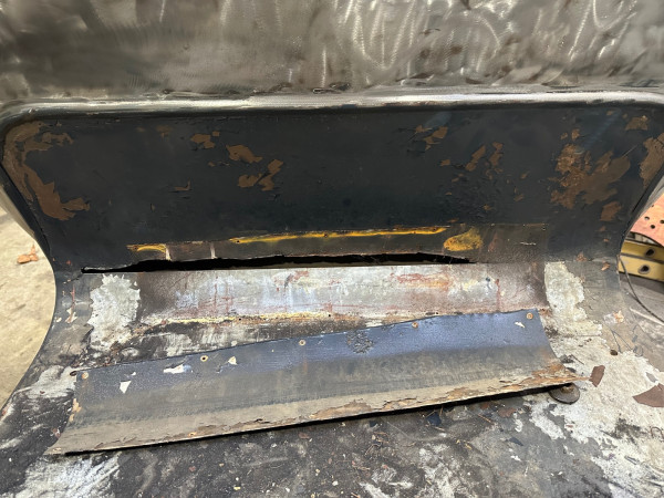

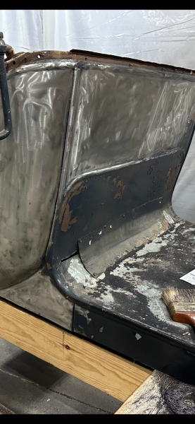

This is a 1914 Runabout body. It is s Beaudette body dated 10/14. Is this transition from the rear of the body correct? It looks like a patch. Art

That was added on. Looks like it needed it.

Yes, that's an add-on. I think the piece of galvanized sheet metal is as well. I believe the rear panel of the body should slope/curve down to the rear deck floor, then stop after becoming horizontal. The rest of the rear deck should be wood. (I have a '21 Runabout. Happy to be corrected if my advice doesn't apply to a '14)

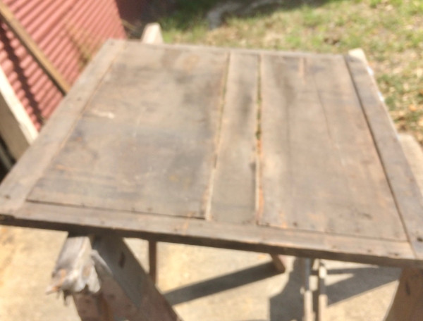

Yes, it is a patch and yes, it should have a wood floor. I have two ‘14 T runabouts. One of which I’ve restored and the other Ed Messenger restored. They both have wood floors. In fact, heres a picture of an original 1914 runabout turtledeck floor:

Thank you for all the responses. I can see the nail holes indicating where the turtledeck floor was nailed to the wood side frames under the turtledeck. I think the biggest challenge is going to be repairing the back of the body where the patch is. I assume the rear should curve into the turtledeck platform as Russ's does. Russ's is a Wilson body, can someone post a picture of the rear of a Boudette body without the turtledeck on it. Art

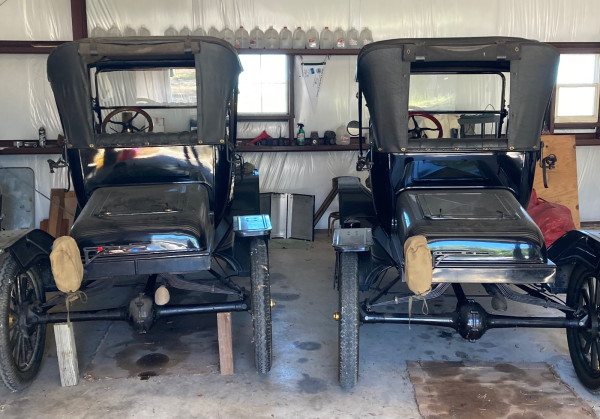

Art, I’m very sorry but both my Beaudettes have a turtledeck installed.
When the snowflakes start falling in Illinois, why don’t you drive south to sunny south central Texas and pick up that original turtledeck wood floor - like they all had.

Very Cool, George - his & her Runabouts !!!

Thanks Steve… the T on the left is an April 1914 so it has no bill front fenders and aluminum crank handle. The other is an October 1914 runabout so it has the ‘bill’ front fenders and cast iron crank handle. I’m very thankful to Wayne Sheldon for confirming the ‘14 models were factory assembled into very early 1915. They both sport U&J updraft carbs and are scary fast. I’d really like to give Art the turtledeck wood. Thought about donating it to the museum in Richmond for study or utilization.

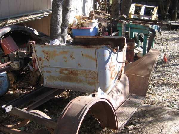

George H, Wow, two beautiful 1914 runabouts! I like how you have two, build dates about six months apart. One representing the early 1914s, the other the late 1914s. Wonderful bookends showcasing a remarkable year of the model T.

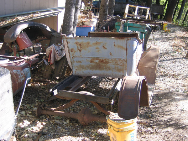

As for the rear panel of the body? I don't have any good pictures of my 1915, and don't know for certain it would be the same either? But I can try to post a couple "before" pictures I do have.
First, a bit of backstory. My car is not an intact survivor. The body was separated from its original chassis decades ago, probably because the body was in poor condition and in the early days of the hobby it was common practice to simply replace the original body with a nice later one (somewhere out there is my car's original 1915 chassis with a later body on it?). The body went through a few owners, some doing some work on it, most doing more harm than good.
When my circumstances made me decide to put together a 1915 runabout (a car I have always liked and had fond memories of a few of them), a very good friend offered me this body which he had gotten with a 1914 chassis he wanted. I had been collecting late brass era model T parts for several years and had restored a 1916 center-door sedan some years earlier. So I already had most of the rest of what was needed to put together a fairly right 1915.
That is the background for my 1915. The body, however, still had its original manufacturer's serial number identification plate. It does not have the code for who built the body, although the manufacturer's steel plate does look like the ones used by Beaudette. The original wood was in poor condition, only about half of it was usable for patterns. It was mostly sort of intact, with very rusty original nails nearly rusted away. The rear deck was missing its floor, however the sills were still together enough to provide the original rear inside corner brackets. The cowl panel might have been changed by a past owner (it had been messed with), and the door and turtle deck were missing. The original manufacturer's date coded serial number plate was still nailed (very rusty nails!) onto the sill inside the front door (I kept that piece of wood). The date code indicates the body was an original February 1915 ordered/built body.
Is that rear panel on a February 1915 the same as a 1914? Your guess is as good as mine, but I suspect it likely would be the same in spite of the 1914 differences around the front of the bodies.
I had actually considered altering the front of the body to "create" a 1914 runabout. However, since the date coded manufacturer's serial number plate indicated that it was a real 1915 body, I decided I would rather have an almost real early 1915 than a real fake 1914. But while restoring the body? Doing research I found out that the 1914s used a different door hinge than the 1915 and later open cars. The bolt holes were located slightly differently, and the hinge was located a quarter inch higher on the 1914s than they were in 1915 onward. While restoring my 1915 runabout body, I found it had had the 1914 style hinge location.
Remember that the body had been separated from its original chassis, so it is sitting on a piled up chassis with 1916 fenders propped up as inspiration (?).
After all that? Whether these "before" pictures of my messed up body help you or not? Here they are in all their messed up glory.

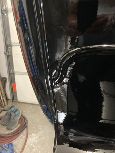

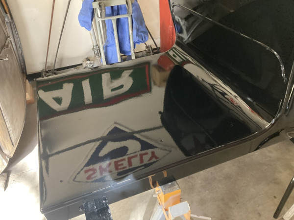

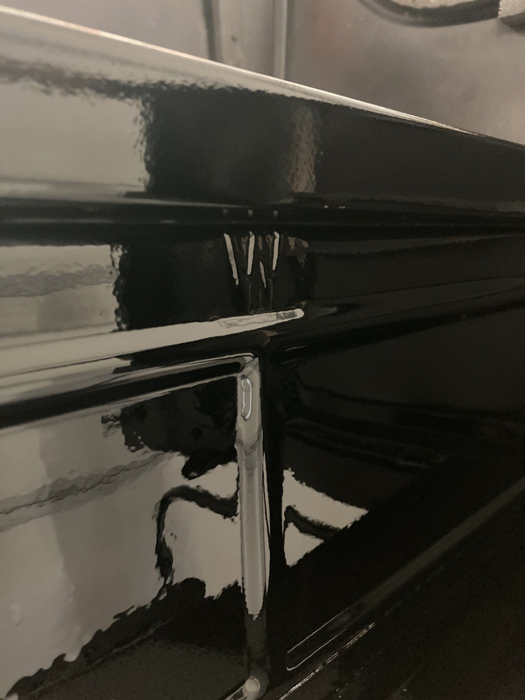

The rear body panel on my son's 1914 runabout is like Larry Smith's 1913 runabout. It is one piece that goes all the way under the turtle deck. Also, the bead on the back panel is different that some other bodies. This is a Wilson body and was produced in August 1914.
Regarding the turtle decks, the 1914 turtle deck that was on my son's 1914 (the car photographed) did not have a wood floor. The steel floor provides strength for the items stored in the turtle deck. I have a 1913, Wilson body runabout, and it is identical to my son's 1914, with a one piece rear panel and no wood floor in the turtle deck. It seems that Wilson bodies varied from other manufacturer's bodies.

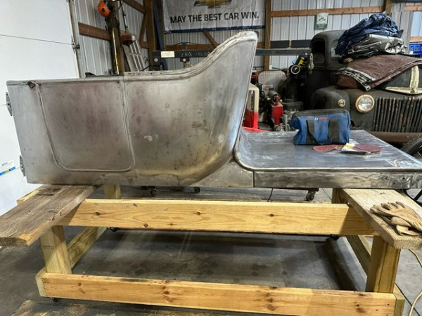

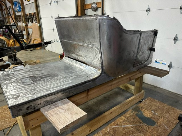

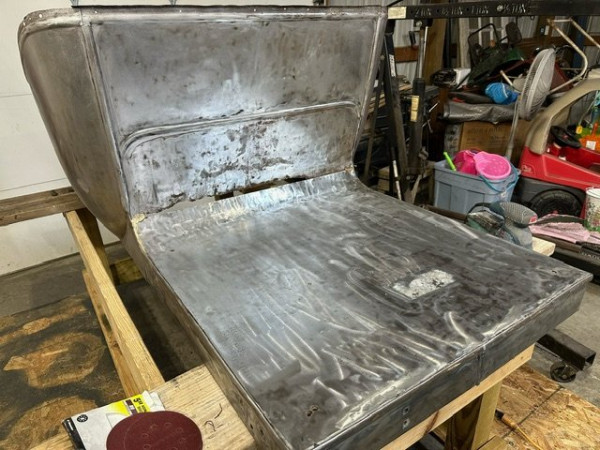

Here is the latest picture of the 14 Runabout body after removing the paint. Art

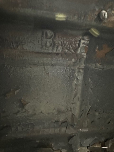

Art, The turtle deck floor looks great. Is there any letter stamped into the kick panel just below the seat cushion? Russ Furstnow
- Posts: 2888
- Last Name: House
Re: 14 Runabout body question
Yes ! You’ve obviously accomplished a lot ! You can cut off the cancerous rustout at the lower back body panel and there exists machines that can correctly curl 20 ga sheetmetal to MIG weld to the original squared off panel. I’m curious of the 2 vertical holes in the very rear ostensibly for the tail lamp bracket ? My 2 (4) bracket holes are on a horizontal plane ? A bit of $35 research I had done at BF Archives revealed the carriage bolts at this location used SQUARE NUTS. FWIW

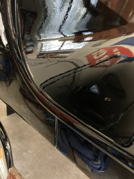

Another for whatever it is worth?
There are some obvious changes between 1914 and 1915. However, my 1915 in spite of poor condition, still had the inside corner brackets in place. The 1915 tail lamp and bracket are of course quite different from the 1914, and the original bracket had been broken off. Yet the original bolts for the bracket were in place. And so were the square nuts. And that is how I restored it.

Russ, There is a B on the seat riser. George, I am glad you noticed the tail light bracket holes. I do not have a bracket and I think the holes should be horizontal like yours. Art
