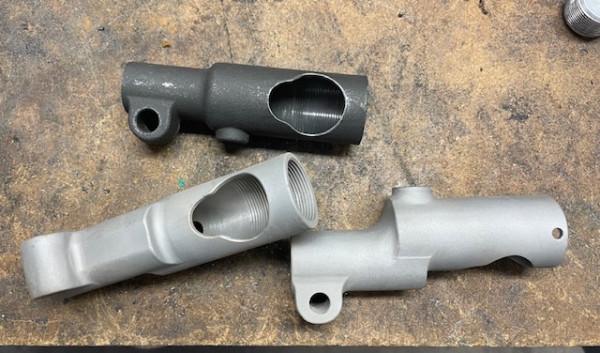

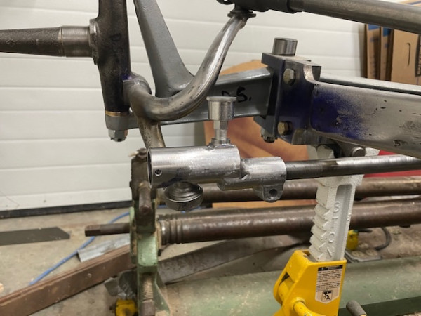

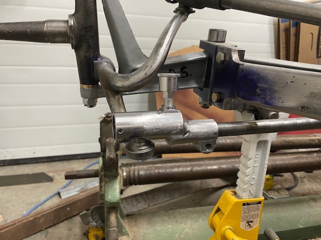

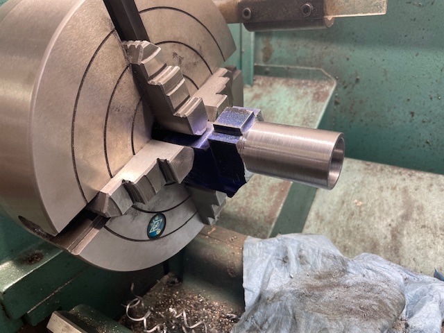

I am using model A style steering ends on my 26 speedster project, but needed to get some more clearance between the tie-rod and the radius rods. The most elegant way to do it was use an offset tie-rod end. I didn’t find what I wanted so I made them out of a bar of 4130. They use the standard model A innards and give me 3/8 additional clearance. I think they came out pretty well. I still need to split the lug so I can tighten them on the rod then black oxide them. Here are a couple of shots.
Boring and turning the big end.
Checking the fit
Checking the fit
Blasted and ready for finish, with a stock model A tie-rod end.

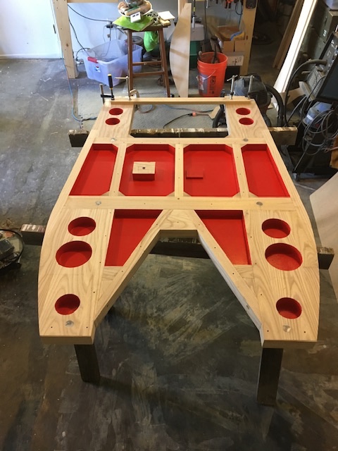

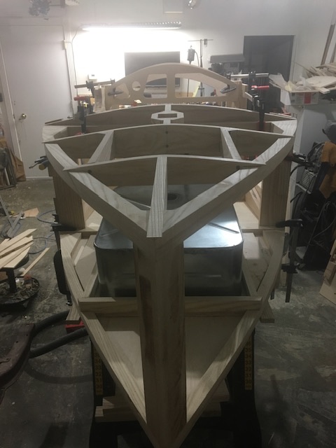

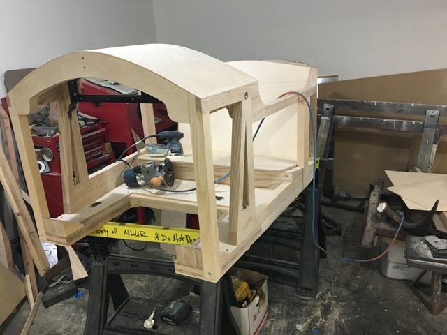

I have the body frame done but it’s not skinned yet. It is going to use wider strips (3-4 inches wide). I had to work out some mechanical things before finishing the body, but I am getting back to it. Here are a couple of shots of the body frame.
From the front
From the front
From the rear
From the rear
The base under construction.

Nice work. Looks to be master boatbuilding grade construction. You might want to consider okoume or sapele mahogany ply, edge glued strips for skin. It would be the lightest unless you want to go sheetmetal.

I am using a thin birch ply for strength overlaid with thin strips of mahogany. I have a pile of old mahogany that was used for wainscoting. It’s not the lightest way to build it, but it will be strong.
