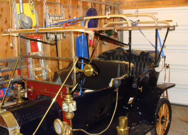

I am rebuilding my 12 touring top with original irons and new bows from Langs. I do not trust that my bows were original so I do not trust using my original bows as pattern to in sure that a new top that I plan to purchase from Classtique will fit properly. I located this old thread from the forum in 2011 which includes an original drawing for a 1913 top (I could not get that drawing to copy into this thread). The 2011 posting is as Follows:

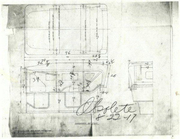

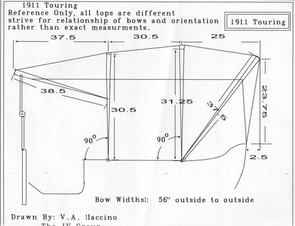

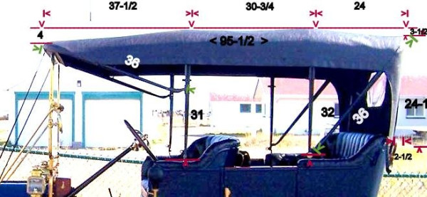

Re: 1912 Touring top drawing needed
I have the following info that has been posted on this forum over the years. Les
Les,
Thanks for posting the drawings!

It turns out that I have very good agreement with the drawing below. I do believe that my bows are original. The problem is that the rear bow, #4, has been broken and crudely repaired with a splint and the front bow, #1, has a significant bow inward where it should be straight. I purchased 4 new bows from Langs which are supposed to have an inside dimension of 54 inches per their website and 3 of my original bows are 53 1/2 inches. Although bows #2 and 3 look good they will not stack when down with just 2 new bows ( #1 and 4) such that I think that I will have to replace all 4 bows.

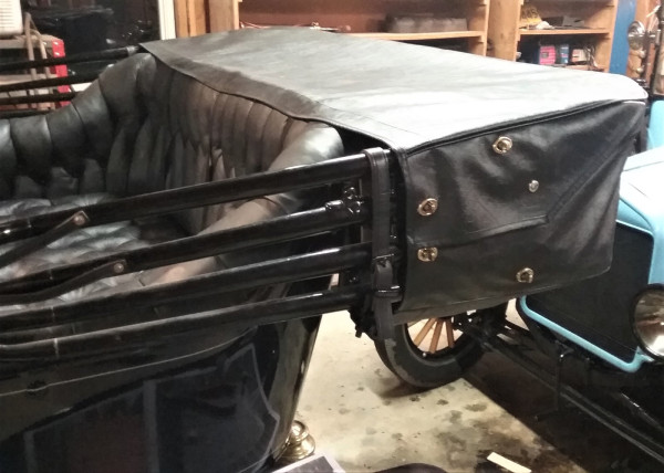

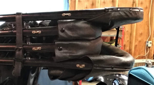

Yes.
When the top is folded down on my 1911, bows #1 and #4 and even and #2 & #3 are even.
When the top is in the up position, the total vertical height of bows #2 and #3 are even.
Take your time to line up everything.
I made this pattern for a top boot. Mike at Classtique made it for me and has the pattern.
-Keith
-Keith

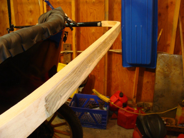

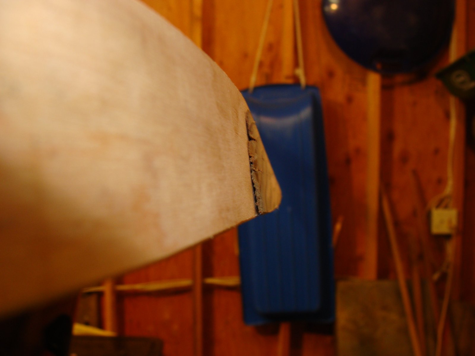

Keith,
Many thanks for the post with excellent photos and dimensions. Not sure that I understand the "wedge". My #4 bow is very bad with several repairs. Does the wedge increase the thickness and arch the #4 bow?
Here are a couple of pictures of the #4 bow "wedge" that I created:
Here is some information from a few years back when I did mine:
https://www.mtfca.com/discus/messages/3 ... 1368324877
I'm sorry, I don't remember how wide I made it.
Keith

- Posts: 6916
A thin wedge like that will help retain a slight upward bow in the rear bow. The rear bow takes a fair load, being pulled down by the rear curtain, forward by the top and every which way by passing traffic, especially trucks. I know it is not a Ford factory item, but a 1 1/2" wide x 3/4" thick board, shaped to follow the inside profile of the back bow, makes an excellent stiffener for that bow. They are standard issue on some of our colonial built cars, including my wide body Duncan and Fraser built roadster.
