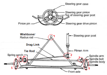

You should consider all the parts related to steering nit just the front axle
If you redo the spindle bushings you'll need special tools. Spindles bolts needed with new bushings.
Start looking at the ball of the pit man arm, tie rod & even the wishbone for wear. Shackles & Tie rod bolts: their bushings too.Don't forget the steering bracket bushing. Sometimes over looked is the steering gear cover underside.

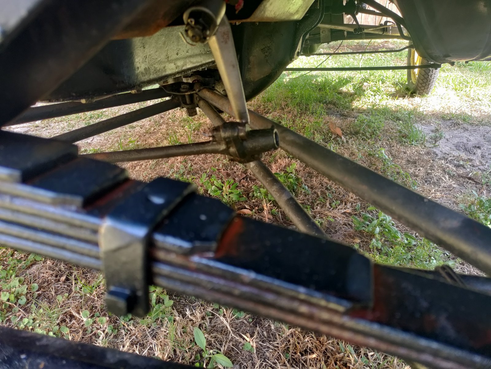

I recently bought the axle book before I bought any of the parts and I'm about to buy the parts but something is throwing me off I think I might have a later production front axle than what I should because according to this book the wishbone should only have the two struts my Model T has four like the later one. Tomorrow when it is brighter outside I'll try to take some clear pictures, I don't want to get the wrong parts.
- Posts: 6544
Re: Front axle rebuild questions

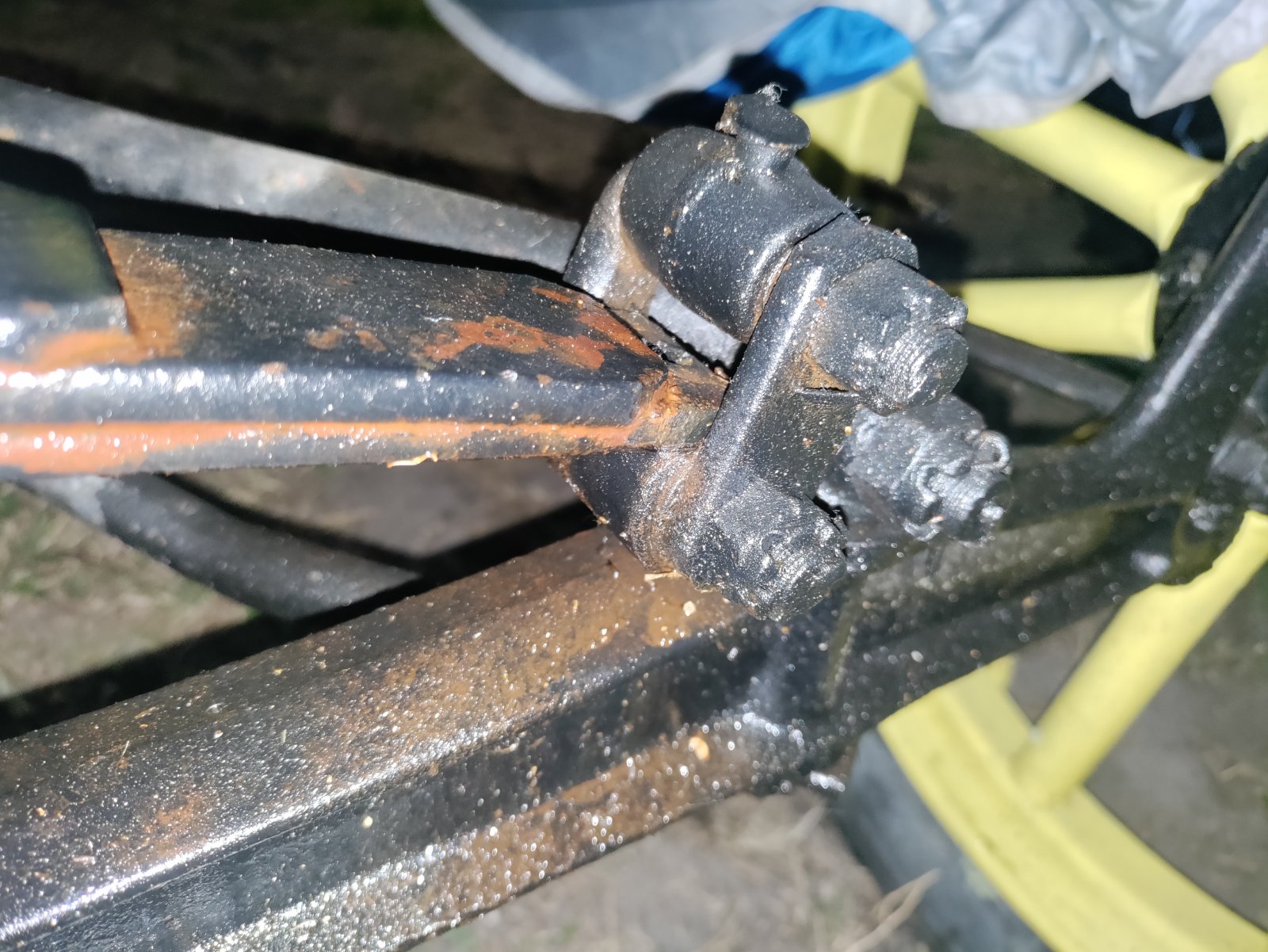

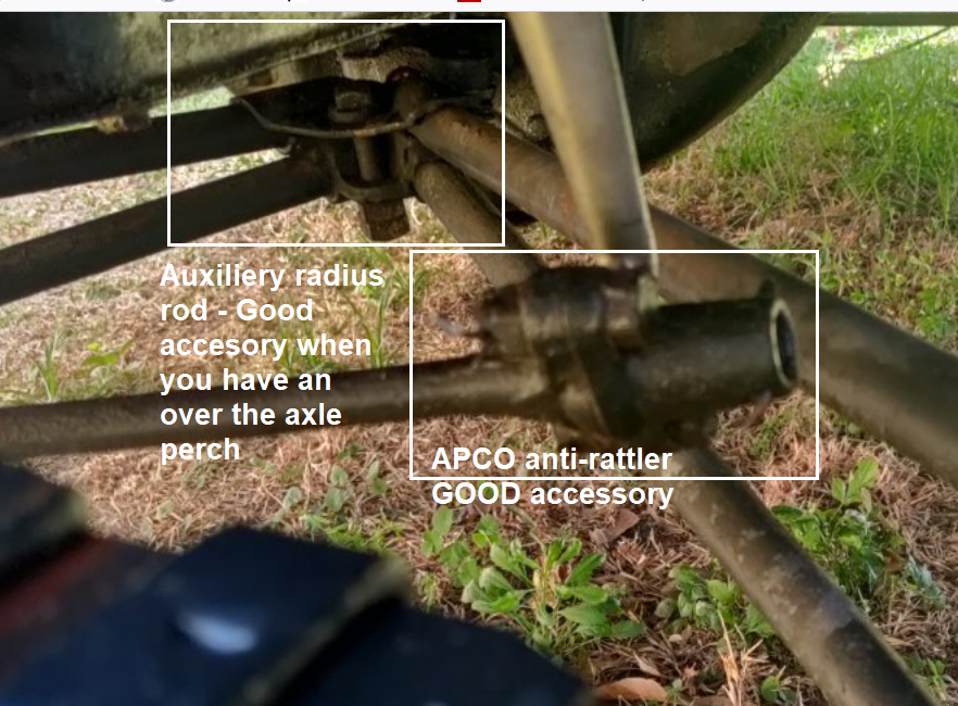

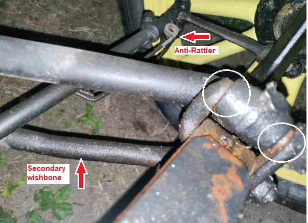

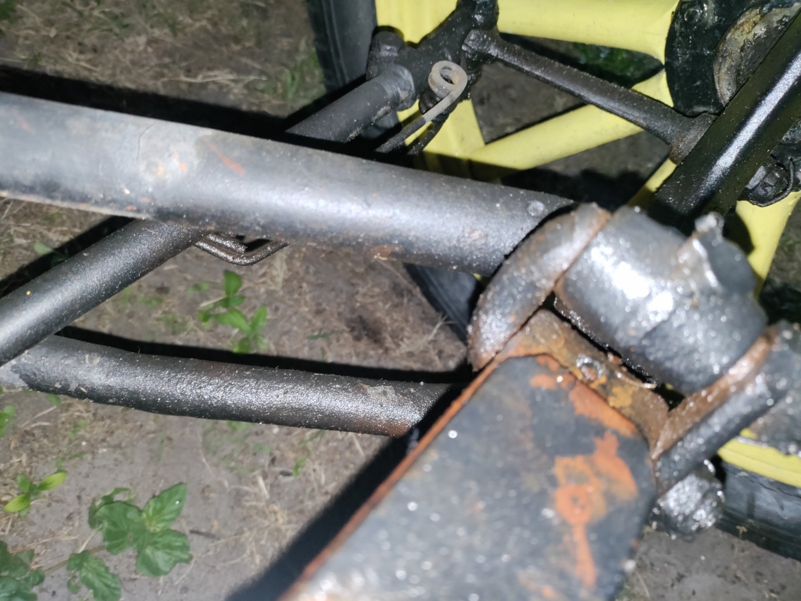

Since you said it has four struts I took a closure look at one of the pictures.LittleTimmy52 wrote: ↑Tue Mar 25, 2025 8:50 pmI recently bought the axle book before I bought any of the parts and I'm about to buy the parts but something is throwing me off I think I might have a later production front axle than what I should because according to this book the wishbone should only have the two struts my Model T has four like the later one. Tomorrow when it is brighter outside I'll try to take some clear pictures, I don't want to get the wrong parts.
One item you have is an anti-rattler this was a "fix" to a worn tie rod bolt and/or yolk. I expect you have one on the other end as well. You shouldn't need it.
The circles indicate rust in the shackle/bushing - so you can expect some issues here.
You have a double wishbone (radius rod) set up. The upper one is stock for a 1917 style perch. The lower one was an aftermarket accessory and worthwhile to keep, as a safety improvement. Later model axles just had a lower one as a design/handling improvement. Take a picture of the end that mounts on the engine pan so it can be identified as an accessory or home made one

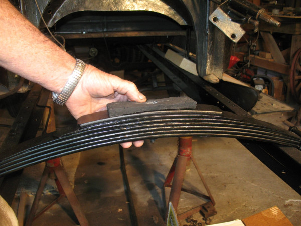

Don't forget the pad on top of the spring.
This one is DIY from a piece of tire.
- Posts: 4394
Don't use a pad so thick that the square head of the spring bolt can't reach the hole in the frame cross member. The bolt head needs to fit into that hole to keep the spring located properly.Steve Jelf wrote: ↑Tue Mar 25, 2025 11:08 pmDon't forget the pad on top of the spring.

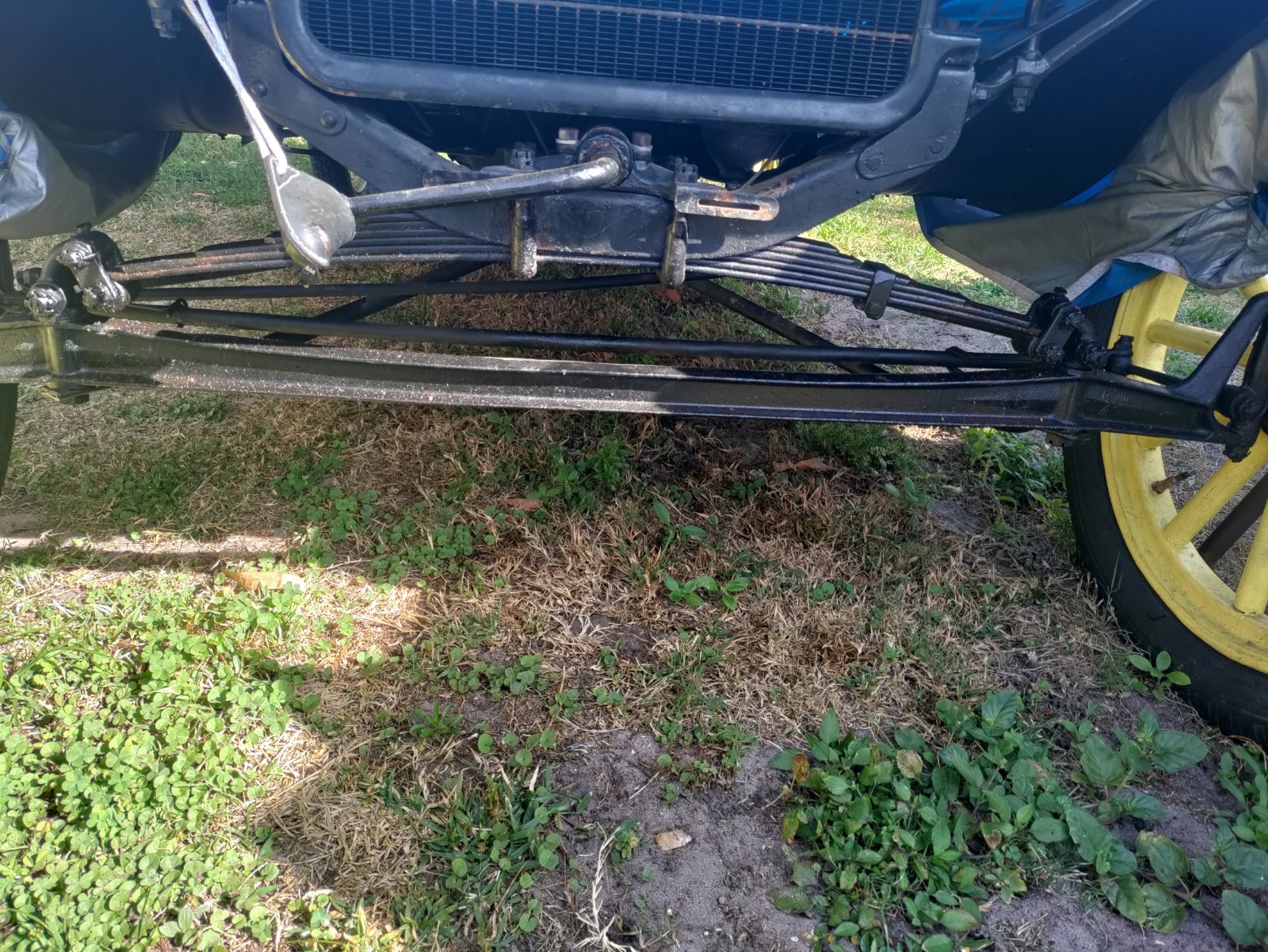

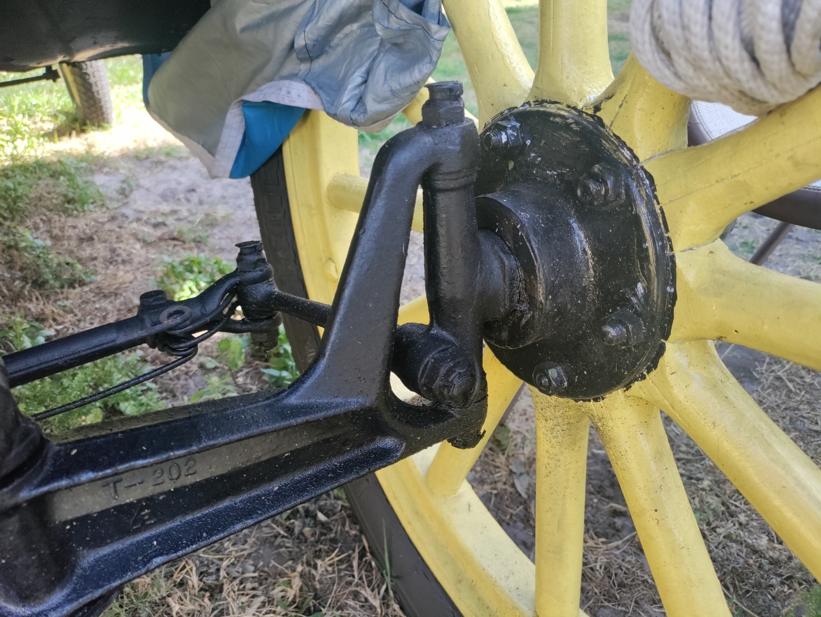

Here are the images. I'm thinking later model front. But what do y'all think?
- Posts: 7395
Never assume that whatever is on a T when you get it is "correct".
In that last picture the absence of a radiator apron suggests 1923 or earlier.
The spring clip is 1919 or earlier.

I have a 17 but the front axle looks like that of the later ones the 19 and later I think, I just want to know if this is the early or late front so I can get the right parts. Also side question how much is an early front axle assembly? Or the parts to correct mine to be more correct for 1917?Steve Jelf wrote: ↑Wed Mar 26, 2025 11:48 amNever assume that whatever is on a T when you get it is "correct".
- Posts: 7395
Early and Late are too variable/indistinct to be useful. Is the1920-1927 spring clip early, or late? It's 20-27. Getting the "correct" parts requires some research. Do you have the same 8-5-28 parts book everybody has? It tells you the years of many chassis parts, and has pictures that can help. Do you have a Ford parts book that covers the year of your car? (1917 isn't it?) For identifying parts, the two Gail Rodda books are helpful. Like Sergeant Schultz, I know nothing. Well, I know a little, but some people think I know a lot more than I do because I refer to references. Nobody can know everything, so I believe in having books and other references where I can look for things I may not remember adequately.
How much do the right parts cost? Oh boy. It depends on where you get them. You can buy some good things shockingly cheap at auctions, if you know what an item is and nobody else knows or cares. I bought my set of Boyco running board cans for less than $10 because nobody else knew what they were. I bought two 26-27 Ford gas tanks for $1 because I was the only one to bid on them. I bought a pump jack for $1 because I was the only bidder. You can also spend way too much If you get carried away in a bidding duel. If I see something I want at an auction, I decide on a limit before the bidding even starts.
Swap meets (Hershey, Bakersfield, etc.) can also have prices that are wonderfully cheap, or way too much. Knowing what you're seeing, and how desirable it is, are important factors in preparing to shop.

Most model T parts are upward/downward compatible. As a result, parts from a later year are often used to replace earlier ones. So.....LittleTimmy52 wrote: ↑Wed Mar 26, 2025 12:14 pmI have a 17 but the front axle looks like that of the later ones the 19 and later I think, I just want to know if this is the early or late front so I can get the right parts. Also side question how much is an early front axle assembly? Or the parts to correct mine to be more correct for 1917?Steve Jelf wrote: ↑Wed Mar 26, 2025 11:48 amNever assume that whatever is on a T when you get it is "correct".
"Correct" can be for the year or an acceptable similar part for safety.
Front axle changes by year https://www.mtfca.com/encyclo/F-H.htm#fr1
other references
https://www.mtfca.com/encyclopedia/
https://www.cimorelli.com/mtdl/1917/default.htm

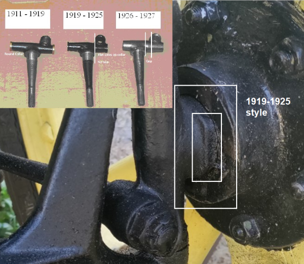

Not sure why your thinking the axle looks like the later other than the spindle is for 1919-25. The rest of the parts look correct. The key part is your 2 hole perch. I wouldn't change the spindles

By 1917 I believe the front axle beam design was largely set. The only discernible differences were the position of the T 202 part number and the forging mark for the different suppliers, neither of which can reliably used to date the axle. Just find the best one you can and work on that.
The bits and pieces to go with it do vary. 1917 should have a chopped leaf spring, L shaped spring shackles, over the axle wish bone and perches to suit, straight spindle arms and spindles without the flats on the inner end. If you want to keep the two wishbones, it may mean you have to use later bent spindle arms.
Hope this helps.
