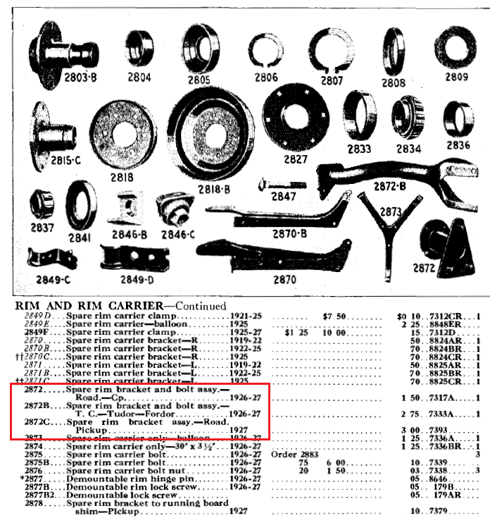

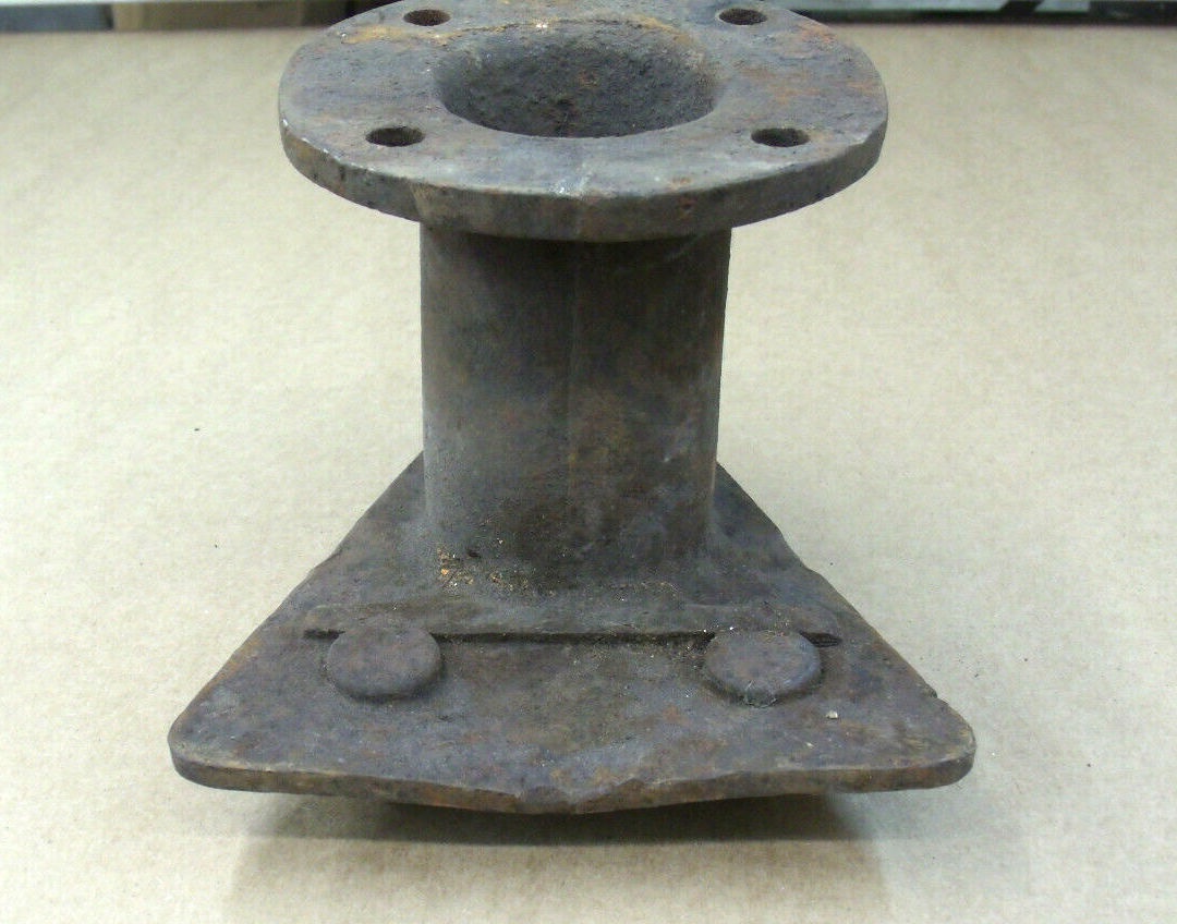

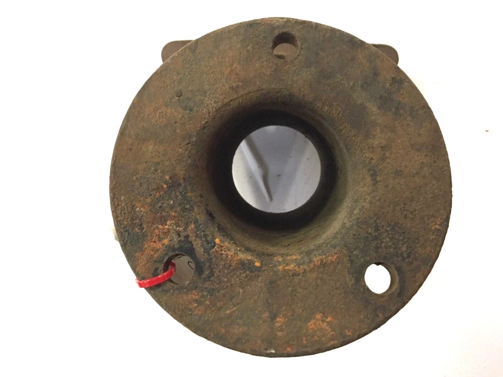

Been a while, but do remember the early '26 (Nov '25 serial) runabout body I restored used the 3 hole mount. Believe that the 4 hole mount came along later, as there are later runabouts with the 4 hole mount. Parts and Price books are unclear for the 2872, the factory # is 7317A for this runabout and coupe mount, so there may have been a 7317 assigned for the early 3 hole? Ford used the letters after the # to indicate change.
So check you body to see the # of holes for the rear mount.
Uncertain about length differences.

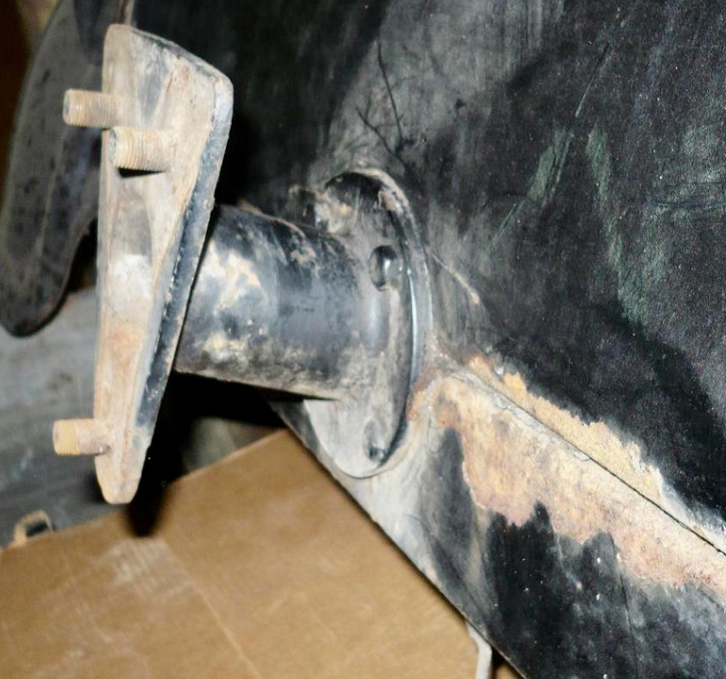

My Coupe was made in May, '26 and has the three hole version. Best, jb

I'm running 30 x 3.5 disc wheels on my Racer & used a 4 hole mount with the 23" Y for the rear mounted spare - I measured 2 of the 4 hole mounts both at 4 & 1/4" - 2 of my 3 hole mounts are 4" & 4 & 1/8".

My ol roadster was a late ‘27 with the trunk floor attached to the deck, was a 3 bolt. Check the internal brace that supports the panel below deck lid for the upper hole(s).

My '26-27 roadster had a 3 bolt carrier.
