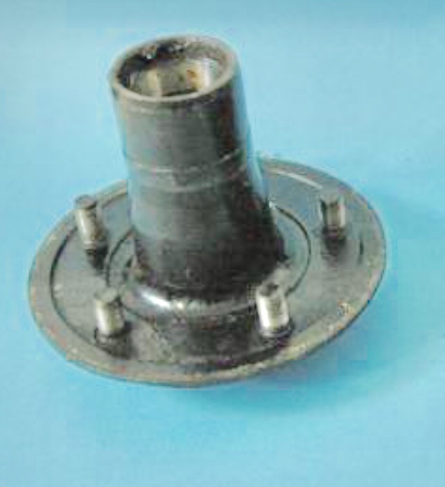

I have several front wheel wire hubs, but do no know if they are original Ford 1926-27 hubs. Does anyone have a photo of these hubs?

Model T front wire wheel hub. 5” bolt circle.
- Posts: 5507
Re: Wire wheel hubs 1926-27
There are some trailer hubs that use 5 on 5 too.
- Posts: 4052
Key detail is the raised ‘collar’ or rim around the backside of the hub. That provides locking system for the special Ford hub bolts. Also most have a small depression in the casting on the backside of the center with Ford script.
