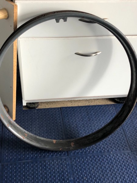

I have a ‘23 Touring, I was replacing the tires and I have this rim as a spare. It is not correct for this car and was I wondering if someone knows what it goes to?

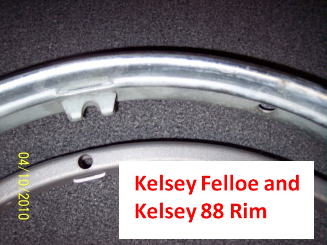

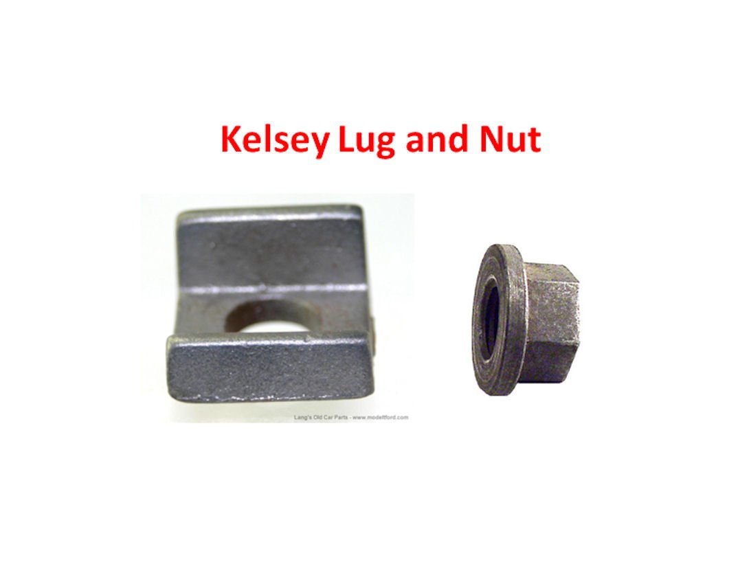

It looks to me like a Kelsey 88 rim. It uses a special felloe with four notches and separate lugs.

Thanks for the info Mark. What vehicle would it fit?

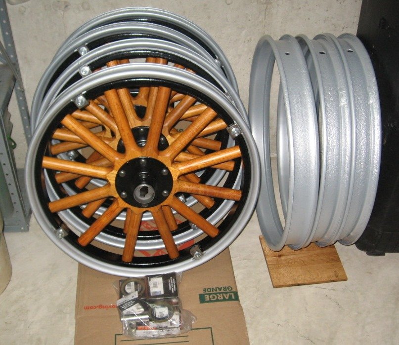

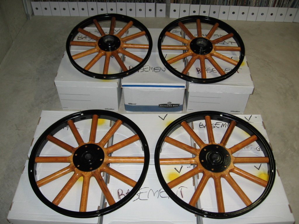

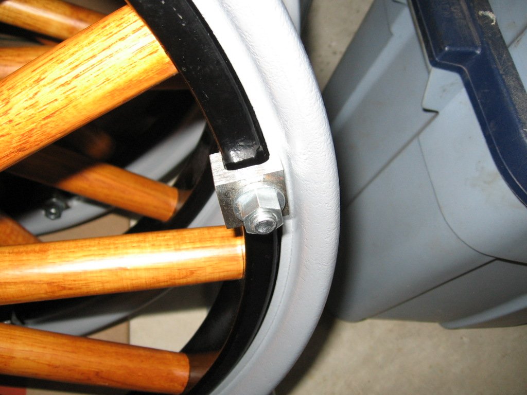

The last picture in my post lists applications of Model T Ford, Gray, and Maxwell. Here are a few pics of a set of Model T Kelsey wheels that I built up a few years ago, then sold to another member in Texas.

Mark, were the lugs and loose lugs on your re-built wheels new items from the vendors? Well done for them to make them available, though the price is a little daunting.
They appear to be totally machined, and thus are perfect, unlike the originals you show in the photo earlier in your post. I was fortunate to buy a bag of NOS original flanged nuts at Chickasha in 2010. The seller wondered why I wanted them. The original nuts and lugs are stamped out, and thus are quite crude in appearance.

Yes, I got all of the fasteners on those wheels new from Lang's.
