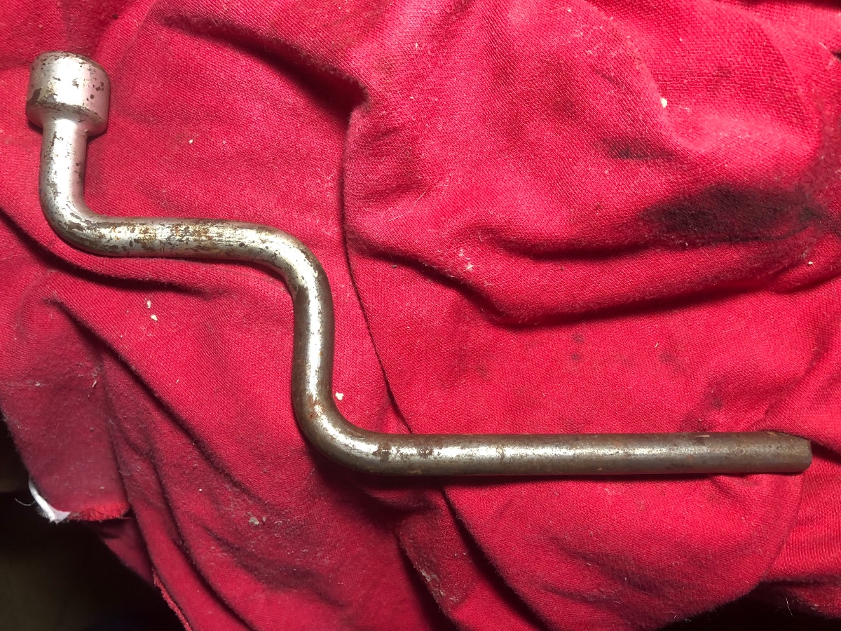

I’ve done it as described above but next time I’m going to try this wrench I found at a swap meet to break the nuts loose. That’s the most difficult (to me) part.

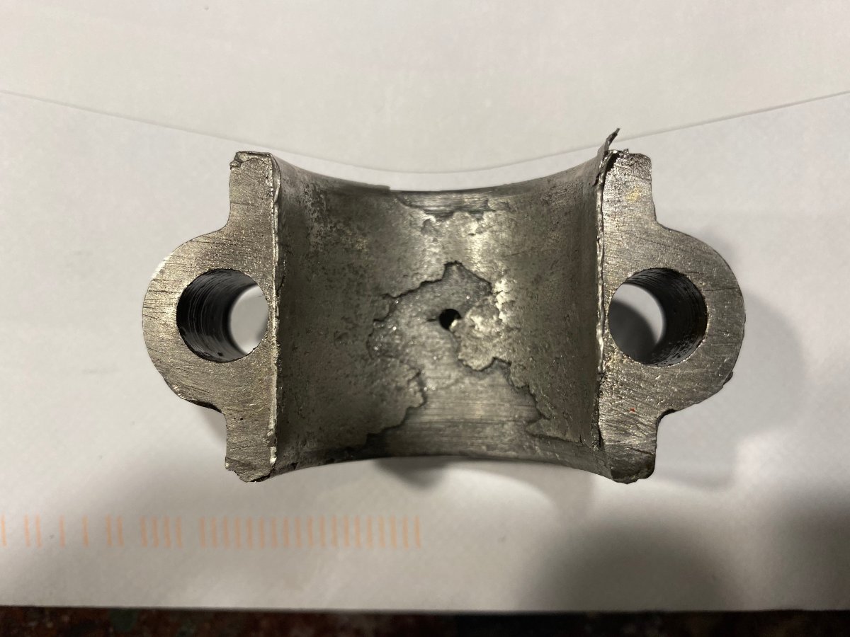

Thanks guys for all the great advice, After much consternation I was finally able to get the cap off. I made a baffle plate as Chad suggested, stuffed rags in the voids and put 2 magnets on the baffle. I was finally able to get the 1st nut loose. I ended up cutting the end off a 9/16 box wrench to that i could put a "cheater" on the end to get enough leverage to loosen the AirCraft nuts. I have a Counter Balanced Crankshaft which doesn't make access any easier.
So, I get the nut loose and with my fingers work it off, and it slips out of my grasp and goes---------?
I haven't found it yet, not on the magnets, in the rags or anyplace else that I can see, I didn't hear dreaded tinkle tinkle of it falling into the sump. I'm just wondering now if it might be stuck to the flywheel magnets ? I'll look in the morning.
Guess I need a new cap! What causes the babbit to disappear like that? Bad pour? This engine was rebuilt less that 3 yrs ago.
If the missing nut can't be found then I guess I'll be pulling the engine.
In fact, I probably need to do that regardless to fit the new rod cap?

You're going to need a new rod (probably 4).
That's some bad looking stuff

Wow. About how many miles on the engine after rebuild ?

I would pull the engine and check out the rest, also good time to clean out the extra stuff floating around.

Oh, nasty!
Do you know where that rod came from? Looks like a bad pour to me. I can't tell from the pictures if the rod wasn't properly tinned? Or bad Babbitt? It could be a loss of oil at some point, but it really doesn't look like it. Regardless, it makes all the bearings suspect.
I always worry about that on my engines. Being forced to do the impossible on a tight budget, I rework old engines. Mix and match rods and blocks and caps. I examine closely for telltale signs, but since I do not know the history of most of those parts, I carefully refit and hope. Usually, my used parts have had enough miles on them that they would have already failed if they had a really bad pour, but one never really knows.
If your rods came from a different source than who may have done the mains? You might consider risking an over the top inspection of all four rods? But the odds are pretty good that you will wind up pulling the engine anyway.
