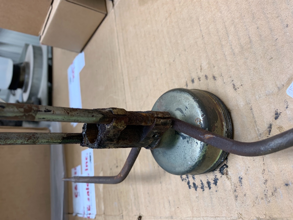

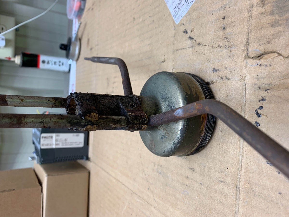

Trying to figure out how to remove the rods. Don’t tell me all I need to do is bend these ears?
Re: Steering column and control rods
If you anneal the ears they will bend easier with less chance of breaking.

The gear box looks like one piece?
So bending them is the way it’s done?
If so,yes I will anneal

Since you have the later single piece gear case, yes, you have to bend the ears (after annealing them so that they don't break).
Folks with the earlier two-piece gear cases could grind off the rivets holding the two parts of the case together and slide the rods out without bending the ears.

anneal, let it cool to room temp, bend a very little bit...repeat a lot of times
multiple annealings followed by thorough cooling during the process is mandatory, in my experience. It takes very little material movement for the metal to become very brittle again.

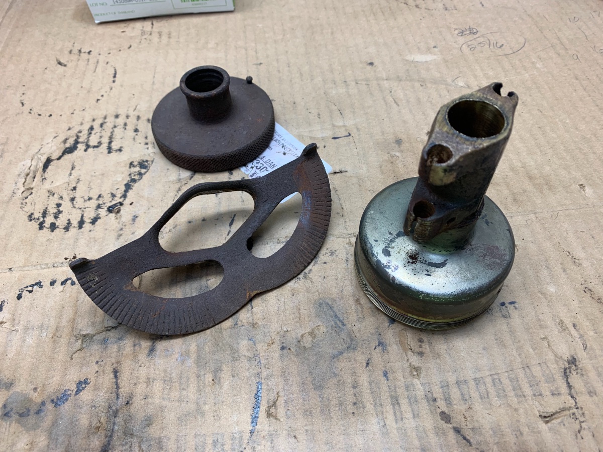

Cut the rods off.  Going to clean this stuff up. Sandblast the rust and then anneal
