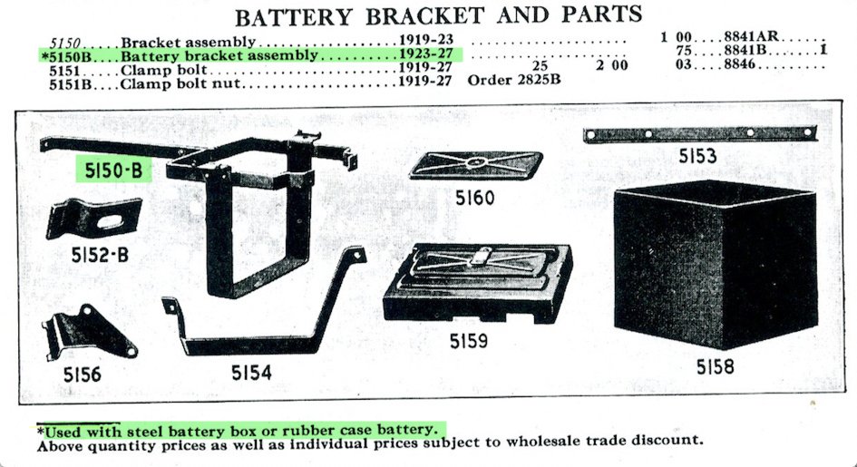

According to the Ford Parts book for the Model T (published in 1928) the 5150-B Battery bracket assembly was to be “Used with steel battery box or rubber case battery”.
This might lead us to believe that the later rubber case batteries available in the 26-27 models, according to the parts list page shown below, did not require a steel battery box or perhaps did not even fit into one.

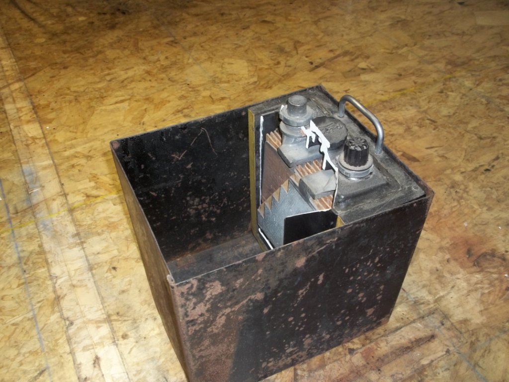

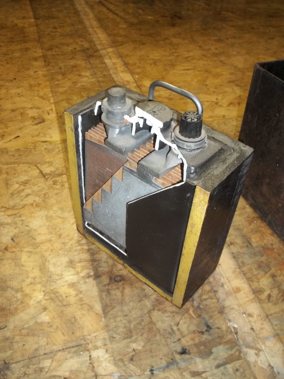

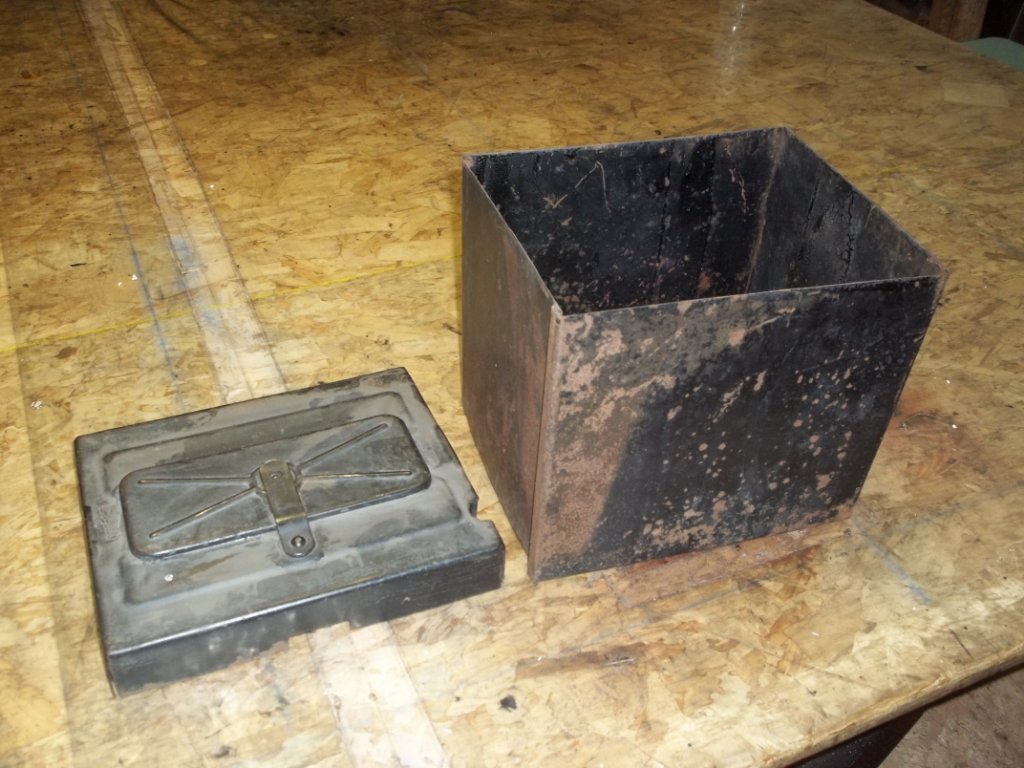

The currently available reproduction battery boxes and lids are designed to hold a modern Group 1 battery with no shimming, they are not made to the original Ford dimensions.
If you want to put a modern Group 1 battery in an OEM Ford metal box, it will easily fit, but will have to be shimmed up and on the sides to fit snugly in the box at the correct height.
OEM Ford Wood battery cases show up on Ebay occasionally, the OEM Ford rubber ones not as much. Unfortunately, a modern Group 1 battery will not fit inside an OEM Ford wood battery case, the inside dimensions of the case are too small.
If you have an original Ford battery case and want to make a metal box with the original Ford dimensions for it, you can make your own box using the dimensions in the thread below, that's what I did. I was lucky enough to be able to get an original lid from Larry Smith

I also bought a reproduction battery top from the old New Castle Battery company and turned my OEM Ford wood battery case into a display battery:

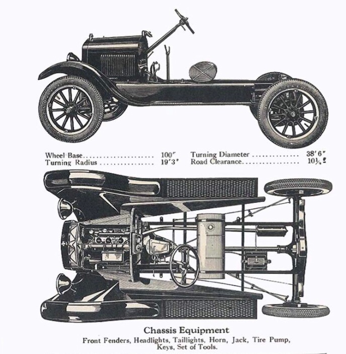

Re: Steel battery boxes – which cars used them?
Factory photo Improved Car chassis.
Clearly shows metal lid and metal battery box in battery hanger.

Thanks Dan. That picture of the improved car chassis certainly does show a steel battery box cover.
I am still perplexed by the statement made in the Parts list for the battery bracket assembly "*Used with steel battery box or rubber case battery".
Could there have been a series of improved cars fitted with the rubber case battery which did not then require a steel battery box?

You could read the parts book as indicating that a rubber case battery will fit in the tin box, just like the wood box battery did. Without a battery kill switch, I would never again run a battery in a tin box with the inspection plate and the lid in place. They severely restrict your ability to access the battery in an emergency.

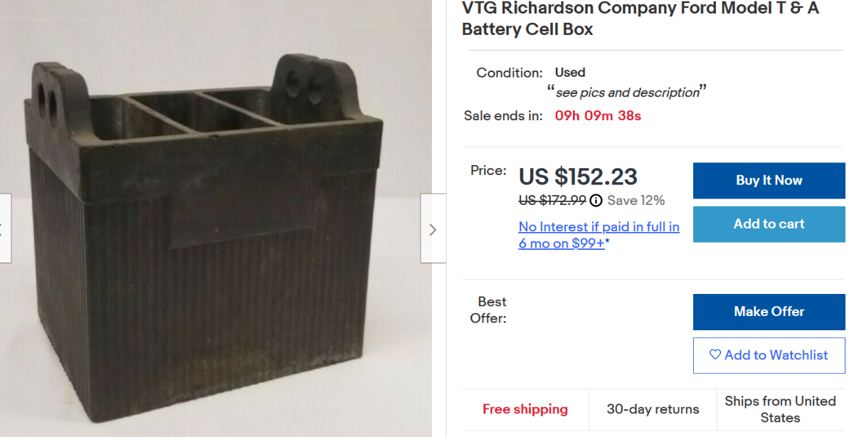

Some info
VTG Richardson Company Ford Model T & A Battery Cell Box Overall measures 9"x9"x7" each cell compartment measures 7"x6"x2 3/8" does show wear for age but in nice overall useable condition
Eric Sole
Topic author - Posts: 139
- Joined: Mon Jan 07, 2019 4:25 pm
- First Name: Eric
- Last Name: Sole
- * REQUIRED* Type and Year of Model Ts owned: 1927 Roadster
- Location: Barcelona, Spain
Thank you Frank for the info on the rubber battery case. The 9 x 7 x 9 measurements provided by the seller on eBay sound like they may be rounded off, but if they are correct then the rubber case would indeed fit inside a steel battery box.
Even though it cost a bit more to produce steel battery boxes for all cars (and trucks), perhaps that was the safest way to guarantee that the top surface of the battery with its connectors and cable clamps would remain relatively clean and mud free.
Nevertheless, I remain perplexed by the statement made in the Parts list for the battery bracket assembly "*Used with steel battery box or rubber case battery".
We'll leave it at that unless someone might vouch that their original 26-27 never had a steel battery box.

Here are a few photos of a NOS, original, 1926-27 battery box and lid. The "cut-away" battery is an original dealer's display with a wood box showing one cell. The dimensions of the steel box are 9" long by 7 1/8" wide by 8" tall. As you can see, the cut-away battery fits perfectly into the steel battery box. It appears the cut-away battery box is made from oak. It is my belief that all Model T's came with a steel battery box from 1919 thru 1927. I hope this helps, Russ Furstnow

The battery box Russ posted is 100% correct, but the lid was actually used in 1925 too. Before that, they had rounded corners. I have no information on when Ford introduced the style we now use, but the earliest ones are different. I've sold probably a dozen exact copies of the original bottom box. If I could get orders for at least a dozen, I would be able to have another run made. What Don mentioned above is correct too.
I went to the Henry Ford Museum recently, and they have an exploded view of a real new 23-25 touring. The battery box for it was not used for some reason, probably because they didn't do the proper research necessary for the project.

Russ's photo shows clearly what the battery box looks like. The seams are on two sides only, and that is what the Snyder and Langs unit lack. Not only that, but a real Ford battery case will not fit, which is typical for some reproductions.
Page 13 in the service book figure 41 and 42 clearly shows the installed unit, and page 29 figure 83. Note the battery case is the wood type, not the later hard rubber type. Also, as with most renderings in the Ford service book, the examples have been touched up, and don't show the seams.
