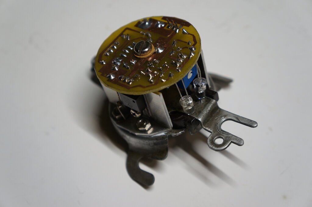

Very interesting. I've been working on something similar, using a programmable unijunction transistor and LED voltage reference. The simplicity and low component count is very attractive, and while it worked well on the bench, in car was a different story. It's easy to get a regulator working on the bench, but the generator has some peculiar characteristics that have been causing no end of trouble with the PWM circuits. The comparator circuit is far less critical because of its very low switching speed.
As it happens, I've only just got the TL494 working without instability in the car today. It needs a bit more work before I go driving with it, and then I'll have another look at the PUT circuit, and investigate your TL431 circuit.

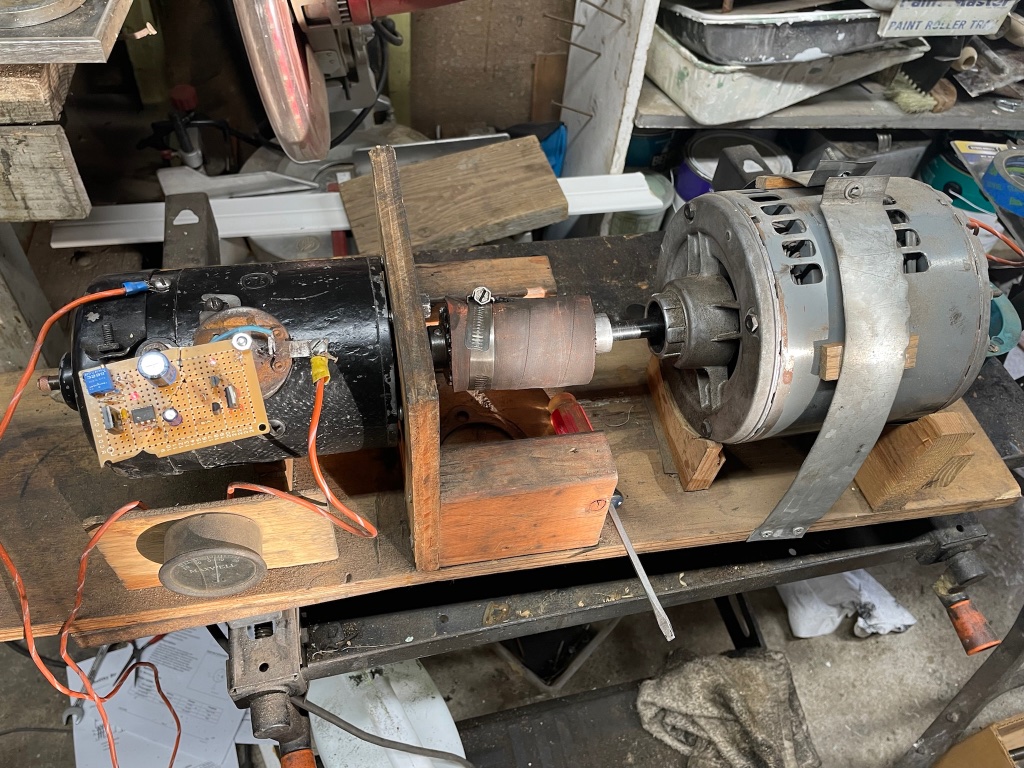

All the components have arrived for the testing of the 393 circuit. Well most as I forgot to order the 15 volt zener.
Below is a photo of the breadboard, I think it will compact down to fit in the Ford cut out housing. The quarter is to give some scale.

We'll be looking forward to hearing the results of your testing. Not sure what your weather is like but I'm sure JohnH will be keen to have someone else trial his comparator design in their car, he's been doing a fair of hard work road+garage testing in sweltering heat...
John's also going to try the (much modified) 494 design in his car tomorrow, so if that's successful we'll have essentially two tested designs to choose from. Once we've some confirmation of operation from others such as yourself it'll be time to think about PCB layout etc.

I connected up the rest on the bench and the device does function with a 180k across the 6.8k to compensate for the lower voltage of my led.
Right now the battery voltage goes from 6.3 to 7 volts. Which seems about correct.
Next is to mount the breadboard on a generator and try it out on my generator test fixture.
I agree that a 2.5 volt reference would be the best solution, my next version will use one. I have dug out an old SPICE circuit simulation program and I will verify if we can eliminate the potentiometer . I suspect with 1% resistors for the positive side of the LM393 and the 1% reference, we will be ok. The cost increase is only a few cents and we will save the cost of the potentiometer. I’ll have to learn how to use SPICE again as it’s been close to twenty years since mine was last used.

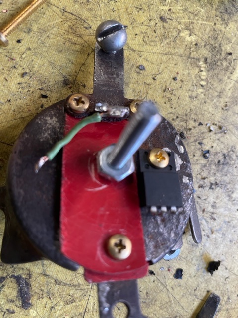

After a few mis-steps the LM393 curcuit is working on a generator.
My first problem was I dropped the breadboard and it cracked across the middle. I fixed that but the 22k resistor on the 393 pin 1 broke. I fixed that. Then the generator in the test fixture died. I’ve not investigated that yet. I found another generator on the bench and the controller works perfectly. I want to run it for a good few minutes checking the temperature of the FET. Also I want to disconnect the 2200uF capacitor to see if it provides any useful function. After that I’ll run the SPICE simulations and determine the values of the resistors on pin 3. My current set up is to turn the charging off at 7 volts and back on at 6.3 volts.
Are these good values to keep a battery fully charged?

Good to see the progress. I'll be interesting to see what temperature your FET & Schottky get to without a heatsink.
The ideal charging voltage will depend upon the battery chemistry. As many Pb batteries today use calcium as a component the requisite voltage for proper charging is a little under 2.67V per cell or 7.4V for a 6V battery.
If it's not a calcium battery you should lower that to around 2.35V/cell or ~7.05V for a 6V battery.

I have continued testing the breadboard and everything appears to be Ok. Initially I ran it for about 20 minutes and then suffered a failure. Two items were found faulty, the insulation on the base of the cutout failed and the soldered lead to the 22k on pin 1 intermittently broke. I think both were caused by the excessive vibration from my test fixture. For the next long term run I moved the board from the generator base and everything worked perfectly for 30 minutes. This included adjusting a load to the battery to increase the frequency of switching to about once per second from the ten per second cycle with no load. The FET only went over ambient by one or two degrees. At a continuous 20 amp load the diode ambient increased by about 7-10 degrees F.
My next move will be a new circular baseboard that will fit in the cutout case. It will delete the 2200uF capacitor, both LEDs, the potentiometer and add the LM385-2.5 voltage reference. I also have to rebuild the cutout base to eliminate the short to ground.
So don’t look for too much for a couple of weeks unless someone is working on a PCB layout

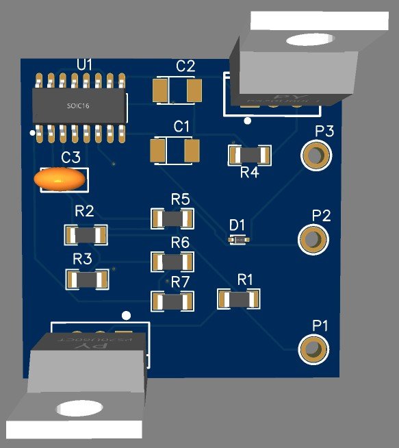

A few posts back you'll have seen the concept PCB I came up with for the 494. I've not done one for the 393, there will be people out there who are far better at that sort of thing than me.
Before considering a PCB design we need to be assured each cct design works well for a number of people. Then things like placement of the high-current components, and whether to use through-hole or SMD for the board components will come into play. Efficiency matters too; although I did a circular PCB I expect it'd result in quite a bit of waste if it were being processed somewhere, and could be difficult to produce at home, so it may well be better to use a square board for the final layout...
For you, as you know, it's a pain having to make a prototype board from ground up, however your experience will give valuable input into confirming the cct design - so thanks for trialling it out and providing feedback.

Initial results are interesting.
I still can't find my oscilloscope, but from what can tell, the circuit does work. Mostly.
Gen was set at charge current of 4.5A @approx 1700 RPM
Brand new 640 CCA 6V battery, resting voltage is 6.45V
In shunting mode (when Q3 is conducting, ie we're not supposed to be charging):
charge current at battery = 1.8A @8.3V
Q3 temp reaches 300++ degrees with a substantial heat sink. It gets VERY hot. D4 gets warm to the touch.
I couldn't get the circuit to shunt completely (unless I biased Q3 manually) so it always charged.
In non-shunting mode ( ie battery is charging)
charge current at battery is ~2.5A @8.9V
adjusting RV1 changes the charge current up and down, as expected.
I did order a few of each component and swapped out Q3 just to see if anything changed, but the 2nd one got really hot as well.
If the rotation speed increased and the gen were to put out 8-10A, I'm not sure Q3 would survive very long.... or it would need a much larger heat sink.
Anyway, these are my initial observations. I'll keep looking for my oscilloscope. I hate to do it, but I might have to buy another one.

Doesn’t sound good and based on my experience with the same circuit, I believe something is wrong.
Once I had found the broken 22k resistor on the lm393 pin 1, mine switched very slowly. The speed with no load on the battery was charging for about a second then off for 7 seconds. As I increased the load on the battery to about 5 amps it was on/off for about one second. Then when I increased the load to 20 amps, the generator was never turned off.
I had checked my setup prior to putting the board on the generator by connecting the circuit to a battery with a bulb as a load. Then I connected a battery charger to the battery terminal. I kept it on until the second led came on and immediately took the charger off. All this while monitoring the battery voltage. In this way I could be assured it was wired and working correctly.
Where I failed was when I cracked the board when connecting the mess to the generator.
I hope this helps.
I hope this helps.

I’ve finished my second prototype
I left the forum a couple of weeks ago to build up a second prototype that I hoped would fit in a Model T Cutout case. After studying the circuit for a while I had some personal technical reasons for not being happy with the npn/pnp driver, so my version is revised with one less transistor and slightly less current draw when the generator is off.
Initially I also deleted the led attached to the output clamp but I subsequently missed it when testing, so I put it back which explains the 2.1 version. I also used a precision voltage reference in place the original second led.
So this is my current schematic. Next was build a second prototype to fit into the existing cutout case. The insulation on my original case failed and shorted out the generator permemently. I purchased some thin insulation and a day later I had a new insulation set. Then I made a round board to fit in the case. And then adjusted the major component to fit around a central mounting and ground screw. A photo of the finished design is below The position of the led is not optimal as it cannot be seen with the cover on!
Of course with the cover on, it looks just like the original. I have not had it on a car but it runs just fine on my test fixture which is a good simulation, indeed the vibration on the fixture is greater than on the car. I have run the generator for about an hour with minimum load on the battery when the led is on most of the time during which time nothing overheated (especially checking Q3). When a large load was applied to the battery (5 amps) the circuit was firmly turned off, again nothing got hot (especially D3). The voltage a which it stops charging is about 7.2v and charging is resumed at 6.3v. These numbers were confirmed by a SPICE simulation which gave theoretical results of 7.19 and 6.19. The theoretical range of adjustment with the 500 ohm potentiometer is about 0.14v though this has not been confirmed on the prototype as yet.
So yet another “393” model works with no apparent glitches.

I installed the regulator on the 24 coupe generator and it works just fine. Initially after startup the ammeter is charging at full rate then after a few minutes the needle swings back and forth and a couple of minutes later it drops to zero. I measured the voltage at the battery and it read 6.37 volts. I turned on the headlights and the generator started up again.
Next I have to puzzle out if I want to put holes in my cutout cover to see the led and adjust the potentiometer.
On the second comparator, it is there and I alway connect the inputs to unused parts just to avoid any unwanted problem such as superiors oscillation. I have puzzled how to use it. My objective to use it was to reduce quiescent current when the ignition was off. I came up with nothing!
Jeff
If you send me your email address I can send a better copy of the schematic and a full parts list.
This goes for anyone else who needs more info

I actually have a FP regulator on my car. I must have secured one of the last of BH's stock. Interestingly, I never thought that regulator worked very well. The first one was completely defective and didn't charge at all, the replacement I have now seems to always charge the battery, so I have it set at at about 5A. All this discussion has me curious now. I think I'll take it off the car and bench test it.

I've responded in group email suggesting that you and Tony might want to try the design at the full output of the generator, as well as at the 5A level. That way the FET will be sinking max current, and the Schottky passing max, so we'll get to know what, if any, heatsinking is required.
I agree the 3524 is a useful looking IC, however I'm still a proponent of the 494 which in practice should provide similarly smooth PWM control and perhaps be more accessible.
Hopefully Tom will also let us know how his 431 design is going. At that point I think we might have enough designs to be going on with, although I guess we could consider a microprocessor design using something like an ATtiny85 or similar. That'd make the voltage settings easy but perhaps make it less attractive to the home builder...
Tony,
I think there's no doubt these are original designs (as much as is possible given we can't stray too far from the chip design parms and typical app notes etc) regardless of where they end up.
Good work with the PCB, it will be interesting to see the result.
AdminJeff
For a long time I have thought that my FP regulator was charging a little on the low side, and this has been verified since all the work on the regulators began. Since I have the battery on a maintainer when I'm not using the car, it's never been a problem. No doubt it's to do with resistor and component tolerances, and would be easy to correct by changing one resistor, but as I'm using the LM393 regulator now it's hardly worth doing.

It is interesting... when in doubt, eBay. I've been eBaying since they first started in 1995. I was at Netscape in those days and a huge supporter. It's quite amazing what I've bought and sold on that platform over the years.
If you think about it, the FP regulator was designed by one guy with no input/field testing by a dozen+ practical Electrical Engineers like all of us. It just sort of hit the market as a finished product and everyone just accepted it. I've heard both good things AND bad about the unit from several different folks who have one. My own initial experience wasn't good, but at the time John stood behind the product and sent me a replacement, which is commendable. Unfortunately, that replacement doesn't seem to be operating as I would expect it should. A regulator should regulate. Mine is always charging. Always. Even when the new battery I just replaced has been on a charger overnight.
Perhaps there is a reason for that. I'll investigate that more fully in the near future. It's also very possible that the wide variance and quality of all the generators out there make his design (and possibly ours) impossible to solve for in the broad sense. The generator sitting in my car today will easily put out 12A both on the car and test bench, but the one currently on my test bench will only put out a max of 7A. I'm also sure there is everything in between and then some currently on the road today. There are a dozen technical reasons why this is the case (armature quality, brush wear, field coil shorts, post connection,rust, etc) but it is a reality. That's a lot to solve for.
What is good is that this entire forum thread is devoted to trying to improve our hobby and taking on this challenge. There will always be those who will always insist that you should just use the stock generator cutout. Just because. But that is ignorance at its finest. If you drive these cars a lot like I do (7,500+ miles a year) and replacing 6v batteries every year because it is being grossly overcharged every time you drive the car and therefore destroyed is your idea of fun, so be it. You can't fix ignorance. You can incrementally improve outdated technology (and without anyone noticing) and save money and increase enjoyment and reliability of the hobby. So that's a solid win in my book.
Nothing can take away the innovation spark from the FP regulator. It was the idea that started all this. The broader audience will now take that effort and vastly improve upon it. Hopefully anyway. Onward and upward as they say...

In all my tests my generator has been set to 10 amp output.
Previous to this work I use a regular diode in place of the mechanical cutout and they never overheated.
My second prototype has run for over an hour with various loads and has not “burned up”.
John has run his model some 300km, which at 30mph, is approximately six hours.

This my second try as the pictures were too large and some how the whole post dissapeared.
My PCB arrived and I populated one for test over the weekend. There was some finger troubles, I must be getting too old for this game. After a couple of challenges it works fine on the bench and on the test fixture. It worked quite well but the switching voltages are a little different from the simulation which is concerning. I then installed in the coupe. Again it functions but just before it reaches fully charge it oscillates s little and once at full charge turns ON and OFF as expected. Testing was cut short as the coupe ran out of gas
The only difference I know of between the test fixture and the coupe is the age of the generator. The one in the coupe is probably 20 years old and the commutator is well worn. The generator in the fixture is essentially new with nice fresh under cut on the commutator which may reduce electrical noise.
Today I refilled the coupe with gas and tried again this time with more success. Overnite I added Jeff’s capacitor across R6 (the feedback resistor) and it quieted down the on/off oscillation and made the voltage setting more or less agree with the simulation.
So we can add mine to the list of working LM383 models that that work well.
I’ve got a couple of tours coming up but I’ll build up another model for the speedster

It's great to see Tony's PCB in action. Not far off being practical for mass production.
And thanks Tom for the details on the TL431 circuit - it's been well thought out.
Having driven with both the TL494 and LM393 regulators, my personal preference is for the LM393. While this may come across as being completely biassed, having designed the LM393 circuit a lot earlier on, it should be pointed out that I actually spent a lot more hours getting the TL494 circuit to work.
The reason is simply that by glancing at the ammeter it's obvious the regulator is working. With the switchmode control from the TL494, I find I have to loook more closely at the ammeter to interpret the reading, and if it's close to zero for a long time, wondering if the charge circuit has failed. With the comparator circuit, the fact that it jumps from zero to full charge current means there's no need to interpret the reading - it's one or the other. The fluctuation of the meter needle is reassuring that it's all working.
Although it's more of academic interest that of practical importance, the TL494 charger does take slightly longer to bring the battery up to full charge, since the charge current tapers off as it does so.
It will be interesting to see what the other opinions are on this, and what the favoured design will be.

I had the PCB fabricated because it was fun. I have little interest in building a hundred or so models but anyone can feel free to have a go. To that end I will clean up the design with any additions the groups wants. I have priced out a round version of my design and the quote was about $387 for 100 boards. The components for the LM393 design is less than $10. So this is well within our initial price range. I sure it would be very little different with either of the other two proposals. I would freely do those PCB designs as well if someone needs it done.
A caution though. These components are quite small and need a small soldering iron and practiced touch, not everyone will have access to suitable tools. So In my opinion it is unrealistic to expect people to populate their own PCB boards. Indeed the shipping for one set of parts exceeds the cost of the parts. So it would be much more reasonable for someone to build up the boards and owners install them in their own cutout housing. Even this may not be universally attractive.
So where do we go now?

I have had success with my bread board 494 version. As I have experience hand soldering SMD parts I thought producing a board sing these components would allows for a smaller board, in this case 35mm X 35mm which fits on the bottom of the original cut out can. D2 and Q1 will fit on reverse side of the board (not as pictured) and folded back under the board and bolted to the bottom of the can. This is my first attempt at designing a board! I am using the free EasyEDA software and struggling a bit. Bit of a way to go with routing but If I have success I will be happy share the gerber files.

John,
Thanks for putting that up and well done with your first attempt, it will be good to hear how you get on with it. Good to see someone trying out the 494 cct as well.
While I like the look of Tony's round board (and the one I did earlier) it has to be acknowledged they're not very efficient in terms of PCB material, your square design is much better in that regard. The SMD will further assist that as you've noted.
Are you going to produce the board yourself, or send the files off and have it done? I guess the smaller board etc will assist costing, although Tony's was hardly expensive. Presumably if one was to have these populated by a board manufacturer SMD would be cheaper than through-hole, have you investigated that at all?
Luke.
Luke.

Hello Luke,
My idea is to get a quantity of boards made by JLCPCB without components these work out at around 3 GBP each, they will also supply the boards with SMD components fitted of course these would be considerably more expensive. Electronics and of course Model T's are hobbies of mine so my personal intention is to produce the board and fit it to cutouts on a no profit basis for those here in the UK and if the board is successful make the greber files available here for other to replicate. I still need to get to grips with the EasyEDA software package to finally produce the board, I'm getting there but a bit of a struggle.
Regards John (UK)
Regards John (UK)

So far, I’ve tested Tonys circuit on 6 different generators now and 3 different batteries. So far so good. I’ve tried charge currents from 5A-10A. My board is on top of a Fun Projects regulator can. The diode and MOSFET are heat sinked to the base of the cutout can. It gets warm but not hot to the touch.
I have yet to drive the car but hopefully I will as it’s supposed to get above freezing here this week.
When I have my ignition on with my distributor, fuel pump and led headlights on, it never stops charging. I expect this as all systems draw about 6 amps. But if I turn off my fuel pump, eventually I get a full charge. I run a Winfield carb and need the fuel pump so this is an outside use case 95% of the time will not be seen.
Jeff
Jeff

Using the original mechanical cut out, with charge current set to 5A, and then the FP regulator, also with the current set to 5A, I noticed no difference in battery life. In both instances, the batteries lasted about eight years before I noticed a drop off in performance, and 10 years before they annoyed me enough to replace them.
So a rough conclusion could be 6kHz ripple in the charge current is no different to pure DC in terms of battery life. I'll find out in another 10 years how the low frequency cycling of the comparator regulator compares...
In any case, low frequency comparator regulators have been used in cars for years - in fact my 1987 'modern' still has an electromechanical voltage regulator.
Some literature has suggested that unfiltered DC which comes from cheap mains powered battery chargers is beneficial for charging, one theory being that it vibrates the sulphate loose from the plates. But, I've had 12V SLA batteries last 20 years being constantly float charged at 13.9V with pure DC.
Battery desulphators were trendy in this part of the world a few years ago, and the local electronic magazine presented them as construction projects. A high voltage pulse was applied to the battery, which supposedly broke through the insulating qualites of the sulphate, to enable to battery to take a charge. One of the designs presents the high voltage pulse (limited to 70v) for 50us out of a 1ms cycle.

My cutout housing version with PCB is now complete. I designed a PCB with DOS Protel on my 386, and used the toner transfer method of applying the board resist. The circuit is exactly the same as my prototype, which has proved itself over the past four months.
https://www.cool386.com/pcb/pcb.html
Because of the unusual construction of my particular (repro) cutout housing, I had to fabricate special brackets to mount the two power semiconductors. This in turn required a board design specific to this unit. However, I'm pleased with how it all turned out.
I decided to retain the Vref LED in view of its advantages, and to make this and the Charged LED visible without drilling into the cover, I simply rely on the LED's shining through the gap above the generator terminal strip. I'm happy with the results. However, it's obvious the mild steel body of the cutout housing is inferior for heatsinking, as compared to the diecast aluminium boxes I've used for the prototypes. The whole heatsinking arrangement I've used would not be suitable for charge currents of more than 5A unless a diode with much lower voltage drop was used. Full details on the design are as before, here https://www.cool386.com/ford_regulator/ ... lator.html
Details of the process are here Because of the unusual construction of my particular (repro) cutout housing, I had to fabricate special brackets to mount the two power semiconductors. This in turn required a board design specific to this unit. However, I'm pleased with how it all turned out.

Fantastic job John documentung the PC board fabrication process, building the pcb version of your design and installation in a cutout housing. Thank you for sharing your knowledge and experience.

Great to see Protel again after all these years, and inspiring to see that basic simple methods still work well for making PCB's.
Well done
Well done
