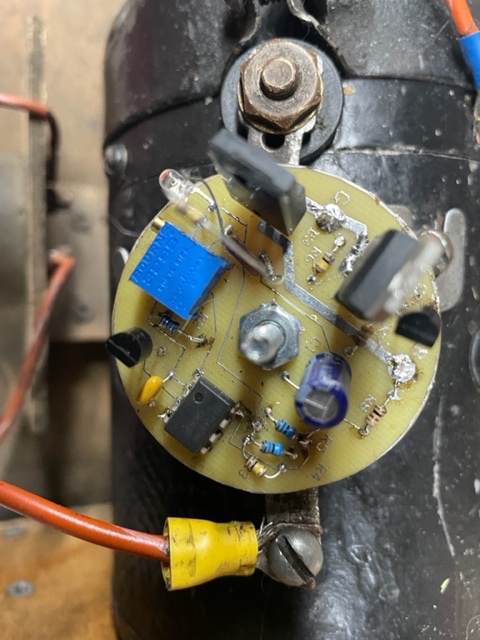

I applied power today and found my led only has 1.68v rather than the 1.9v on the prototype made by JohnH. I had previously been in contact with John who didn’t know the vendor part number for his led as he acquired them a number of years ago and of course they are unmarked.
I can reduce the 6.8k resistor to make it function but I wonder if this is a good idea if we are looking for a reliable and repeatable design.
I rather think I would prefer a cheap reference diode (LM385-1.2) which has know, stable initial and temperature characteristics. The cost is essentially the same as the led.
Any thoughts?

Tony, the LED voltage is not critical in itself. The important thing is that it is constant - which it should be. I found that with each of the LED's I tested, there was only about 6mV variation in forward voltage for the particular LED, over the normal operating range.
As expected, different LED's will have slightly different forward voltages, and for this reason a trimpot must be used to set the voltage.
It is quite in order to alter the 6.8k as you have done, if the LED voltage is such that there's not enough adjustment in the trimpot.
I totally agree, that for a repeatable design, especially if there's any ideas of using precision fixed resistors instead of a trimpot, that a precision voltage reference is preferable. A final version for mass production would undoubtedly be along these lines.
A quick glance at the data inidcates that the LM385 looks ideal for the purpose. Its current drain is in the low microamps which is far less than the TL431, or the existing LED. The choice between the 1.2V and 2.5V version is probably not critical, although I'd probably be inclined to go with 2.5V.

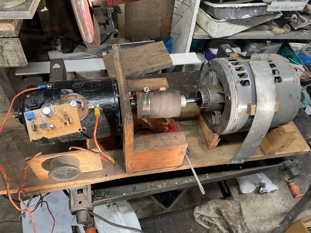

I connected up the rest on the bench and the device does function with a 180k across the 6.8k to compensate for the lower voltage of my led. 😊.
Right now the battery voltage goes from 6.3 to 7 volts. Which seems about correct.
Next is to mount the breadboard on a generator and try it out on my generator test fixture.
I agree that a 2.5 volt reference would be the best solution, my next version will use one. I have dug out an old SPICE circuit simulation program and I will verify if we can eliminate the potentiometer . I suspect with 1% resistors for the positive side of the LM393 and the 1% reference, we will be ok. The cost increase is only a few cents and we will save the cost of the potentiometer. I’ll have to learn how to use SPICE again as it’s been close to twenty years since mine was last used.

After a few mis-steps the LM393 curcuit is working on a generator.
My first problem was I dropped the breadboard and it cracked across the middle. I fixed that but the 22k resistor on the 393 pin 1 broke. I fixed that. Then the generator in the test fixture died. I’ve not investigated that yet. I found another generator on the bench and the controller works perfectly.
Generator test fixture
I want to run it for a good few minutes checking the temperature of the FET. Also I want to disconnect the 2200uF capacitor to see if it provides any useful function.
Smart cutout
Smart cutout
After that I’ll run the SPICE simulations and determine the values of the resistors on pin 3. My current set up is to turn the charging off at 7 volts and back on at 6.3 volts.
Are these good values to keep a battery fully charged?

Good to see the progress. I'll be interesting to see what temperature your FET & Schottky get to without a heatsink.
The ideal charging voltage will depend upon the battery chemistry. As many Pb batteries today use calcium as a component the requisite voltage for proper charging is a little under 2.67V per cell or 7.4V for a 6V battery.
If it's not a calcium battery you should lower that to around 2.35V/cell or ~7.05V for a 6V battery.

Great work Tony, glad to see it's working. You can increase the 180k resistor if you want the switch on and switch off voltages closer together. If taken too far however, the circuit becomes unstable. Also, some adjustment of this resistor might be required if different values of resistor have been used for the trimpot, and the two resistors either side of it. Of course, once it's on the car and the wiring resistance to the battery becomes part of the circuit, it will probably be necessary to readjust the trimpot anyway, which will bring up the switch on voltage slightly.

I have continued testing the breadboard and everything appears to be Ok. Initially I ran it for about 20 minutes and then suffered a failure. Two items were found faulty, the insulation on the base of the cutout failed and the soldered lead to the 22k on pin 1 intermittently broke. I think both were caused by the excessive vibration from my test fixture. For the next long term run I moved the board from the generator base and everything worked perfectly for 30 minutes. This included adjusting a load to the battery to increase the frequency of switching to about once per second from the ten per second cycle with no load. The FET only went over ambient by one or two degrees. At a continuous 20 amp load the diode ambient increased by about 7-10 degrees F.
My next move will be a new circular baseboard that will fit in the cutout case. It will delete the 2200uF capacitor, both LEDs, the potentiometer and add the LM385-2.5 voltage reference. I also have to rebuild the cutout base to eliminate the short to ground.
So don’t look for too much for a couple of weeks unless someone is working on a PCB layout

Post by TonyB » Fri Feb 04, 2022 8:33 pm
I’ve finished my second prototype 😊
I left the forum a couple of weeks ago to build up a second prototype that I hoped would fit in a Model T Cutout case. After studying the circuit for a while I had some personal technical reasons for not being happy with the npn/pnp driver, so my version is revised with one less transistor and slightly less current draw when the generator is off.
Initially I also deleted the led attached to the output clamp but I subsequently missed it when testing, so I put it back which explains the 2.1 version. I also used a precision voltage reference in place the original second led.
So this is my current schematic.
Regulator schematic
Regulator schematic
Next was build a second prototype to fit into the existing cutout case. The insulation on my original case failed and shorted out the generator permemently. I purchased some thin insulation and a day later I had a new insulation set. Then I made a round board to fit in the case. And then adjusted the major component to fit around a central mounting and ground screw. A photo of the finished design is below
Regulator on generator
The position of the led is not optimal as it cannot be seen with the cover on!
Of course with the cover on, it looks just like the original.
Regulator with the cover on
I have not had it on a car but it runs just fine on my test fixture which is a good simulation, indeed the vibration on the fixture is greater than on the car.
I have run the generator for about an hour with minimum load on the battery when the led is on most of the time during which time nothing overheated (especially checking Q3). When a large load was applied to the battery (5 amps) the circuit was firmly turned off, again nothing got hot (especially D3). The voltage a which it stops charging is about 7.2v and charging is resumed at 6.3v. These numbers were confirmed by a SPICE simulation which gave theoretical results of 7.19 and 6.19. The theoretical range of adjustment with the 500 ohm potentiometer is about 0.14v though this has not been confirmed on the prototype as yet.
So yet another “393” model works with no apparent glitches.

I installed the regulator on the 24 coupe generator and it works just fine. Initially after startup the ammeter is charging at full rate then after a few minutes the needle swings back and forth and a couple of minutes later it drops to zero. I measured the voltage at the battery and it read 6.37 volts. I turned on the headlights and the generator started up again.
Next I have to puzzle out if I want to put holes in my cutout cover to see the led and adjust the potentiometer.
On the second comparator, it is there and I alway connect the inputs to unused parts just to avoid any unwanted problem such as superiors oscillation. I have puzzled how to use it. My objective to use it was to reduce quiescent current when the ignition was off. I came up with nothing!
Jeff
If you send me your email address I can send a better copy of the schematic and a full parts list.
This goes for anyone else who needs more info
PC board
I am going to attempt to design a PCB. It will be based on my second prototype wired board.
Wish me luck.

In all my tests my generator has been set to 10 amp output.
Previous to this work I use a regular diode in place of the mechanical cutout and they never overheated.
My second prototype has run for over an hour with various loads and has not “burned up”.
John has run his model some 300km, which at 30mph, is approximately six hours.

This my second try as the pictures were too large and some how the whole post dissapeared. ☹️
My PCB arrived and I populated one for test over the weekend. There was some finger troubles, I must be getting too old for this game. After a couple of challenges it works fine on the bench and on the test fixture. It worked quite well but the switching voltages are a little different from the simulation which is concerning.
PCB of the regulator
I then installed in the coupe. Again it functions but just before it reaches fully charge it oscillates s little and once at full charge turns ON and OFF as expected.
Testing was cut short as the coupe ran out of gas☹️
The only difference I know of between the test fixture and the coupe is the age of the generator. The one in the coupe is probably 20 years old and the commutator is well worn. The generator in the fixture is essentially new with nice fresh under cut on the commutator which may reduce electrical noise.
Today I refilled the coupe with gas and tried again this time with more success. Overnite I added Jeff’s capacitor across R6 (the feedback resistor) and it quieted down the on/off oscillation and made the voltage setting more or less agree with the simulation.
So we can add mine to the list of working LM383 models that that work well.
I’ve got a couple of tours coming up but I’ll build up another model for the speedster😊
PCB in the coupe
PCB in the coupe

Good to see the results of your board work - well done. It will be good to hear how it continues when you get more fuel for the test bed :-)

It's great to see Tony's PCB in action. Not far off being practical for mass production.

So far, I’ve tested Tonys circuit on 6 different generators now and 3 different batteries. So far so good. I’ve tried charge currents from 5A-10A. My board is on top of a Fun Projects regulator can. The diode and MOSFET are heat sinked to the base of the cutout can. It gets warm but not hot to the touch.
I have yet to drive the car but hopefully I will as it’s supposed to get above freezing here this week.
When I have my ignition on with my distributor, fuel pump and led headlights on, it never stops charging. I expect this as all systems draw about 6 amps. But if I turn off my fuel pump, eventually I get a full charge. I run a Winfield carb and need the fuel pump so this is an outside use case 95% of the time will not be seen.

Back on March 1 I mentioned that my tests with a flat battery had shown that I needed a heat sink on the diode. The simplest method was to bolt the diode to the base of the cutout and then solder the diode leads to the PCB. It’s a bit messy but after drilling a very carefully placed hole and cutting away some of the new insulation it seems to work quite well.
Diode on the cutout base.
Regulator with diode on base but no cover
As you can see by the led being lit, the device still works as before.
I probably have enough parts to build three more regulators, I need one for the speedster, would anyone else like to try one as part of the ongoing tests. If so, let me know by email and I’ll see what I can do.
Tony Bowker

My cutout housing version with PCB is now complete. I designed a PCB with DOS Protel on my 386, and used the toner transfer method of applying the board resist. The circuit is exactly the same as my prototype, which has proved itself over the past four months.
Details of the process are here https://www.cool386.com/pcb/pcb.html
Because of the unusual construction of my particular (repro) cutout housing, I had to fabricate special brackets to mount the two power semiconductors. This in turn required a board design specific to this unit. However, I'm pleased with how it all turned out.
I decided to retain the Vref LED in view of its advantages, and to make this and the Charged LED visible without drilling into the cover, I simply rely on the LED's shining through the gap above the generator terminal strip.
I'm happy with the results. However, it's obvious the mild steel body of the cutout housing is inferior for heatsinking, as compared to the diecast aluminium boxes I've used for the prototypes. The whole heatsinking arrangement I've used would not be suitable for charge currents of more than 5A unless a diode with much lower voltage drop was used. Full details on the design are as before, here https://www.cool386.com/ford_regulator/ ... lator.html

Fantastic job John documentung the PC board fabrication process, building the pcb version of your design and installation in a cutout housing. Thank you for sharing your knowledge and experience.

Great to see Protel again after all these years, and inspiring to see that basic simple methods still work well for making PCB's.
Well done 👏 👍
