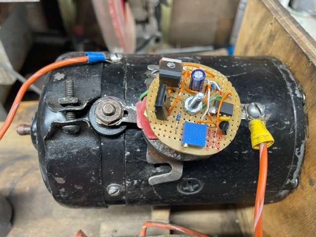

All the components have arrived for the testing of the 393 circuit. Well most as I forgot to order the 15 volt zener.
Below is a photo of the breadboard, I think it will compact down to fit in the Ford cut out housing.
Prototype 6 volt regulator
The quarter is to give some scale.

We'll be looking forward to hearing the results of your testing. Not sure what your weather is like but I'm sure JohnH will be keen to have someone else trial his comparator design in their car, he's been doing a fair of hard work road+garage testing in sweltering heat...
John's also going to try the (much modified) 494 design in his car tomorrow, so if that's successful we'll have essentially two tested designs to choose from. Once we've some confirmation of operation from others such as yourself it'll be time to think about PCB layout etc.
Luke.

I applied power today and found my led only has 1.68v rather than the 1.9v on the prototype made by JohnH. I had previously been in contact with John who didn’t know the vendor part number for his led as he acquired them a number of years ago and of course they are unmarked.
I can reduce the 6.8k resistor to make it function but I wonder if this is a good idea if we are looking for a reliable and repeatable design.
I rather think I would prefer a cheap reference diode (LM385-1.2) which has know, stable initial and temperature characteristics. The cost is essentially the same as the led.
Any thoughts?

Tony, the LED voltage is not critical in itself. The important thing is that it is constant - which it should be. I found that with each of the LED's I tested, there was only about 6mV variation in forward voltage for the particular LED, over the normal operating range.
As expected, different LED's will have slightly different forward voltages, and for this reason a trimpot must be used to set the voltage.
It is quite in order to alter the 6.8k as you have done, if the LED voltage is such that there's not enough adjustment in the trimpot.
I totally agree, that for a repeatable design, especially if there's any ideas of using precision fixed resistors instead of a trimpot, that a precision voltage reference is preferable. A final version for mass production would undoubtedly be along these lines.
A quick glance at the data inidcates that the LM385 looks ideal for the purpose. Its current drain is in the low microamps which is far less than the TL431, or the existing LED. The choice between the 1.2V and 2.5V version is probably not critical, although I'd probably be inclined to go with 2.5V.

I connected up the rest on the bench and the device does function with a 180k across the 6.8k to compensate for the lower voltage of my led. 😊.
Right now the battery voltage goes from 6.3 to 7 volts. Which seems about correct.
Next is to mount the breadboard on a generator and try it out on my generator test fixture.
I agree that a 2.5 volt reference would be the best solution, my next version will use one. I have dug out an old SPICE circuit simulation program and I will verify if we can eliminate the potentiometer . I suspect with 1% resistors for the positive side of the LM393 and the 1% reference, we will be ok. The cost increase is only a few cents and we will save the cost of the potentiometer. I’ll have to learn how to use SPICE again as it’s been close to twenty years since mine was last used.

Next was build a second prototype to fit into the existing cutout case. The insulation on my original case failed and shorted out the generator permemently. I purchased some thin insulation and a day later I had a new insulation set. Then I made a round board to fit in the case. And then adjusted the major component to fit around a central mounting and ground screw. A photo of the finished design is below
Regulator on generator
The position of the led is not optimal as it cannot be seen with the cover on!
Of course with the cover on, it looks just like the original.
Regulator with the cover on
I have not had it on a car but it runs just fine on my test fixture which is a good simulation, indeed the vibration on the fixture is greater than on the car.
Generator test fixture
I have run the generator for about an hour with minimum load on the battery when the led is on most of the time during which time nothing overheated (especially checking Q3). When a large load was applied to the battery (5 amps) the circuit was firmly turned off, again nothing got hot (especially D3). The voltage a which it stops charging is about 7.2v and charging is resumed at 6.3v. These numbers were confirmed by a SPICE simulation which gave theoretical results of 7.19 and 6.19. The theoretical range of adjustment with the 500 ohm potentiometer is about 0.14v though this has not been confirmed on the prototype as yet.
So yet another “393” model works with no apparent glitches.

AdminJeff
Re: A $20 (or less!) DIY regulator, and other issues
Post by AdminJeff » Sun Feb 06, 2022 3:22 am
Tony,
I like the simplified design. I assume that you left the unused 1/2 of the op amp there "just because"? It serves no purpose that I can see... I finally spent some time with the original circuit today trying to figure out why it generates so much heat, and found that in fully charged mode, the gate voltage at the MOSFET isn't sufficient to turn it on completely, thus operating outside of full conduction and therefore generating excess heat. That puts the issue squarely in the emitter follower circuit. Either I have a leaking NPN transistor or something else is going on. I ran out of steam today, but I'll try your new mods tomorrow.
Do you have a larger version of the schematic? It's hard to make out the values of you resistors.

Next I have to puzzle out if I want to put holes in my cutout cover to see the led and adjust the potentiometer.
On the second comparator, it is there and I alway connect the inputs to unused parts just to avoid any unwanted problem such as superiors oscillation. I have puzzled how to use it. My objective to use it was to reduce quiescent current when the ignition was off. I came up with nothing!
Jeff
If you send me your email address I can send a better copy of the schematic and a full parts list.

I am going to attempt to design a PCB. It will be based on my second prototype wired board.
Wish me luck.

Tony,
I'm on your updated design with the single transistor switch.
After I figured out and corrected the wiring on R6 to U1, pin 2, I saw the exact same thing... not very elegant. It would be better if we could achieve both hard ON when battery is fully charged and hard OFF when charging or large current draws. During the swings, the comparator is in that dreaded middle ground, ie not enough hysteresis. This is when I saw the MOSFET heat up substantially. In that state the MOSFET is sinking a few Amps because the gate is not fully triggered. When fully triggered it exhibits a very low current draw.
I know I've seen op amp comparator circuits that can better account for this effect, especially with noisy signals (which we have here in spades), but it does add to the complexity. I'll have a look around and see what I can find. A really good discussion of this effect is here
https://www.analog.com/en/analog-dialog ... resis.html

The NASCAR race from LA was boring and I thought I would give an old simple PCB layout program as try. It seems to work, well at least I have a picture of what a layout could look like.
This is the layout.
PCB layout for the Regulator
The red lines are the copper on the component side. Most lines are 0.01” except for the high current line around the diode and clamping FET.
The green lines are the copper on the “solder” side, that is the opposite side to the components.
The yellow lines are the silk screen lines. This being a low cost prototype, they may be deleted on the first run of boards. For that reason I added the various component designation in copper on the component side.
The board is round, well actually it’s a series of straight lines but it’s close enough. It’s about 1.90” in diameter with a mounting and signal ground hole in the center. Actually the center is 0.012” off center as I built it on a 0.025” grid.
The schematic is on my previous thread, originally it had a small error which is now corrected.
Next see if I get a few PCB fabricated.

Tony,
Ok I’ve verified your new circuit. I had better luck with a 75k resistor for R6. I also put a 0.0068uf cap across that resistor and it seemed to help dampen the on/off oscillation. After researching hysteresis on several sites, a couple recommended this approach when in noisy environments. As best I can see, there is severe noise spikes at about 38khz. I didn't do the math on the cap value but something small like I used is helpful in dampening that spike. I’m sure others with a better scope can get closer to the noise spike frequency and a filter calc might get the cap value closer.
My ON voltage was 6.4v and my OFF voltage was 7.4v. Very close to yours. I’m not sure we should get rid of the trim pot as resistor tolerances of +/- 5-10% will necessitate fine tuning the trip points.
Anyway I ran the test setup for a couple of hours using a 4ohm 50 watt resistor and a light bulb on the battery as a load so that it drained the battery slowly. My on/off cycles were about 4-5 minutes and there was no oscillation after changing R6 to 75k and adding the cap in parallel.
I also varied the charge rate on the gen and settled on 5A.
There is obviously a constructional fault if your MOSFET is not being driven to saturation. The comparator output is either on or off - it is not a linear device. After many hours on the bench never once did I see the comparator output midway between on and off. It changes state within microseconds.
After driving it with now for something like 300km I'm very satisfied with the performance.

I ordered my PCB this afternoon.
Took quite a bit of effort as my version of the program was 7.0 dated 2009 and now they are on 7.9….. I had to confirm my old laptop would install the new version, then delete the old version and install the new. It all takes time.
I checked my design a couple more times and to my horror that big circle in the middle was not a hole. The latest version lets you look at all the holes. It was just a circle of copper so that was one revision. The second was larger pads for the battery (B) and generator (G) connections. Eagle eyed readers would have also seen that the green trace between the bottom of D1 and R5 didn’t quite touch.
I fixed all I could see and sent it off with money and expect boards in about a week.

Yup. Tony's original "new" design had the feedback resistor on the wrong input of the comparator. I figured that out and replicated his results above with a small mod.

My PCB arrived and I populated one for test over the weekend. There was some finger troubles, I must be getting too old for this game. After a couple of challenges it works fine on the bench and on the test fixture. It worked quite well but the switching voltages are a little different from the simulation which is concerning.
PCB of the regulator
I then installed in the coupe. Again it functions but just before it reaches fully charge it oscillates s little and once at full charge turns ON and OFF as expected.
Testing was cut short as the coupe ran out of gas☹️
The only difference I know of between the test fixture and the coupe is the age of the generator. The one in the coupe is probably 20 years old and the commutator is well worn. The generator in the fixture is essentially new with nice fresh under cut on the commutator which may reduce electrical noise.
Today I refilled the coupe with gas and tried again this time with more success. Overnite I added Jeff’s capacitor across R6 (the feedback resistor) and it quieted down the on/off oscillation and made the voltage setting more or less agree with the simulation.
So we can add mine to the list of working LM383 models that that work well.
I’ve got a couple of tours coming up but I’ll build up another model for the speedster😊
PCB in the coupe
PCB in the coupe

Good to see the results of your board work - well done. It will be good to hear how it continues when you get more fuel for the test bed :-)

It's great to see Tony's PCB in action. Not far off being practical for mass production.

Post by TonyB » Mon Mar 14, 2022 8:43 pm
Back on March 1 I mentioned that my tests with a flat battery had shown that I needed a heat sink on the diode. The simplest method was to bolt the diode to the base of the cutout and then solder the diode leads to the PCB. It’s a bit messy but after drilling a very carefully placed hole and cutting away some of the new insulation it seems to work quite well.
Diode on the cutout base.
Regulator with diode on base but no cover
As you can see by the led being lit, the device still works as before.
I probably have enough parts to build three more regulators, I need one for the speedster, would anyone else like to try one as part of the ongoing tests. If so, let me know by email and I’ll see what I can do.
Tony Bowker
