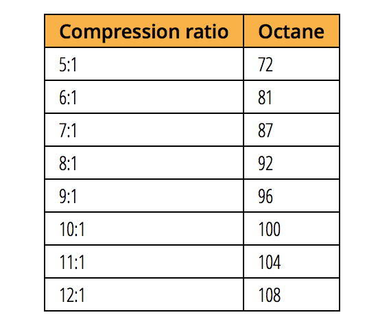

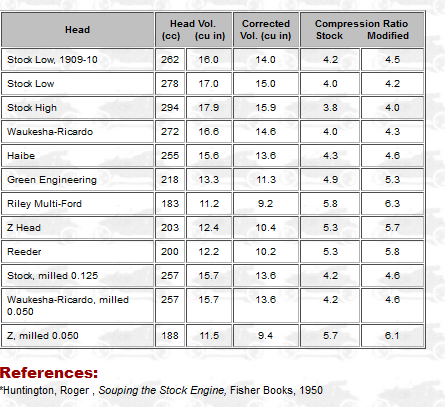

An octane rating, or octane number, is a standard measure of a fuel's ability to withstand compression in an internal combustion engine without detonating. The higher the octane number, the more compression the fuel can withstand before detonating. Octane rating does not relate directly to the power output but simply indicates gasoline's capability against compression.
The advantage in using Ethanol gas (87-88) over Ethanol Free Gas (averages about 90 Octane) is the price.
Leaded Gasoline should never be used in a vehicle with a catalytic converter as it will destroy its effectiveness to reduce emissions. If you live in a State that does emissions testing - it will be noticed.
Ethanol Free gas should be used in older lawn and garden engines and some automobiles built prior to 1975. The reason for this is that these engines contained parts that react with ethanol.
Here are two charts use your head to decide your gas. --
There are also different methods of measuring an Octane rating - in t he US the RM/2 method is used but in other countries it may be RON or MON. While the numbers are in the same range the values are different for the grade gas https://en.wikipedia.org/wiki/Octane_rating

Been trying to understand the Leaded Gas Pro position with respect to Model Ts. The Con position is well documented.
https://en.wikipedia.org/wiki/Gasoline
1903 to 1914
Early fuels were termed "straight-run" gasolines and were byproducts from the distillation of a single crude oil to produce kerosene, which was the principal product sought for burning in kerosene lamps. Gasoline production would not surpass kerosene production until 1916. The earliest straight-run gasolines were the result of distilling eastern crude oils and there was no mixing of distillates from different crudes. The composition of these early fuels was unknown and the quality varied greatly as crude oils from different oil fields emerged in different mixtures of hydrocarbons in different ratios. The engine effects produced by abnormal combustion (engine knocking and pre-ignition) due to inferior fuels had not yet been identified, and as a result, there was no rating of gasoline in terms of its resistance to abnormal combustion. The general specification by which early gasolines were measured was that of specific gravity via the Baumé scale and later the volatility (tendency to vaporize) specified in terms of boiling points, which became the primary focuses for gasoline producers. These early eastern crude oil gasolines had relatively high Baumé test results (65 to 80 degrees Baumé) and were called Pennsylvania "High-Test" or simply "High-Test" gasolines. These would often be used in aircraft engines.
By 1910, increased automobile production and the resultant increase in gasoline consumption produced a greater demand for gasoline and the growing electrification of lighting produced a drop in kerosene demand, creating a supply problem. It appeared that the burgeoning oil industry would be trapped into over-producing kerosene and under-producing gasoline since simple distillation could not alter the ratio of the two products from any given crude. The solution appeared in 1911 when the development of the Burton process allowed thermal cracking of crude oils, which increased the percent yield of gasoline from the heavier hydrocarbons. This was combined with the expansion of foreign markets for the export of surplus kerosene which domestic markets no longer needed. These new thermally "cracked" gasolines were believed to have no harmful effects and would be added to straight-run gasolines. There also was the practice of mixing heavy and light distillates to achieve the desired Baumé reading and collectively these were called "blended" gasolines.
.... As late as June 1917, Standard Oil (the largest refiner of crude oil in the United States at the time) stated that the most important property of a gasoline was its volatility. It is estimated that the rating equivalent of these straight-run gasolines varied from 40 to 60 octane and that the "High-Test", sometimes referred to as "fighting grade", probably averaged 50 to 65 octane.
World War I
... When the U.S. entered the war in April 1917, the U.S. became the principal supplier of aviation gasoline to the Allies and a decrease in engine performance was noted. Soon it was realized that motor vehicle fuels were unsatisfactory for aviation, and after the loss of several combat aircraft, attention turned to the quality of the gasolines being used. Later flight tests conducted in 1937 showed that an octane reduction of 13 points (from 100 down to 87 octane) decreased engine performance by 20 percent and increased take-off distance by 45 percent. If abnormal combustion were to occur, the engine could lose enough power to make getting airborne impossible and a take-off roll became a threat to the pilot and aircraft.
U.S., 1918–1929
Engine designers knew that, according to the Otto cycle, power and efficiency increased with compression ratio, but experience with early gasolines during World War I showed that higher compression ratios increased the risk of abnormal combustion, producing lower power, lower efficiency, hot-running engines, and potentially severe engine damage. To compensate for these poor fuels, early engines used low compression ratios, which required relatively large, heavy engines with limited power and efficiency. ......
Between 1917 and 1919, the amount of thermally cracked gasoline utilized almost doubled. Also, the use of natural gasoline increased greatly. During this period, many U.S. states established specifications for motor gasoline but none of these agreed and they were unsatisfactory from one standpoint or another. Larger oil refiners began to specify unsaturatedmaterial percentage (thermally cracked products caused gumming in both use and storage while unsaturated hydrocarbons are more reactive and tend to combine with impurities leading to gumming). In 1922, the U.S. government published the first specifications for aviation gasolines (two grades were designated as "Fighting" and "Domestic" and were governed by boiling points, color, sulfur content, and a gum formation test) along with one "Motor" grade for automobiles. The gum test essentially eliminated thermally cracked gasoline from aviation usage and thus aviation gasolines reverted to fractionating straight-run naphthas or blending straight-run and highly treated thermally cracked naphthas. This situation persisted until 1929.
The automobile industry reacted to the increase in thermally cracked gasoline with alarm. Thermal cracking produced large amounts of both mono- and diolefins (unsaturated hydrocarbons), which increased the risk of gumming. Also, the volatility was decreasing to the point that fuel did not vaporize and was sticking to spark plugs and fouling them, creating hard starting and rough running in winter and sticking to cylinder walls, bypassing the pistons and rings, and going into the crankcase oil.[39] One journal stated, "on a multi-cylinder engine in a high-priced car we are diluting the oil in the crankcase as much as 40 percent in a 200-mile [320 km] run, as the analysis of the oil in the oil-pan shows"
Recap: Low grade gasoline promoted the development of engines with low compression ratios Thermal Cracked gas caused visible deposits in the oil pan, fouled plugs etc
Leaded gasoline controversy, 1924–1925
With the increased use of thermally cracked gasolines came an increased concern regarding its effects on abnormal combustion, and this led to research for antiknock additives. In the late 1910s, researchers such as A.H. Gibson, Harry Ricardo, Thomas Midgley Jr., and Thomas Boyd began to investigate abnormal combustion. Beginning in 1916, Charles F. Kettering of General Motors began investigating additives based on two paths, the "high percentage" solution (where large quantities of ethanol were added) and the "low percentage" solution (where only 0.53–1.1 grams per liter (0.071–0.147 oz/U.S. gal) were needed). The "low percentage" solution ultimately led to the discovery of tetraethyllead (TEL) in December 1921, a product of the research of Midgley and Boyd and the defining component of leaded gasoline. This innovation started a cycle of improvements in fuel efficiency that coincided with the large-scale development of oil refining to provide more products in the boiling range of gasoline. Ethanol could not be patented but TEL could, so Kettering secured a patent for TEL and began promoting it instead of other options.
The dangers of compounds containing lead were well-established by then and Kettering was directly warned by Robert Wilson of MIT, Reid Hunt of Harvard, Yandell Henderson of Yale, and Erik Krause of the University of Potsdam in Germany about its use. Krause had worked on tetraethyllead for many years and called it "a creeping and malicious poison" that had killed a member of his dissertation committee. On 27 October 1924, newspaper articles around the nation told of the workers at the Standard Oil refinery near Elizabeth, New Jersey who were producing TEL and were suffering from lead poisoning. By 30 October, the death toll had reached five.[43] In November, the New Jersey Labor Commission closed the Bayway refinery and a grand jury investigation was started which had resulted in no charges by February 1925. Leaded gasoline sales were banned in New York City, Philadelphia, and New Jersey. General Motors, DuPont, and Standard Oil, who were partners in Ethyl Corporation, the company created to produce TEL, began to argue that there were no alternatives to leaded gasoline that would maintain fuel efficiency and still prevent engine knocking. After several industry-funded flawed studies reported that TEL-treated gasoline was not a public health issue, the controversy subsided.
Recap: Both Ethanol and TEL were known as antiknock additives. The higher ratio of Ethanol to gas initially led to TEL and failed studies on its effect to a persons health led to its choice.
The Model T engine at this point was developed as a low compression engine running on, at best, a 60 octane rating. The need to prevent knocking with a higher grade octane rating should be satisfied with any of Today's gasoline octanes
Lead Gas (lead substitutes) affect on valve seats
https://blog.amsoil.com/what-is-a-lead- ... -need-one/
Lead also emerged as an effective way to protect against valve-seat recession, which can occur under high-rpm, high-heat, high-load conditions. This was observed by lead deposits under the valves
As the intensely hot exhaust valve hammers against the valve seat thousands of times per minute, the two components can momentarily fuse together in a process called “microwelding.”
Once the valve opens, the microweld tears apart. Multiply this by thousands of times and the valve seat deteriorates until the valve no longer seats properly. This leads to compression and power loss, in addition to catastrophic failure if the valve breaks off.
Recap: The Model T is not a high-rpm engine. It can be under high-load. The reference to "high-heat" needs to be qualified with a value range. Model T engines normally run at the same temperature range as Today's engines.
Conclusion:
There is no point in using Leaded Fuel because of its higher octane rating in a Model T (or any engine) with a compression ratio 7:1 or below.
Using Leaded Fuel or additives to an engine with hardened valve seats is also questionable as being necessary. However, for engines with unhardened valve seats that have never been replaced - then it would make sense to use it or an additive that is documented to protect unhardened valve seats. there are many advertised with somewhat ambiguous claims.
Aircraft fuels are for aircraft engines not low compression engines

The development and use of leaded fuel permitted raising HP output in low priced automobiles from around 1/10 HP per cubic inch in 1920 to around 2/10 HP per cubic inch by 1930 while reducing engine weight and increasing fuel efficiency. By 1940, HP per cubic inch was up to around 4/10 HP per cubic inch, and fuel consumption per HP delivered was down considerabley. This certainly helped put money in car makers' pockets, but it also put a lot of money in consumers' pockets by reason of increased efficiency and mulitplied the usefulness of automobiles, trucks, busses, and aircraft. It opened the door to rapid advances in commercial aviation, over-the-road trucking, helped shorten WWII, and made possible the production of large quantities of high quality gasoline from less than ideal grades of crude oil, making quality, low-priced fuel available widely to the masses. Leaded fuel had a great many benefits, and it was one of several key factors in making "modern living" possible for great masses of ordinary people.
- Posts: 8686
Re: Thoughts on type of gas
A Model T engine will perform the same on 70 octane gasoline as it will on 116 octane fuel, assuming all other characteristics of the two fuels are the same. A 350 CID 350 HP engine will run just fine on 70 octane fuel.... until you open the throttle past a certain point. As manifold pressure increases with more throttle opening, you will need progressively higher octane fuel to avoid devastating detonation, and at or near wide open throttle, octane requirements will be at or near 100 for a typical carbureted engine with HP output around 1 per CID. Depending on a particular engine's design, WOT octane requirement might be well over 100. I've driven high compression engines designed for 100 octane leaded fuel many tens of of thousands of miles on cheap "regular" leaded and non-leaded fuels with octane ratings from 87 to around 93. No harm will result IF you keep manifold pressure low enough to prevent detonation. You might need to shut the engine off in gear to prevent "dieseling". I've run a high compression 390 Ford FE engine on "drip"gasoline for a hundred thousand miles with no issues. The octane rating of that stuff was very low... probably below 50. NO problems, as long as the operator (me) was careful to avoid detonation.
Pretty much what the Engine Masters guys said. The high priced stuff isn't worth the $ as long as you don't detonate or hit the drag strip.
