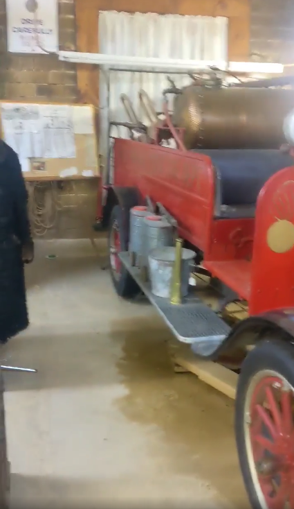

Thank you everyone for the information! The firetruck is my profile picture, so I am guessing it is a high radiator... I am new to the model T's, but the radiator looks very similar to our 1925 touring, so I am guessing that it is a high radiator. The truck is all original, and has 1923 painted on the hood with the initials for the Savanna Ordnance Depot Fire Department. (SOD FD) I found an online video of the museum which has the truck in it. Since I am not at the truck now, I cannot get photos. https://br-fr.facebook.com/McConnellAre ... 0882311735
- Posts: 4691
Re: Serial Number?
Looks like a high radiator to me. I have had engine swaps on various cars and went down to the Highway Patrol headquarters and had them look at the car and the new number. They ran a check and if the number hadn't been reported stolen or registered, they just gave me a verification and I got it transferred to the new number. Sometimes the engine number was earlier or later than the registered date of the vehicle. So I would suppose the same could have been done sometime in the past with your vehicle. Very common on vehicles where the engine number is used as a VIN number.

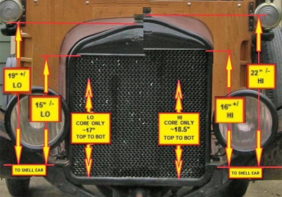

Rather than rely on what people think things look like in a picture, use this to determine whether your radiator is low or high.
Low = 1923 &earlier; high = 1924 & later.

The apron under the radiator indicates a high radiator, as do the lips on the front fenders. On our Canadian sourced cars, this would make it 1923 or later. TT's kept the same components even when the improved 1926-7 cars came along.

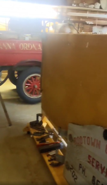

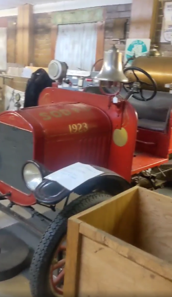

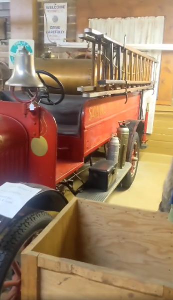

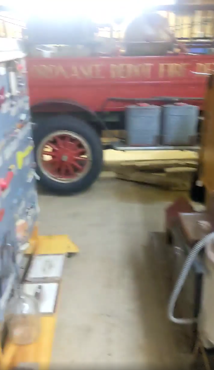

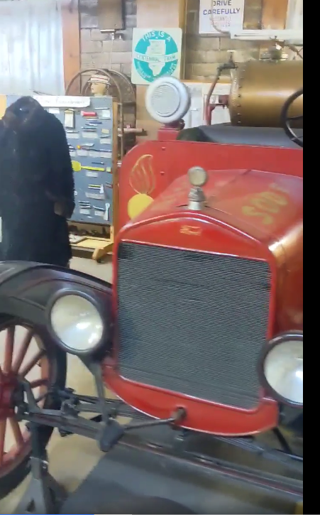

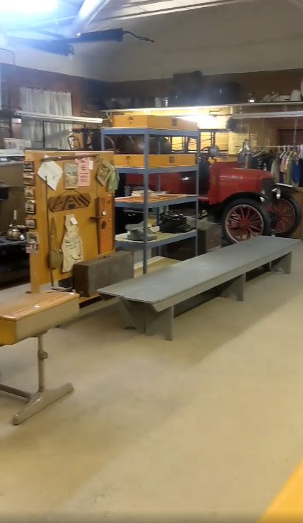

I am finding these photos in the above video, since I do not have access to a camera that I can upload pictures onto the forum. I will also be losing my computer on the 25th so I will not be able to post on the form for a while. I will have to look at the car, but I don't know if it has a wood firewall, and the coils are in the same spot on the dash. I do not know about the rest of the holes everyone has mentioned. I think that the car has a high radiator, but I will have to measure it.

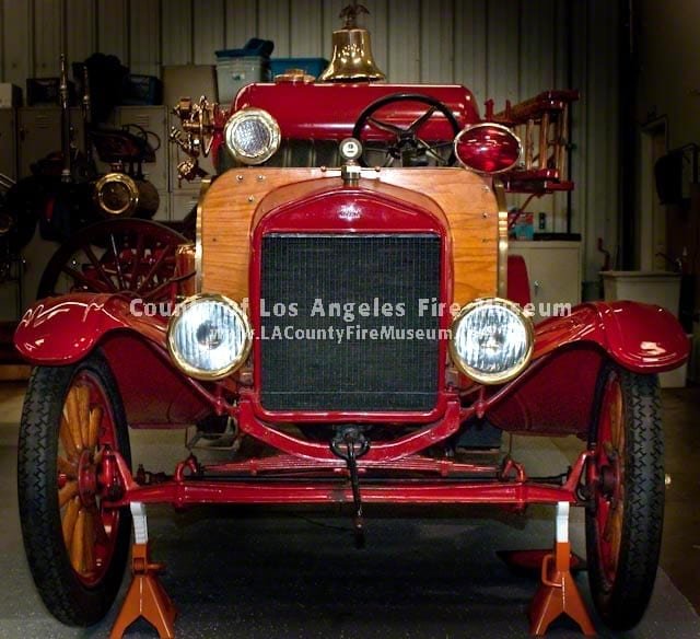

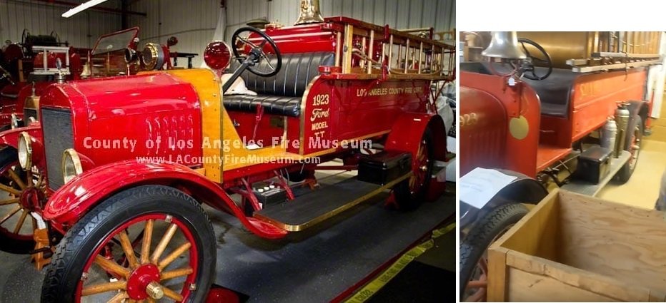

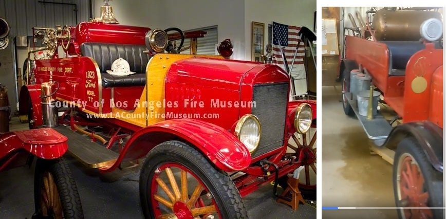

Did some searching on the INTERNET. https://www.lacountyfiremuseum.com/proj ... -model-tt/
"1923 Ford Model “TT” The TT designation was for heavier duty chassis, such as a truck chassis. The TT we have is similar to the 1915, but it has two chemical tanks. You could switch over to the other tank when the first was empty and continue to fight the fire as you refilled the other one with water. This also carried 2.5″ cotton jacketed hose, and that hose would be charged with water with either a fire hydrant, or a pumper." --
Comparing some details I would say it is a 1923 American La France. It would then be likely that parts from from a prior year might be used in assembling the body by ALF. Many things match -(I didn't expect the running boards to but the do). A "no match" is the width of the rear fender but who is correct? Would be worth while to capture some pictures from the museum video and take a corresponding picture of the one under investigation --
Some vintage photos to answer authenticity of questionable differences like rear fenders

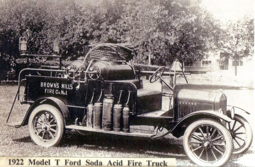

It looks like that truck has a high radiator. If it is a 1923 like it says, why would it have a high radiator?TRDxB2 wrote: ↑Tue May 17, 2022 1:27 pmDid some searching on the INTERNET. https://www.lacountyfiremuseum.com/proj ... -model-tt/

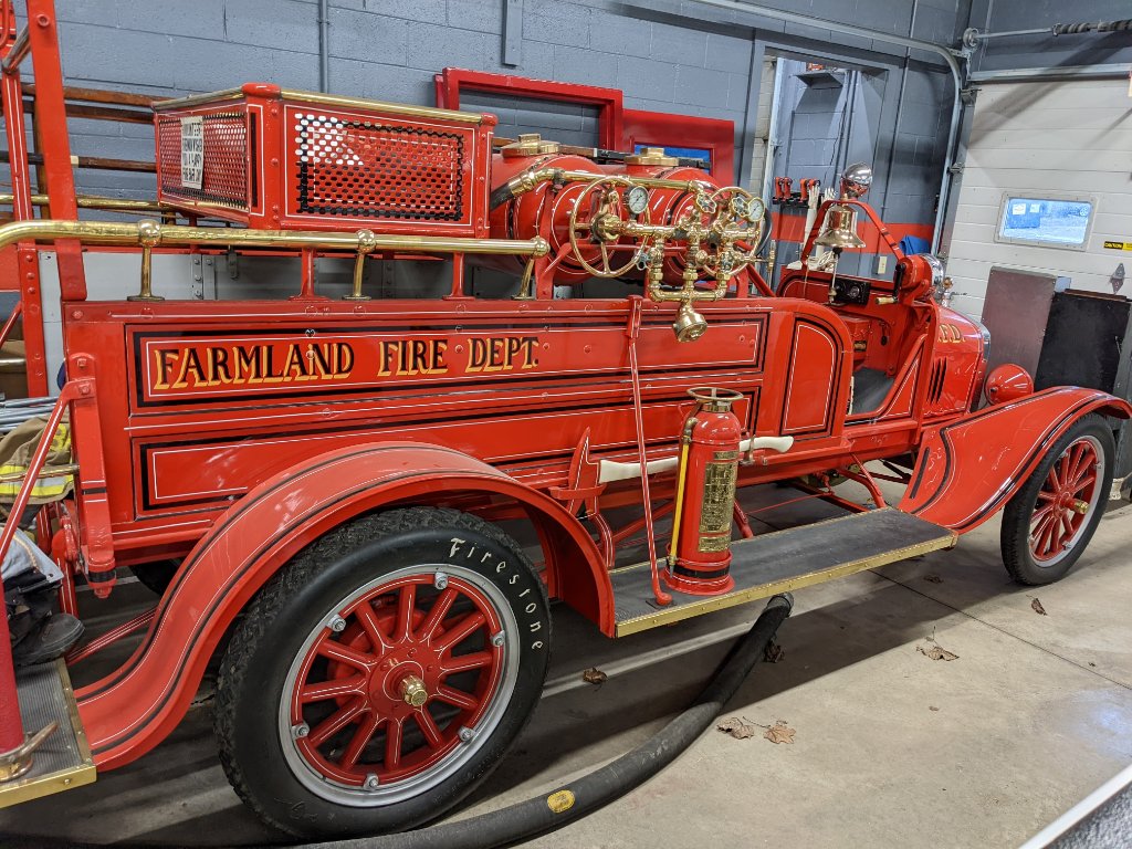

Re: Serial Number?
I have talked with another owner of a truck like ours, and the fenders on theirs are different as well.
I see that this truck has a lip on the rear fenders. Ours does not, but this truck has that same design.

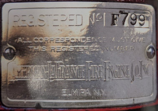

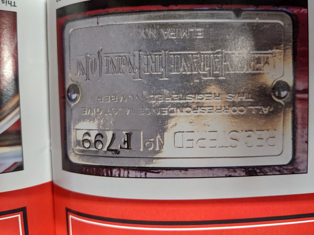

Re: Serial Number?
The above plate is not from our truck, but from another truck that was featured in the Vintage Fire Truck Magazine.
(Thank you for cropping it and rotating it for us all.)

The visual difference between low and high hoods can be tricky. I've found the best way is to look at the car from the side -- if the hood hinge is close to the top of the headlight, its a low hood. If there's a bit of space between the two, its a high hood.
Your truck looks like a high hood. That, plus the apron and fender style supports a March 1925 date as the engine number states.
The date "1923" painted on the hood looks like it was added over the past fifty years, probably by someone who sincerely thought that was the year of the truck.
- Posts: 4288
Re: Serial Number?
Your truck seems to match the Brown's Mills truck the closest. The ALF bodies have a bit different construction than yours. The "Rockville" truck, I believe, might be a Boyer.
Maybe look up the antique fire engine club, SPAAMFAA.
https://spaamfaa.org/
