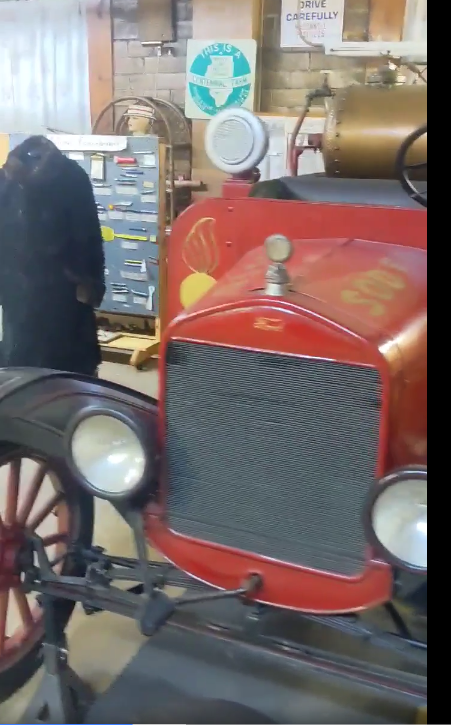

Post by 1925 Touring » Mon May 16, 2022 10:36 am
Thank you everyone for the information! The firetruck is my profile picture, so I am guessing it is a high radiator... I am new to the model T's, but the radiator looks very similar to our 1925 touring, so I am guessing that it is a high radiator. The truck is all original, and has 1923 painted on the hood with the initials for the Savanna Ordnance Depot Fire Department. (SOD FD) I found an online video of the museum which has the truck in it. Since I am not at the truck now, I cannot get photos. https://br-fr.facebook.com/McConnellAre ... 0882311735

Re: Serial Number?
Post by Norman Kling » Mon May 16, 2022 11:37 am
Looks like a high radiator to me. I have had engine swaps on various cars and went down to the Highway Patrol headquarters and had them look at the car and the new number. They ran a check and if the number hadn't been reported stolen or registered, they just gave me a verification and I got it transferred to the new number. Sometimes the engine number was earlier or later than the registered date of the vehicle. So I would suppose the same could have been done sometime in the past with your vehicle. Very common on vehicles where the engine number is used as a VIN number.

Post by Mark Gregush » Mon May 16, 2022 10:07 pm
It's a TT fire truck, the front end photo above might be the only good indicator of what year it is along with the engine number.

The apron under the radiator indicates a high radiator, as do the lips on the front fenders. On our Canadian sourced cars, this would make it 1923 or later. TT's kept the same components even when the improved 1926-7 cars came along.

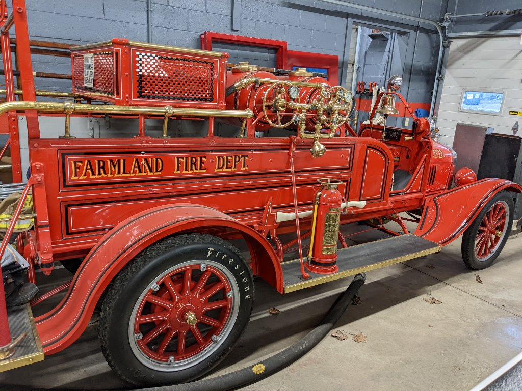

I have talked with another owner of a truck like ours, and the fenders on theirs are different as well.
I see that this truck has a lip on the rear fenders. Ours does not, but this truck has that same design.

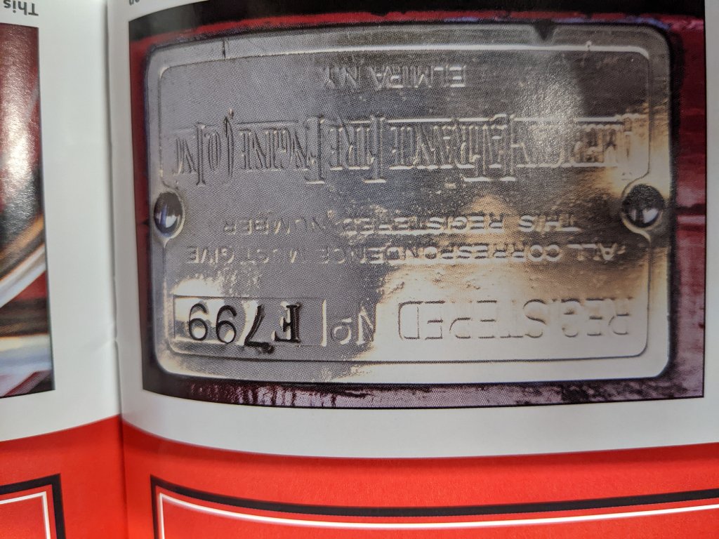

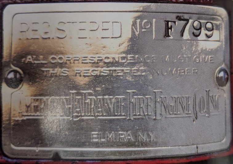

Post by Chris Haynes » Wed May 18, 2022 1:28 am

Post by 1925 Touring » Wed May 18, 2022 9:41 am
The above plate is not from our truck, but from another truck that was featured in the Vintage Fire Truck Magazine.
(Thank you for cropping it and rotating it for us all.) :)

The visual difference between low and high hoods can be tricky. I've found the best way is to look at the car from the side -- if the hood hinge is close to the top of the headlight, its a low hood. If there's a bit of space between the two, its a high hood.
Your truck looks like a high hood. That, plus the apron and fender style supports a March 1925 date as the engine number states.

Post by Jerry VanOoteghem » Wed May 18, 2022 12:39 pm
Your truck seems to match the Brown's Mills truck the closest. The ALF bodies have a bit different construction than yours. The "Rockville" truck, I believe, might be a Boyer.
