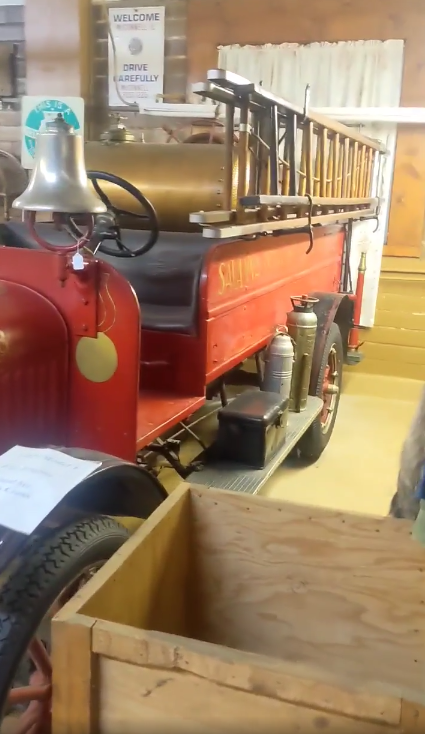

Thank you everyone for the information! The firetruck is my profile picture, so I am guessing it is a high radiator... I am new to the model T's, but the radiator looks very similar to our 1925 touring, so I am guessing that it is a high radiator. The truck is all original, and has 1923 painted on the hood with the initials for the Savanna Ordnance Depot Fire Department. (SOD FD) I found an online video of the museum which has the truck in it. Since I am not at the truck now, I cannot get photos. https://br-fr.facebook.com/McConnellAre ... 0882311735

Looks like a high radiator to me. I have had engine swaps on various cars and went down to the Highway Patrol headquarters and had them look at the car and the new number. They ran a check and if the number hadn't been reported stolen or registered, they just gave me a verification and I got it transferred to the new number. Sometimes the engine number was earlier or later than the registered date of the vehicle. So I would suppose the same could have been done sometime in the past with your vehicle. Very common on vehicles where the engine number is used as a VIN number.

Rather than rely on what people think things look like in a picture, use this to determine whether your radiator is low or high.
Low = 1923 &earlier; high = 1924 & later.
Is your firewall steel? Then it's after 1922. Does it have a large wiring hole under the terminal board? Then it's 1923. Is the big wiring hole above the terminal board? That's 1924 and later.
On cars the hand brake quadrant is an important clue. Maybe one of the experts can tell us if this applies to trucks too. 4 rivets = 1924 & earlier; 2 rivets = 1925 & later.
That 1923 painted on the vehicle is no guarantee. A Ford made August-December 1923 is a 1924 model. Also, people often misremember what they read or hear. I bought a "1922 touring" which turned out to be a 1923. The TT project sold to me as a 1922 is actually a 1924. The sellers weren't being dishonest about the year. They were just mistaklen.

The apron under the radiator indicates a high radiator, as do the lips on the front fenders. On our Canadian sourced cars, this would make it 1923 or later. TT's kept the same components even when the improved 1926-7 cars came along.

The visual difference between low and high hoods can be tricky. I've found the best way is to look at the car from the side -- if the hood hinge is close to the top of the headlight, its a low hood. If there's a bit of space between the two, its a high hood.
Your truck looks like a high hood. That, plus the apron and fender style supports a March 1925 date as the engine number states.
The date "1923" painted on the hood looks like it was added over the past fifty years, probably by someone who sincerely thought that was the year of the truck.

Your truck seems to match the Brown's Mills truck the closest. The ALF bodies have a bit different construction than yours. The "Rockville" truck, I believe, might be a Boyer.
