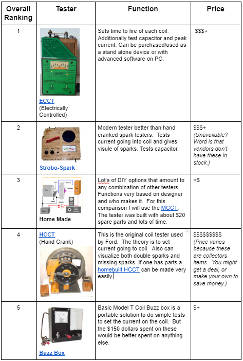

Okay I have concluded that I need a good set of coils. I know that I can get rebuilt coils, but I am asking myself, should I spend that money toward getting a tester?
The advantage of having someone rebuild my coils is that it would be done. I wouldn't have to worry about the labor (time) or parts. The disadvantage is that I wouldn't have a good way to test those or coils or other coils...
So then I look at the tester options:
Simple Ford Coil Buzz tester $143.99
https://www.macsautoparts.com/ford_mode ... ester.html
I have one of these and it helps with setting current, but is not dynamic and does not account for double/miss sparks.
Hand Crank Coil Tester (HCCT) $$$? Availability?
Mechanically detects double spark. Great Model T era technology! Heavy, not very portable.
"Strobo-Spark" $349.95
http://www.funprojects.com/products/ct-1.aspx
Improvement on the HCCT. Light and portable.
Electrically Cranked Coil Tester (ECCT) $299.95 ($399.95 with software)
http://shop.modeltetimer.com/main.sc
Lot's of bells and whistles. Here is a technical write-up I found related to it:
http://www.modeltecct.com/uploads/ECCT_Intro.pdf
[Another none-commercial electronic coil tester: http://members.iinet.net.au/~cool386/tester/tester.html]
So it looks like I have three good options of coil testers:
1. ECCT w/o software $300
2. Strobo-Spark $350
3. ECCT w/software $400
Please let me know what you recommend and why. (I saw a number of post recommending these, but not comparing them.)
Thanks,
Matt

I purchased a ecct tester last winter and it works very well, the dvd that comes with it is very informative as to testing and setting the points. it is very compact and easy to use. Just my 2 cents.

I have the ECCT hooked up to my laptop. You can run all the tests from there. I can simulate 1-250 sparks at any RPM (within reason.) I usually test my coils using 200 sparks at 400, 800, 1200, 1600 and 2000 RPM. This gives me very reliable information on how the coil will perform in use. After charting the results I can rerun the tests at a later time for comparison.
This has been the single best investment I have made in the tuning of my engine.

I own a Strobo-spark. The ECCT was not available when I purchased it... It works very well (has for years) and resultant coils perform nicely. I do not own a ECCT so cannot personally comment on it, but it has a good reputation among it's users.

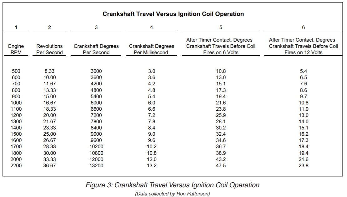

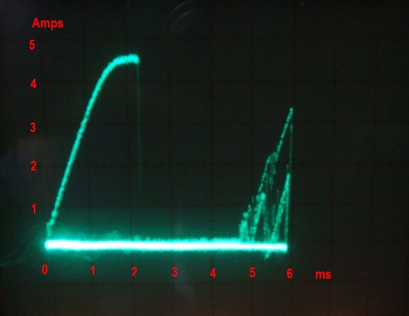

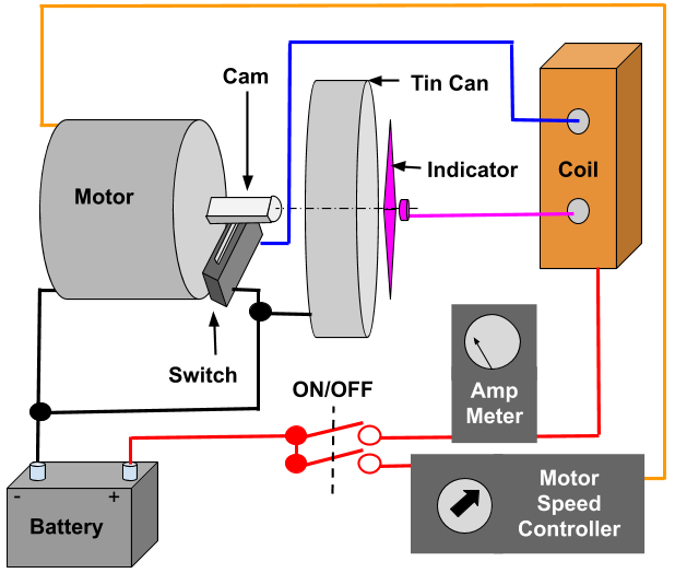

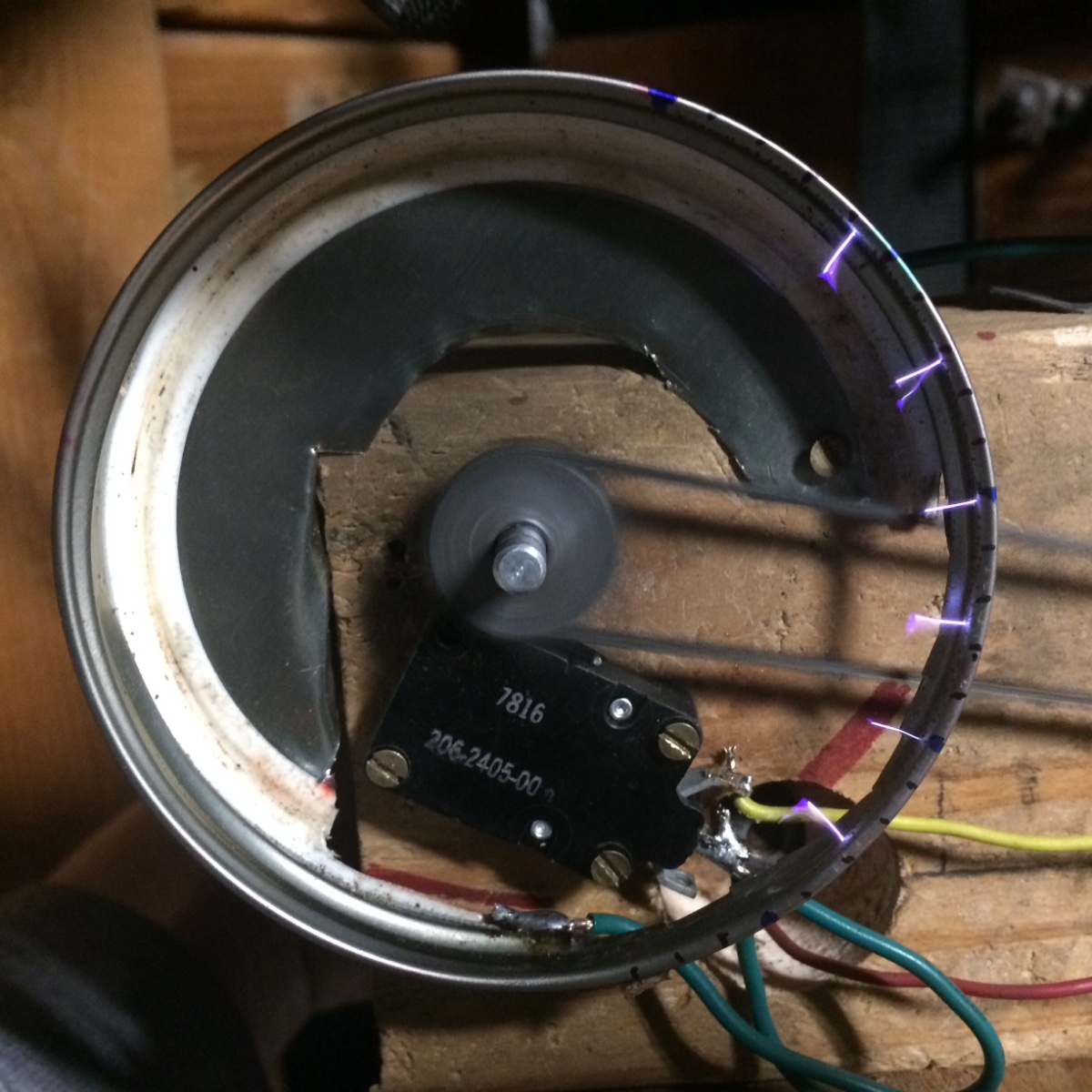

I use the dwell time to fire method of coil adjustment; intially I built my own tester using this principle and then bought an ECCT.
The ECCT is user friendly for non technical Model T owners, and if the computer interface is used, it will tell you everything there is to know about the coils. What I like is that with dwell time to fire is you end up with a set of coils all matched. Any timing inaccuracies are eliminated from the coils and only depend on the condition of the timer.
So called "Buzz Box" testers are only good for a rough adjustment. They work on the principle that average coil current as indicated by the meter depends on coil firing time. However, the meter is not sufficiently accurate for this purpose, and certain variations with individual coils means that some require a greater or lesser current for the same firing time. Also, this type of tester cannot show if a coil suffers from multiple sparking. You can only make sure the points are in good condition, are adjusted to the right clearances, and hope for the best.

I have the ECCT and love it, easy to learn and use, it's a lot of fun to rebuild your own coils and have your car run fantastic and all accomplished by you. You can at your leisure, test and adjust your coils for maximum performance

Because of that, and if I was in your position, I'd be buying his Strobo-Spark device.
I have no knowledge of the ECCT except for what I've read.
But I know I could trust the Fun Projects product.

I've had a strobopark for several years now and am completely satisfied. I rebuilt a few coils but mostly it is used for tune-up work. HCCT's are pretty much collected, driving the price up. The ECCT was not available when I was shopping. You just need to remember that they are just tools and some homework is required.

I have a Strobospark and it works great. I have never used, or even seen the ECCT used. I do think the dwell time to fire adjustment theory does makes sense.

I bought the ECCT with all the bells and whistles, with two cars I thought it would be good investment. Both of my cars run great, one with a roller timer and the other with an itimer. I also verify my coils at different rpm ranges.

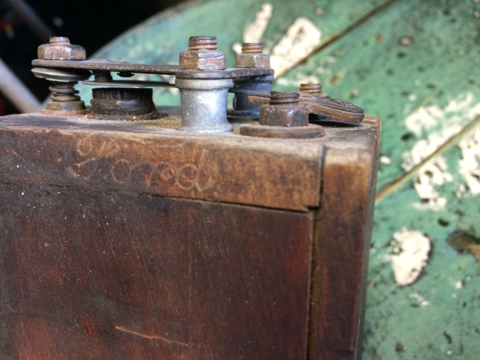

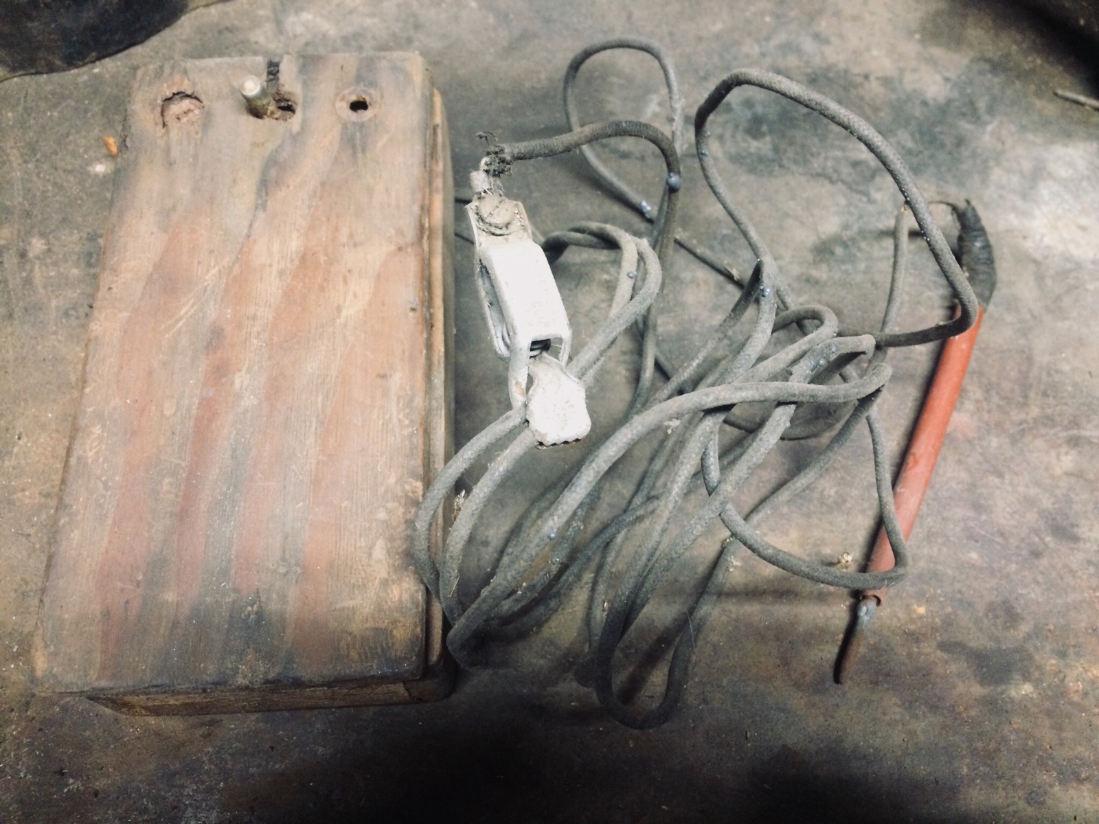

Thanks for sharing your additional experiences! This is very helpful as I consider what I will do.

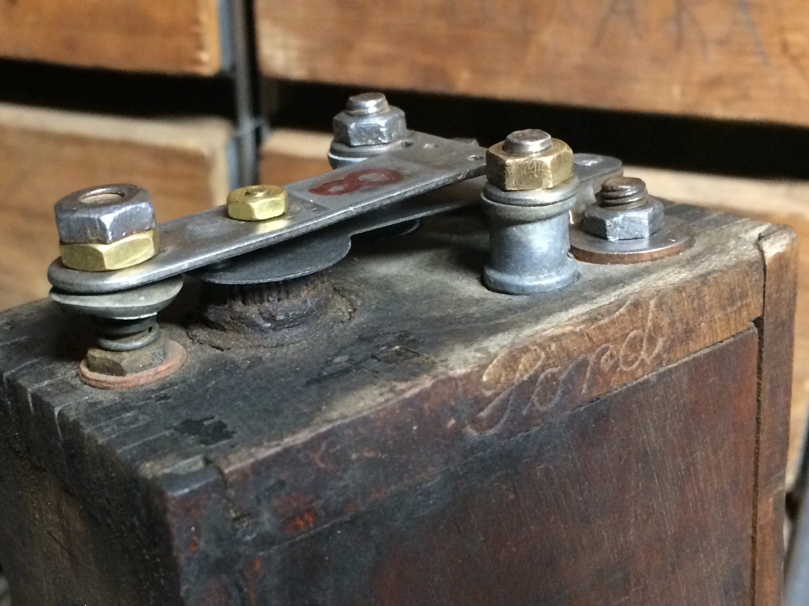

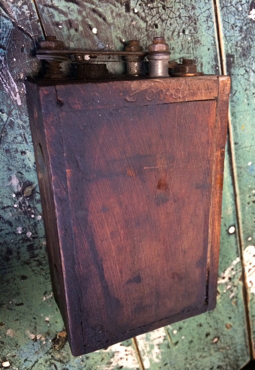

As I was pulling out the coils I had I found my old coil tester: But the batteries seem to be older than me! Matt

Mike Kossor makes the ETimer, ITimer and also the ECCT. All of his products are of the highest quality and he has the highest customer satisfaction rating because of the quality of his products and his helpfulness.
I have purchased John Regans products which are very good but the ECCT can be much more accurate.
I might advise you to purchase the ETimer and use the coils that you have now and eliminate the need for any ECCT or others!
On top of that you won't need any future coil adjustments or any maintenance or replacement of the timer in the future! It appears you have little knowledge about adjusting the coils and it was stated earlier that it does take a bit of learning to be able to do a proper adjustment job. The ETimer will most likely out perform your adjusted coils and what ever timer you are currently using by far.
IMHO

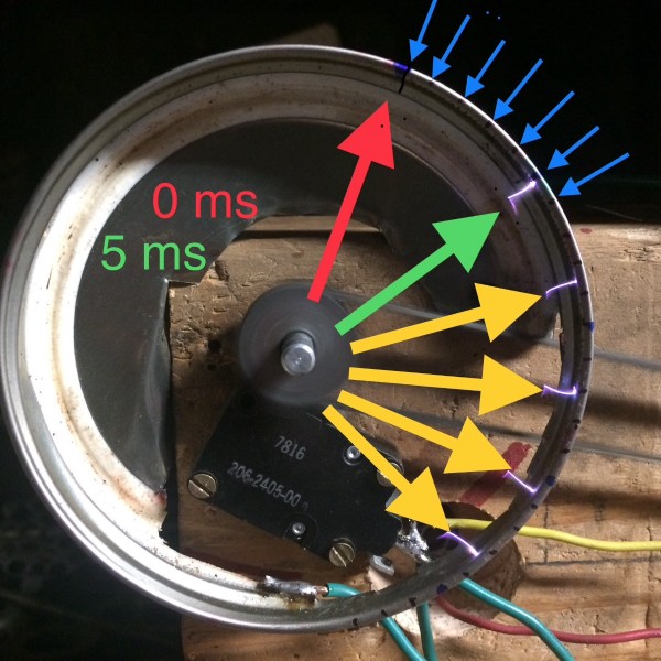

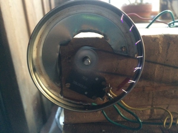

I rebuild coils and I have all three

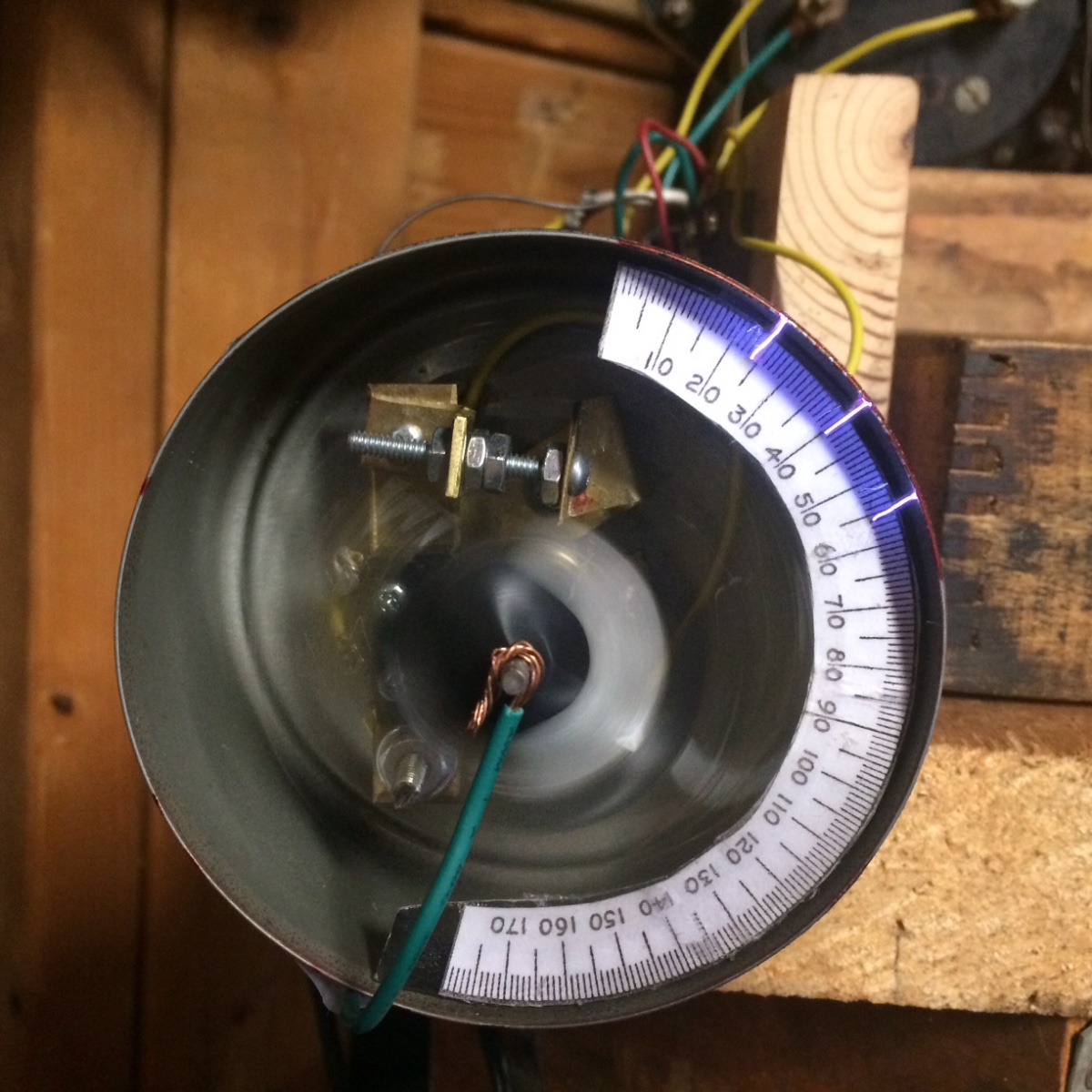

Strobospark is a modern and portable redesign of the original HCCT and a good one (as all that John Regan have given this hobby).
However, I was catched by the talk about dwell time on each coil, and the importance of this to be alike in a set of coils. So I ended buying an ECCT and have tried it out on the last set of 10 coils I rebuild.
I have still to master how to adjust so the dwell become the same, but practice makes master I hope. I now tests all coils on all three devices as they should be perfect on all three.
I intend to adjust the coils in my two Model T's and see the results.

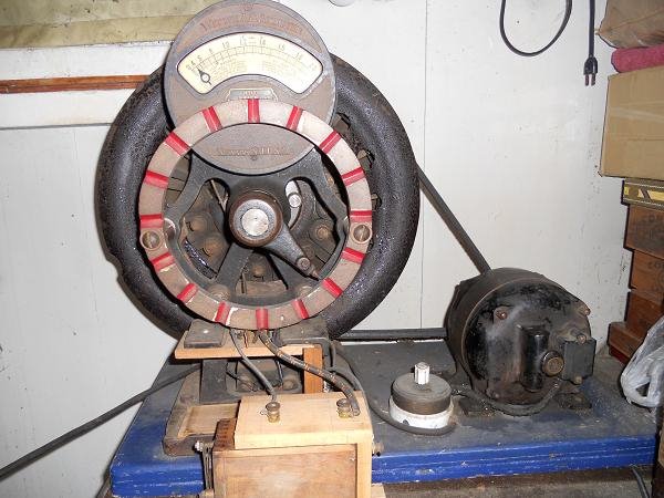

Have you thought about building your own HCCT. I have to assemble mine yet but have the frame welded together and purchased th e bearings and shaft collars from Grainger. You possibly have a mag coil ring and flywheel and magnets laying around or have friends with parts to help you and you all could use it. You would have to find an amp meter to read low amps. I found one through the forum.

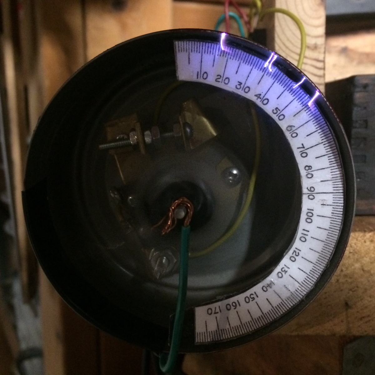

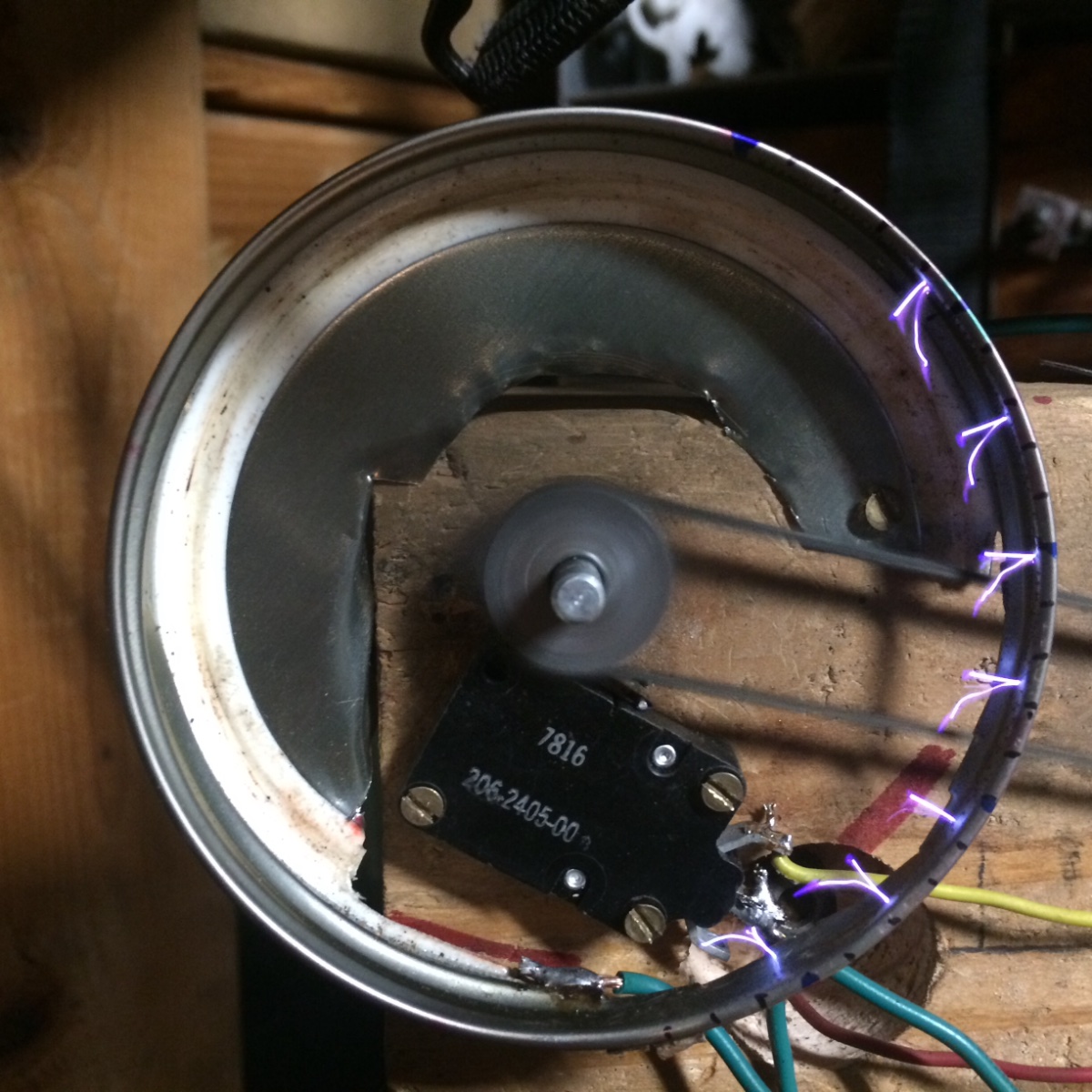

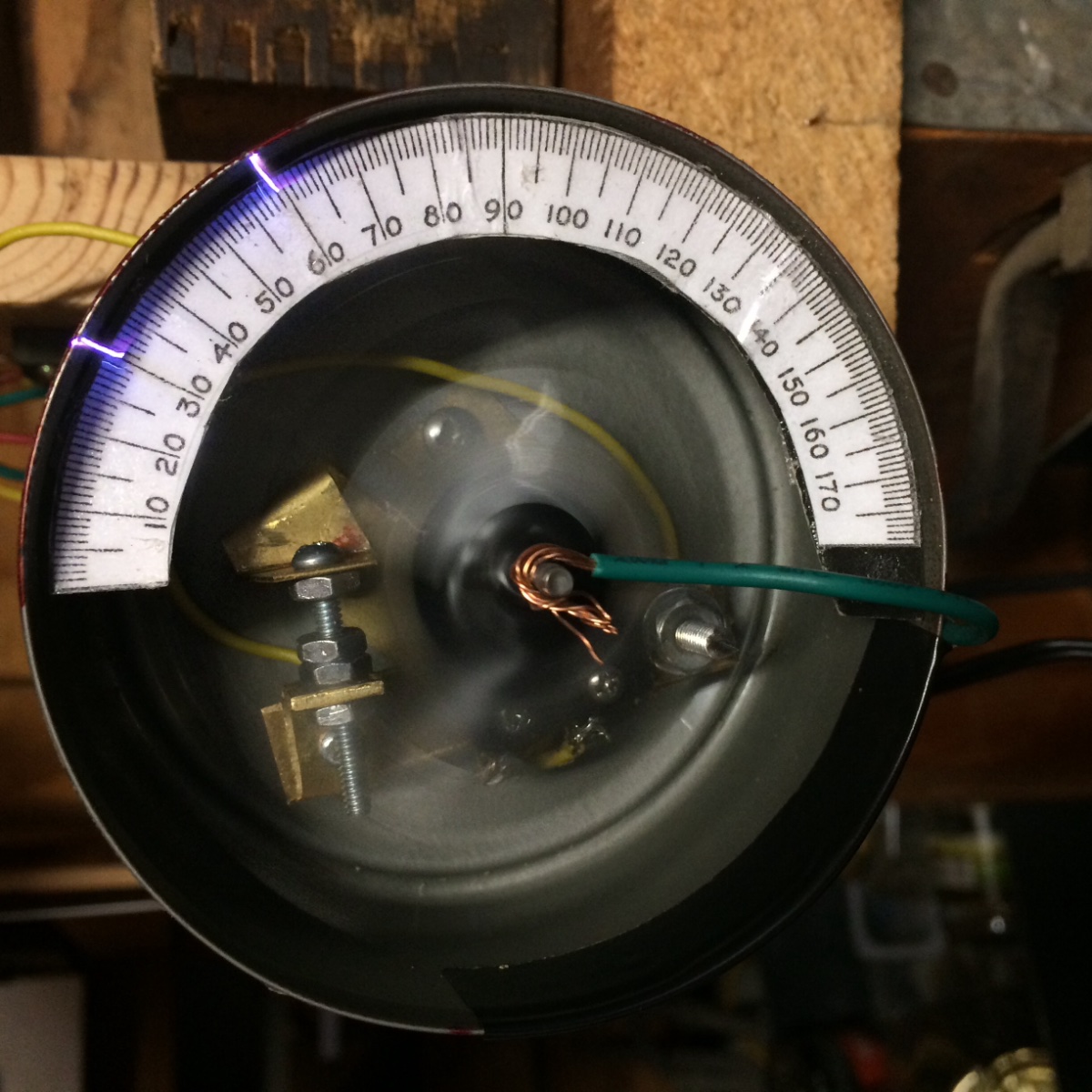

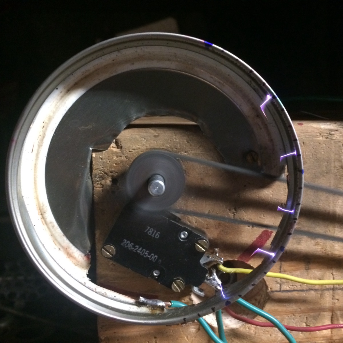

I decided to move forward. I made a MCCT!
Matt
BE_ZERO_BE
- Posts: 662
- First Name: BOB
- Last Name: CASCISA
- Location: POULSBO, WA
Re: Model T coil tester advice: HCCT, Strobo-Spark, ECCT
Gresat job. !!!
What did you use for an ammeter?

Matt
since I don't see a magneto behind the ring, I'm not sure what I'm seeing here, but with a 1725RPM motor, that pully is WAY too small and your rotor is going WAY too fast to replicate operating conditions of a T (I sincerely hope there is not a magneto/magnets turning that fast in your shop)
In any event, elaborate, please, on what we are seeing!

Bob,
This is a work in progress. I am testing the theory of the dynamic part of the MCCT. I still need to add the amp meter.
Scott,
That you see is a peanut butter lid, wires, microswitch, pulley with excentric. Uhmm that is about it.
I plan to discuss theory later, but I need to go about my day job at the moment...
Matt
Scott,

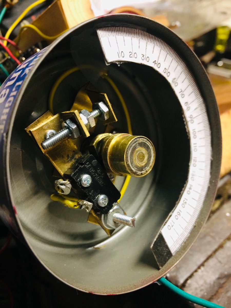

A bit more of the back story.
When I was a youngster, I would go way back in the under stairs closet and work on electronic projects. It was the only space that I could be alone from everyone including my two older brothers. One time I decided to prank my brother. I connected one side of a Model T coil to the door knob and the other side to a bare wire on the floor. I turned on the coil and called my brother. He came, opened the door, but nothing happened because he grabbed the porcelain on the knob. A few moments later after checking everything I called him back and... nothing. I mean he said nothing, but later told me that the shock was so strong his body convulsed and forced him to fly back on the bed. I share this story because this was my first exposure to a Model T and I would have never dreamed that I would be able to put that coil in my first Model T.
Okay, before I say anything more, I want to say that after researching the other options, and getting feedback, I can tell there are other great testers and worth the price. I understand if someone wants to do it "right" HCCT, Strobo-Spark, or ECCT with the proper understanding are all great options. But frankly, I have never personally used any of these to test coils. But as I researched things it just got my ticker moving.
I thought to my self, many Model T enthusiast like my self don't like to spend more than $20 on anything. What could I build that is so simple that anyone could build? Also, I have build/tested a lot of electronics and wanted to build something that was a lot more mechanical. Finally what could have been built 100 years ago based on the same concept. I also thought, a HCCT is nice, but too heavy. A ECCT is pure electronics to measure dwell time. (I don't know how a Strob-Spark works, perhaps my design is similar.) I concluded that I don't need magnetos to test dwell time, but I could use the concept on the HCCT to display the spark and give a understanding of dwell...
So here is how the Motor Controlled Coil Tester 0.0 works:
-A small DC motor turns a spark needle and excentric.
-The excentric turns on and off the low voltage primary wires.
-The needle is set so strait up is 0 dwell.
-For initial testing the unit is running approximately 400 RPM that would be equivalent to about 800 RPM. (It is slow, but that is how things came out with the 9 VDC power supply I am using. It could be speed up with a higher voltage.)
-400 RPM yields .15 seconds per revolution. That would mean if the first spark is at 40 degrees then it would have a 17 msec dwell time. (These are estimates based on the image that I posted and estimated 400 RPM.)
I have ideas to improve upon the MCCT 0.0. Obviously I want to add an ammeter. But my biggest issue is that I need to improve on my primitive excentric so that the 0 dweel time is more stable.
I welcome your thoughts and input.
Matt
Matt

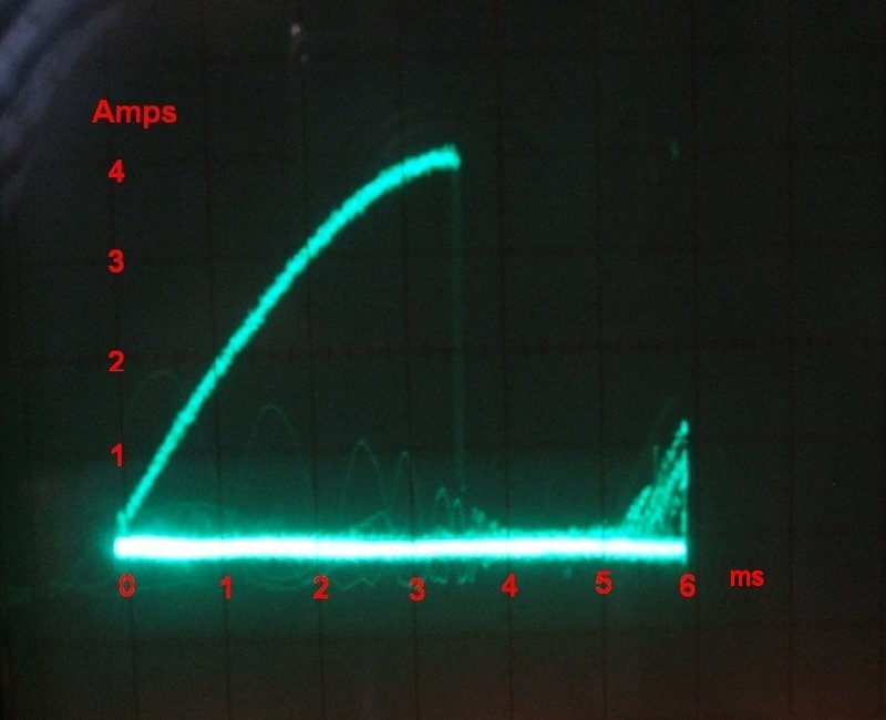

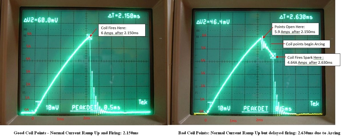

Matt, good to see you taking the initiative to experiment and learn by building your own MCCT. Here is what I learned when studying Model T coil point operation and the challenges they present that make adjusting them for equal and consistent firing time a challange.
In Theory, the basic concept is straight forward. A coil firing a periodic series of sparks with series of magneto pulses will draw an average current that is proportional to dwell time to fire spark. Subject all 4 coils to the same periodic series of magneto pulses and set the average coil current drawn equal and all 4 coil will have equal dwell time to fire spark or in other words, the same ignition timing with respect to piston position since the magneto pulses are synchronized with the crank shaft.
In Practice, physical variations between coils can guarantee coils set for equal average current will result in coils that require different times to fire spark. This causes ignition timing variation which causes engine vibration and loss of engine power.
The equal coil current method of tuning coils is also vulnerable to coil point arcing which can be present without indication by Ammeter reading as the variation in coil current happens too quickly for the meter to respond and is averaged over many sparks consisting of normal and arcing point contact openings. The illustrations Below helps visualize this. On the left is the coil current of a properly adjusted coil measured on an oscilloscope which displays how the coil current changes with time. Coil current is measured on the vertical axis and time is measured on the Horizontal axis. Note that the coil current starts at 0A at time 0 and ramps up steadily until it reaches 6A in 2.150ms. At this time, the resulting magnetic field is sufficiently strong to pull open the point contacts causing the coil current to drop abruptly to 0A This abrupt change in coil current produces a sharp change in magnetic field which induces the high voltage in the secondary winding responsible for firing spark across the spark plug gap. The average current method of adjusting coil points works very well with 4 similar coils adjusted for the same average coil current (1.3A) IF the points consistently open abruptly as illustrated in the left photo.
Conversely, misadjusted coil points may still open when the coil current reaches 6A but open slowly which frequently causes an arc to form as illustrated in the Right photo Below. Note that the coil contacts still open at 6A after the same dwell time (2.150ms) However, the current slowly decreases to 4.64A as the arc length increases until the contacts are too far apart to sustain the arc and the coil current abruptly drops to 0A at time 2.630ms; causing the coil to generate spark at the spark plug. Note that this same coil fires 0.48ms LATE. Thus the spark fires retarded by 0.48ms which translates to nearly 6 degrees at 2000 RPM. Another serious issue caused by point arcing is spark energy lost by the arc heating the air and point contacts. That is because the coil current drops from 6A to 4.64A before the arcing stops and spark occurs (abrupt drop in current). The lower coil current at the time of firing equates to a 40% reduction in spark energy which can result in poor combustion and misfire. The average current method of adjusting coil points works Poorly with 4 similar coils adjusted for the same average coil current if the coil points are randomly arcing when the coil points open as illustrated in the Right photo. That is because the random point arcing is not readily apparent from the average coil current reading (1.3A).
This is why coil points adjusted by actually measuring the dwell time to fire spark nearly always result in a smoother running engine with more power.
Matt in California
Topic author - Posts: 823
- First Name: Matt
- Last Name: G
- Location: California

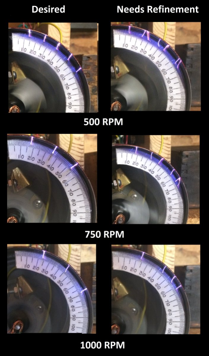

Mike,
Thanks for all the great information! This is very helpful as I attempt to make a very simple MCCT. I agree that the time to fire and consistency of all coils is very important for an optimal system. I also agree that your concerns about only adjusting for current has serious limitations. This is why a dynamic test is so important!
In your experience, can you adjust a set of coils to have equal dwell time at one speed, but then when you change the speed things drift? Or do things remain consistent regardless of speed? I am wondering if adjustments can minimize effects of different parameters (i.e. inductance, capacitance, spring constants and other electromagnetical differences) at a particular speed, but in reality things will drift as speed changes. Or is it possible to get a completely mismatched set of coils and tune them to be exactly the same regardless of speed?
Matt
Matt

Matt, regarding your question: "can you adjust a set of coils to have equal dwell time at one speed, but then when you change the speed things drift?" Absolutely! A coil adjusted to fire consistently at 2000 RPM can definitely start firing erratically as firing rate increases if not adjusted correctly. The firing consistency can and will drift with use; more than many realize. Unfortunately, New MTFCA forum rules were established to prohibit me from discussing technical details of the ECCT or its operational principals because I developed and market that tool, and is now considered "Free Advertising". If you are interested to know more, I must now ask you to contact me individually via PM or Email. My apologies in advance if I am unable to respond to all inquiries. It is time consuming and very inefficient way to share information of common interest but those are the rules imposed.

Matt, did you receive my email with example of improperly adjusted coil that fires relatively consistent at low to mid RPM but steadily degrades as firing rate increases?
In actuality, the higher engine speed will not likely be achieved due to the degrading coil firing consistency. Enginge smoothness would also be poor.

Keen, please see my post of April 22 above regarding comparing coil test results of the ECCT with other coil testers. Don't waste your time with that.
Judge coil adjustment method by comparing engine performance. That is the only thing that really matters. Please share your findings when you do.

Okay worked on the cam/microswitch. I got consistence sparking from good coils and I put in. Here’s an example:
The red arrow indicates zero dwell, the green indicates the first spark and yellow are the sparks after that. The little blue arrows are pointing to each millisecond of time starting with zero.
You can see that the first spark happens at about 5 ms followed by sparks every 3.5 ms. The picture is actually show two different scans verifying this coil is fairly consistent.
Matt
Matt
Matt in California
- First Name: Matt
- Last Name: G
Here is another cool. A good coil, just the two need to be tuned the same:
Here the first spark is at 4.25 ms
And each spark after that comes about 2.75 ms
Matt
Matt

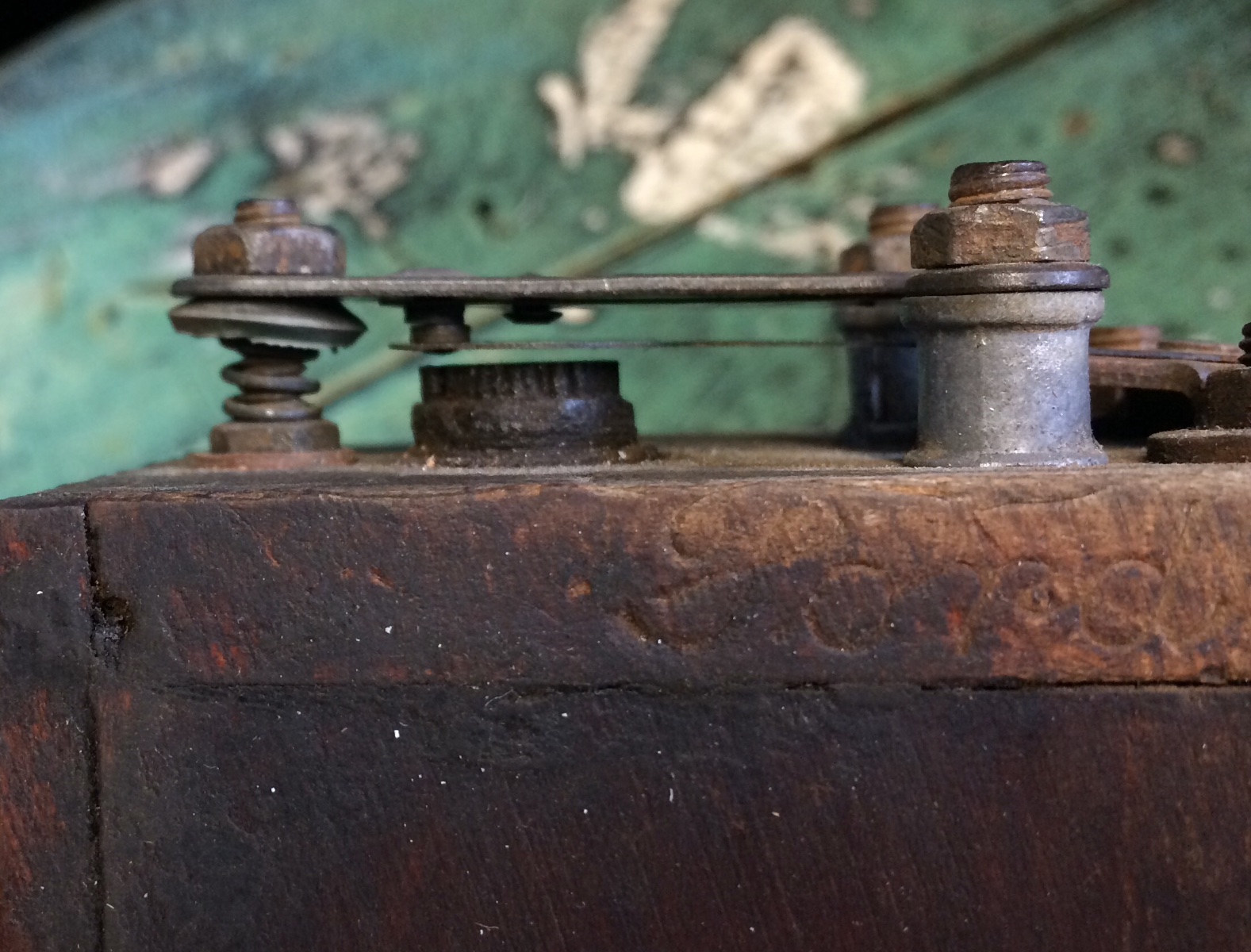

Here is one that the cushion spring is not working causing the dreaded double spark:
It either makes those “V” shapes or causes the sparks to be too close together. In this case the first spark is at around 4 ms followed by sparks every about 1.75 ms.
Of course the issue with no cushion spring is that it will not allow it to charge up for very long before the contacts break.
BTW if you look closely you will see little black tick marks on the side of the lid. Those are approximately 1 ms.
Matt
Matt

John,
I sent you a PM. Call me. No secrets here!
The MCCT v0.0 just has the following parts:
-A small DC motor turns a spark needle and cam/eccentric.
-The eccentric turns on and off microswitch to the low voltage primary wires.
-Peanut butter jar lid
-power supply
-a few basic parts to hold the coil
-Ammeter
Essentially the idea is to mimic the Model T timer (switch) and the HCCT (display spark).
Matt
-power supply
-Ammeter
Matt

I am a little perplexed and wonder if someone can help me.

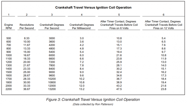

I found the following on the fun projects web page: http://www.funprojects.com/pdf/More%20o ... Timing.pdf
I saw the following figure: It seemed logical that doubling the voltage would cut the dwell time in two. But I am not getting the same results...
I had my setup as photographed above on 12 volts. I keep the MCCT motor at 12 VDC, but lowered the coil voltage to 6 VDC and I am still seeing 4-5 ms dwell time.
Any ideas?
Matt
Any ideas?
Matt

Coil dwell time to fire certainly does increase as the input voltage is lowered; and conversely decreases as input voltage increases.
If a coil is set for a dwell time to fire of 3.5ms (the point at which core saturation begins) when fed with 6V, this decreases to about 2ms when the coil is fed with 12V. It's for this reason a greater range of timing advance is required to run coils successfully on 6V as compared to 12V.

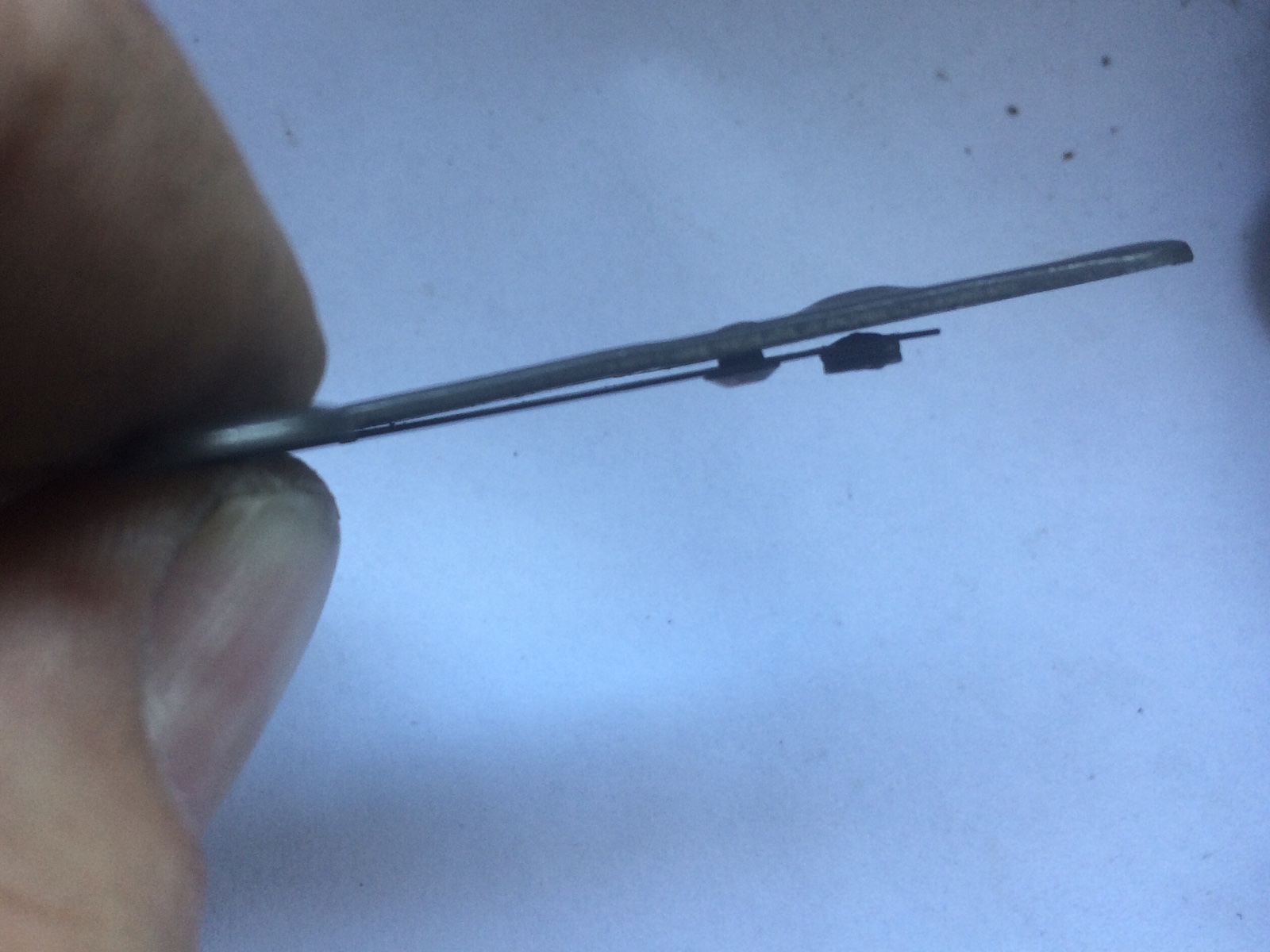

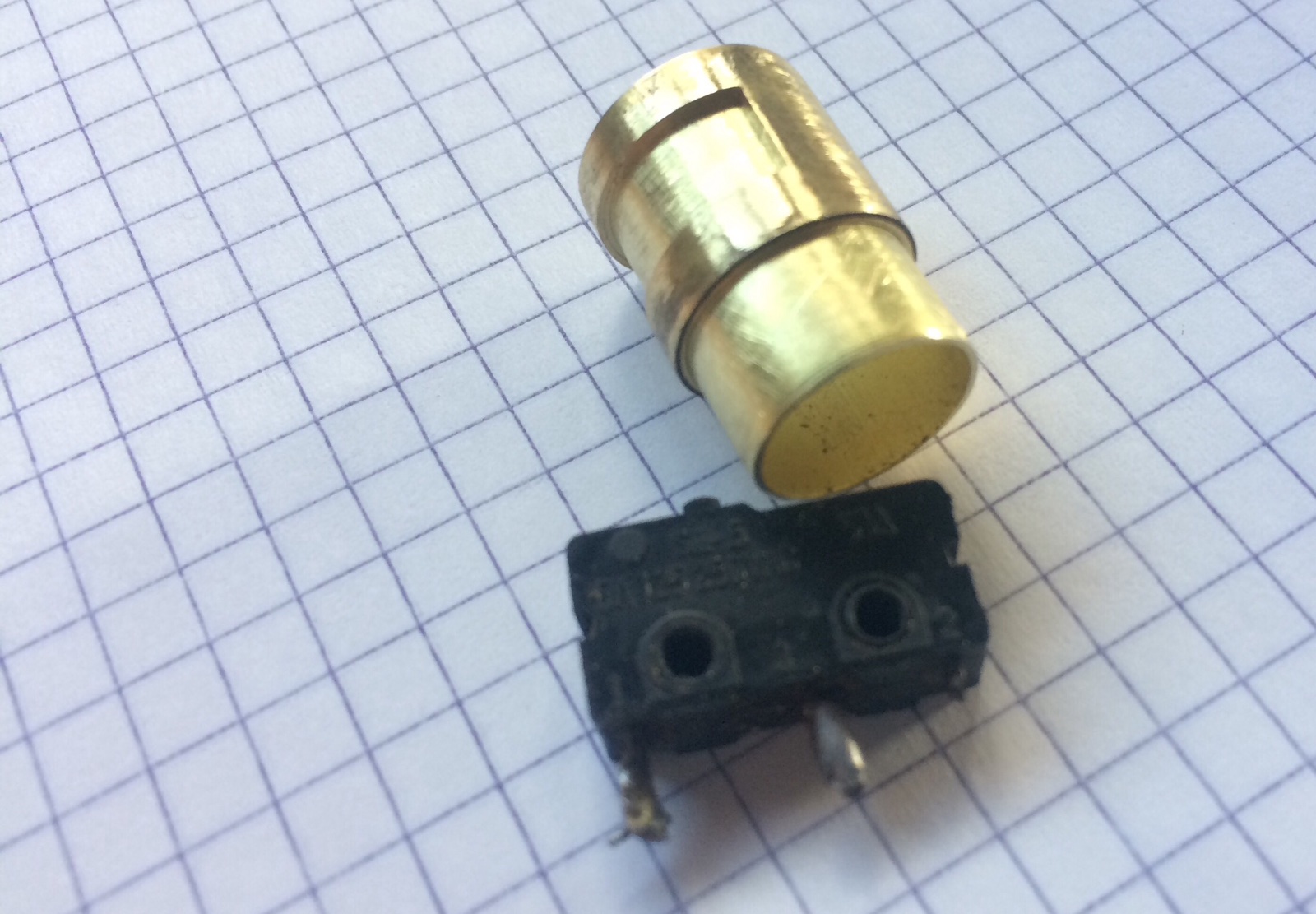

Upon doing more testing I figured out that micro-switch setup somehow must be causing a delay. Somehow when I move it slowly it must have a different on location then when it is moving fast. Increasing the voltage does move the first spark a bit back, the following sparks is where it is more obviously changing with voltage.
John, could you help me to confirm the distance from powering the first spark and between the first and the second, etc. ? I am just wanting to make sure that the dwell time between each spark should be the same if you leave the power on for a handful of sparks. Or is there a difference because there is more movement with the cushion spring on the first spark?
Also, does anyone have a recommendation on the gap that I should use?
Thanks!
Matt
Thanks for confirming things! Wow! It looks like you live in a beautiful part of the world.
Thanks!
Matt

Matt, did you receive my email with data illustrating how coil firing consistency can deteriorate with firing rate associated with higher engine RPM?
Regarding your present inquiry, mechanical switches suffer from non-ideal switching characteristics. Switch bounce is a primary characteristic in which contact is made, broken, made, broken, until contact becomes permanent. This occurs within milliseconds but that is the order of the time scale in which the model T coil operates. These brief interruptions in primary coil current offer one explanation why the first coil firing is observed to take longer than the others. Another consideration is the fact the first coil firing occurs starting with the coil at rest. There is no residual energy stored in the coil on its first spark. That is Not the case in subsequent coil firings. The periodicity of subsequent coil firings will depend heavily upon the 3 fundamental coil point variables (Vibrator spring tension, cushion spring tension and point gap) and the residual energy stored in the coil from the previous firing when the points eventually close after firing. Focus should be on the characteristics of the dwell time to fire the first spark. This dwell time to fire should be equal and consistent for all 4 coils regardless of engine RPM firing rate. Subsequent coil firings is irrelevant with respect to engine performance since it is the first spark that is responsible for ignition on the power stroke. Also assuming the spark needle rotational velocity is uniform and does not vary with time. Ideally, the motor power supply is properly regulated and independent from the coil primary power. Having the ability to measure coil dwell time to fire is necessary but not sufficient to achieve proper coil point adjustment.
The Art of Coil Point Adjustment
Regarding point gap, 0.031" is the recommended starting point gap. Equal and consistent coil firing time can be achieved with this gap by setting the vibrator spring for nominal firing time of 2ms when stimulated from rest by an ideal 12VDC step function (i.e. No switch bounce). Firing consistency is attained by proper adjustment of the cushion spring tension. The two adjustments do interact so it is an iterative process that typically takes only a few minutes if the cushion spring travel has the specified distance of 0.005" If the cushion spring travel is not properly set by the manufacturer however, proper coil point adjustment can be much more elusive. This is because the onus all on the operator to find a balance between vibrator spring tension, cushion spring tension and point gap that insures the coil point contacts consistently break abruptly in 2ms without the benefit of the limit rivet stopping the cushion spring movement.

Matt, adding to what Mike has said, I am surprised the micro switch has lasted this long. Not just because it isn't designed for this kind of service - switching so rapidly, but also I wonder about arcing at its contacts because of switching an inductive load. The life for a typical micro switch is 500,000 cycles. Also, the way micro switches work means there is some inherent delay between pressing the actuator and the contacts actually making, and I wonder if this has something to do with the change in dwell time not being so obvious.
Something that might be worthwhile experimenting with is to eliminate the micro switch and run the coil off AC. If a synchronous motor is used to drive the pointer, the sparks would remain in a fixed position. In this regard, I suspect the tester might resemble the Strobospark.

Thanks for your response. Yes, I did receive the document where you illustrate the inconsistencies can deteriorate with higher engine RPM. I believe that I did send a response, perhaps it went to spam. Is it okay to share the document here on the forum?
I agree with your thoughts on a larger initial delay, both because of the delay in the switch and a coil depleted of residual charge. I also concur that most of the concern should be with the initial spark dwell the same over all four coils. Though subsequent coil firings is irrelevant, I think the follow up sparks are helpful to expose other issues including the dreaded double spark.
Thanks for your response on "The Art of Coil Point Adjustment." I am starting with the recommended 0.031" point gap. But I was actually confirming if the test spark plug gap should be 1/4". I wondered if that was a bit to much. From what I understand you recommend setting the coils to 2ms @ 12 VDC. I am working out some kinks on the system, but it looks like I will be able to get results in that order. Then I will be able to play with the cushion spring and vibrator spring tension (Vibrator spring tension, cushion spring tension and point gap).
Wow! Materials wise, I haven't spent much on my tester (just spare parts I had), but time wise the ECCT is looking cheaper and cheaper than my MCCT tester! But I am enjoying understanding the magic behind the curtain. And as I heard a long time ago you measure hobbies by how little you spend per hour;)
John, I agree that a different system to trigger the spark should be considered. Perhaps just using a set of points would be helpful.
Matthew
Matthew

I am pleased to announce the development of MCCT v1.0. For those new to the discussion my goal is to build a cheap (<$20), simple, mechanical electric motor driven coil tester that could have been build during the production of the model T. The hope is to provide dynamic testing of coils especially to measure dwell. The MCCT v0.0 was a proof of concept. In the second tester I want to eliminate the belt and improve the visualizer.
I’m moving away from the peanut butter jar lid to a tuna can! Matt
Matt in California
- First Name: Matt
- Last Name: G

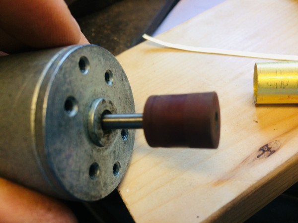

I had this DC motor with a rubber bushing to drive something.

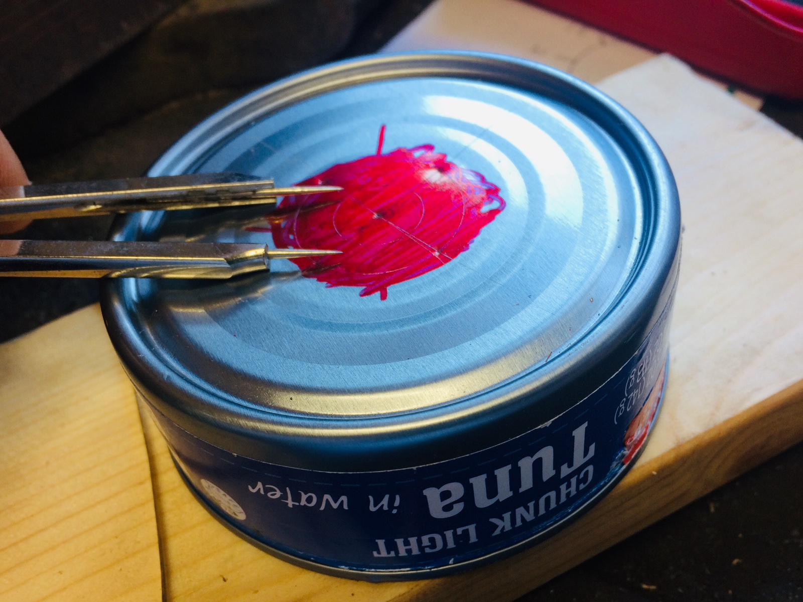

I marked the tuna can using permanent red. (I didn’t have any Persian blue.)

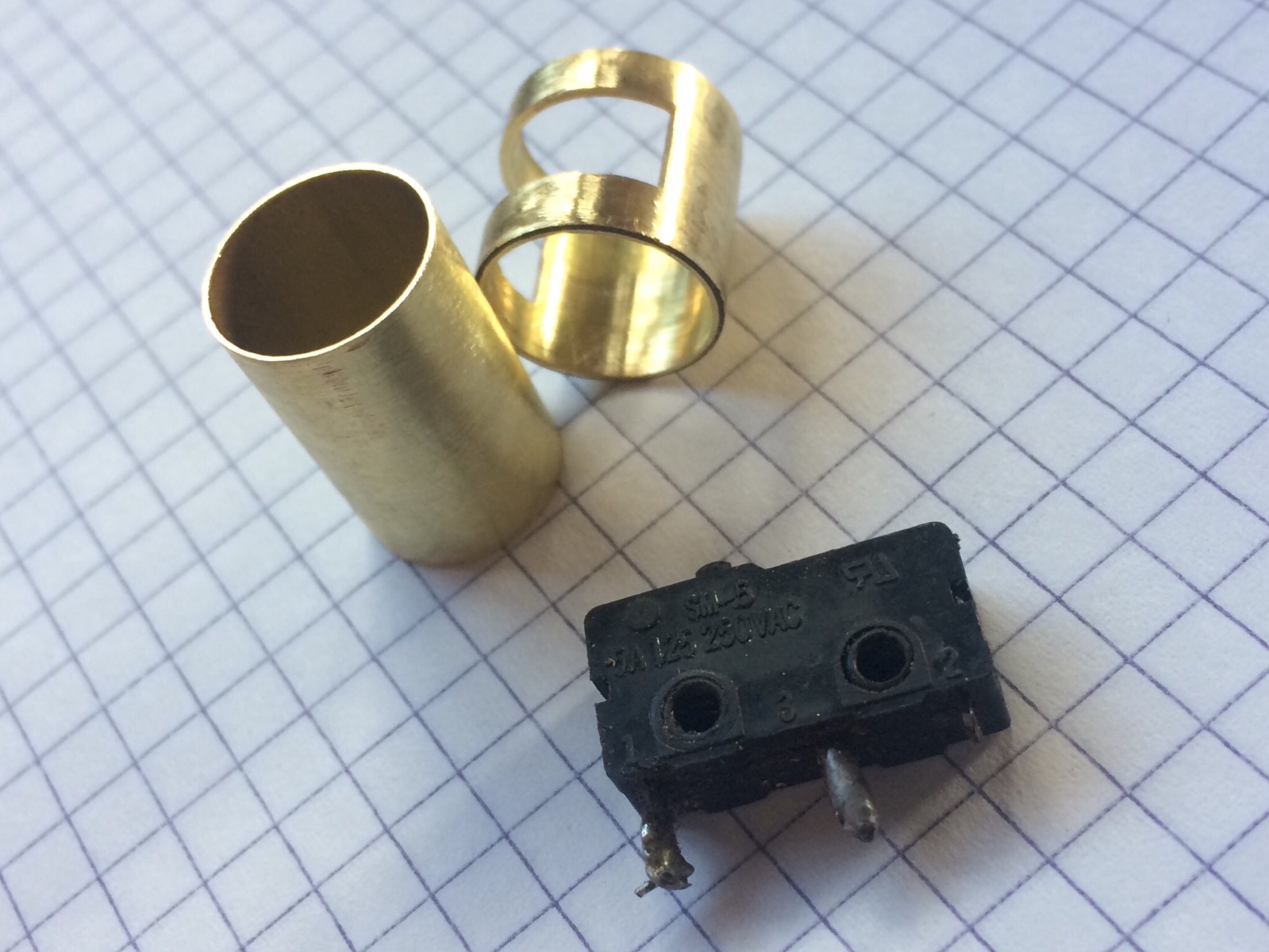

Again I am using a micro switch. I used brass tubing to make the cam to activate the switch.
Tubing fitted together:
Matt in California
- First Name: Matt
- Last Name: G
One more progress photo with the cam assembly.
Mark Nunn
- Posts: 1288
- Last Name: Nunn
- Location: Bennington, NE
Not that this adds to the conversation, but when I don't have blue die available for marking I have successfully used a Sharpie. It cleans up easily with a solvent such as lacquer thinner of kerosene.
Matt in California
- First Name: Matt
- Last Name: G
Mark, yes that was permanent marker red
. I didn’t go to the trouble to clean it off.
I started some testing. Here is the motor running at 750 RPM (or 1500 engine RPM). I did have the sparks plus or minus a few degrees each cycle, but this case is 24 degree dwell followed by 11 degree cycle for second and third spark.
Here is a tabulated record of averages all taken at 12 volts using engine RPM:
RPM, Dwell, 2nd+
1000, 16 , 11
1500, 25 , 16
2000, 35 , 21
2500, 44 , *
*@2500 RPM no second spark was recorded because coil activation is approximately 60 degrees.
I see some similarities with the Crankshaft Travel Versus Ignition Coil Operation Chart. Within 1° the delay to second spark exactly matches column six. I was expecting the dwell time to match, but I will count this as progress!
I think the biggest improvement on this second version is the visualizer. I was able to find a protractor on line and scale it to give degrees.
I am enjoying the feedback both on and offline that I am getting!
Thanks,
Matt

jab35
- Posts: 1037
- Last Name: Bartsch
- Location: Dryden, NY 13053
Matt: I enjoyed your posts, thanks for sharing.
Your setup shows the coil firing at roughly 545 Hz for 2nd and 3rd sparks for all speeds indicated. The first spark may be 'late' b/c the coil is at rest during the dwell period and that may affect time to first spark, but time to first spark is also consistent at all speeds. And remember the camshaft rotates at half crank speed so at 2500 your crank would be turning 5000 rpm. Nice work! jb
Matt in California
- First Name: Matt
- Last Name: G
James,

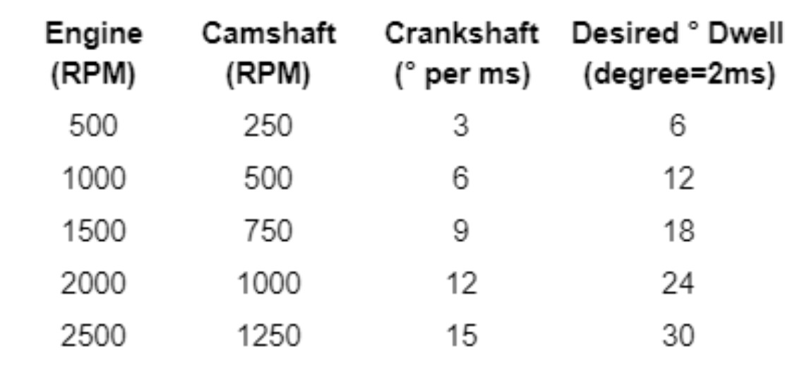

Thanks for your thoughts. I wrote the summary in terms of engine RPM (2*camshaft or 2*my readings).
I was concerned that the MCCT v1 was effecting the dwell time, so I carefully cleaned up the cam for the microswitch and balanced the roaring visualizer. I was shocked with the results. Not only did I get much more stable waveforms, the dwell time decreased dramatically! The above image was taken at 1250 RPM (equivalent to 2500 RPM on the engine). Note that the dwell time is the same time to the second spark!
I made this chart using the recommended 2ms dwell: You will see that this coil looks like it perfectly fits for 2500 engine RPM!
The only concern that I have is that this is in terms of crankshaft dwell... would that mean that the dwell is off by a factor of two? And thoughts?
I look forward to hearing your thoughts and insights.
Matt

I decided that I needed to put my New MCCT to the test and see what other coils look like. Here is an example of the results.
Speeds are actual speed of MCCT or comparable to the camshaft speed.
The coil on the left was one that has relatively new points and a new capacitor. Notice how the frequency of the follow-up sparks are very consistent. By the way the last spark may be cut short because the micro-switch closes around 68-70 degrees.
The coil on the right looks to be an original Ford coil with an old set of points. I would have considered it a good user coil in the past. The difference is that the follow-up sparks are erratic. The dwell time is similar, but I image the current delivered and possibly missing first sparks are more common for the coil on the right. In the end the coil on the right is indeed serviceable, but less than desirable.
Enjoy,
Matt
Enjoy,
Matt

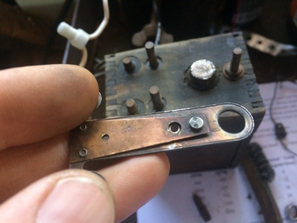

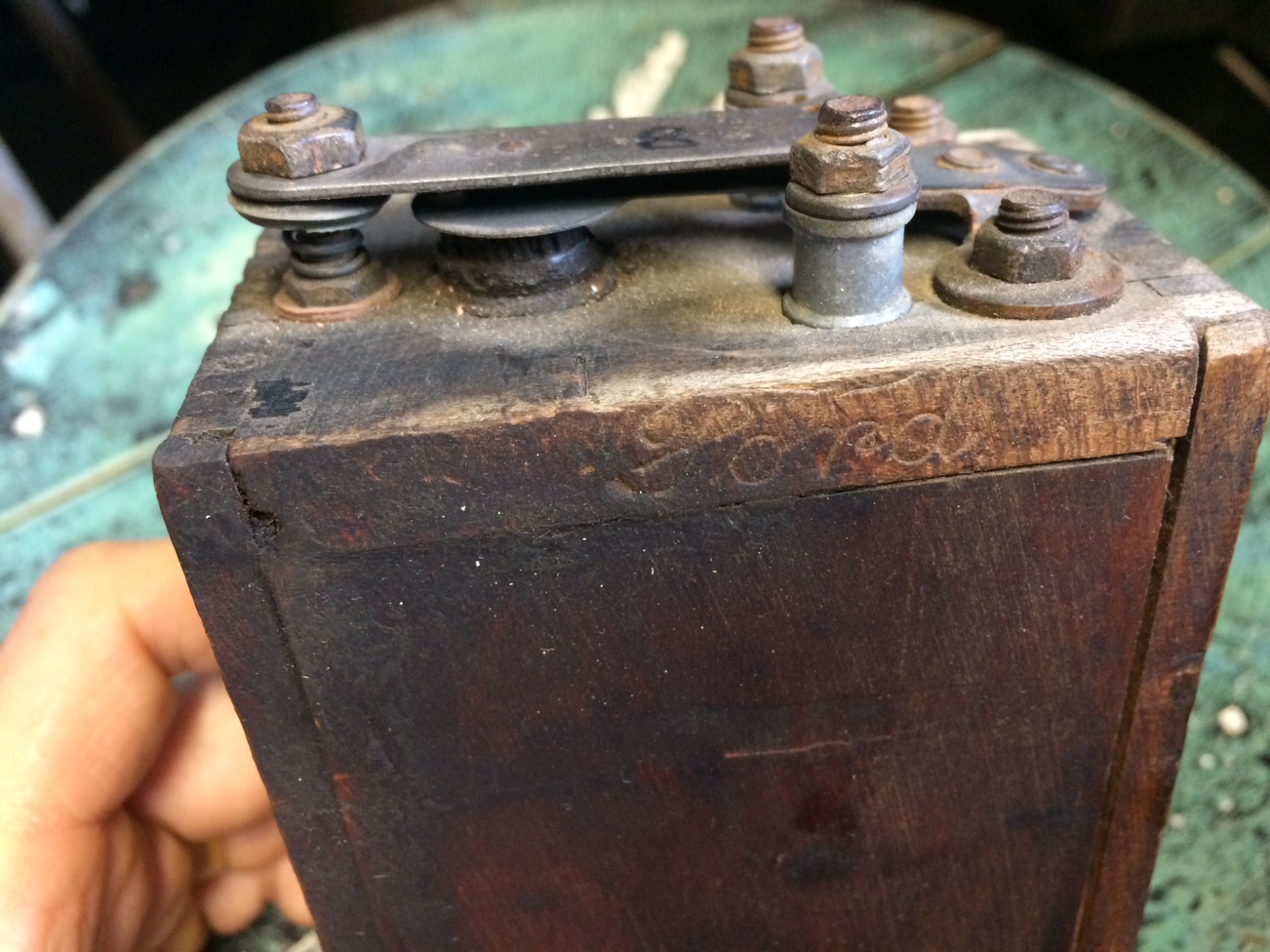

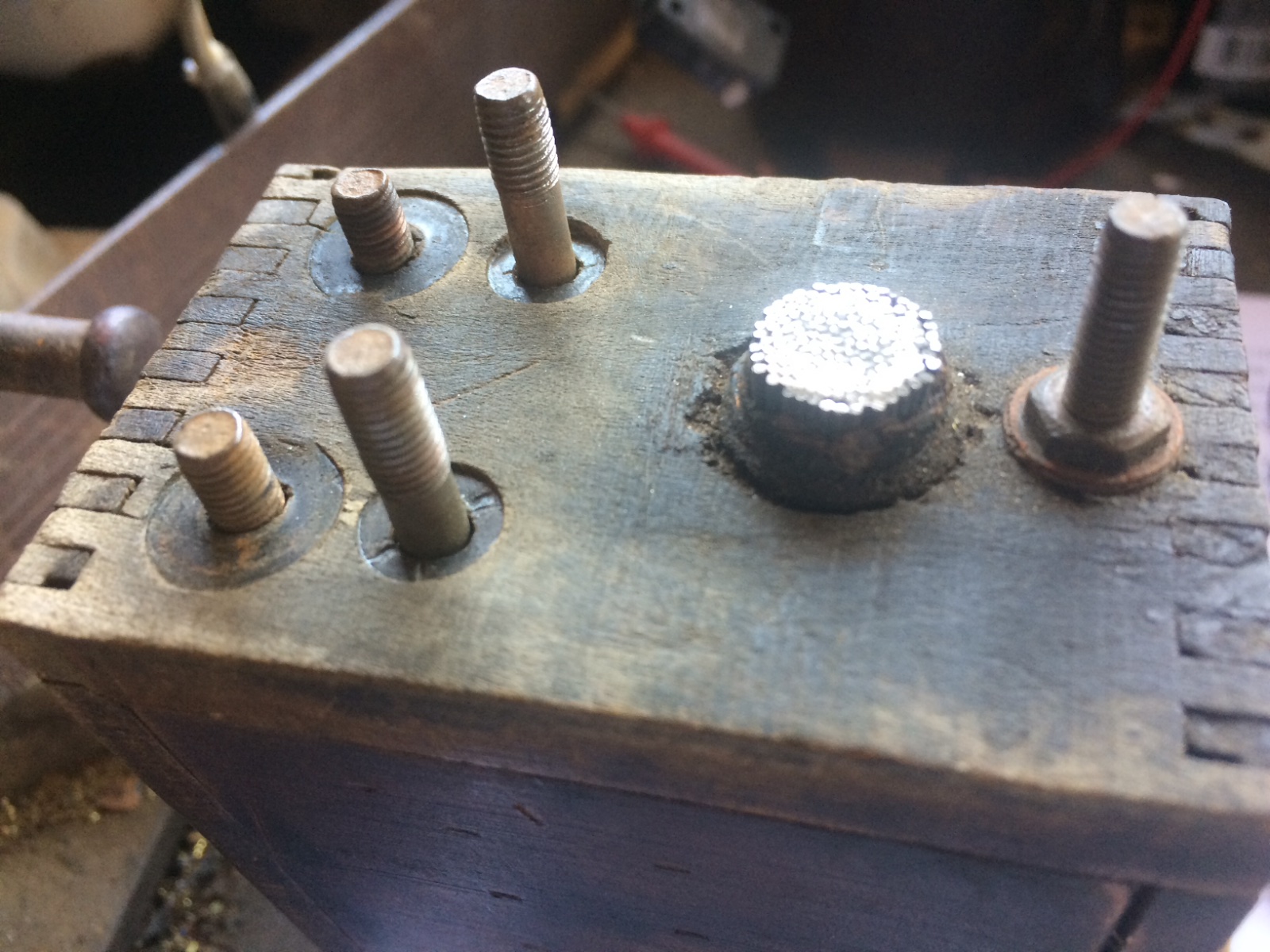

Here is the old Ford coil that was tested and declared “Needs Refinement” above.
A closer look shows that the aluminum standoffs have sunk into the wood.
There is evidence that in the past someone really hammered on the main vibrator spring.
But I think this last photo shows a bit more. The cushion screen travel looks way too large (hard to see in picture). Also the points are not lined up.
I need to get to work on this one.
Matt
Matt
Matt in California
- First Name: Matt
- Last Name: G

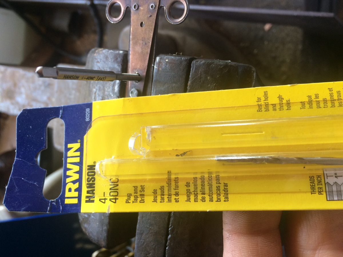

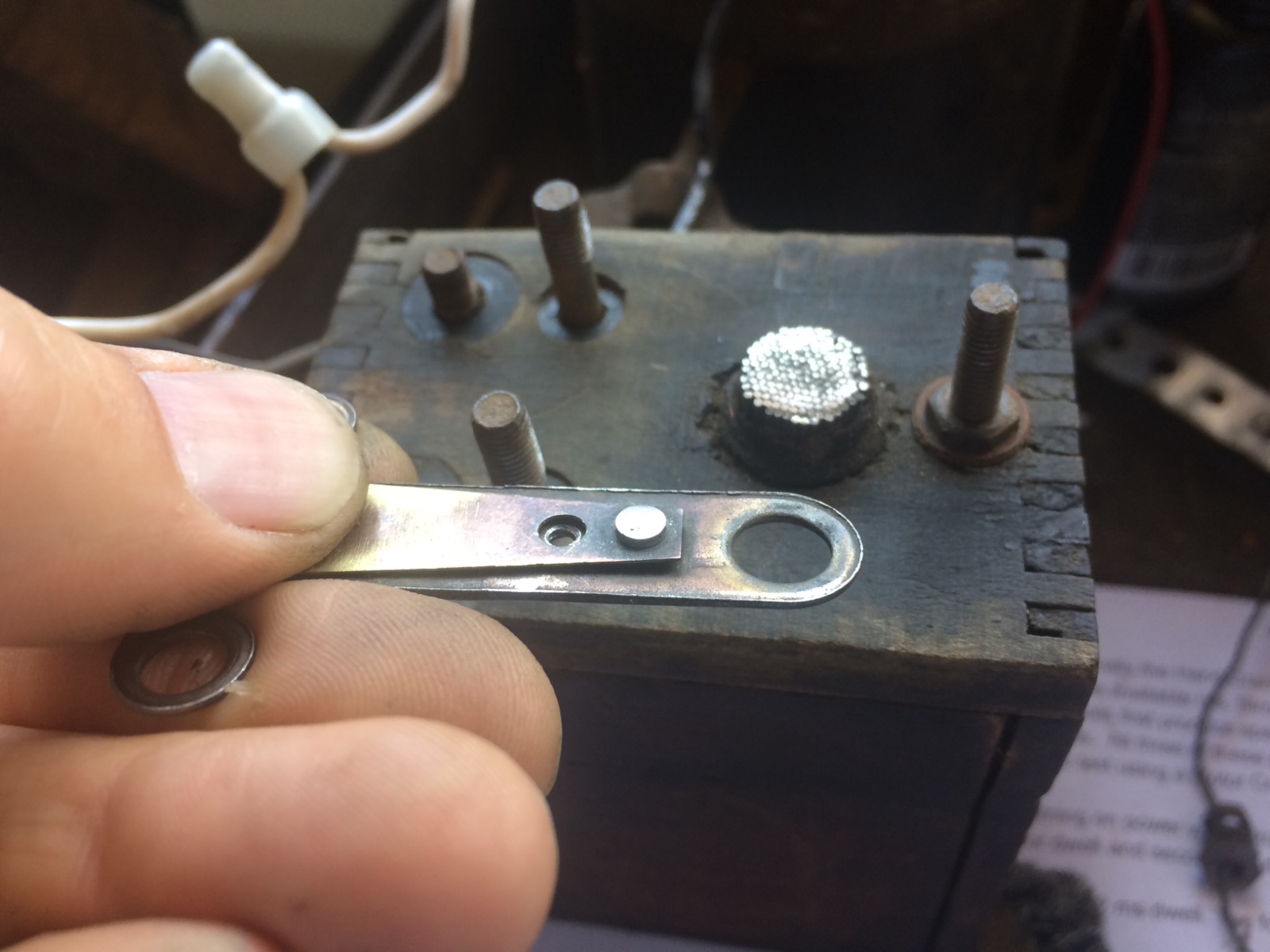

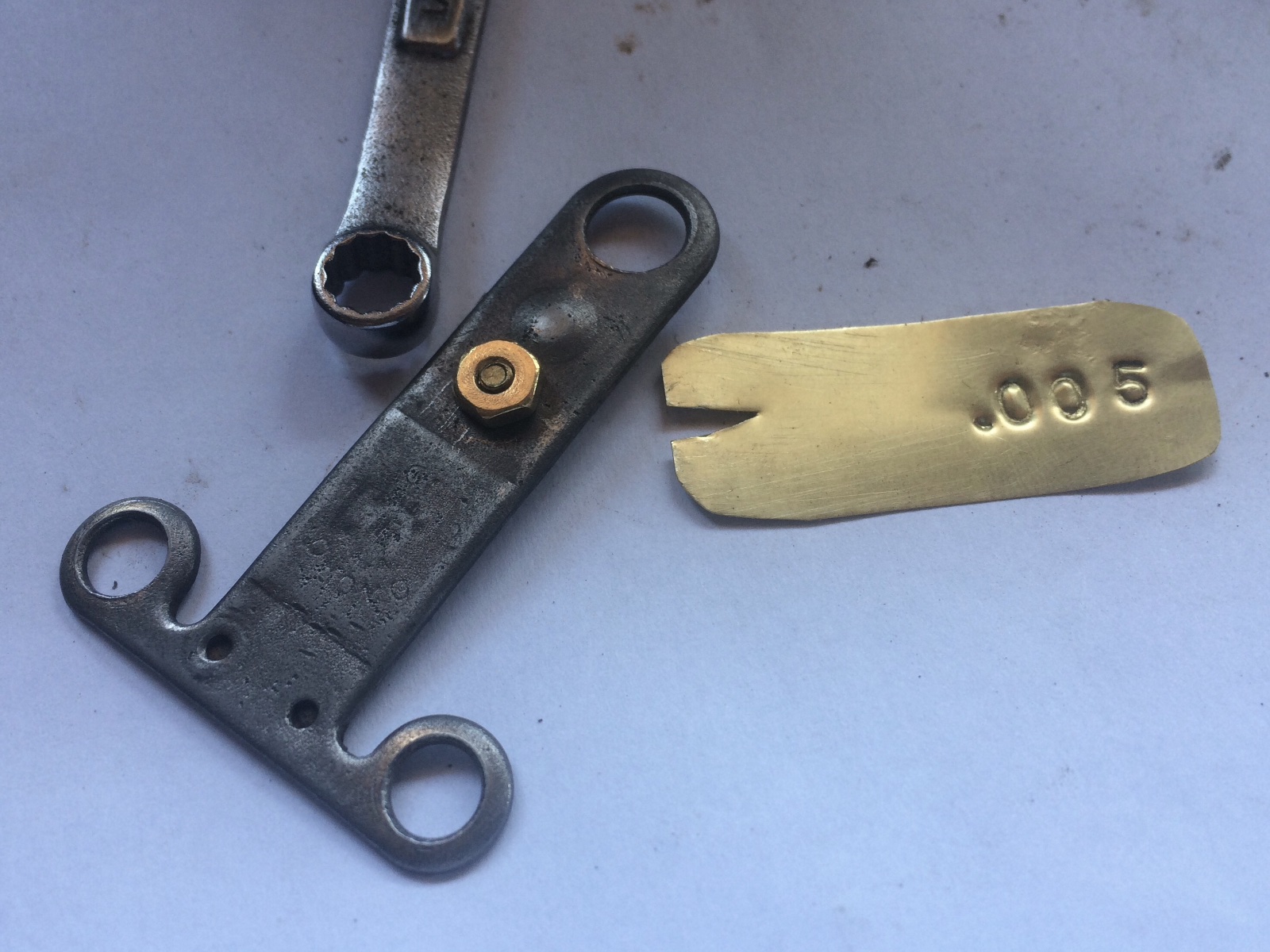

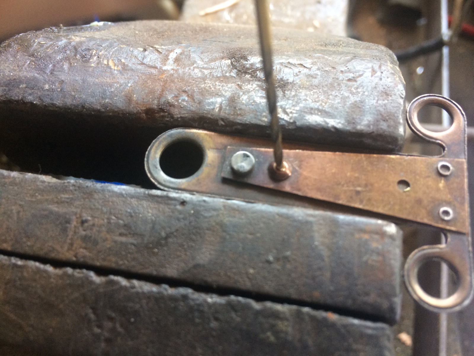

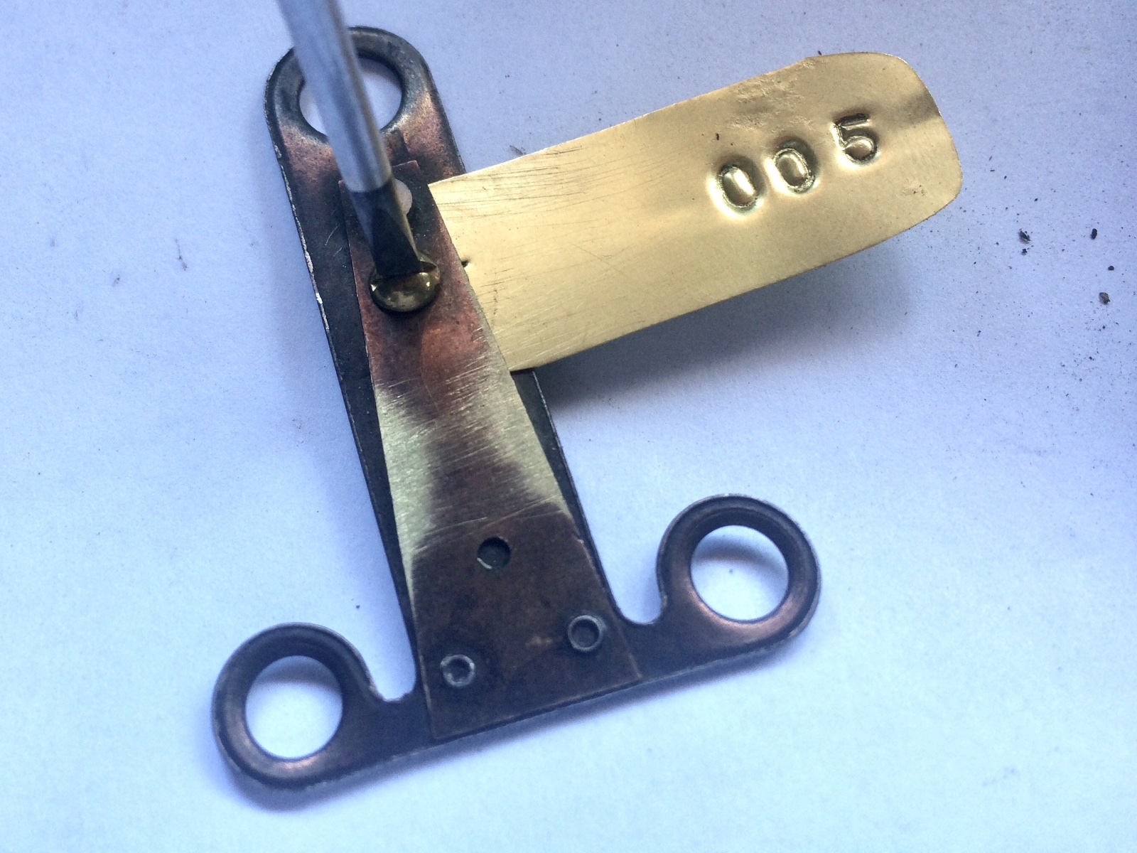

First thing to tackle was a cushion spring river. The original gave about 20 thousands play.
So I drilled it out.
Then taped it with a 4-40 thread.
Put the brass screw in using my home made shim/filler gauge.
Then finished it off with a lock nut.

I then polished the points.
And shimmed the depressions in the wood:
I used 5mm zinc plated washers that work perfectly!
- Posts: 3943
- First Name: Larry
- Last Name: Smith
I'm impressed with all the electrical knowledge some of you guys have. I just don't understand any of it! Ron Patterson rebuilds my coils, and does a fantastic job. I have a good friend who understands electronics a lot, and he purchased a ECCT, and gave me a demonstration on one of the coils that Ron Rebuilt. It was fascinating watching all of this, but I still don't understand it. I have an old HCCT that has and electric motor, and that works for me.
- Attachments
- Coiltester.JPG (75.38 KiB) Viewed 67291 times
Matt in California
- First Name: Matt
- Last Name: G
Larry, Nice set up. I guess that you could consider that a MCCT;)

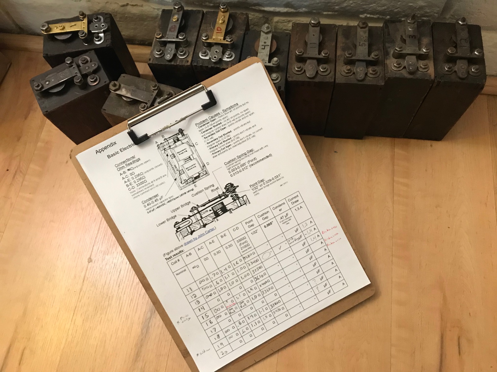

I havn't posted on the MCCT since June. In reality I didn't do much more on the hardware. It does the job, but has room for improvement.
I developed the following manual as a draft, but stalled on the final version since June. You will see that this document is based on the works of others whom I appreciate dearly. In that spirit, consider this open source and use it as you desire. My goal here was to describe how to test coils with the Motor Controlled Coil Tester (MCCT), but the record sheets could be handy for other tester. This includes the following info for adjusting the coils:
Here is the file: File removed. See newer post with updated document.
Please feel to respond with suggestions and I can make changes/improvements.
Matt

With the StroboSpark and ECCT testing with constant voltage levels, the current is adjusted to make all the coils fire at the same level or same time.
A coil set up on the ECCT measures that spark start time and lets it be set equal for all coils to provide a much smoother running engine with more power.
Coils adjusted that way will not all measure the 1.3 amps of current, if tested again in the HCCT, but as that current is only flowing about 1/8th of the time for each coil, a little extra current is not a problem.
My conclusion: Comparing the ECCT and HCCT coil setup is like comparing apples and oranges!

A much better analogy for the HCCT to ECCT comparison is using a sun dial to tell time rather than a digital watch. Yes, that much of a difference. The sun's position to tell time is akin to using coil current to tell time. Granted they are on different scales but there are more variables involved with the coil current that can skew the indirect approximation of coil firing time (coil to coil primary inductance, point arcing, abnormally slow magneto voltage rise time, coil not starting from rest (no timer) to name a few).
To put the required accuracy in perspective. +/- 0.00008333 seconds equates to +/- 1 degree of ignition timing error at 2000 RPM That is the time of the 1st spark firing from rest with a fast magneto rise time. Try measuring that with a mechanical watch. Similarly, the HCCT measures the average RMS current of a steady stream of coil firings none of which are from rest. Occasional coil point arcing may very well be present and averaged into the reading.

I had someone recently ask about how to make a Motor Controlled Coil Tester. I though this thread outlined how to make MCCT, but realized I that I could better illustrate it. Here is the simple design used for the Motor Crank Coil Tester (MCCT):
Simply put the MCCT is a Ford coil triggered by a switch. This switch is controlled by a cam on a motor. The motor speed controller adjusts motor speed that controls the switching time to the coil very much like a commutator does on the Model T. The indicator turns and can display the spark on a scale similar to a Hand Crank Coil Tester (HCCT). Additionally an amp meter is used to display the amount of current flowing to coil.
Here is the most practical part of the document. I use it to catalog the pile of coils that I have.
Updated manual for adjusting coils specifically with the MCCT:
Deleted... See updated version later in this thread.
Please give me any feedback you may have on this. I am trying to make it a helpful resource for others. As you will see it is not just for the MCCT.
Enjoy,
Matt

I started this topic back in April. Here is my personal ranking after researching and hearing feedback from others.
I personally feel the ECCT seems to be a great device and the best on the market. Early on a gentleman using one told me his story. He said most people who own model Ts just want to go make a trip to get ice cream. For that a simple buzz box maybe okay. But when he met someone who could start the car from magneto and had a great running car researched coil adjustments. He now has a car that runs beautifully and won the Montana 500 in the past. His claim is that a set of matched coils is key for that. But I want to underscore that it is good to have a set that is tuned for 2000 RPM not only so the car can run well at 50 mph. The slower the car idles the lower the magneto voltage/current. Low voltage will make the dwell time longer.
The Strobo-Spark seems like a great modern option, but it seems like it is not available now. The HCCT also works, but it can be expensive and is not portable. There are some attractive DIY options, but it requires some time and know how.
Anyway this has been a great learning experience for me and I hope the data posted is helpful for others. Feel free to give your own feedback and opinions.
