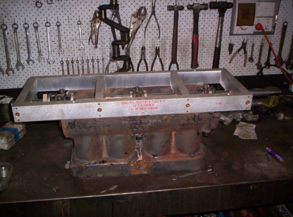

Not trying to hi-jack Mark's thread but I know that cylindrical grinders are all but obsolete these days but has anyone ever used a crank grinder to sharpen a reamer? My grinder is set-up strictly for plunge grinding, but I suspect I could sweep once I had the bulk removed. Not sure how my Arnold gage would work on a reamer ...and maybe that is the issue??Dan Hatch wrote: ↑Thu Dec 22, 2022 6:43 pmThe KRW machines are designed to use the reamer. They do a good job with that. But undersized reamers are few. I had a local guy that ground mine but he closed. Hard to find a grinder that with take that long a reamer. Last ones he did for me were $400 each.
Mark, something that Dan and I have spoken about over the years is most KR Wilson Frames have the bushings worn just enough where they cannot hold/support the bar tight enough without creating some harmonics. Dan & I discussed using a sacrificial T engine block as a boring bar frame where we would bore the block's mains large enough that it would hold a 0.750" ID bushing in all 3 mains. Then after making a 0.750" boring bar, the bearings in the KRW Frame could be bored out to accept new bushings, ...and then those new Frame bushings align-bored to accept your Model-T boring bar. I think our consensus has been that when you added all the time you will spend modifying an old KRW Frame to be good as new, you could spend that same amount of time (-or likely less!!) working part-time at McDonalds to earn the money to buy one of Gene's frames and be done with it.
While I use a TA14 to line-bore most projects in my shop, I do own several Tobin Arp SB bearing resizers. I have strongly considered using one of those as a drive-unit for powering one of Gene's frames and boring bars. The Tobin Arp drive motors they used on many of their tools are really very nice and produce a beautiful finish because of their hydraulic feed and infinite speeds. These units also use variable pulleys to control the bar rotational surface feet per minute speeds. If you are looking for a drive unit, I would suggest looking for a TA drive motor and adapt that.

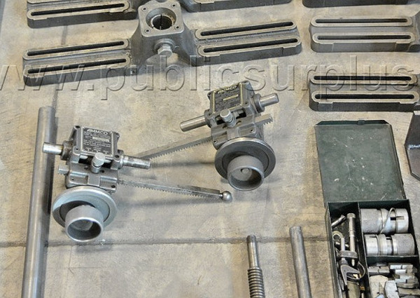

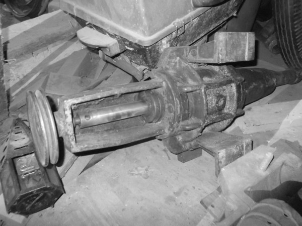

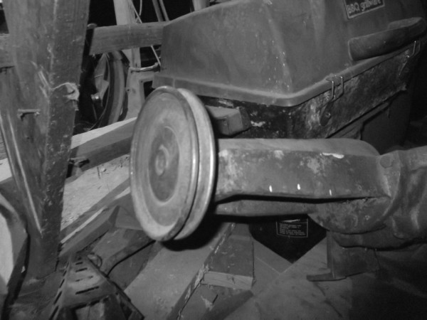

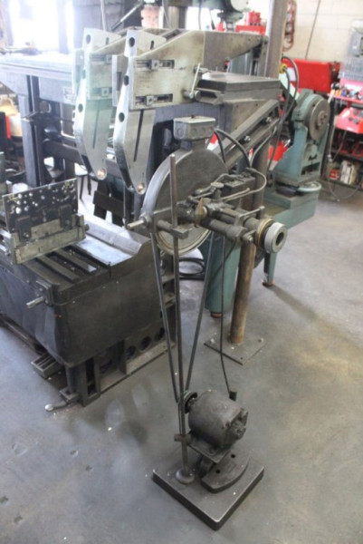

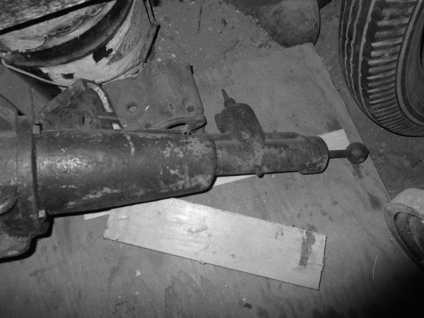

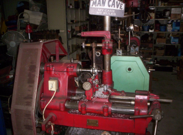

Kwik-Way portable line boring machines also use a similar drive unit. See https://www.fordgarage.com/pages/kwikwa ... ctions.htm
The 2nd photo shows the feed unit on the end of the boring bar set up on the bottom a supercharged 1930 SSK Mercedes block.
You can see several photos of the complete rig @ https://www.publicsurplus.com/sms/aucti ... uc=1606930
The drive end of the shaft slips into a concentric bore on the inside of the boring bar, and the rack and pinion drive with a ball on the end is fastened by a universal adaptor to the engine block.
These line-boring machines are obsolete but can still do excellent work in the hands of a patient operator. You should be able to buy a complete setup from a reasonable seller for about $250 - 500 and sell the rest of the parts not needed or possibly find just a feed unit for less. If my memory serves me right, the boring bar is about 1-1/4" and too large for standard T-sized bearings, but it could be adapted to use a smaller bar.

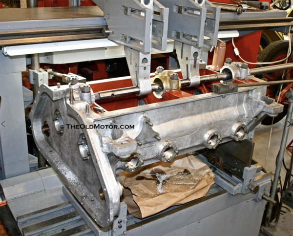

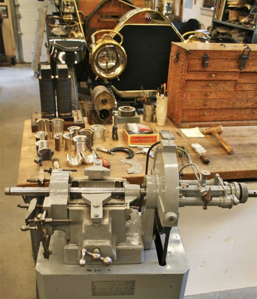

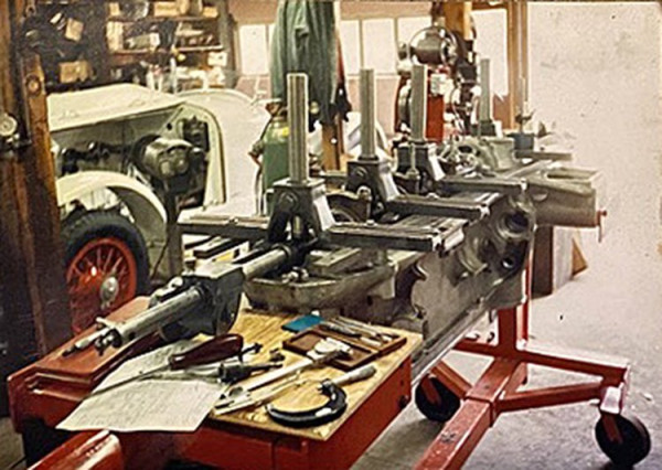

Re: Babbitt boring bar RPM?
In the foreground of this photo you can see the self contained Tobin Arps hydraulic (rotational and horizontal) feed works that can easily be adapted to any Model T align boring fixture.
The beauty of this unit is that they are reasonably easy to find, not terribly expensive, the horizontal feed rate is infinitely adjustable in both directions, the hydraulic feed pump is powered by the rotational action and you can still buy TA repair parts for repairs. Ron Patterson

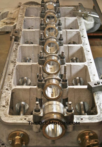

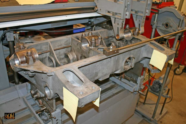

If anyone would like to see how I use a Torbin-Arp machines to line-bore early non-Ford engines and make new bearings check the following links:Ron Patterson wrote: ↑Sun Dec 25, 2022 3:21 pmIn the foreground of this photo you can see the self contained Tobin Arps hydraulic (rotational and horizontal) feed works that can easily be adapted to any Model T align boring fixture.
Ron Patterson
https://theoldmotor.com/?p=149961
https://theoldmotor.com/?p=47859
https://theoldmotor.com/?p=56711
These Tobin arp feed units are all used on their connecting rod machines (above) learn more @ https://theoldmotor.com/?p=51174

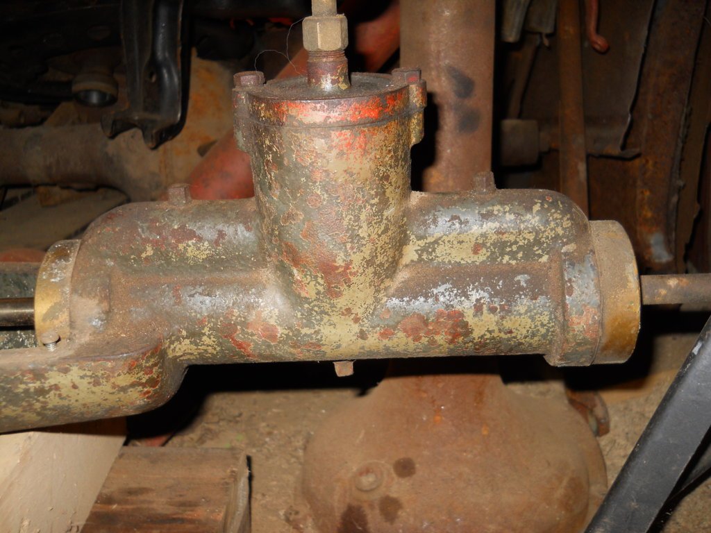

Topic author - Posts: 5398

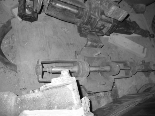

Guess I could somehow use these parts to drive the boring bar:

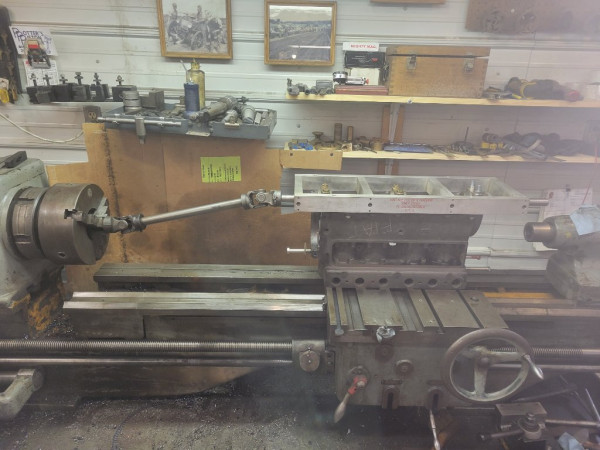

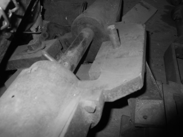

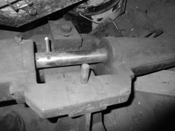

One more photo. This is where my sliding drive I was going to use on the lathe is coming from. The drive fluid which looks like a master brake cylinder with the reservoir on top. The actual drive is a grooved piece in the housing that is fed by the reservoir and turned by the pulley/sliding shaft at the other end.
The AAMCO unit, I have thought about. The boring bar and boring bar rod/holders would have to be modified or replaced as the smallest size supplied in the kit that I have seen, would be too big for the Model T. I did come across one of the holders on eBay that was made for the smaller Model T boring bar.
