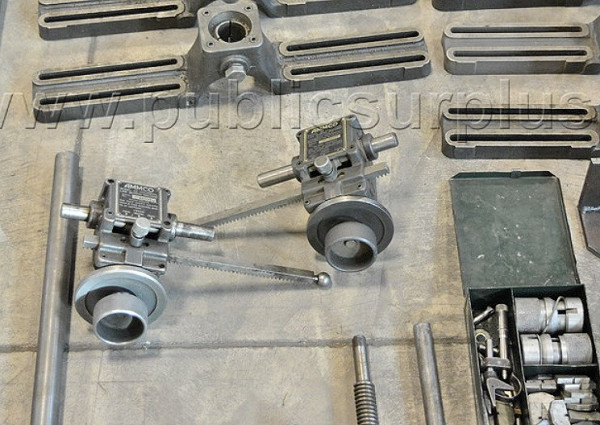

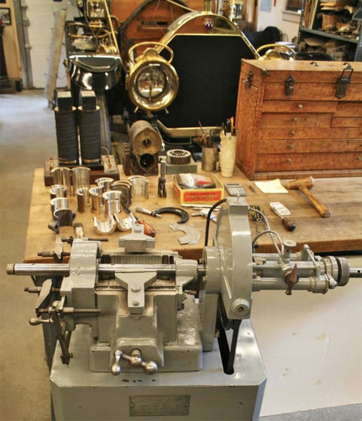

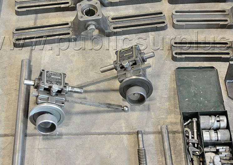

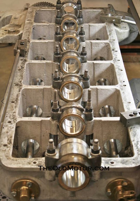

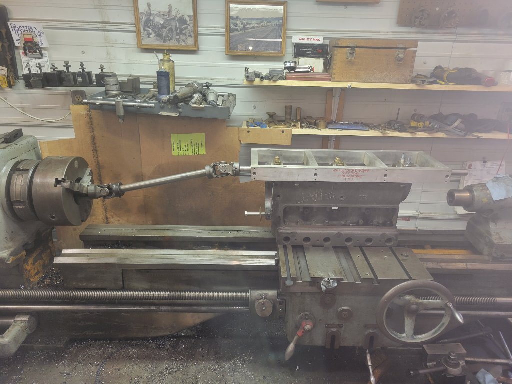

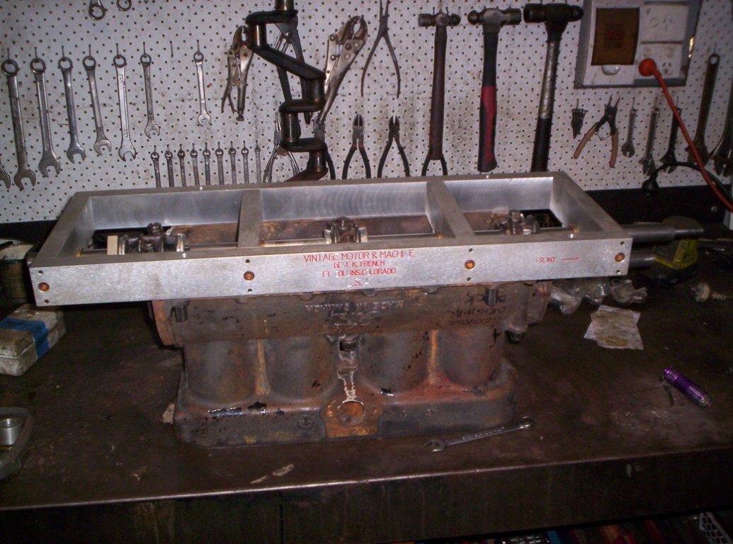

Mark, 40 years ago, before buying a Tobin Arp line boring machine, I purchased a WWII-era AMMCO Model 42 portable line boring machine seen in the second photo. The feed unit for it is just like the two in the 1st photo and is powered by an electric drill. The feed unit is not what you are looking for but are inexpensive and feed gearboxes have forward and reverse and both rough and fine feel settings and work well for main and cam bearings.
Kwik-Way portable line boring machines also use a similar drive unit. See https://www.fordgarage.com/pages/kwikwa ... ctions.htm
The 2nd photo shows the feed unit on the end of the boring bar set up on the bottom a supercharged 1930 SSK Mercedes block.
You can see several photos of the complete rig @ https://www.publicsurplus.com/sms/aucti ... uc=1606930
The drive end of the shaft slips into a concentric bore on the inside of the boring bar, and the rack and pinion drive with a ball on the end is fastened by a universal adaptor to the engine block.
These line-boring machines are obsolete but can still do excellent work in the hands of a patient operator. You should be able to buy a complete setup from a reasonable seller for about $250 - 500 and sell the rest of the parts not needed or possibly find just a feed unit for less. If my memory serves me right, the boring bar is about 1-1/4" and too large for standard T-sized bearings, but it could be adapted to use a smaller bar.

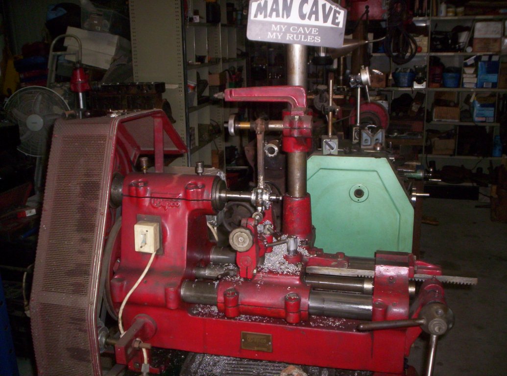

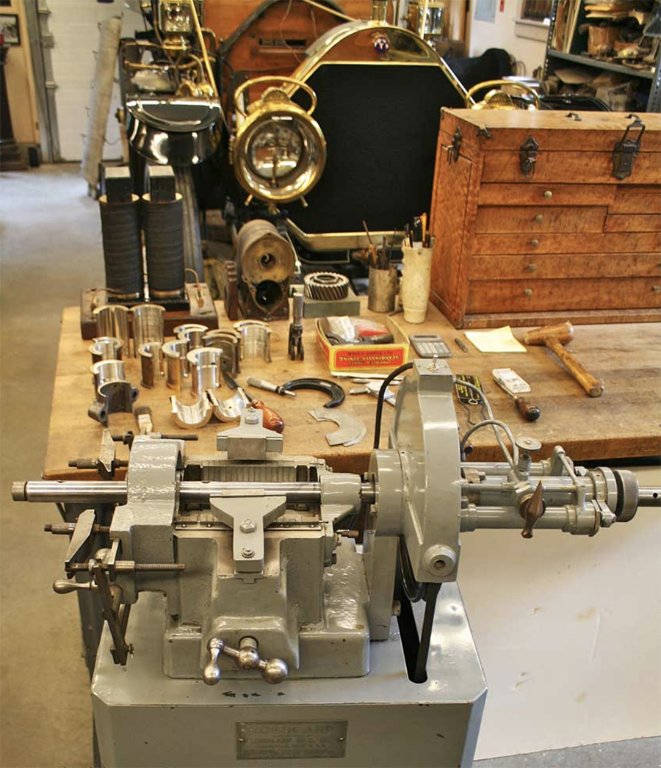

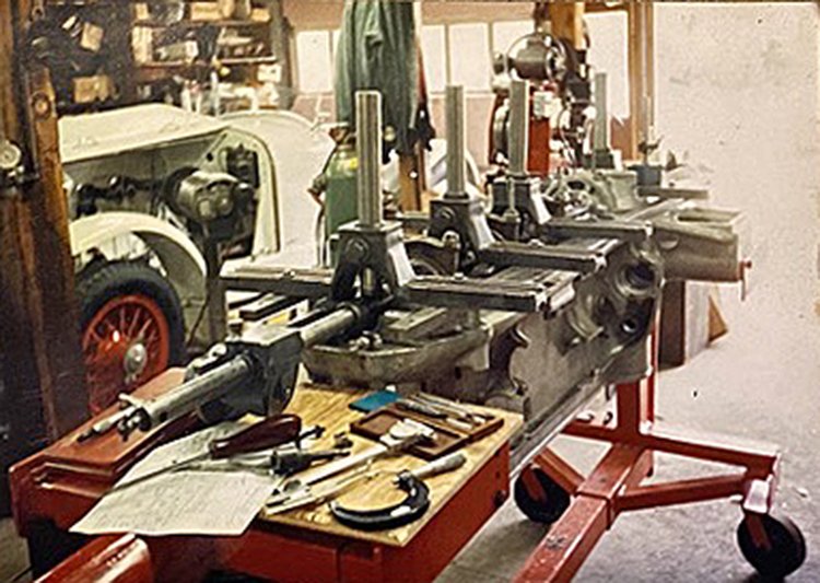

Ron Patterson
Re: Babbitt boring bar RPM?
In the foreground of this photo you can see the self contained Tobin Arps hydraulic (rotational and horizontal) feed works that can easily be adapted to any Model T align boring fixture.
The beauty of this unit is that they are reasonably easy to find, not terribly expensive, the horizontal feed rate is infinitely adjustable in both directions, the hydraulic feed pump is powered by the rotational action and you can still buy TA repair parts for repairs. Ron Patterson

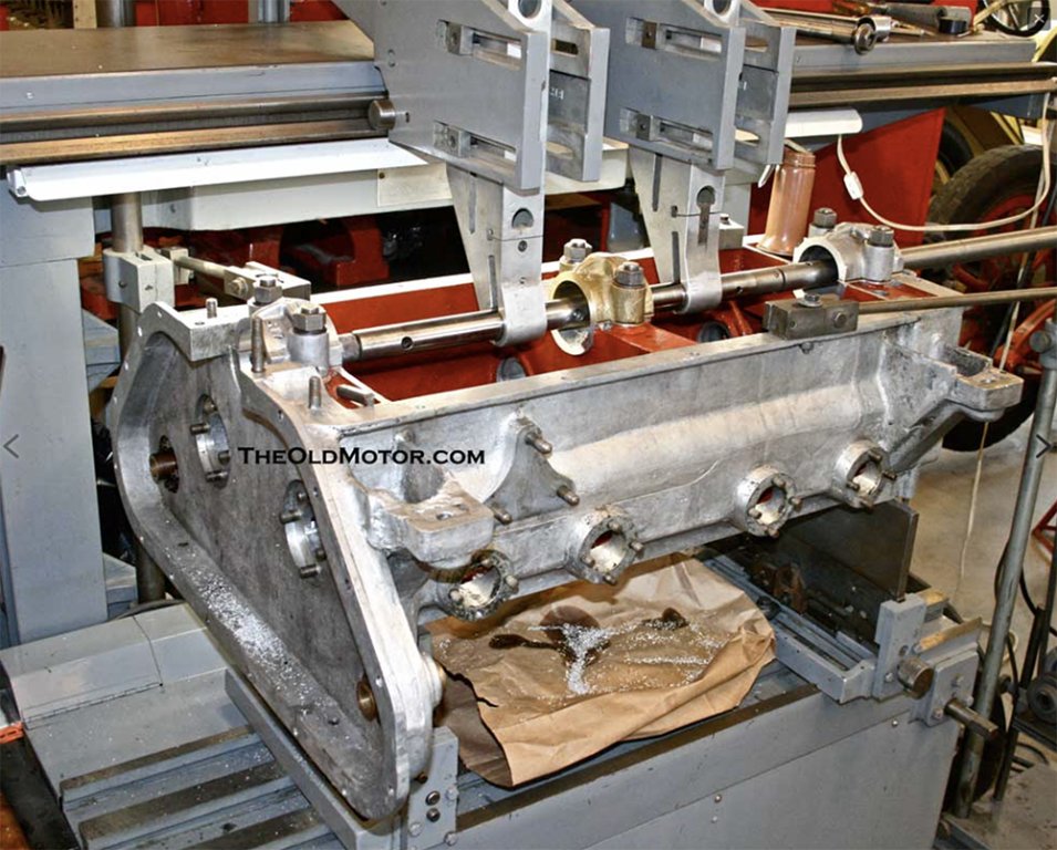

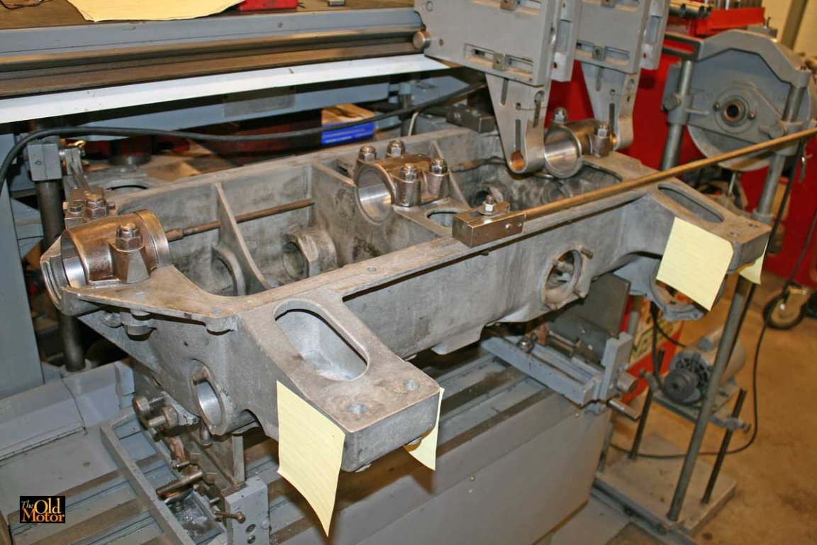

If anyone would like to see how I use a Torbin-Arp machines to line-bore early non-Ford engines and make new bearings check the following links:Ron Patterson wrote: ↑Sun Dec 25, 2022 3:21 pmIn the foreground of this photo you can see the self contained Tobin Arps hydraulic (rotational and horizontal) feed works that can easily be adapted to any Model T align boring fixture.
Ron Patterson
https://theoldmotor.com/?p=149961
https://theoldmotor.com/?p=47859
https://theoldmotor.com/?p=56711
These Tobin arp feed units are all used on their connecting rod machines (above) learn more @ https://theoldmotor.com/?p=51174

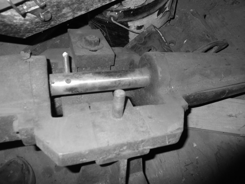

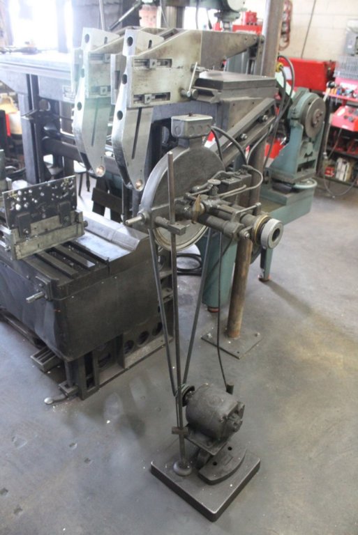

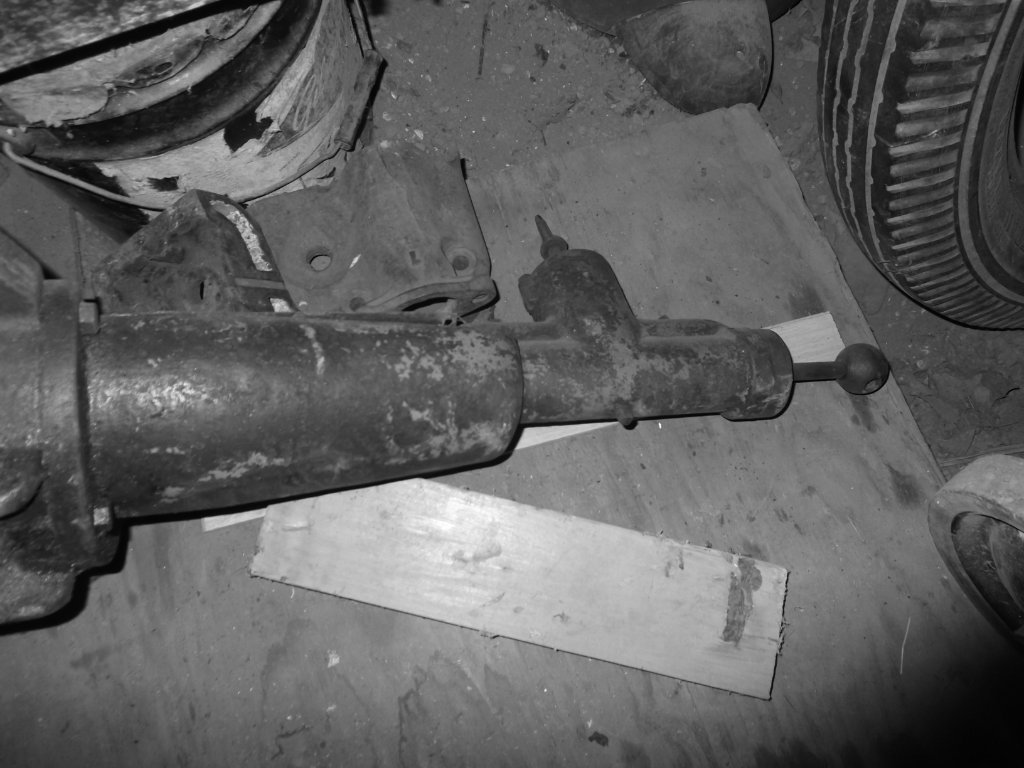

Topic author - Posts: 5548

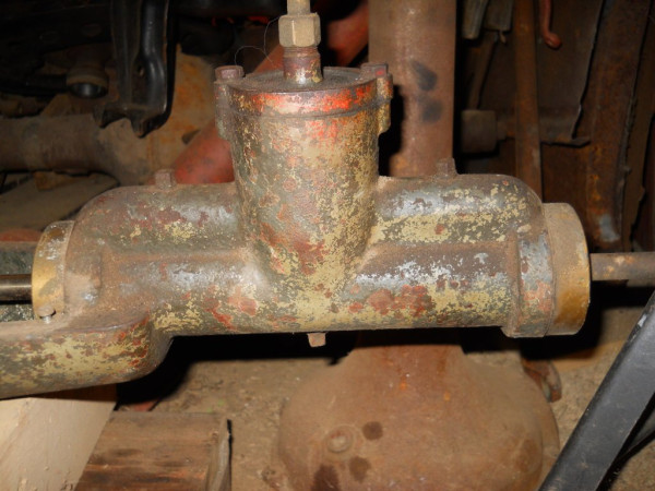

Guess I could somehow use these parts to drive the boring bar:

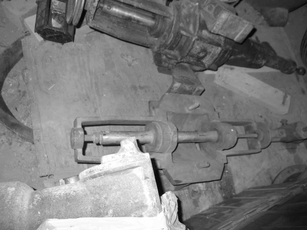

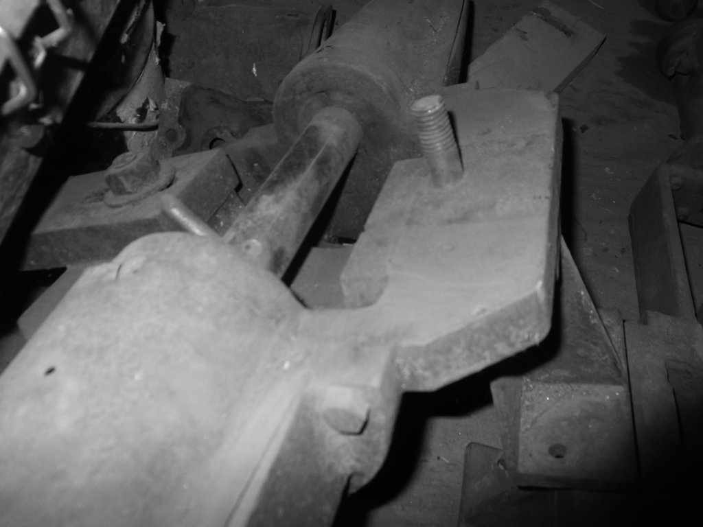

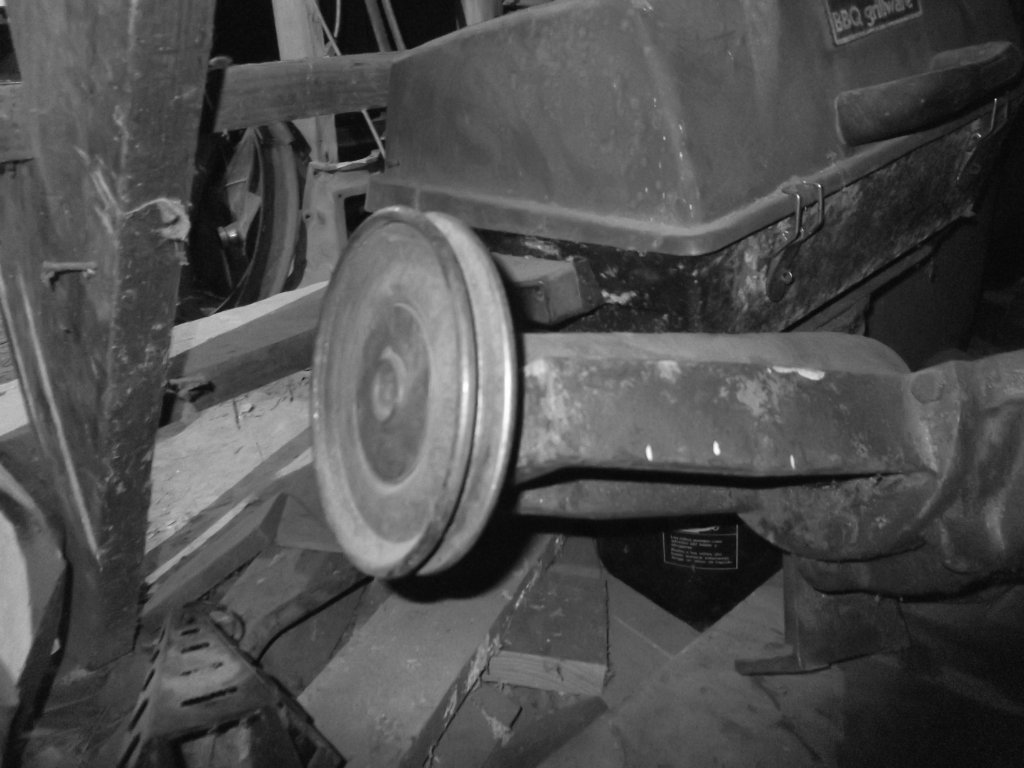

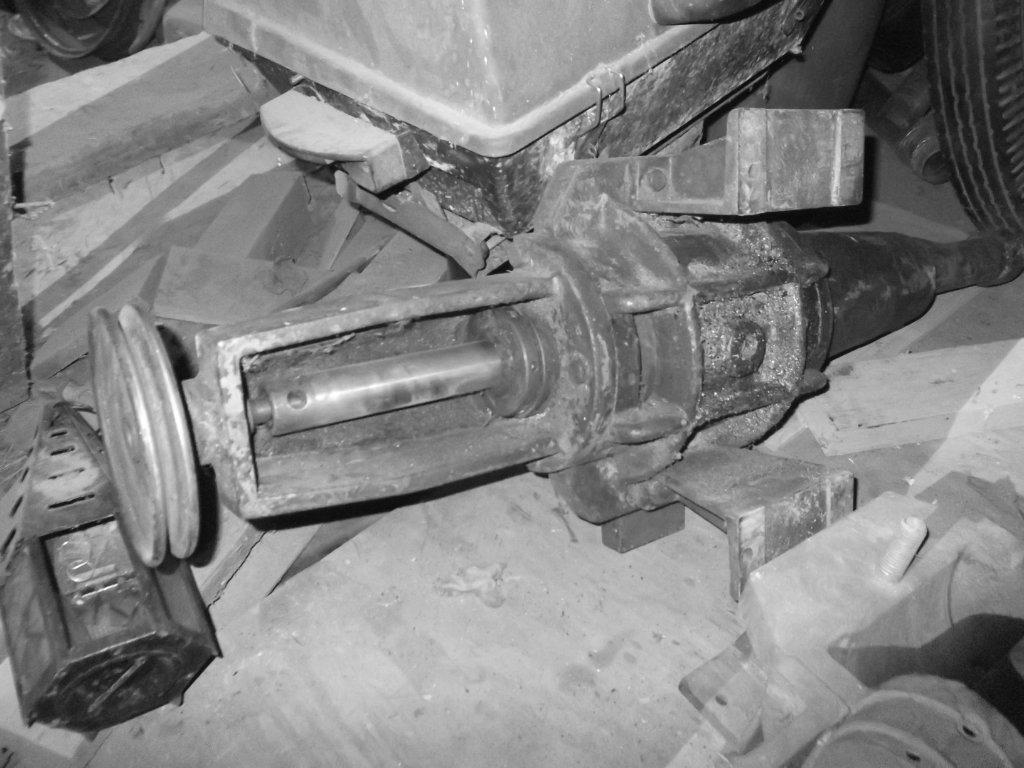

One more photo. This is where my sliding drive I was going to use on the lathe is coming from. The drive fluid which looks like a master brake cylinder with the reservoir on top. The actual drive is a grooved piece in the housing that is fed by the reservoir and turned by the pulley/sliding shaft at the other end.
The AAMCO unit, I have thought about. The boring bar and boring bar rod/holders would have to be modified or replaced as the smallest size supplied in the kit that I have seen, would be too big for the Model T. I did come across one of the holders on eBay that was made for the smaller Model T boring bar.
