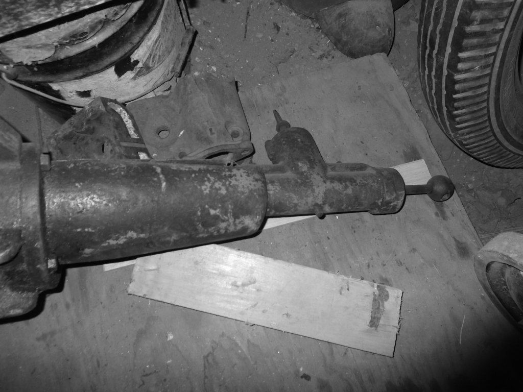

Guess I could somehow use these parts to drive the boring bar:

Post by Mark Gregush » Mon Dec 26, 2022 3:26 pm
One more photo. This is where my sliding drive I was going to use on the lathe is coming from. The drive fluid which looks like a master brake cylinder with the reservoir on top. The actual drive is a grooved piece in the housing that is fed by the reservoir and turned by the pulley/sliding shaft at the other end.
The AAMCO unit, I have thought about. The boring bar and boring bar rod/holders would have to be modified or replaced as the smallest size supplied in the kit that I have seen, would be too big for the Model T. I did come across one of the holders on eBay that was made for the smaller Model T boring bar.
