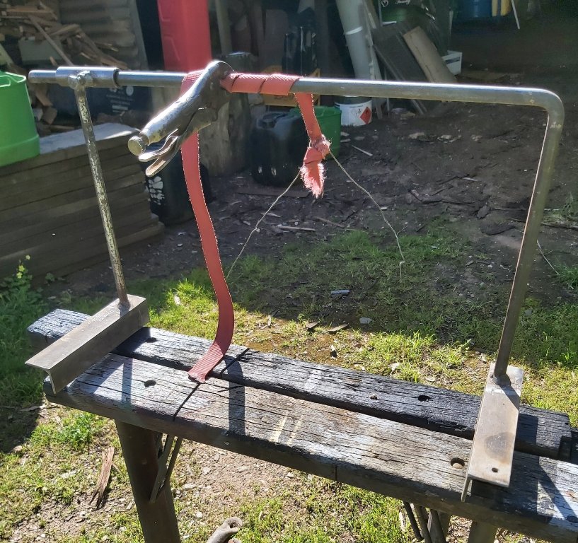

- Posts: 7167
Re: Slow Speed Pedal Shaft
Art, I use a ratchet tie down to pull the axle assembly back. One end goes around the rear cross member, the other hooks inside one of the radius bolt nuts at the front. You don't need much. The idea is to open up the gap just a bit so the hogshead can be lowered into place with as few impediments as possible. You are wise to pull the exhaust manifold too.
A few weeks ago I posted photos of a device I made to make the job of lowering the cover into place so much easier. Others may be able to find it for you.

- Posts: 7167
Art, I found a photo of the fitting jig I made from some scrap. The angle irons sit on the frame rails. The wire goes in the two top holes for the inspection plate. The multiple loops of strap allow for controlled lowering. The lock on pliers allow you to hold it at any height while you align the clutch fork and pedal shafts in the bands. No need to fight the weight of the thing. I could almost do the job on my own, but help is good.
- Posts: 7167
Photo.
Art M
- Posts: 984
- First Name: Art
- Last Name: Mirtes
- Location: Huron, Ohio
Allen,
Thanks for posting the above picture of your rig for supporting the hogshead during its installation. I am planning to build one. It's a simple no cost solution to a complex problem.

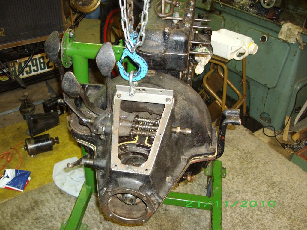

ABoer
- Posts: 236
- Joined: Mon Jan 07, 2019 2:41 pm
- First Name: Anthonie
- Last Name: Boer
- * REQUIRED* Type and Year of Model Ts owned: 1912 touring 1923 roadster 1925 pickup
- Location: Klaaswaal NL
This is my helper with the Hogs Head .
Toon
Toon
